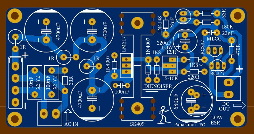

Yeah that's my PCB, I originally took a schematic from AMB but then changed it to a simple RC delay circuit, something like this
And it's similar but it's an XPPower ECL10US12-E (10w) since those don't have a maximum load capacitance

...also my friend knauf1919 designed a nice power supply for this tiny amp....I invite him to post the final version of the PCB project if he wants so...
It's nothing special. It's the DieNoiser version (I like the name) of tombo56.

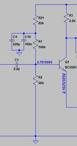

I know I am rather late to the party but I would like to suggest a small improvement to this design. As it stands, its PSRR is quite poor simply because the first stage is biased directly from the supply. Any noise on the supply is fed straight to the input and care is needed with the PCB layout to ensure output stage signal currents do not induce voltages onto the supply feeding the bias resistors.
To fix this I would suggest using a decoupled potential divider for generating the required bias voltage and then feeding this to the base of the first transistor via a suitable value resistor.

Hi Ian, it's never too late to join this party!
Thanks for your suggestion. Looking at the circuit, it makes total sense that whatever noise gets past the PSU filtering will manifest in the input of the BC550.
I've had a play in the sim and this change seems to make quite a difference when I inject a sine wave into the DC supply:
Is that along the lines of what you are thinking?

That is just the sort of thing I had in mind. With the values you used the corner frequency is close to 20Hz so I would increase the cap to 1uF or even 10uF to drop it well below the audio band.
