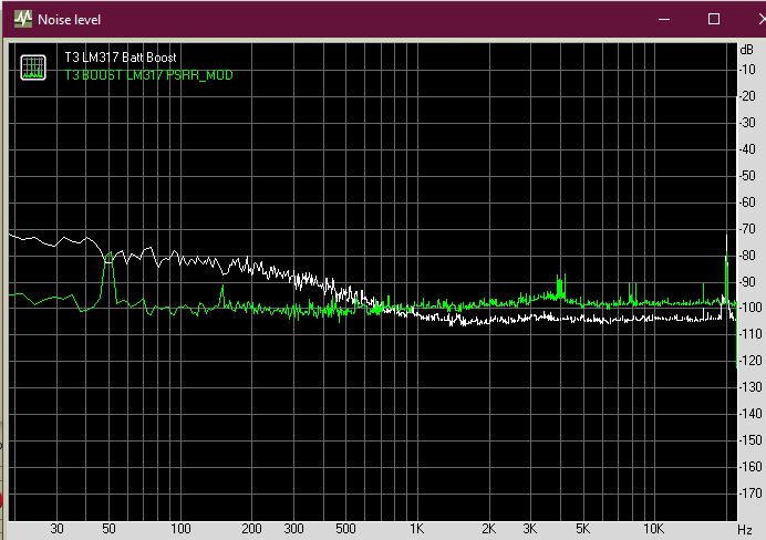

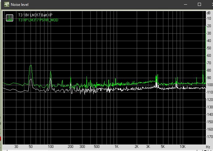

Some quick results
I made the changes to the power supply to the driver transistors as previously detailed:
Remove 180K and replaced with 82K and 100K in series
Connected mid point to 22uF and 100nF to ground
Measured using the power supply labelled 'XP' and 'Boost' (phone charger- > Boost Converter)
Same configuration as before:
Power supply -> CRC -> LM317 -> VCC
All with a 245ohm load @ -3dB.
Here is the comparison with before:
XP:
Boost:
As you can see, the noise floor was worse using 'XP', but the boost converter faired much better and is now quiet with no input connected.
There was a change to the enclosure in that a layer of aluminium was applied to the inside surfaces to assist with shielding (plastic case), so that might be a factor in these tests, and something that I'll look into more when I get a chance.

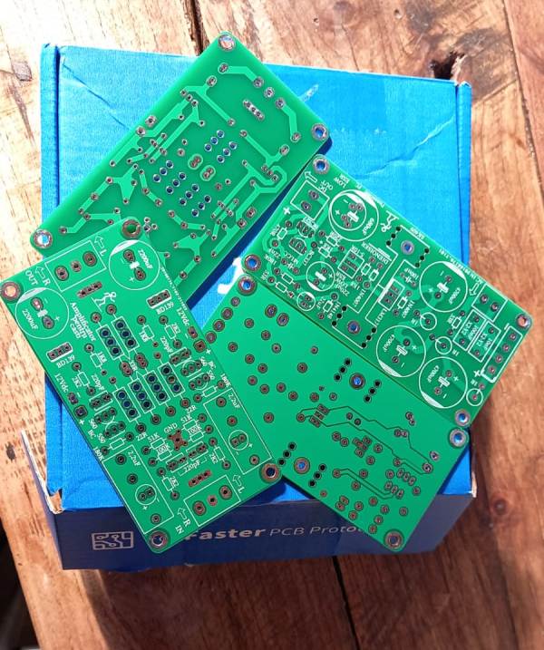

After I receive the PCBs from knauf1919, I will prepare some kits with this set of PCB, if anyone interested, send me a message. 2-3 sets will be available, PCB+components or PCB mounted and tested. I will come back with assembled ones photos. The set of PCB contains one PCB for the amplifier and one for the denoiser/stabilised power supply.

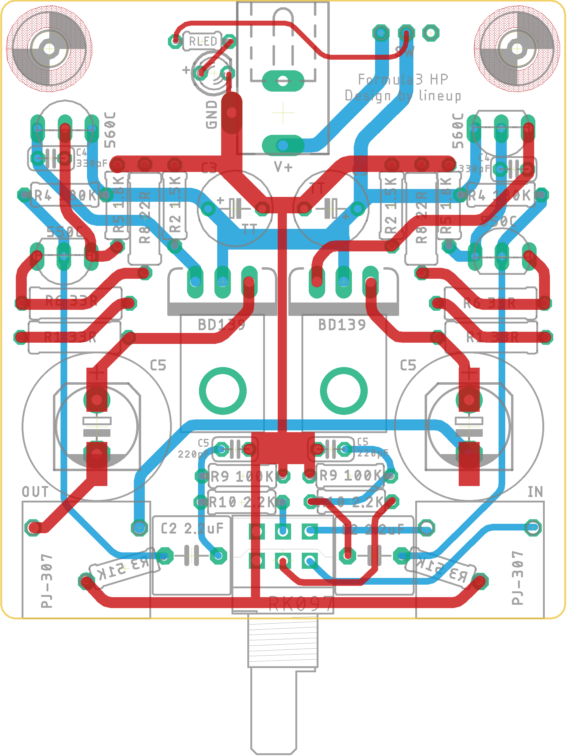

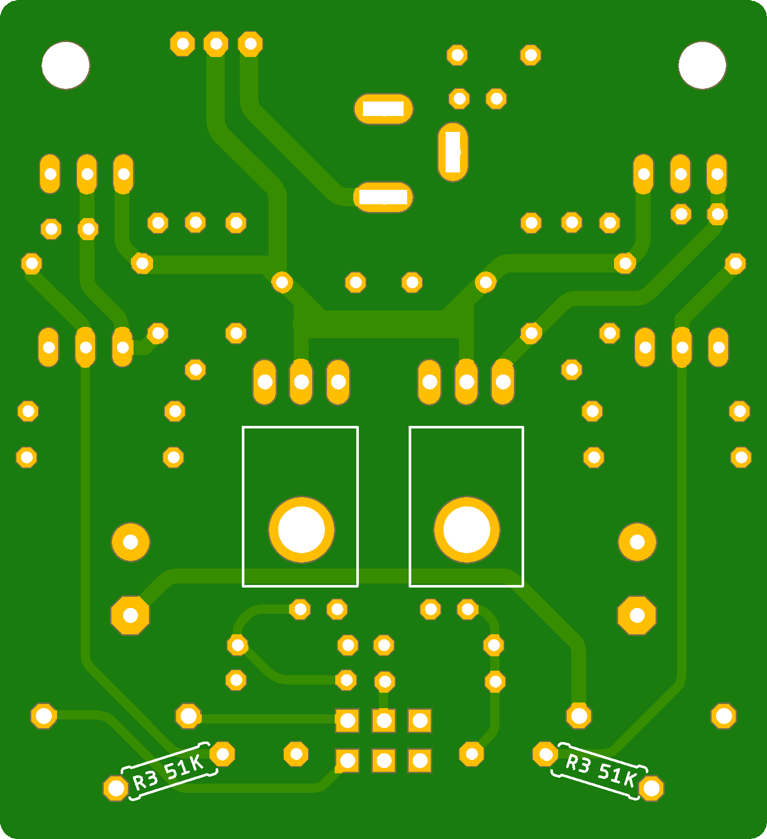

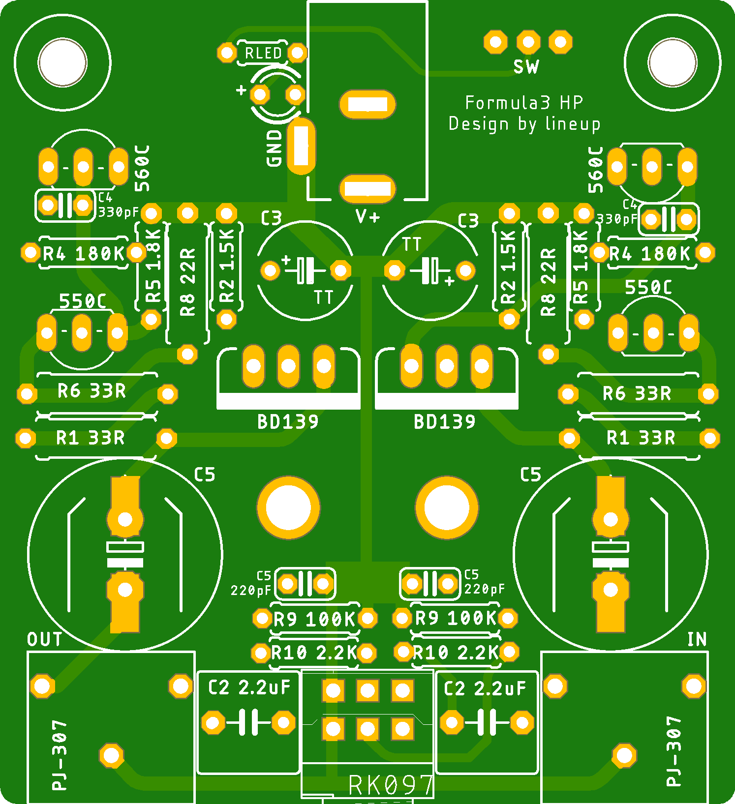

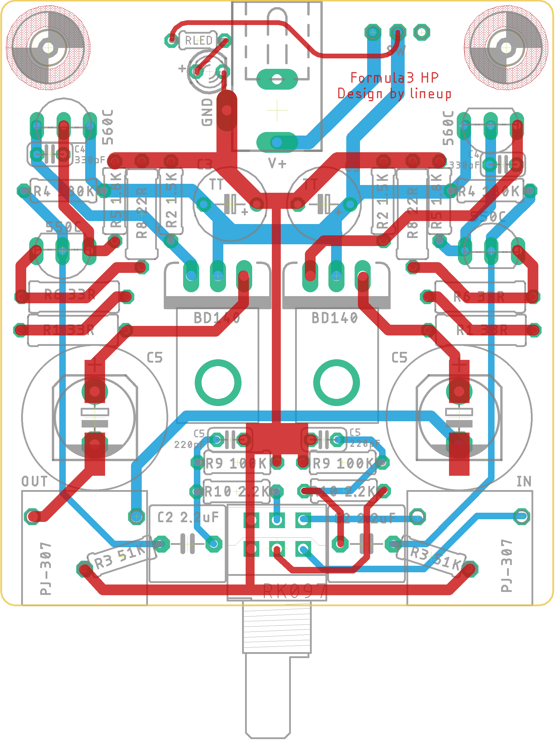

Hello all,
first of all thanks to Lineup for the design..
made a layout has dc and signal input and hp out jacks are on the board, measures 53x58 mm..
BD140s will be sandwiched between case and underside of the board so has screw holes..
since i'm not expert for pcb design, there may be something wrong..
can someone with sharp eyes take a look please?
thanks in advance.
thanks in advance.

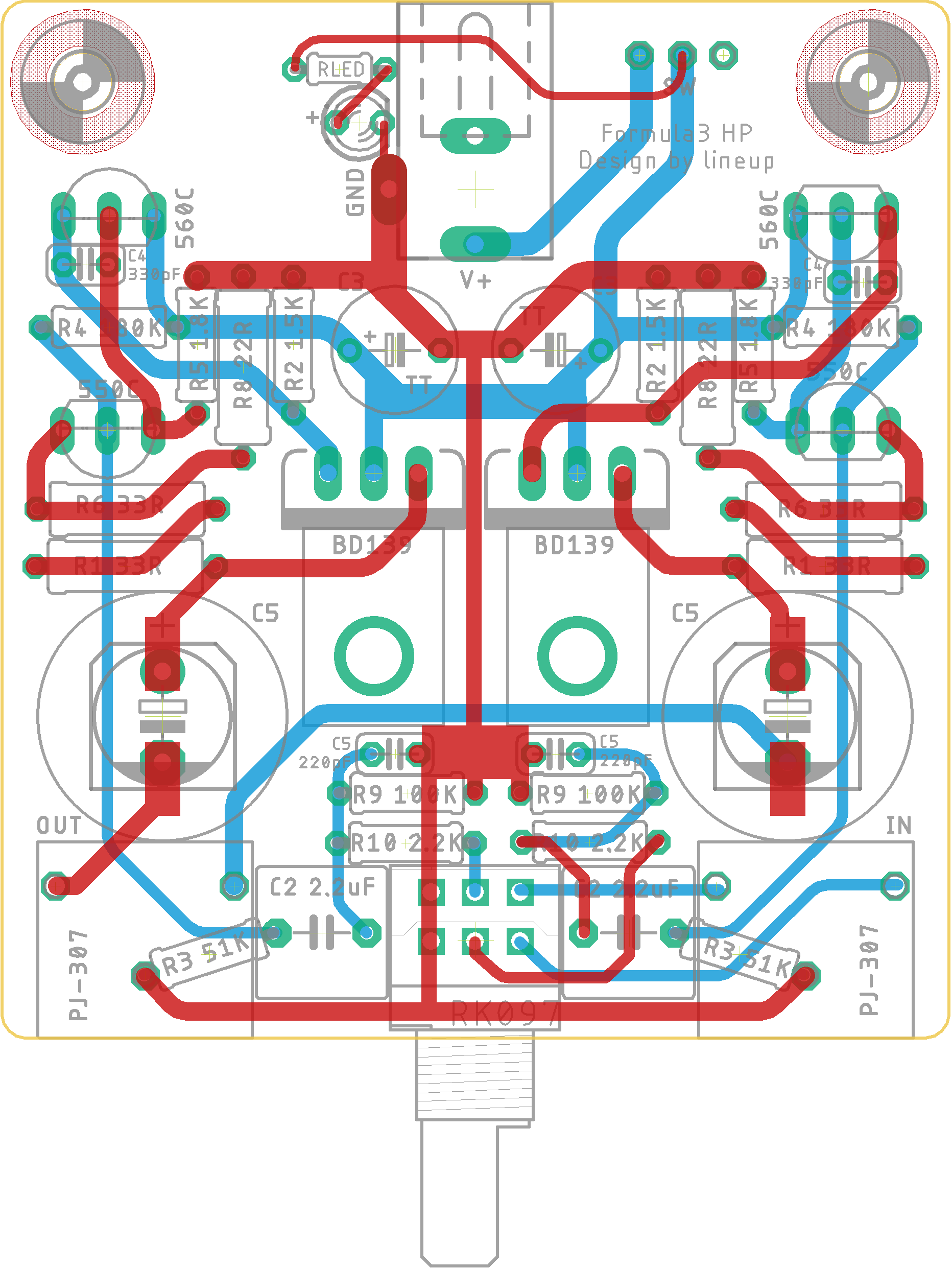

why did you use BD140?
the final transistor must be NPN, ie BD139.
C3 is backwards
marin cornel, avtech thanks a lot. C3 rotated.
bd140 from another pcb, exactly on same place..
forgot the change label..
Lots of your parts are pretty close with some even overlapping.
(C5/R9; C2 seems pretty much "sandwiched"; 560C/C3).
Just make sure these will fit in reality.
R3 is on the bottom? and uses the same through-holes as PJ307 and C2?
joensd, thank you very much.
actually this is just a quick layout to see if there is a mistake and
will be fine tuning for parts placements.
yes, R3 is on the bootom side, sharing footprints of C2 and PJ307.
