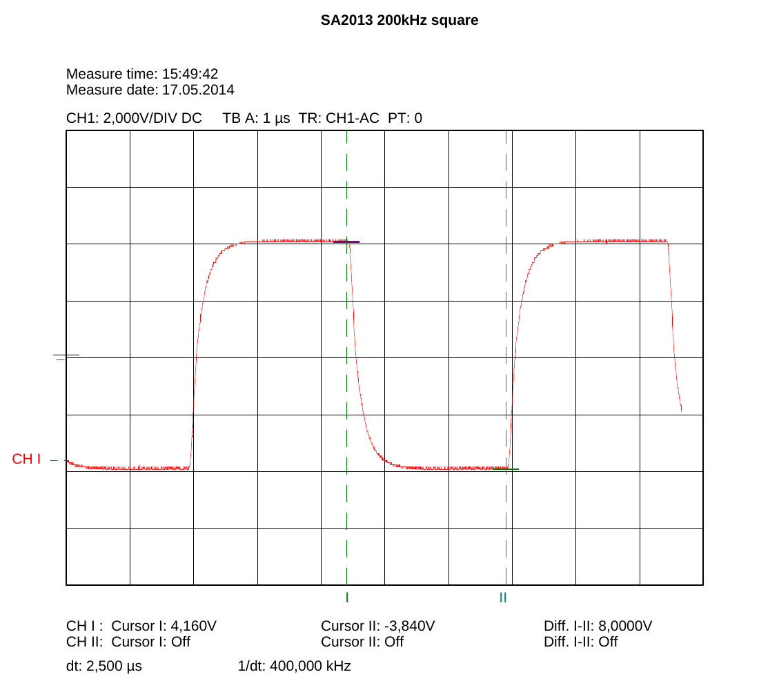

2stageEF high performance class AB power amp / 200W8R / 400W4R

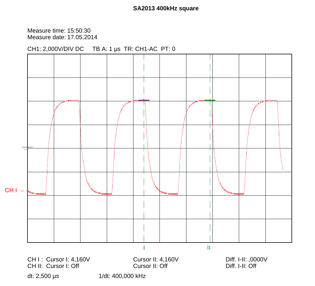

Why is the rise time of the sq wave faster on the leading edge during the rising sine wave (+) side and opposite on the down ward slope of the sine wave? Then it is slower on the leading edge during the falling of the sine wave (going neg - towards zero)?
Some of the square waves indicates maybe some slew limiting going on.... ? Can you test for the amps slew rate limites under loads??
THx-RNMarsh
All tests including the overload tests and overload details where made with load 8R in series with output inductor 0.8µH || 10R. Zobel 100n/10R has been removed.
To which picture do you refer?

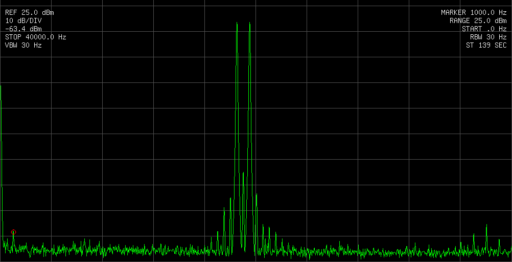

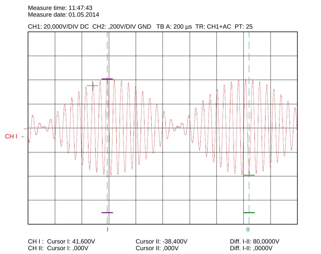

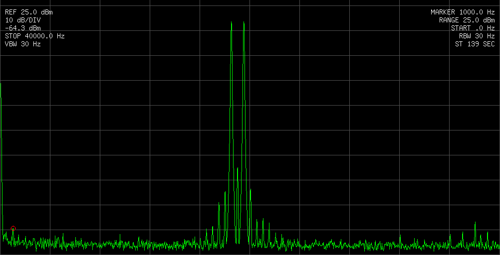

IMD measurements part 1
Today I have generated a new csv file for my arbitrary generator:
18.5/19.5kHz imd test. (If you are owner of HMF2525 or similar device see attached file "sinus_imd_test_2ms.zip")
Measured SA2013 using TMC 56p/680p/470R @ 8R resistive load @ 80V pk2pk.
For reference I have added a sweep of the arbitrary generators output terminated with 75R using HP3585A.
Attached pictures:
  1. reference HMF2525 output 2700mv peak terminated at HP3585A using 75R input.
  2. SA3013 80Vpk2pk @ 8R resistive load
  3. osci screenshot

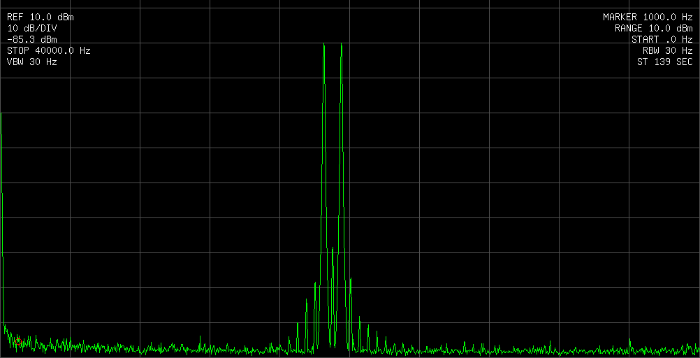

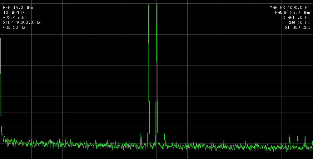

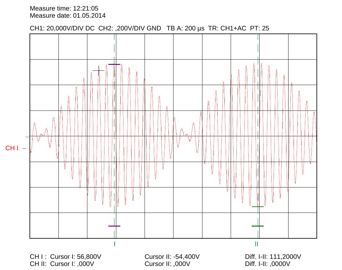

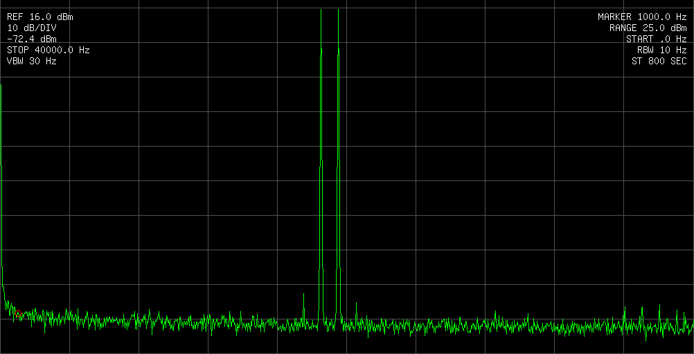

IMD measurements part 2
pictures:
  2. SA3013 112Vpk2pk @ 8R resistive load
  3. SA3013 112Vpk2pk @ 8R resistive load repeated
  4. osci screenshot
... maybe an expert can help here to calculate imd values as I do not have the math knowledge... :worship:
... or is the imd figure simply too bad so it would be better to avoid building an amplifier using this circuit?😱
For a 19 kHz + 20 kHz two-tone IMD test, the "IMD value" is defined as the ratio of the amplitude of the 1 kHz tone to the amplitude of the high-frequency tones.
Taking image 2 from your post #842 as an example, it looks like the 1 kHz tone is about 95 dB down from the amplitude of the two high-frequency tones, expressed as a percentage this is about 0.0018%.
A couple of good references for audio measurements and definitions are:
Audio Measurement Handbook, available here:
AP High Performance Audio Analyzer & Audio Test Instruments : Home
and "Audio Specifications" from Rane Audio, available here:
http://www.rane.com/pdf/ranenotes/Audio_Specifications.pdf
Think it's about 85 db difference. But the reference is also about 85 to 86 db. Clearly my measurement limits here. So I can only say imd is better as 85 db?
Doh! So it is. Obviously couldn't count this morning!
Thx so much! "rane" document is really good. 🙂
Unfortunately "AP" needs an account to download it ...
You're welcome. I must be "logged-in" at AP without realising. You can register for an account for free (click "Create an Account" in the vertical list to the left).

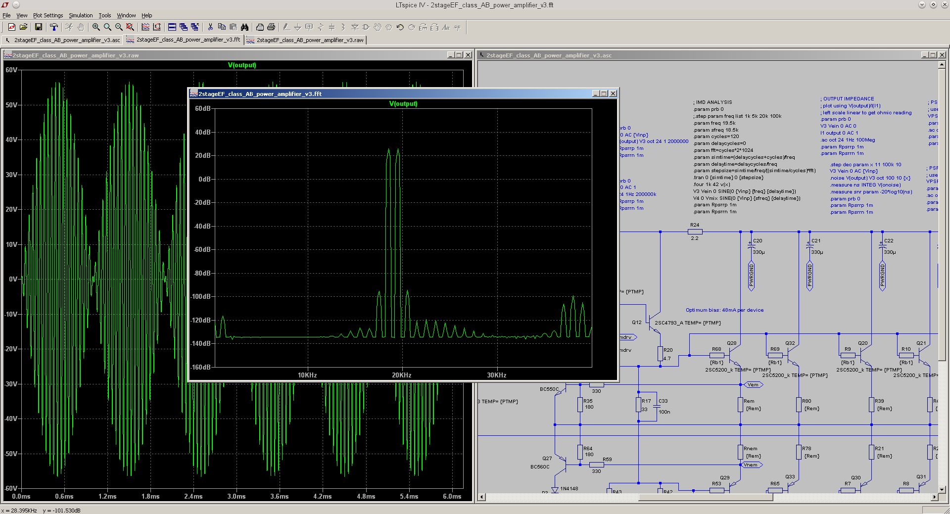

... and the imd simulation for 112V pk2pk ...

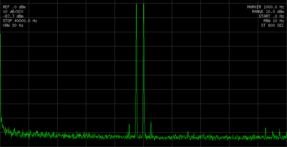

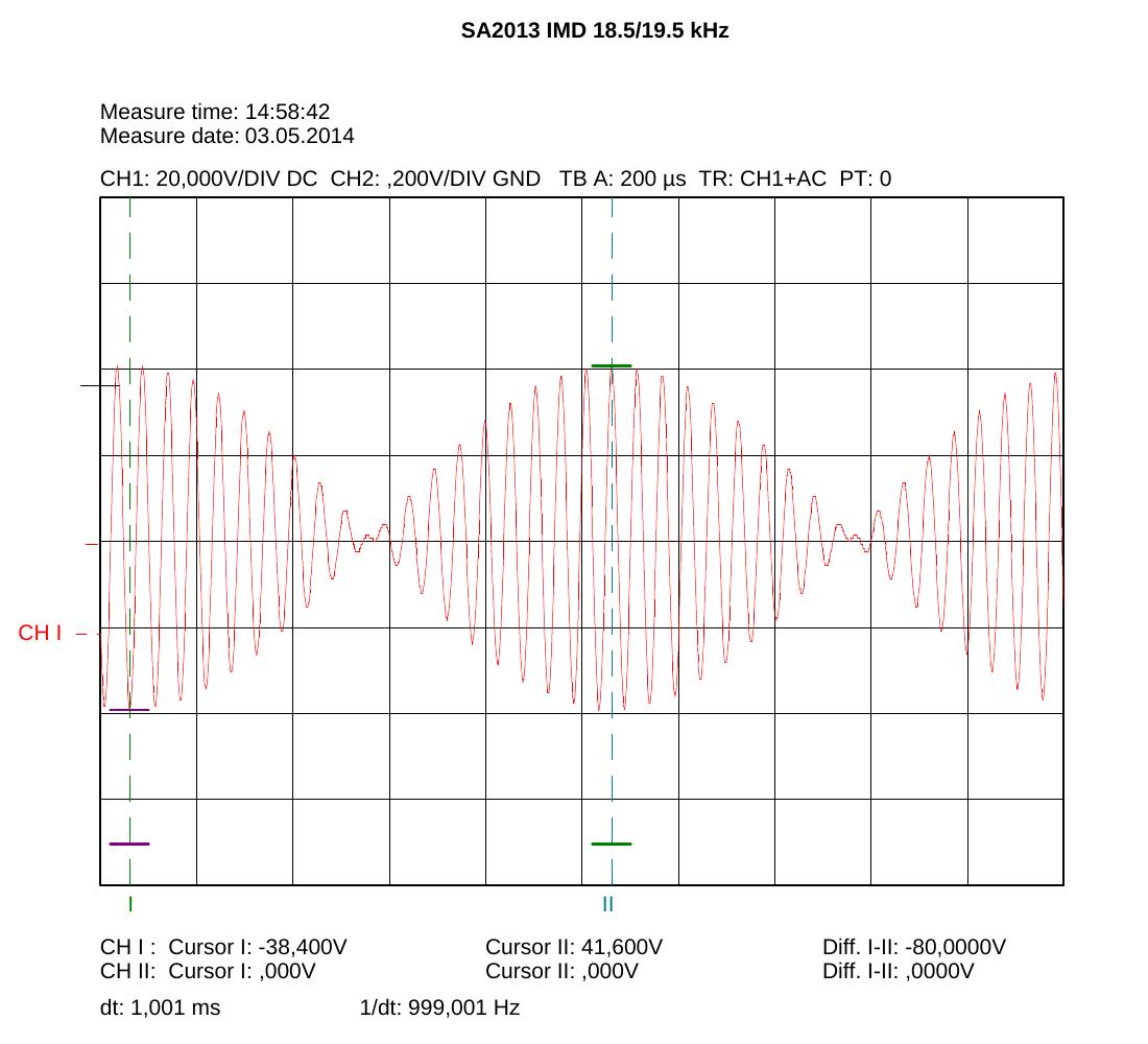

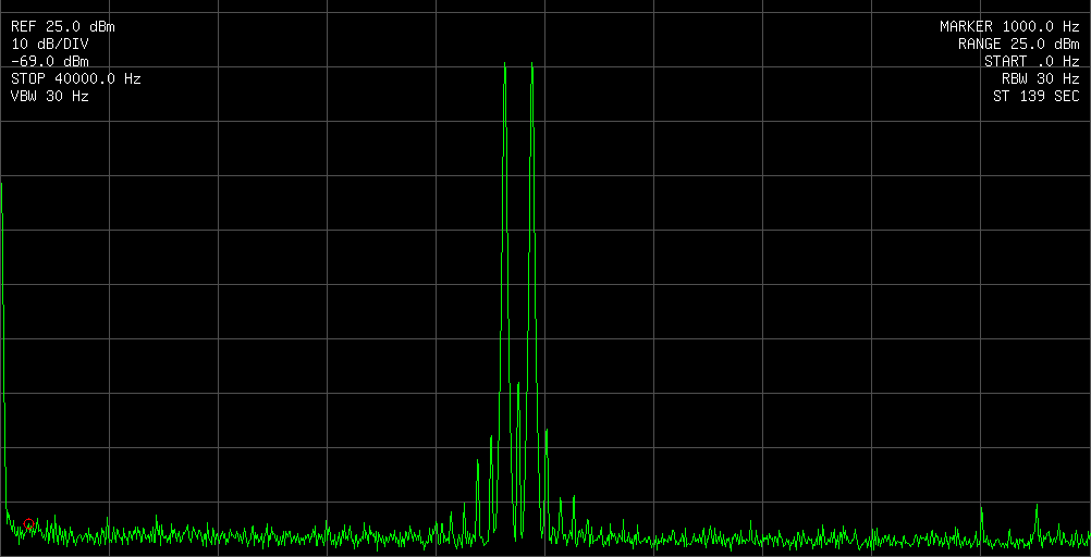

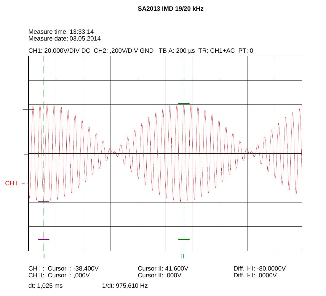

Redone: IMD measurements using 19/20kHz
as you clearly have seen (but not reported) the imd 18.5/19.5kHz input/output graphics have had a -60db 19kHz artefact. This was caused by a firmware error during import of the csv values. The firmware has been correct by hameg a view days ago and after upgrade the input/output pictures now look as it should:
  2. SA3013 80Vpk2pk @ 8R resistive load (~ 100W)
  3. osci screenshot
The HMF2525 and the output of SA2013 have nearly the same -88db 1kHz referenced to the level of 19/20kHz.
SA2013 adds virtually no extra imd in comparison to the input.😉
A reference test using an Asus Xonar D1 and ARTA
  • HMF2525 2700mv output/2k imd: -91,45 db
  • SA3013 80Vpk2pk imd: -90 db
These are my measurement limits as the input signal isn't good enough.

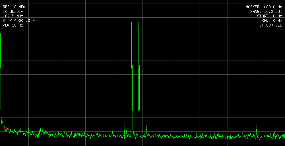

Redone: IMD measurements using 19/20kHz part 2
... and here are the 18.5/19.5 kHz tests redone:
  3. osci screenshot
Attached both csv files for uploading directly to HMF2525 (resolution 32768 points) and the simulation files to produce them. Also included 2 perl scripts to create measure scripts for ltspice and convert the output to csv.
Have fun!
Br, Toni
  3. osci screenshot

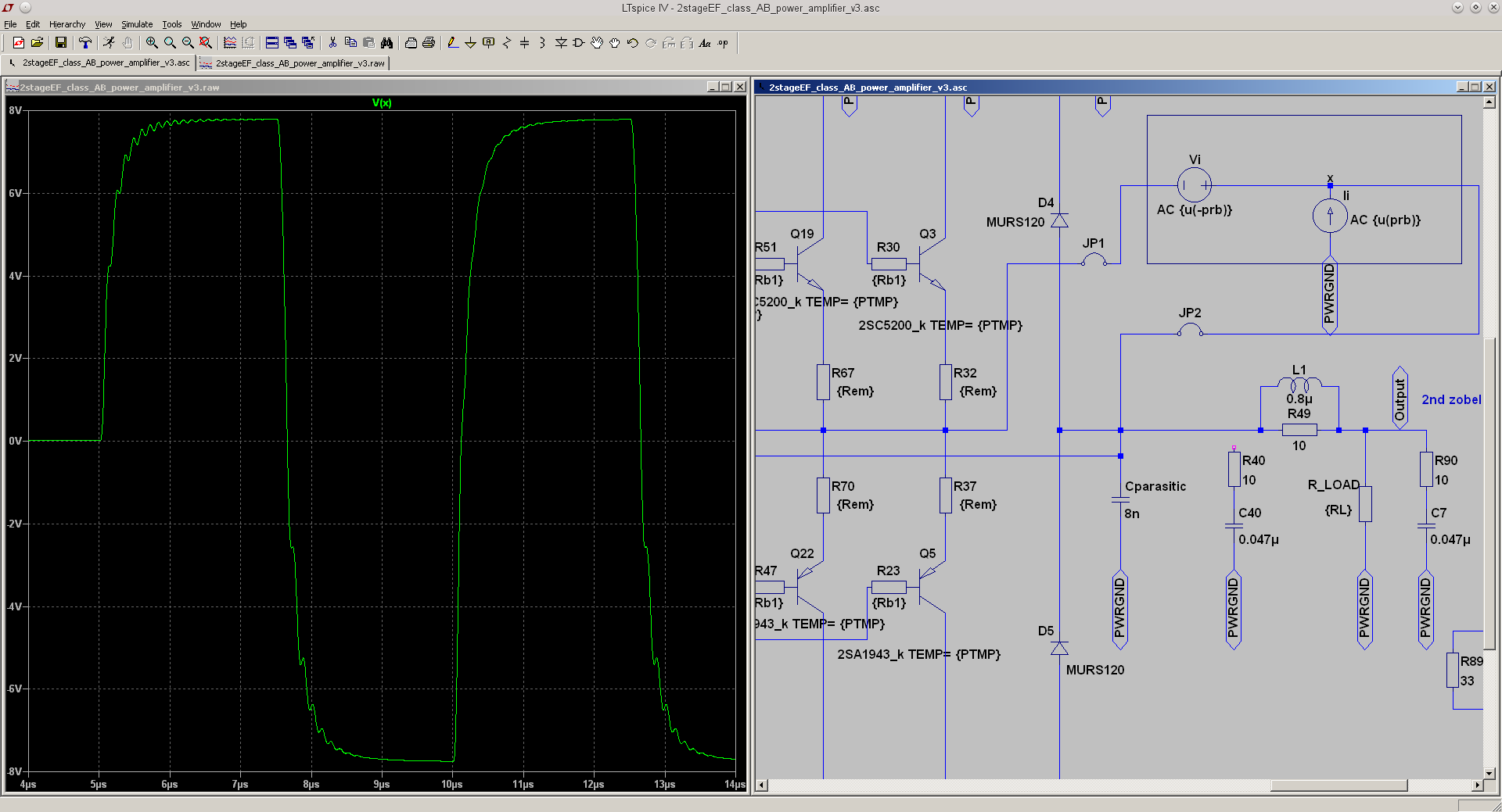

Small signal square wave tests OR why a zobel is always needed
During small signal measurements without zobel I saw an interesting osci screenshot and now I know why:
Again simulated my amplifier in LTSpice with removed Zobel and added 8nF parasitic capacitance on output before inductor: the attached ltspice screenshot exactly represents real life seen on hameg osci screen ... 😉
... took my Peaktech 2165, set it to capacitance measurement using 1kHz test signal, removed input/vas stage and all cables from ampifier and measured between output and ground: 8,4nF 😛
Maybe this measurement method is not ok and the value is per accident the same as the simulation ...
The oscillation frequency of the seen "wiggles" in real life (~ 9 MHz) is nearly the simulated one (~ 8.5 MHz)
8nF parasitic capacitance seems to be normal for those many output BJT's mounted on a big heatsink with doublesided pcb using a groundplane
Need always to be inserted in the simulation schematic to be more realistic?
What do you think?
