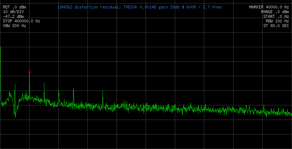

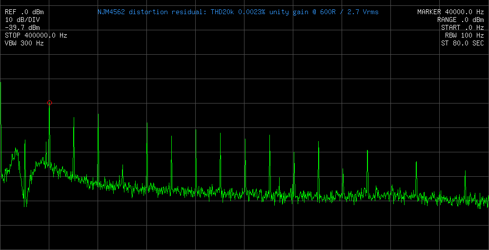

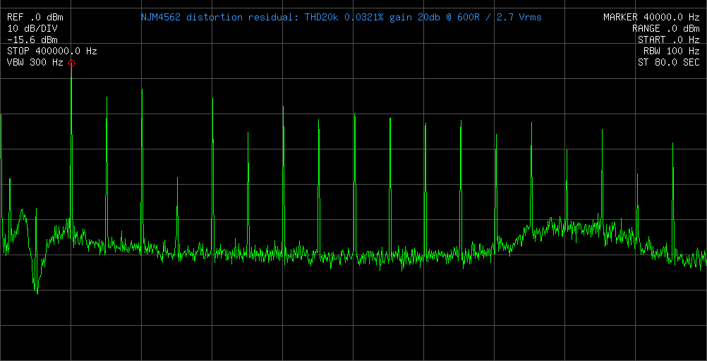

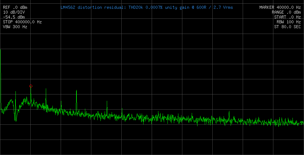

Today I got some pieces of JRCs NJM4562 (top of chip: 4562D / JRC / G001B) to compare with LM4562.
Power supply +/- 17V
Surprise: my test exemplar of NJM4562 seems to be unity gain stable.
Here are the THD20k results. Think NJM4562 is a good harmonic synthesizer compared to LM4562 or NE5532. 😉
BR, Toni

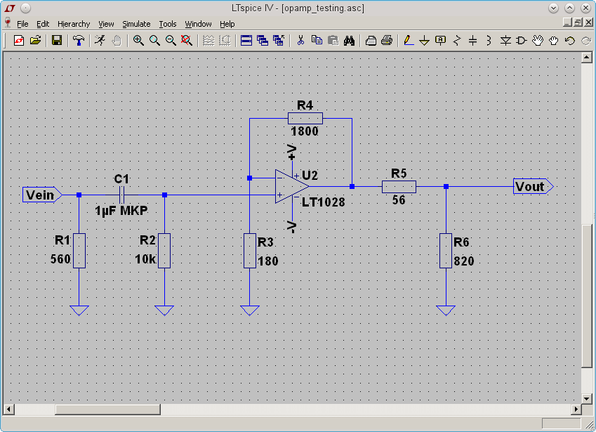

What was your test circuit?
Can you do some comparative tests with gain of 40dB with 1k8 & 18R2 feedback network? Perhaps at a higher O/P eg 10Vp (7Vrms) 600R

Attached test circuit. The photo of the lab test you can see some posts before.

R3 was set to 18R during test.

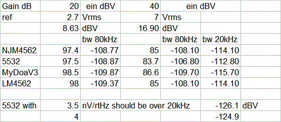

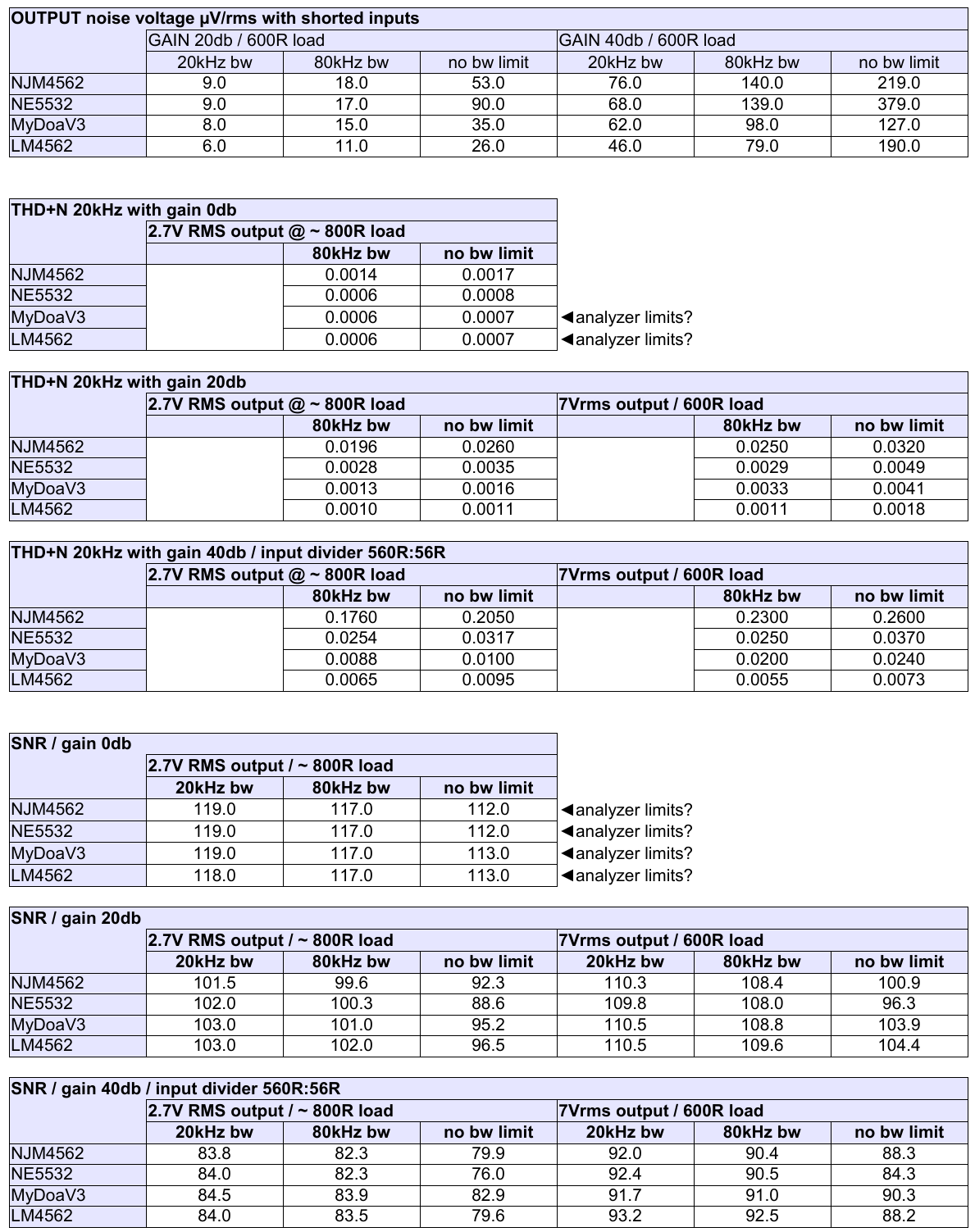

Opamp noise measurements compared:
Output level for gain 20db was 2.7Vrms
Output level for gain 40db was 7Vrms
All values have been averaged using a function from VP7723D to get a stable reading at my environment.
At unity gain and 2.7Vrms SNR measures 111/117 db (no bw limit/80kHz bw) for all 4 types of opamps with a tolerance of +/- 0.5db. Seems to be the analyzer limit.
BR, Toni

I don't quite understand how you are presenting these noise measurements.
Are the numbers with reference to the quoted 2.7Vrms & 7Vrms?
It's usual to do noise with shorted input or a specified source resistance and no signal. Shorted input would be good and easy for this test.
Then the noise would be at some absolute level, either dBV with reference to 1Vrms or dBu, wrt to 0.7746Vrms.
But MyDoaV3 looks very good in this company.

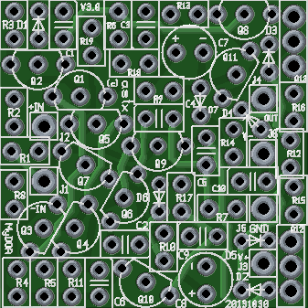

Attached the first variant of the MyDOA-V3 PCB - not really much spare space available for future extensions...
Br, Toni

Just a few calculations based on Toni's noise measurements. I normalise to the 'ref' voltages and subtract the gain.
Normalising to Ein gives 'similar' figures at 20dB & 40dB gain but I'm a bit suspicious that the 20dB gain figures are slightly better than the 40dB gain figures. It should be the other way round.
20kHz noise should be 6dB less than 80kHz noise provided hum/buzz is insignificant.
From Jurassic experience, I expect 5532 to have Ein within 2dB of this -124.9dBV spec in a properly designed and constructed LN amplifier. NOS Philips/Mullard 5532 (from the old Southampton plant) and lesser maker's 5534 about a dB worse.
Toni's results are more than 10dB worse so I'm still not sure what the VP7723D is showing. I don't think its short circuit noise. Perhaps it puts a resistor across the i/p when measuring noise.

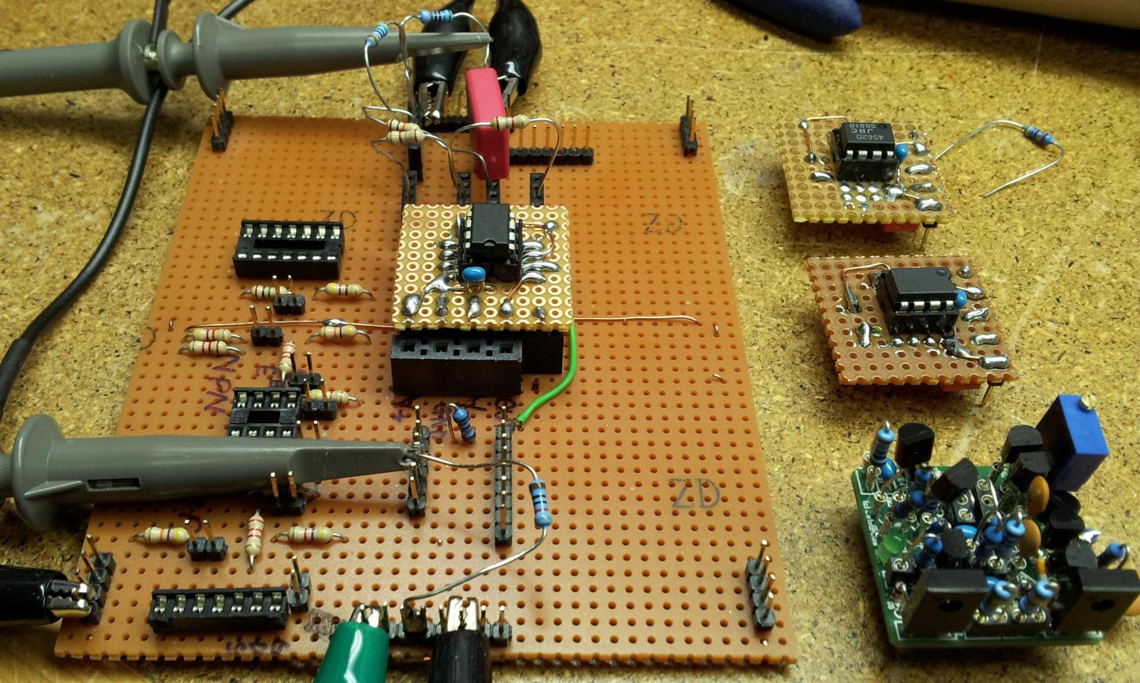

Toni, how do you decouple power rails in the circuit from #772?
What value electrolytics? Are they physically AT the OPA (within 2cm) ?
But I think the relative noise performance of the 4 devices with LoZ source is valid. NJM4562 & LM4562 about the same. MyDoaV3 slightly better and 5532 slightly worse.

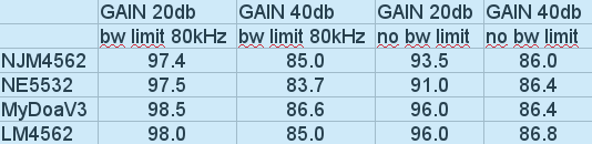

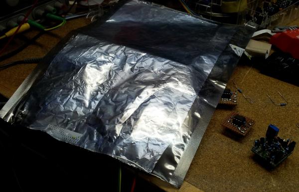

Dear Richard,
some more measurements for you to calculate. I have re-measured all devices using a simple EMI shield. (see attached pictures)
All other devices in the room have been switched off - even my PC
Decoupling under test socket:
Br, Toni

Dear Richard,
2 x electrolytics decoupling 22µ
2 x 0.1µF
Decoupling on test socket as near as possible to chip:2 x 0.1µF
2 x 0.1µ +/- rail to ground and one extra 0.1µ rail2rail.
EMI shield betters the SNR values significant. Maybe this data and your calculations come now closer to the datasheets.
Br, Toni

unable to upload the picture of the current pcb - diyaudio software problem?
No more disk space available?
