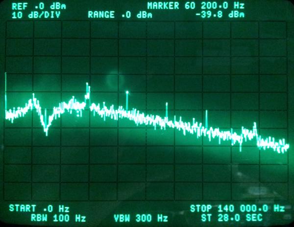

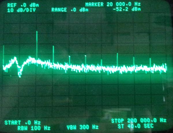

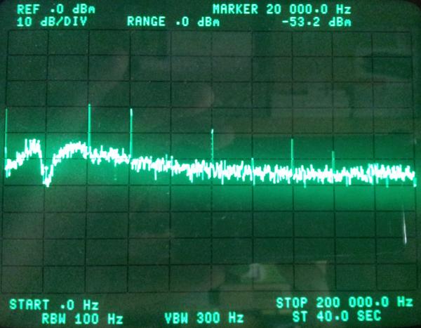

I am currently designing my own discrete opamp using BF245A.
Currently measured results at unity gain:
0.002% THD20k@2.7V RMS @ 600R (bw 80 kHz)
slewrate 20V/µs
( compared using my VP7723D: LM4562 gives me 0.001% THD20k@2.7V RMS @ 600R, bw 80 kHz)
To get a fealing of measurement quality I have attached spectrum analyser HP3583 screenshots from 20khz residual (2nd picture) and the analyser residual itself for comparison (1st picture).
Is it worth continue with this discrete opamp design?
BR, Toni

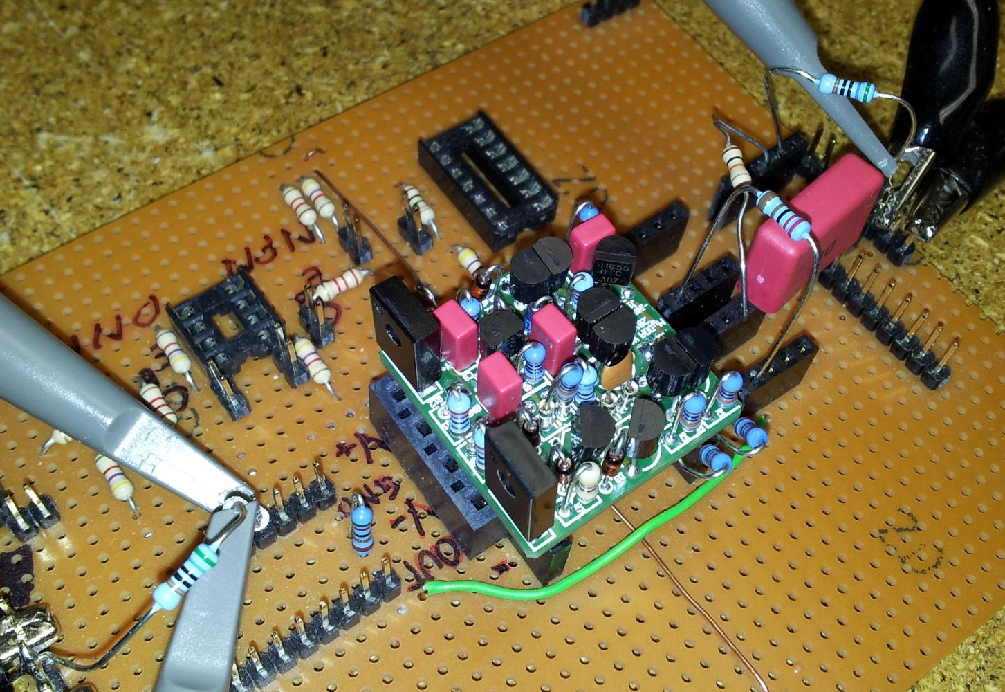

Hi Tony and others,
Looking at your pcb, seeing all those components standing up, it is just crying to be done in SMT. If certain parts only come in THT, have to stay with them, but many can be changed. How's your eye sight?

Dear Rick,
of course we could use SMT parts - but my eyes are some decades old and my fingers are moving sometimes so fast that I can't see the flight route of an SMT device.😀 I hate those small SMT devices.
So I decided to develop this opamp with standard discrete through hole parts.

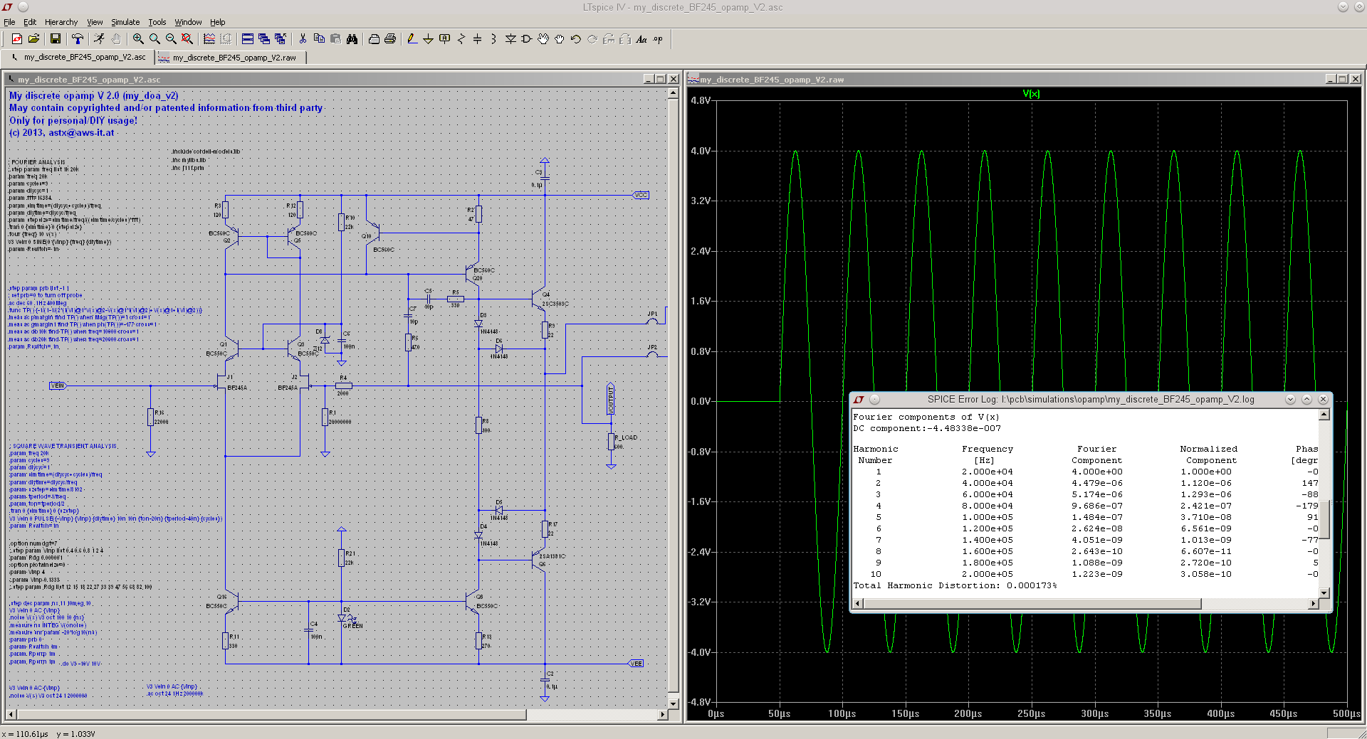

attached the schematic with real life compensation values. The simulated 0.002% THD20k@4Vp@600R is exactly the measured one!
Also the simulated and measured square wave figures are nearly exactly!
So our pole gurus are able to help here?
Use "mylibs.lib" from above asc files.
BR, Toni

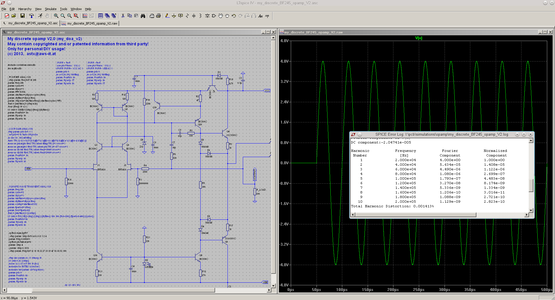

Now with a capacitance multiplier to better PSRR on positive supply: about 91dB at 1kHz and 90dB 20kHz (can be further bettered on increasing C1).
Optimized compensation - 0.001% THD20k@4Vpk@600R
Very small transient overshoot < 5%

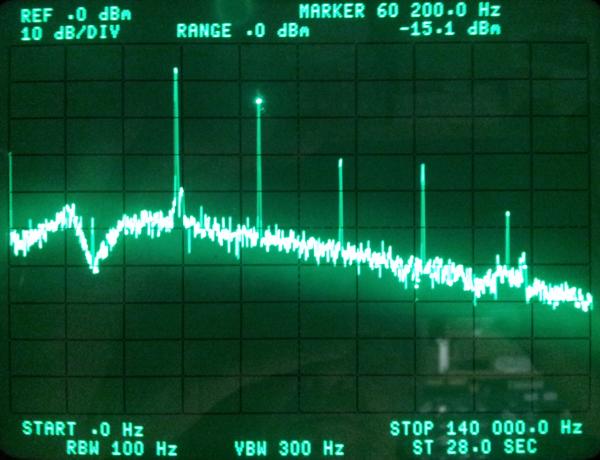

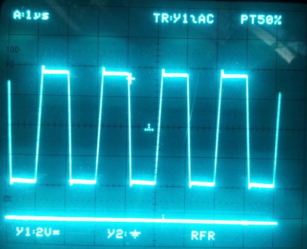

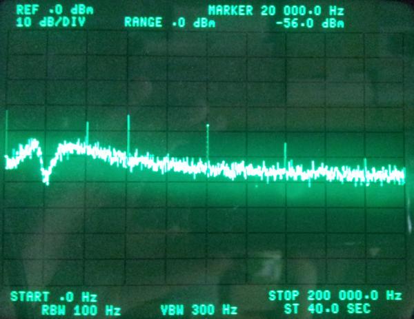

20kHz / unity gain / 4Vpk
From left to right:
From left to right:
- Analyser reference residual no bw limit
- My_DOA residual no bw limit
- LM4562 residual no bw limit
