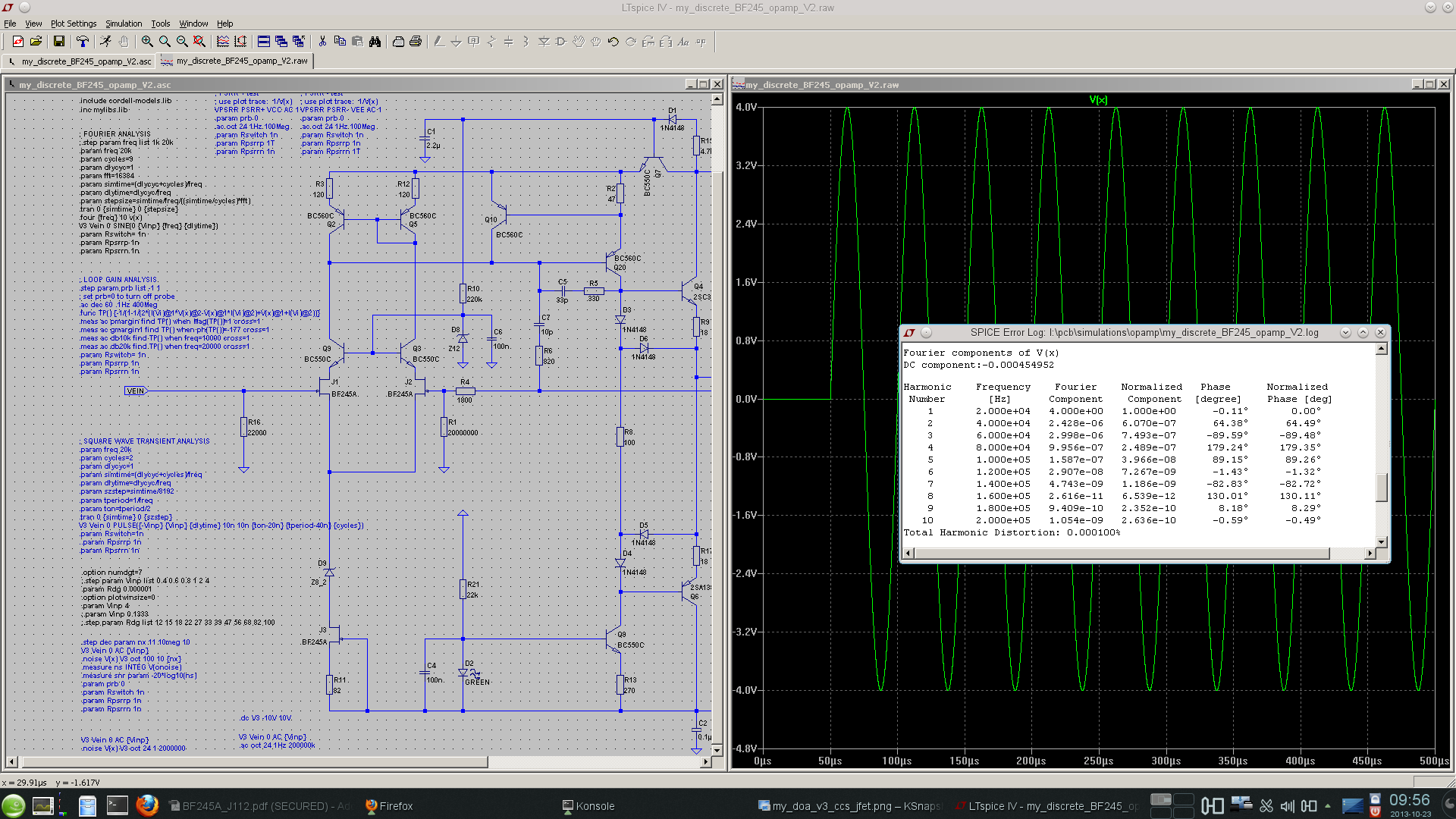

Why is the THD20k now 10 times better on using a BF245 also for CCS?
Is this a simulation error? Or does the "bad" CCS behaviour of the BF245 cancel out errors from the input JFET's?

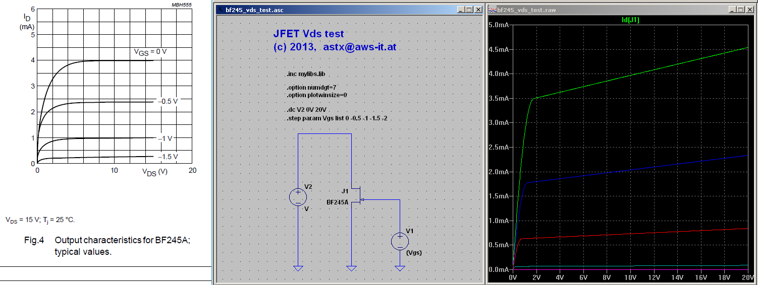

Maybe you have a hint how to check the jfet model?

Set up a simulation with the CCS as it is now, and sweep the drain voltage from 0 to Vdsmax. It should be similar to the Vds curves in the datasheet. My experience however is that no Jfet model in LTSpice has ever had realistic Vds curves. Yet, I've never heard anyone complain about it nearly as much as they complain about BJT and MFET models.
However, I've rarely had an LTP CCS contribute significantly to distortion. Even a resistor bootstrap can work here, especially since you're using a current mirror. So I see a very strong possibility that it's not the CCS that's the problem. Perhaps it is because you were sharing the same bias node for the input and VAS sources? IE cross-contamination?
Attached the BF245 Vds simulation - hope it's correctly done - looks similar with datasheet (especially compared to the compatible SMT part BF545 which is still available in mass production).
If I replace the BF245-CCS with e.g. J111 (using 1.2k) THD20k worsens to 0.0028% compared to BC550C CCS (0.0014%).

According to the datasheet the BF245 is actually much better than the model shows.

There is no interaction. If we duplicate R21/C4/D2 (schematic from post #741) and feed the LTP CCS there is no change in THD or gain or PM or GM....
Both sources are feed by R21, with no separation. This way they can interfere with each other.
But if we check the constant current stability we can see that the BJT based CCS is more exactly as the JFET CCS. So my question is: does the lower CCS quality of the BF245 CCS cancel out nonlinearities of the BF245 LTP or may this be only a simulation error?
Using the BF245 as CCS betters the THD20k to 0.0001% - 1ppm - so your answer confuses me a little bit ...

Hi guys,
Thanks Toni for helping me figure out how to test a jfet using ltspice. Took me a while to figure this rather simple thing out, as it was hard to read. Even had to get Bob C. PA design book out to go over a few things. I am so glad that Bob covered ltspice in his book. I asked Doug Self to do the same in his new PA book, I do not have it, but I believe that he did not cover ltspice like Bob has done = a shame. I am sure Bob is pleased that many of us are building on his examples.
So here is the .asc file that represents what you posted earlier testing the BF245A jfet.
OT: discrete opamp
You're welcome.

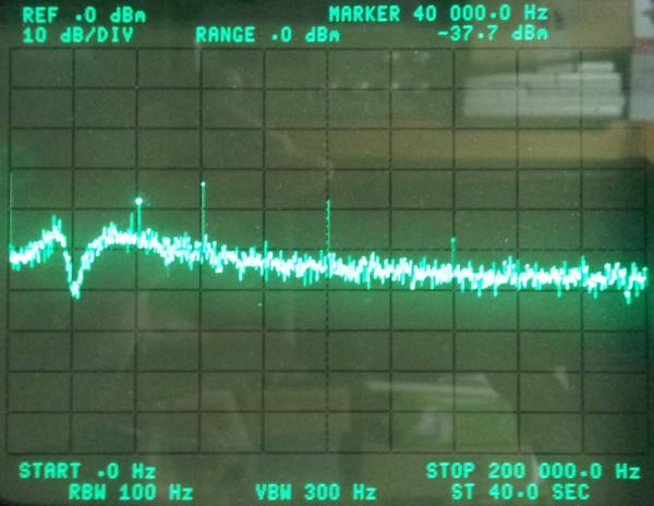

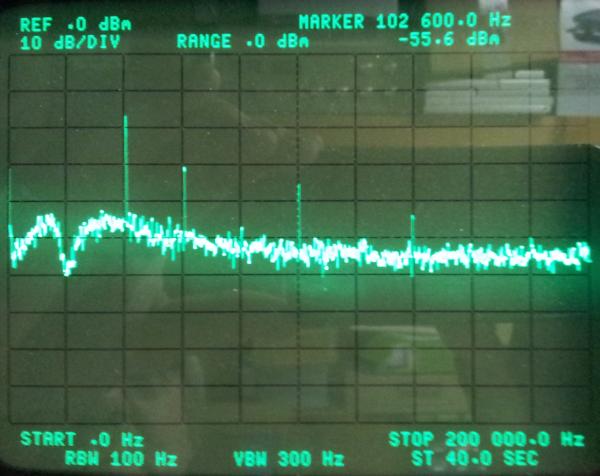

Using BF245A as CCS and first measurements: there is really some interesting effect on higher harmonics viewable. Have to analyse the spectrum the next days. Stay tuned. Going for a beer now! 😉
BR, Toni
BR, Toni

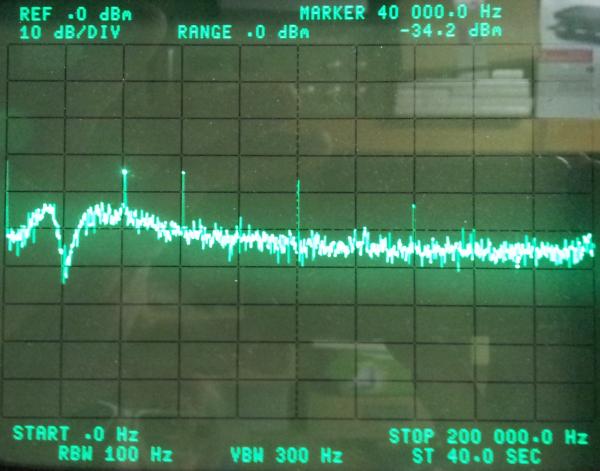

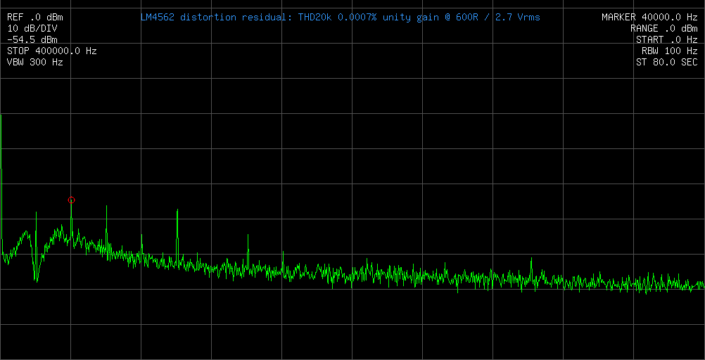

Attached the THD20k residual @ 4Vpk @600R spectrum (no bw limit) using a BF245A as CCS for the LTP. Indeed the harmonics have bettered compared to older spectrum pictures. The measured THD20k for my_doa_v2 was 0.0019% (bw 80kHz) - only a small decrease and far away from the simulated 0.0001%.
Something goes on here - maybe using same (matched) transistors for CCS and LTP cancels out some errors?
Spectrum pictures from left to right:
BR, Toni

- my_doa_v2 with BF245 as LTP-CCS
- LM4562
- VP7723 - analyser reference input directly to output.
BR, Toni

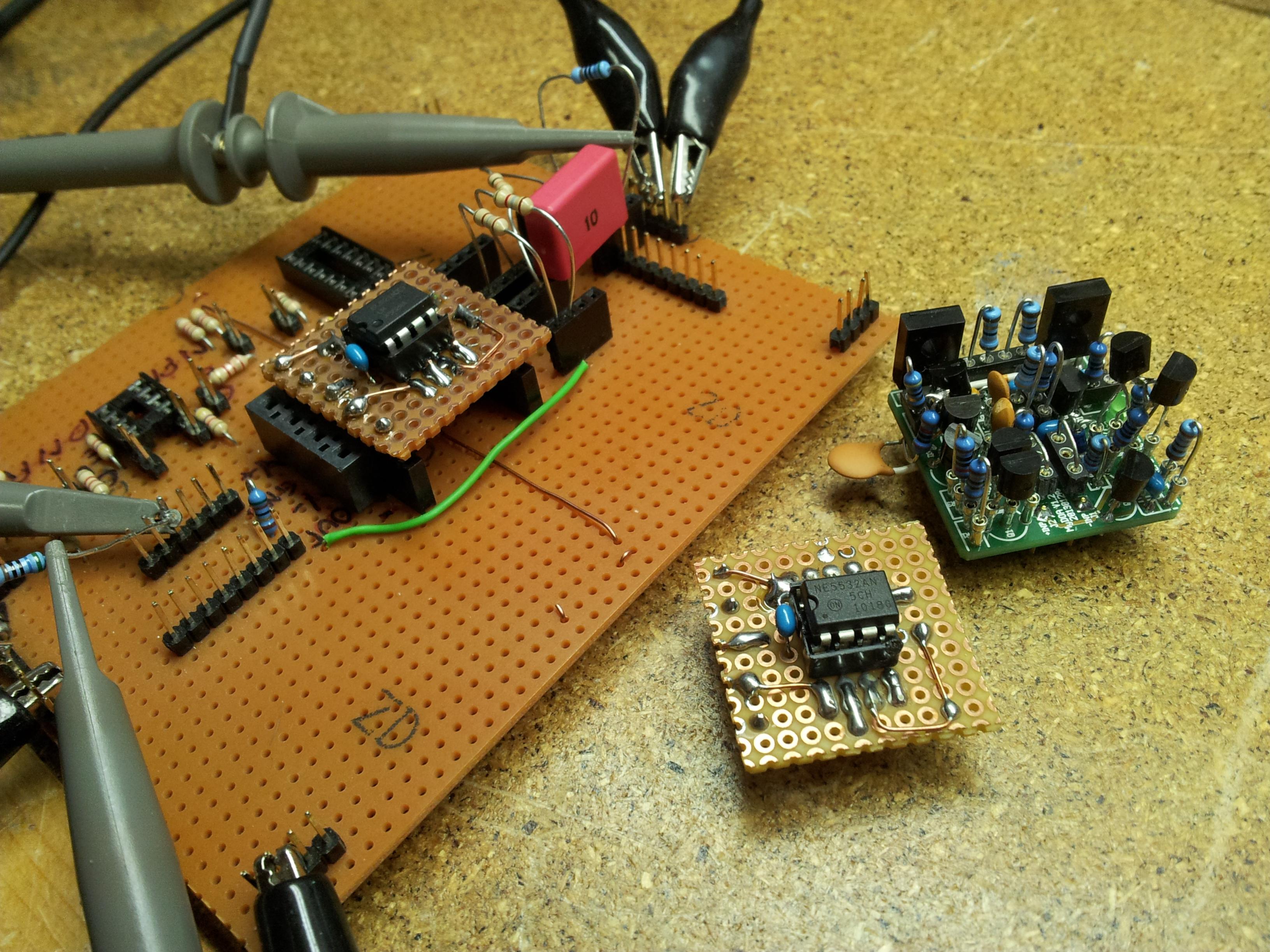

OT: discrete opamp

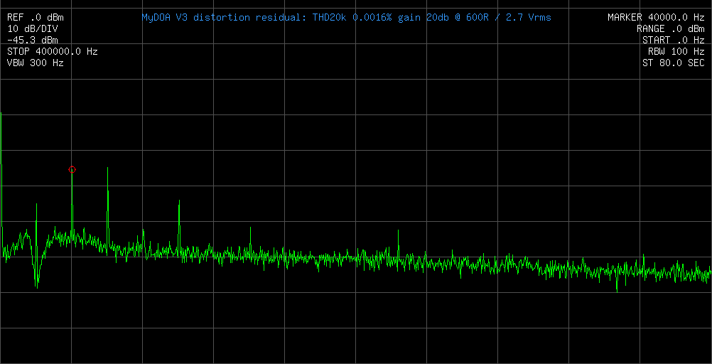

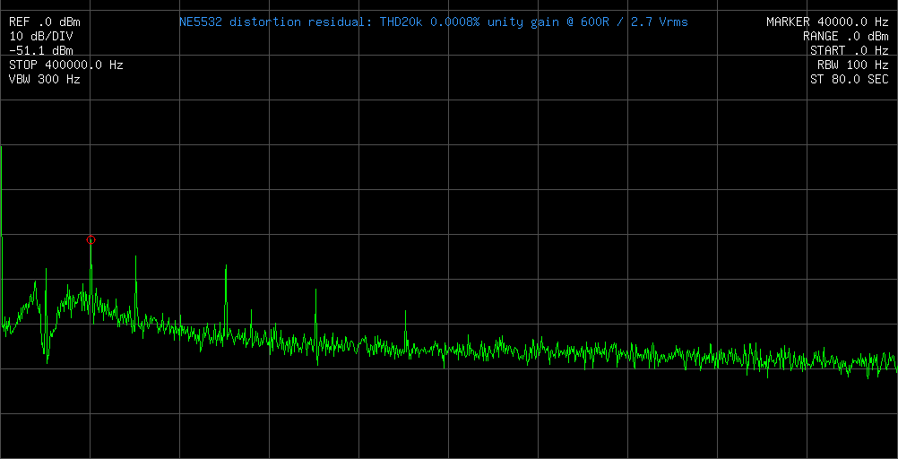

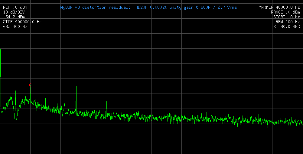

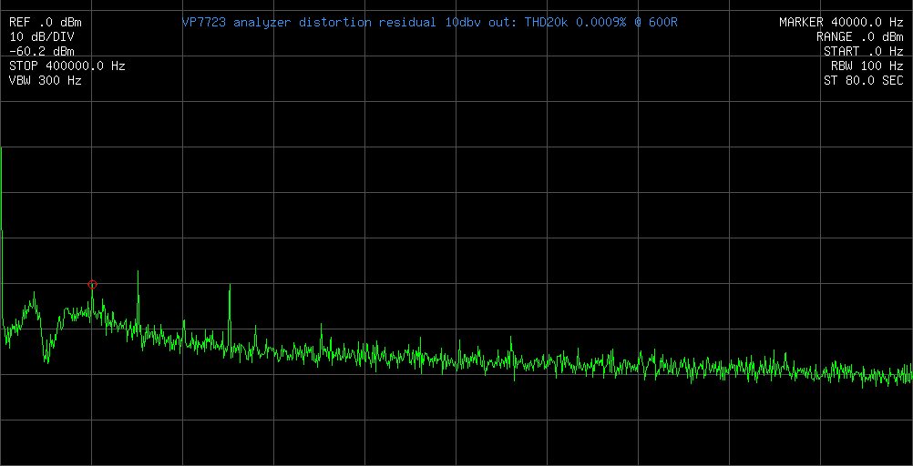

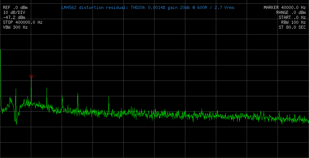

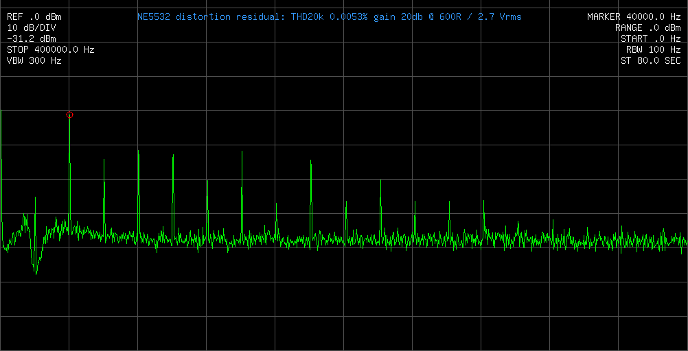

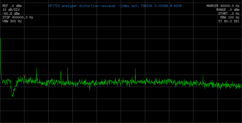

... have said I would not continue development on my_doa_v2 (LTP: BF245A, single VAS).
But attached you can find some test results of
Br, Toni
my_doa_v3 (LTP: BC550C, enhanced VAS)
If you think it is worth to upload the schematic too - let me know. (answering, votes are welcome) 😉
Br, Toni
