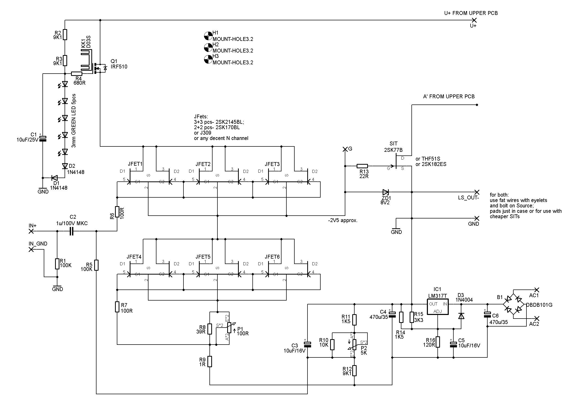

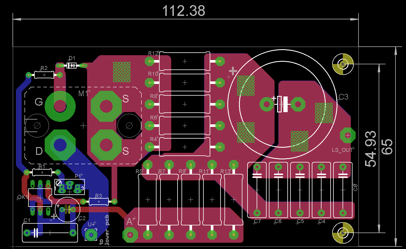

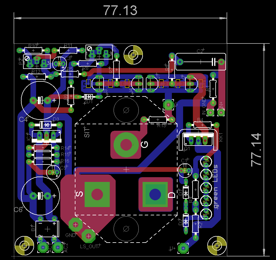

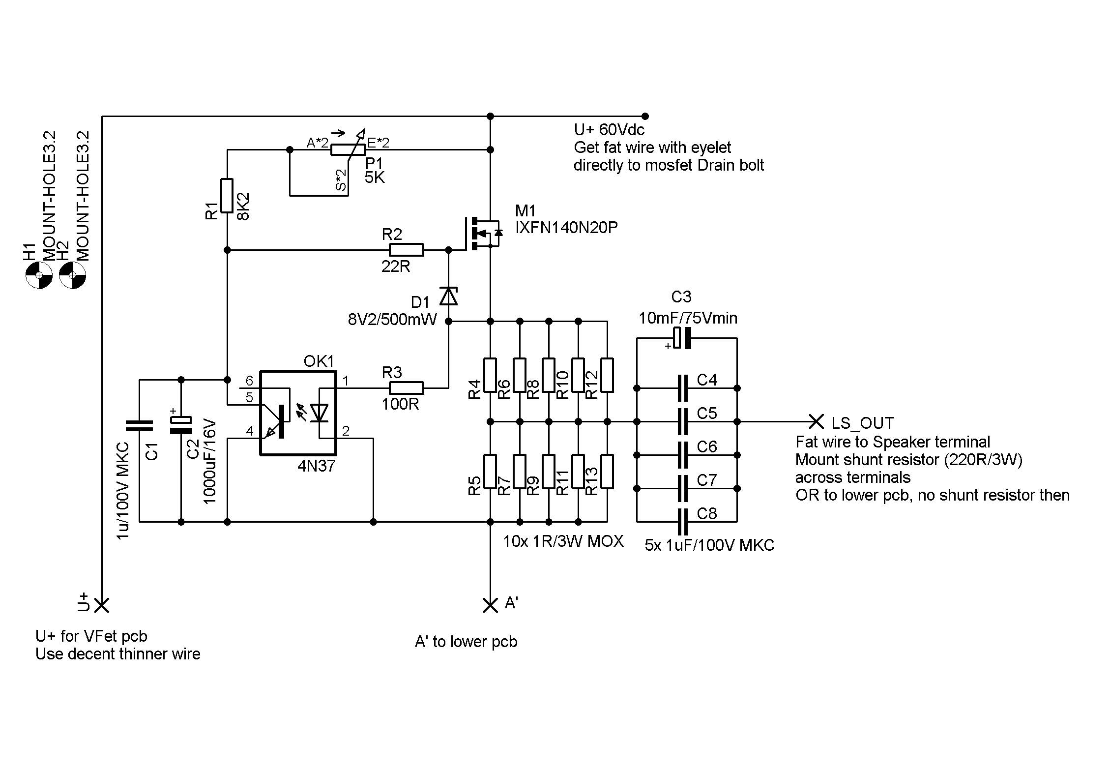

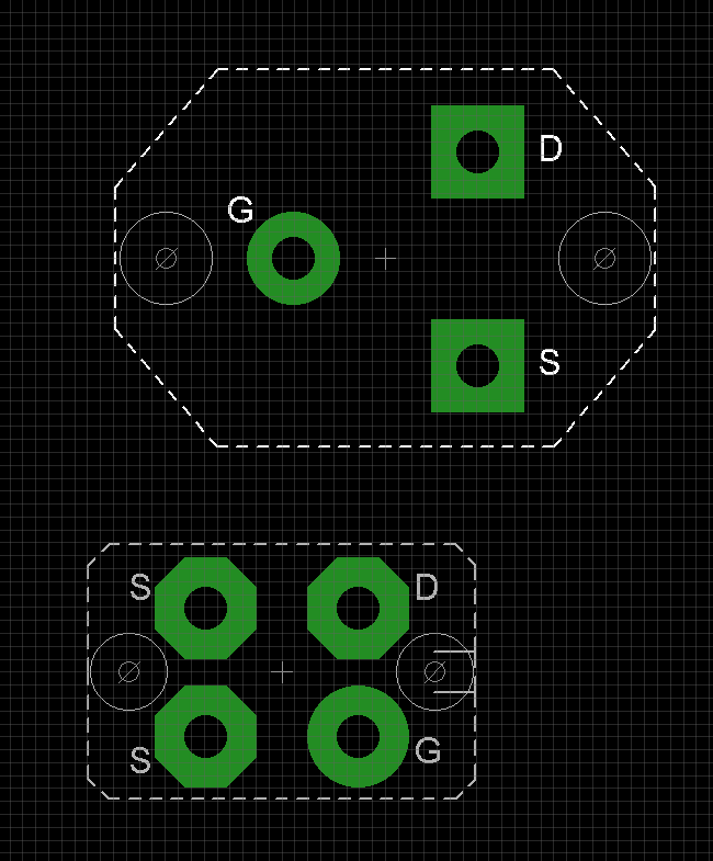

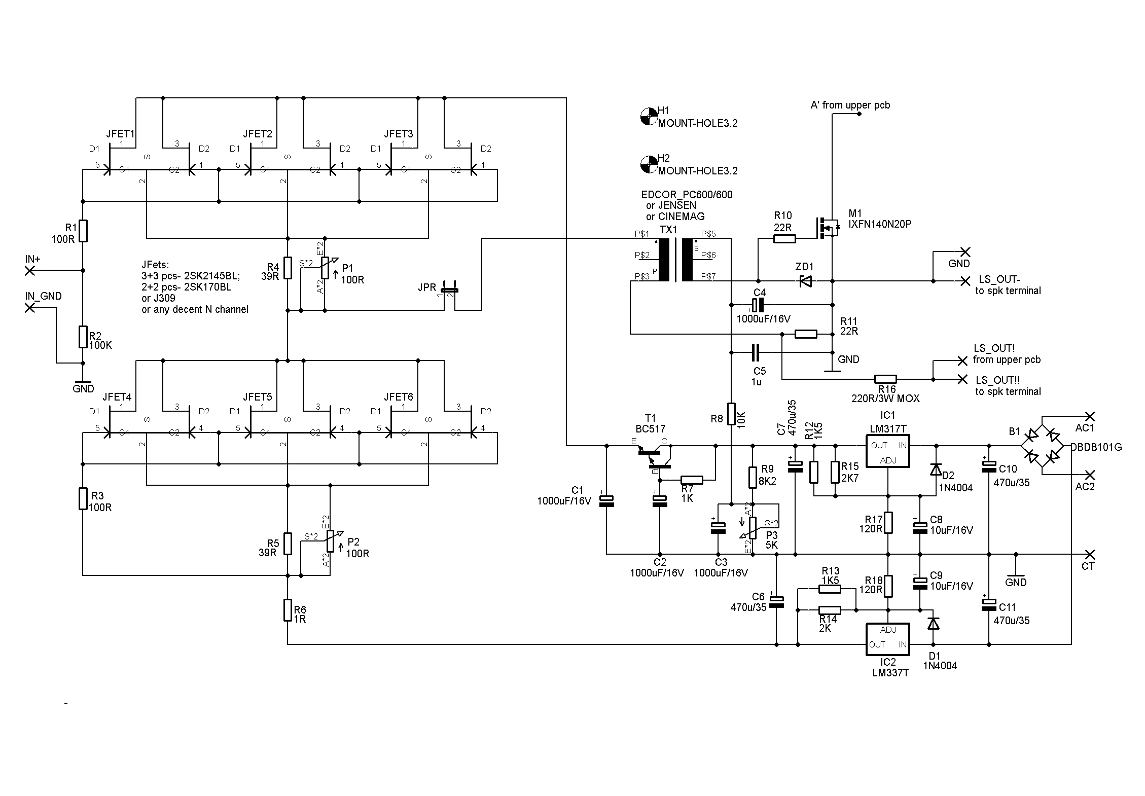

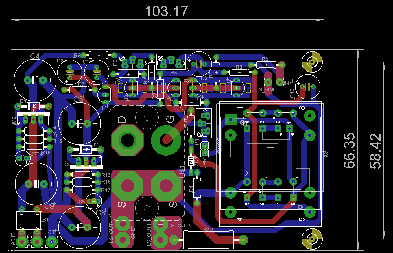

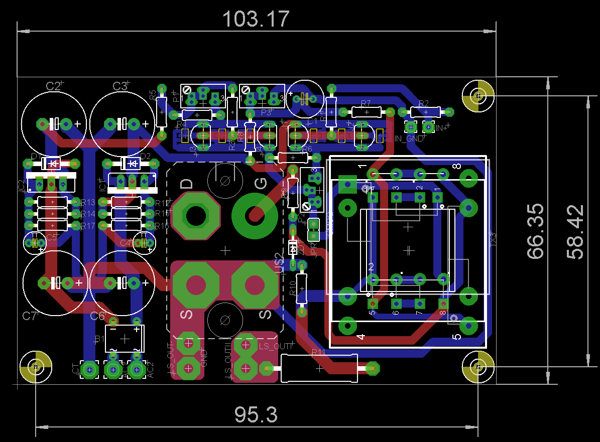

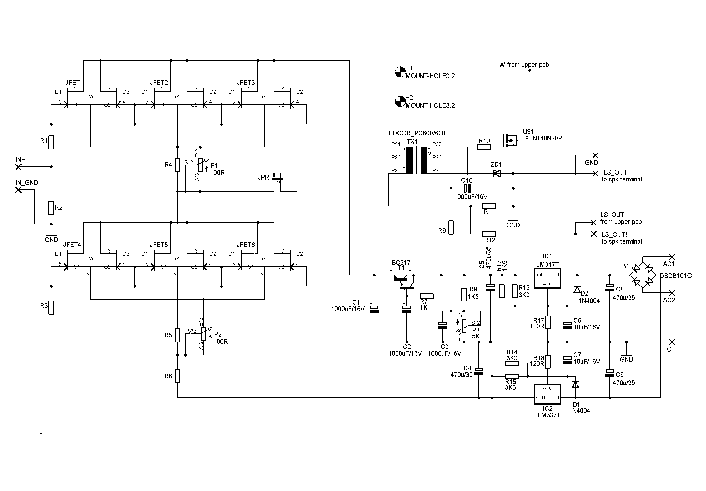

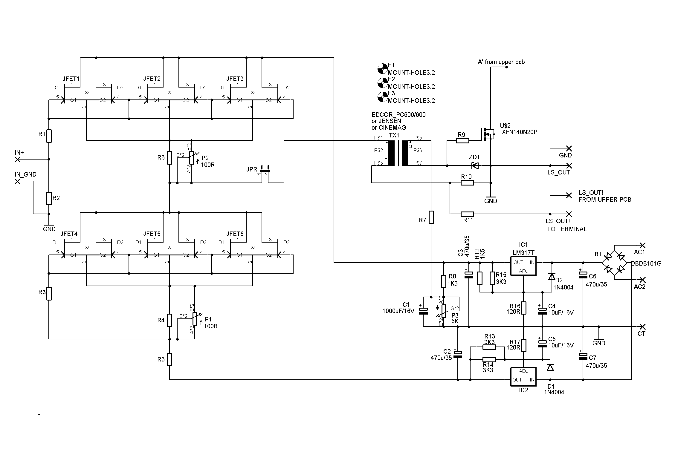

so,recapitulation of files still being just in PC realm
values pretty much sorted, wire-pad names also sort of sorted
upper pcb valid for all amp iterations
lower SIT pcb valid for 2SK77B,THF51S,2SK182ES ; LM317 and IRF cascode voltages adjusted to expected Ugs of 2SK77B , little tweaking of same desirable to maintain aroundish 9V across each input buffer half
lower mos puck pcb valid for Poor Men iteration
