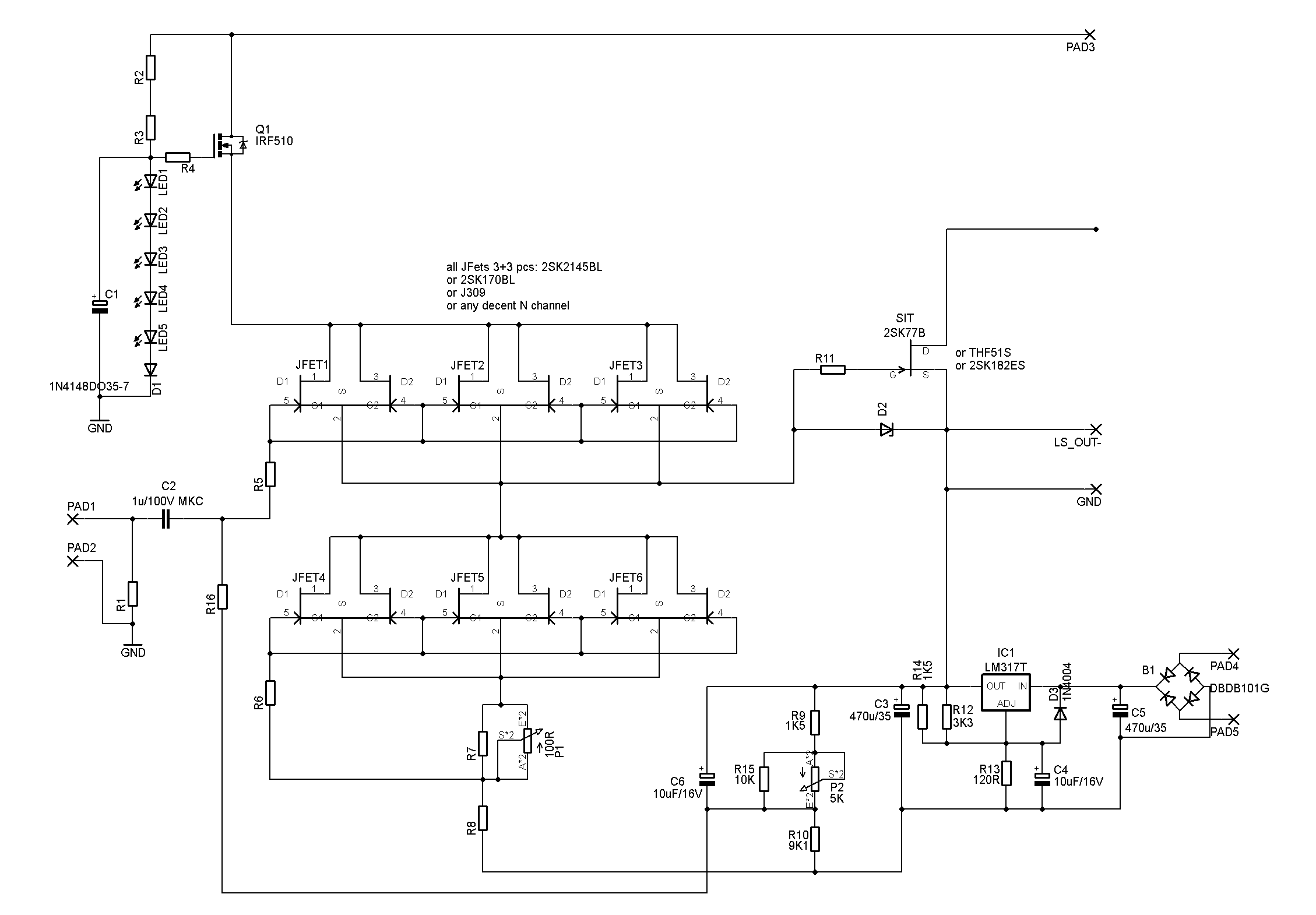

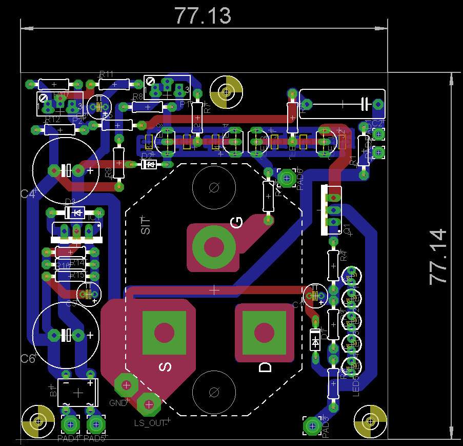

something as this ...... :clown:
(for Poor Men iteration , obviously different schm/pcb needed)
