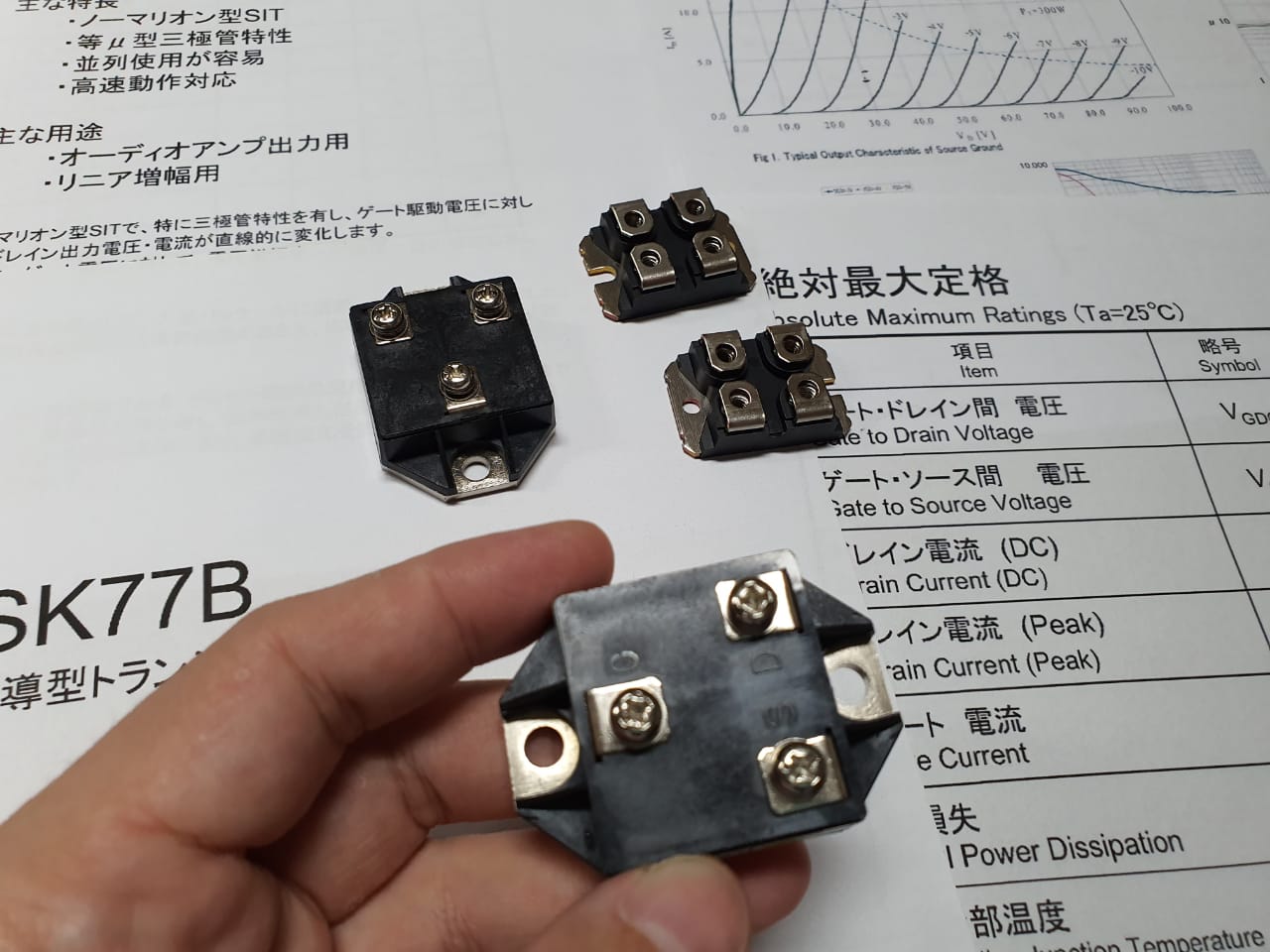

I got a pair of 2sk77b. Wonder which design is best for it?

Anthony , care to share that paper (datasheet) , which is on photo?

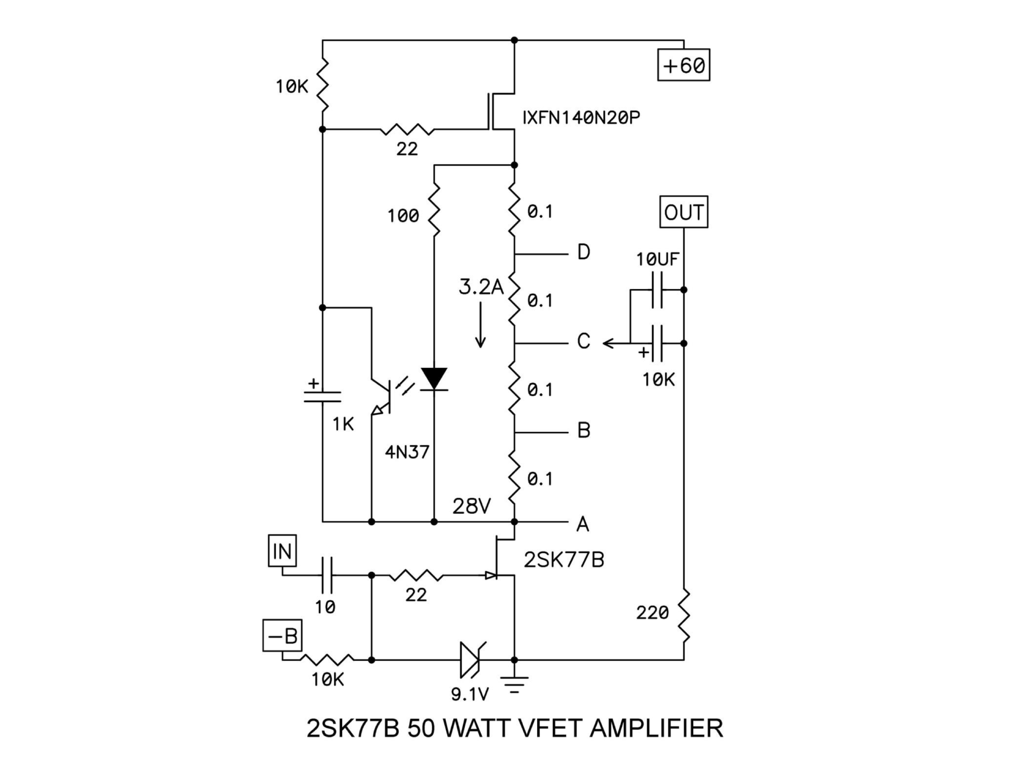

It's point to point. See 50w Single-Ended BAF2015 Schade Enabled (post #857) and 50w Single-Ended BAF2015 Schade Enabled (post #905).

well , in this moment it seems it'll be either slightly Babelfished iteration of what you did show in BAF 2015 lecture ( with input buffer implemented in biasing, servo - still thinking about) , or it'll be some big bstrd with inductive load
