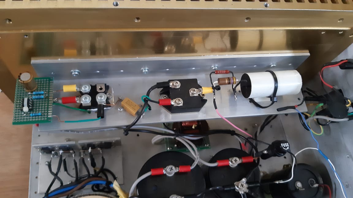

looking nice , except a fact that L bracket positioning is exactly opposite of best one , which is approx. 1/3 of heatsink height, starting from bottom
though , if heatsink is oversized ...... and that one looks as good enough for 180W of heat , it really doesn't matter that much

How much VA power is Your toroidal transformer ?
That aluminum bracket represents a lot of thermal resistance. It might be better to mount those devices flat on the heatsink .

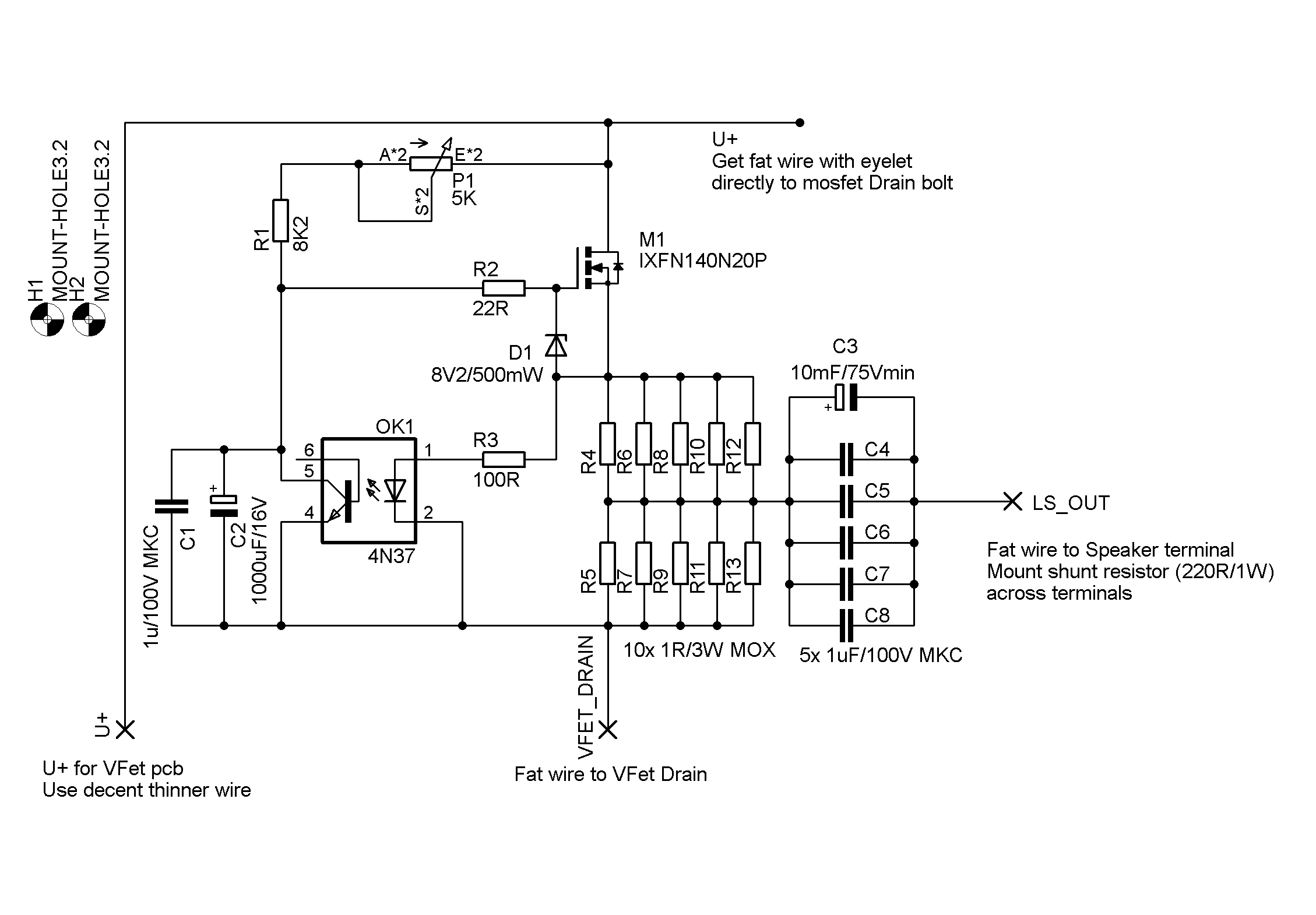

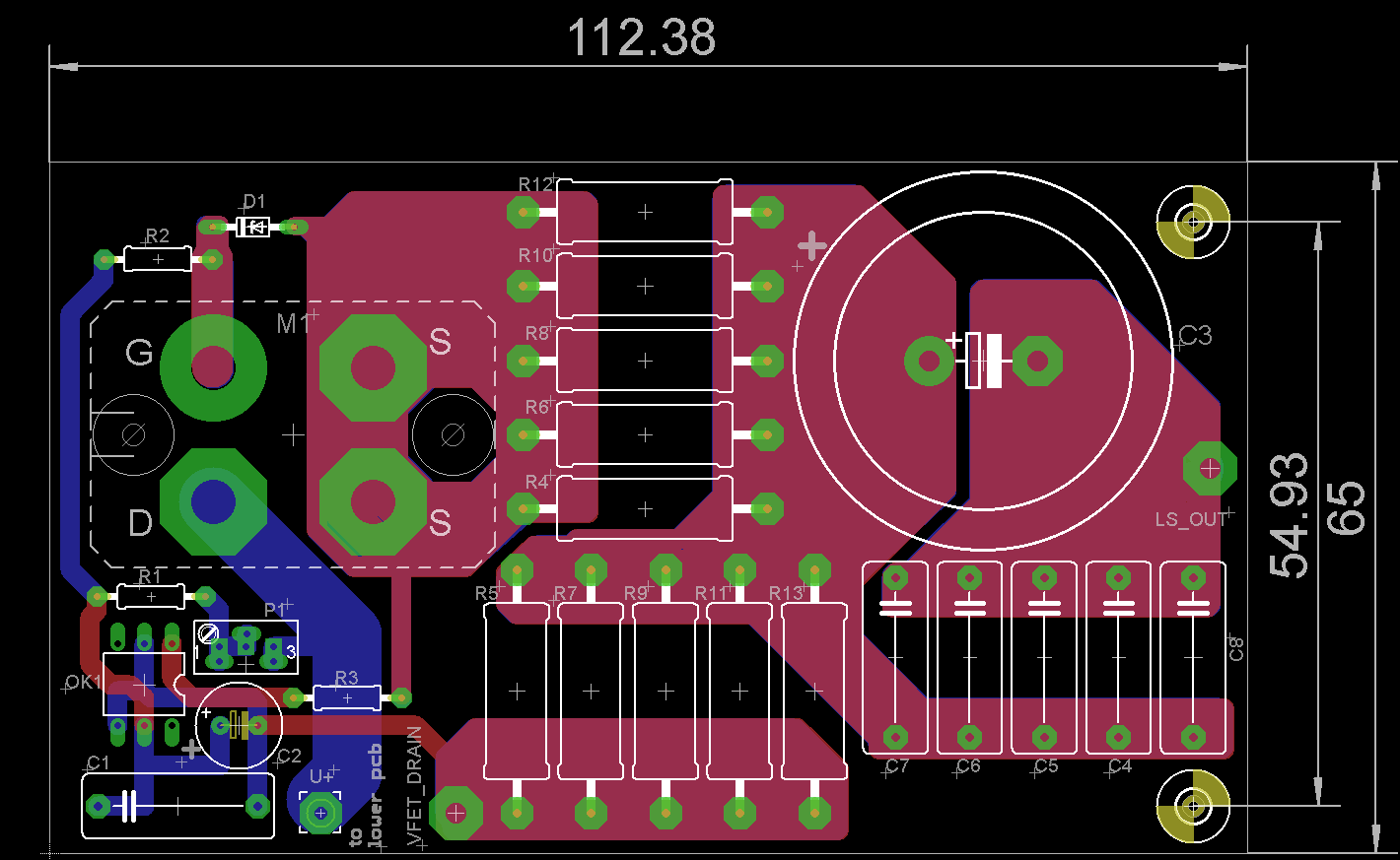

yup
besides making Big one for Mighty Moi , greening all the time simply having mental image of Mithrandir's cunning smile , I need to make THF iteration for my Polish friend
so , will probably make it as complete project , maybe even including everything needed for Papa's Poor Men All-Mos iteration , presented in same BAF 2015 video

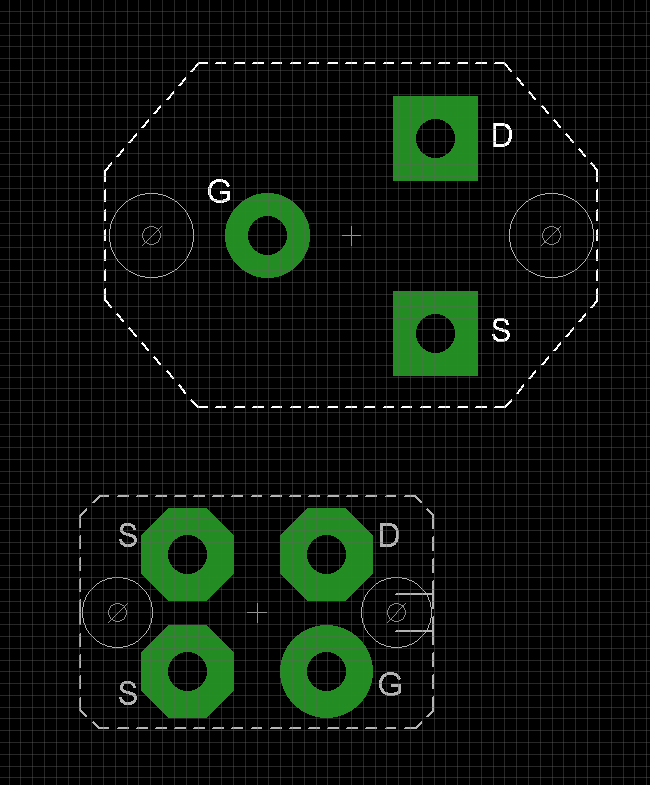

as we are speaking , I'm making Eagle packages for 2SK77B and IXFN140N20P
yup

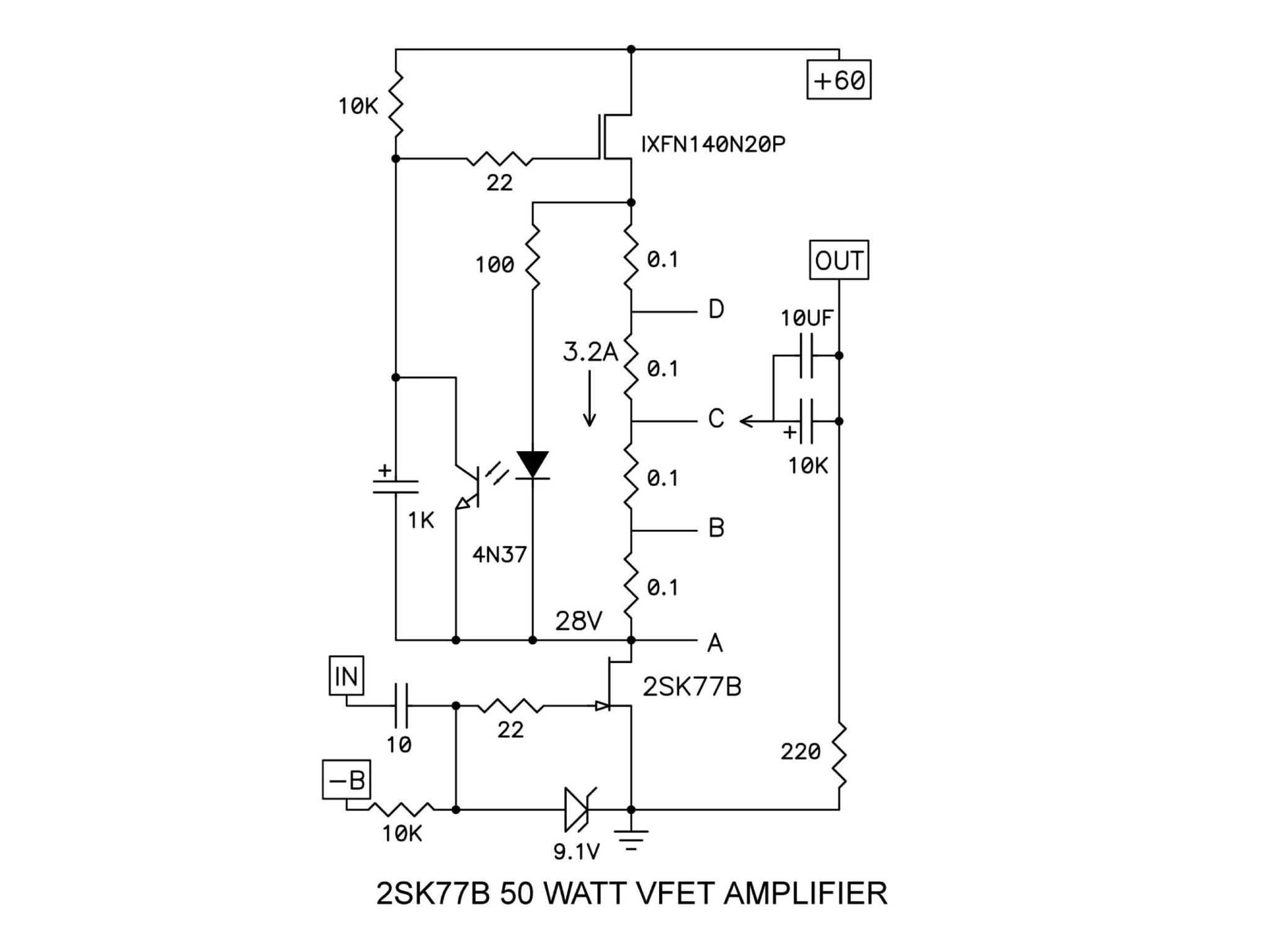

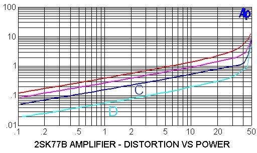

5a me think... It's what papa prescribed voltage.. Sounds don't know yet...
Thanks AnthonyA, another question : how much is bias (- B) voltages for SIT's?
Me know very well triode simulation with IXYS mosfets and Tamura input transformers only , but my amp builds have a CCS version with A, B, C and D connection points from 2SK77B schematics.

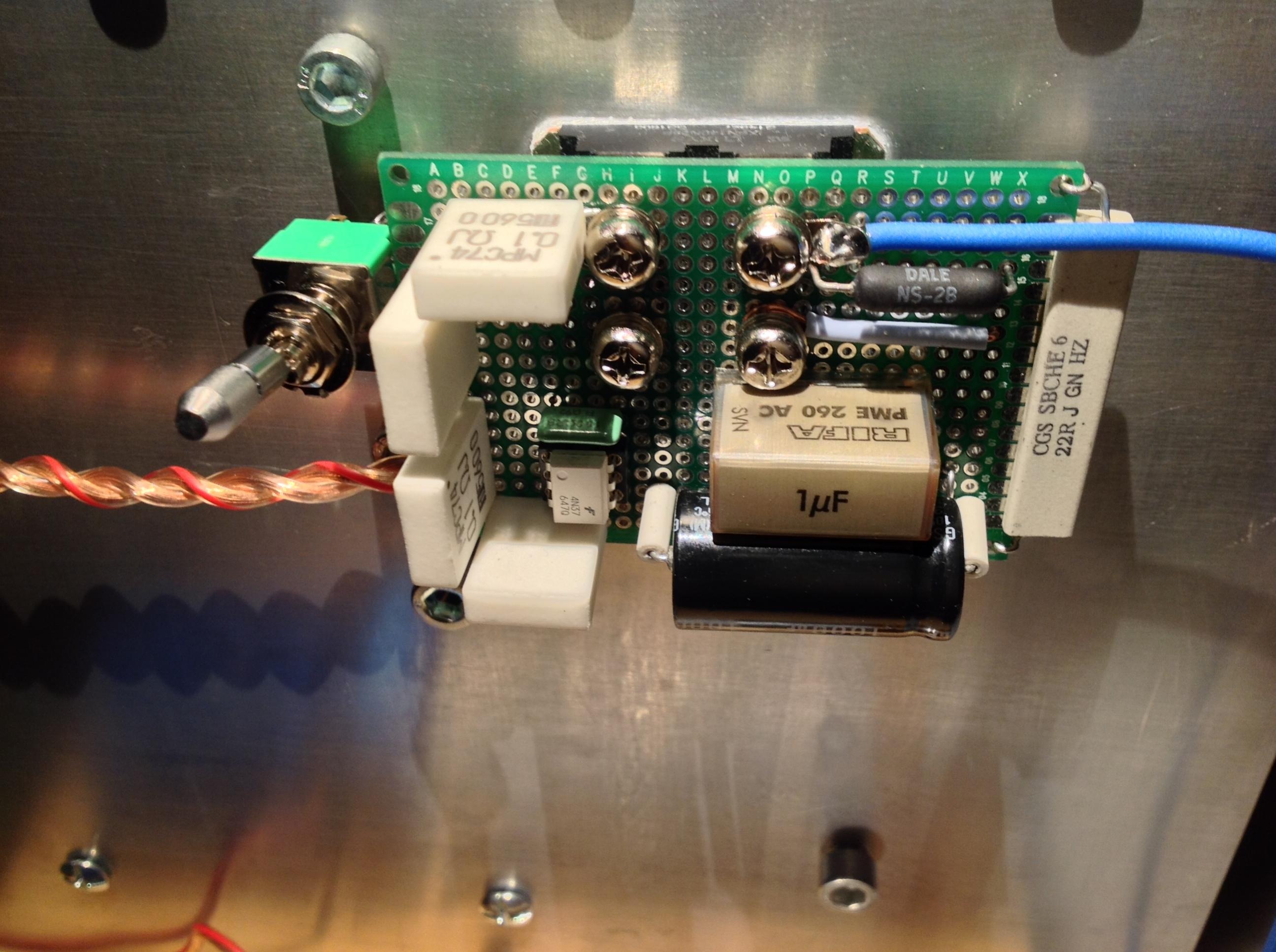

Is a DIY option simple tip just solder double switch from CCS points C to D so You get two different sound signatures possibilities to chose from only one amplifier. Is twice fun with the music play 🙂
hope you're not using that tiny green switch for speaker route 🙂
btw. I had some fun this evening .... whenever I have no energy for something "more demanding" , I'm finding pcb fun very relaxing
Work perfectly ..this Sato Parts Japan handle 6A of current and can be locked for security.hope you're not using that tiny green switch for speaker route 🙂
Gold plated contacts in hermeticaly saled box Is a Big Green Switch
