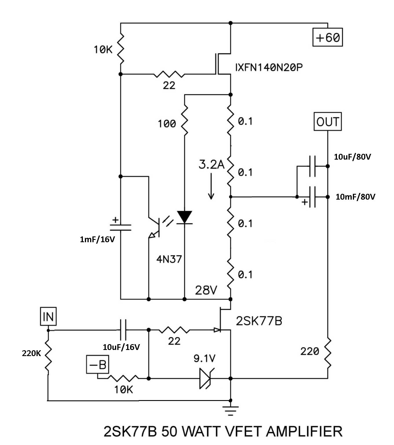

No typo as far as I know. The cap to the left of the 4N37 is labeled 1K (1000uF) and the cap at the speaker output is labeled 10K (10,000uF).
I have built this circuit with those values and it works and it sounds great. Not with 2SK77B of course, but with THF-51S.

I did use the IXFN140N20P for the CCS.
You mentioned that your were working on this amplifier too. Is it nearly finished?

I have one channel working - hopefully during the next week or so I will get the other going.

use fine , fast , settable B-
5V is enough , negative
even 7905 will work (put some shunt load on output , say 15mA will do the job so 330R regular resistor will do) , though LM431 or LM336Z-5 are better for better sleep , if nothing else
