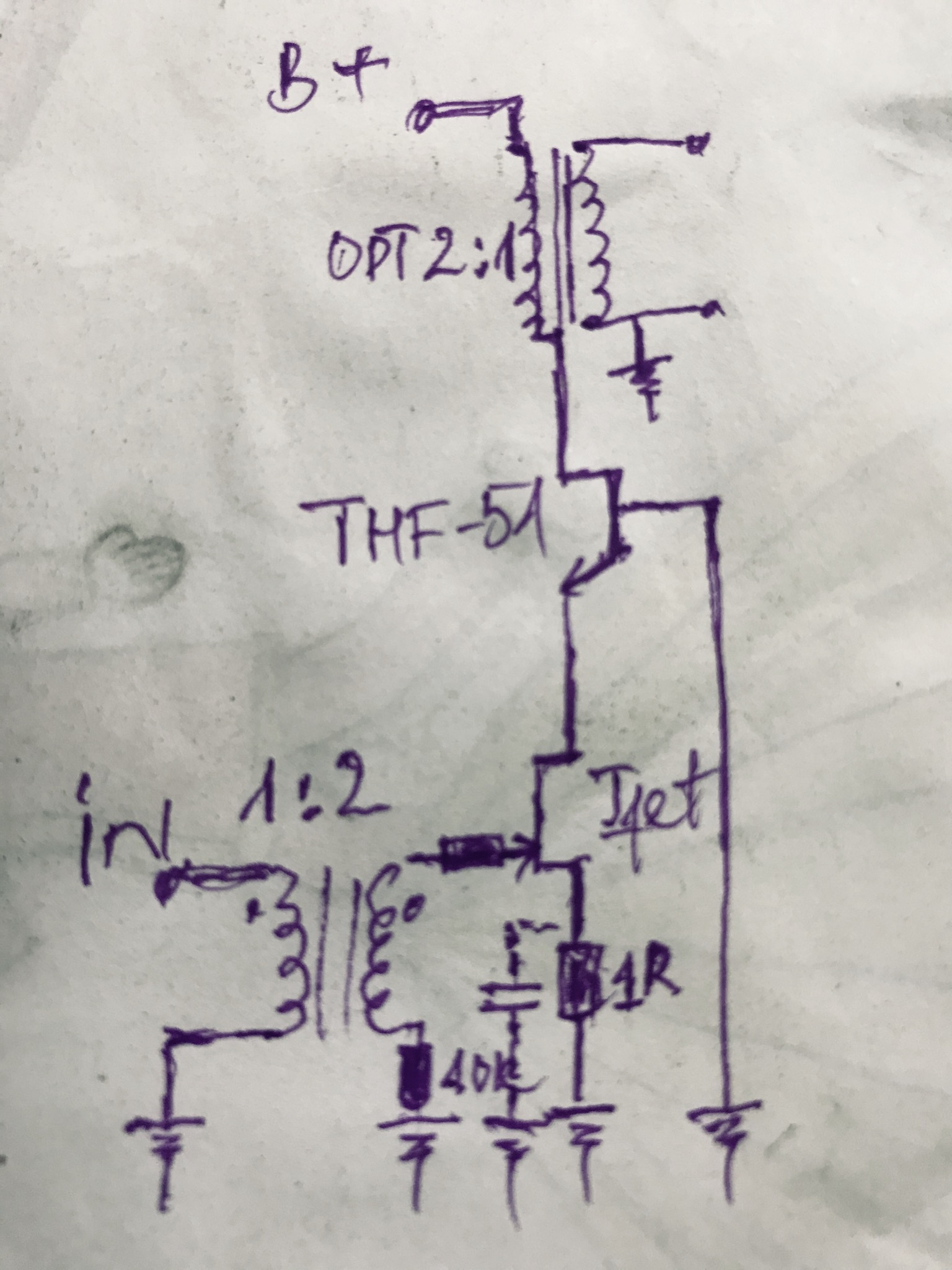

I think THF 51 is better than 2sk18x except its Ciss very hight. Mr Pass teach us Cascode topo will help so I'm going to try Tubeman' topo with Tokin THF-51S & CGH40045G CREE
