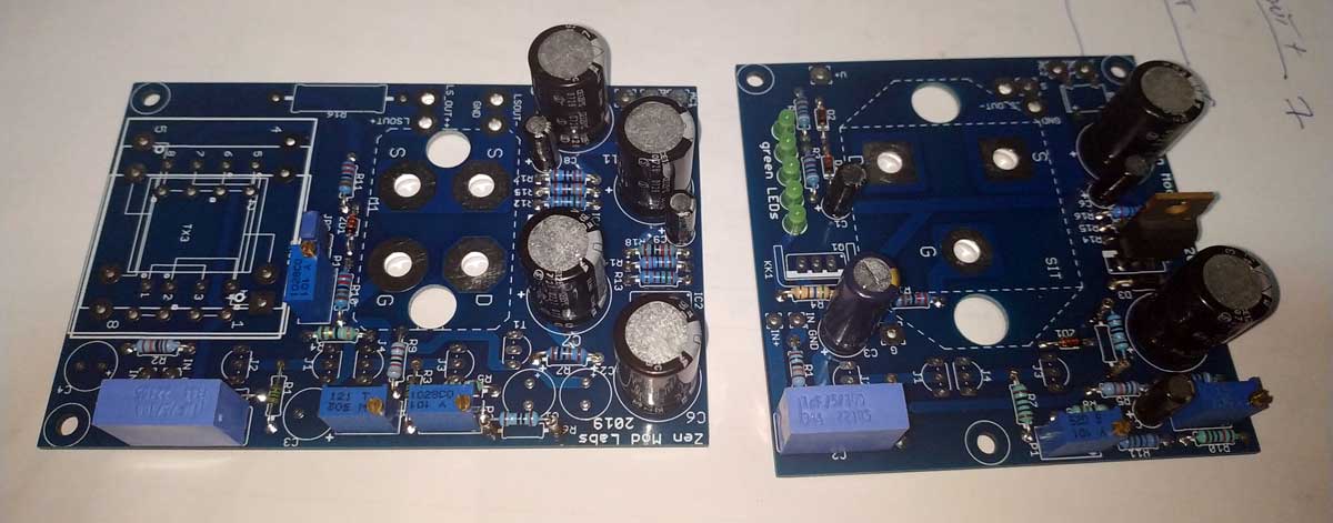

as I'm always saying - it'll be either All The Glory , or Major Flop in Public :rofl:
in case of first one , I'll have them available for Greedy Boyz ....
proper testing , and I hope to be satisfied with outcome

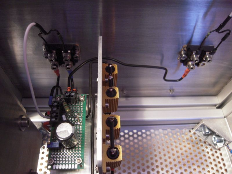

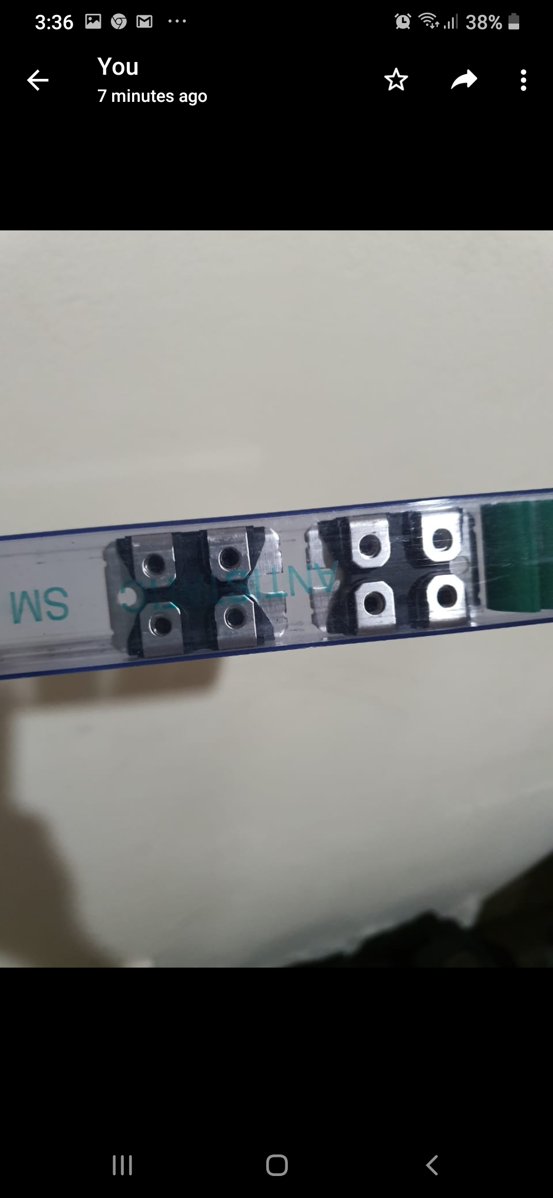

myself:
I think I have to change my forum-name to 'master of disaster' or
'copper - bender`? See attached pic.....:bigeyes:

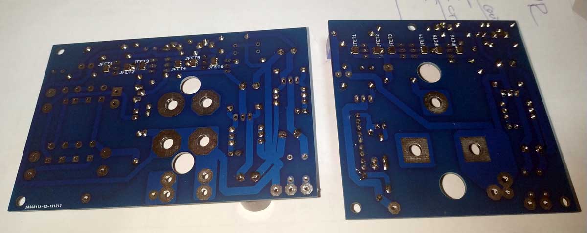

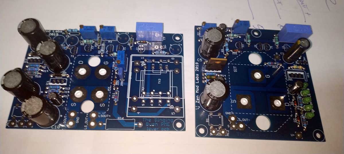

lousy late night pics
lazy to arrange proper light
missing some tiny parts - few caps and small Graetzs, need to order them tomorrow ....
so , testing in few days ......
In the "SIT multi-flavor" lower PCB schematic what is the voltage at the gate of the IRF510? I don't know what the forward voltage is on YOUR green LEDs.
What is the A/C voltage at AC1 and AC2?. I am guessing 22VAC to run the buffer at 28V regulated but, if you write down the voltage, we don't have to guess, eh?
it's sorta too early for tiny details , prior to even firing them up
however , I'm counting on plain old difuse 3mm Green Leds , all of them having 1V93 at few mA
so , logic is to have tiny smd JFet buggers working at something as 9-10V
for SIT gain pcb , AC is once 15V ; if you calc , output voltage of LM317 reg is soso 12Vdc , so 15Vac is resulting in nice headroom even when mains goes funny (-10%)
rarely seen in my neck of wood , but that's my habit - taking that in account
for Mosfet gain pcb (xformer Schade etc.) , auxiliary xformer is , say, 30Vct (or 2x15Vac )
in both cases 100mA sec is Plethora of Pinjatas
