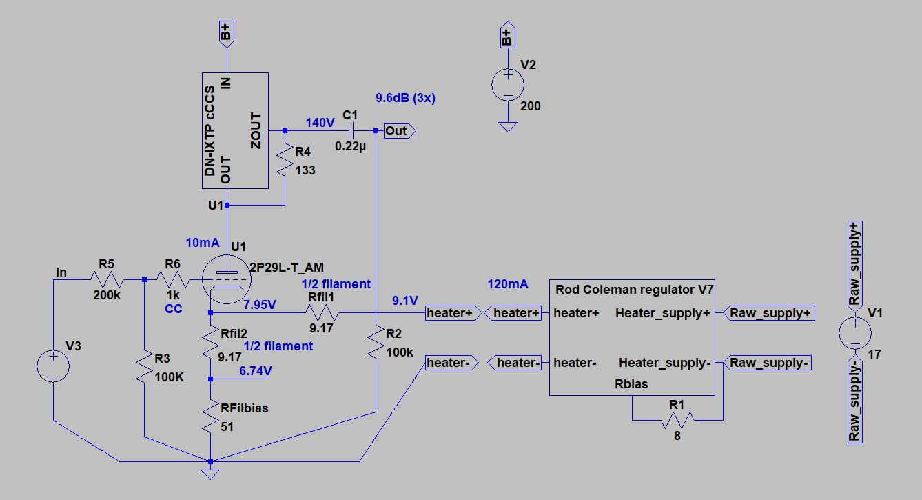

2P29L Preamp
I am building a 71A preamp, but really struggling with the microphonics, despite all the usual countermeasures. I might switch to a 2P29L since I can reuse all of the other elements I already have in place. I'll have to change a few of the operating points of course, but will be pretty easy.
But this tube is too much gain for me.
I know its a total taboo, but how might I add 10dB of local feedback? Is that crazy? I would be using a circuit similar to Ale's but with a 10m45s CCS on top rather than his gyrator.
Yes, I could certainly attenuate the input as well. Trying to explore some uncovered ground is all. Not a firm believer feedback is bad, and also experimenting is really the only way I know how to learn.

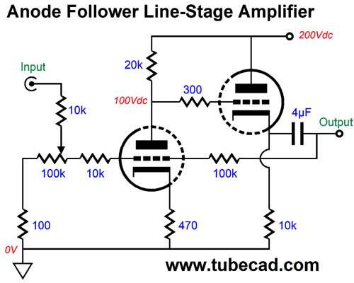

You can apply parallel (shunt) negative feedback from the output (plate or anode) to the grid of a triode.
Some call that an 'anode follower', but that is a confusing name.
https://www.tubecad.com/2019/03/blog0458.htm

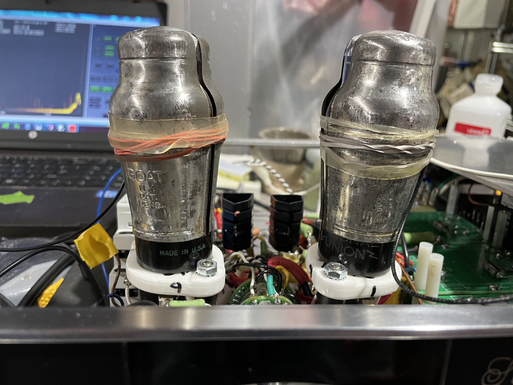

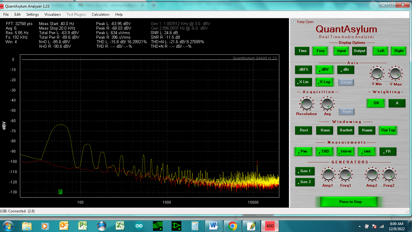

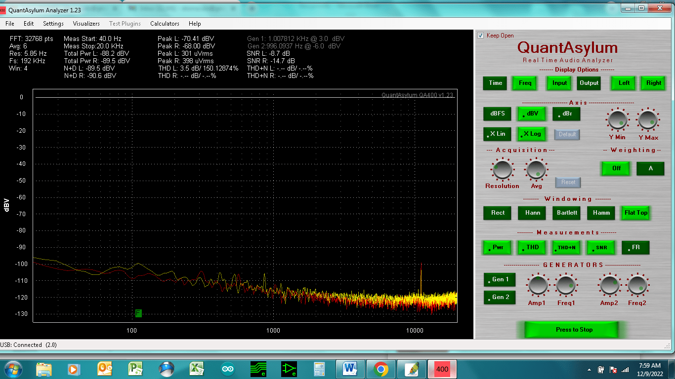

I think the elephant in the room is microphonics. Without measurements some have concluded they have have solved the problem. Maybe they’ve suppressed it below -80dB so cannot hear it, but let’s opine about how running smps on a filament will induce intermodulation distortion at -110 dB/V lol. That’s not directed at you, but I find some of these conversations rather amusing
The other problem of ancient DH tubes not only microphonics, but tend to sensitivity of magnetic and/or electric field (EMF).
Some tube (same type, different manufacturer and/or different production time) insensitive, some has horrible behaviour.
Decade ago I measured few dozen of #26 tubes, only few was insensitive of EMF.
The biggest difference (at 50Hz component) between tubes was 40db!
The other ones are good tubes, but was necessary to shield its (aluminium or permalloy folie).
Yes, indeed true! Look at the difference with the tubes shielded vs not. Almost 40db difference at 60hz, plus all the other noise. The left channel on the one attachment I removed the shield. The other attachment is with both tubes shielded.
That’s why I’ve come around to these 2P29L tubes. Reputation for not being microphonic, plus they’re already shielded with their dorky but kind of cute hat. I kinda like how they look- others may disagree

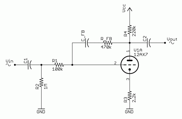

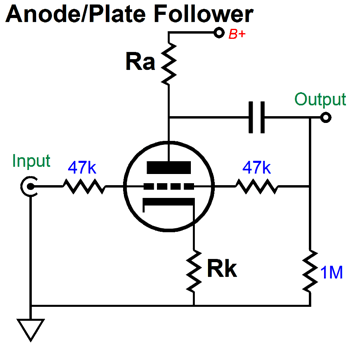

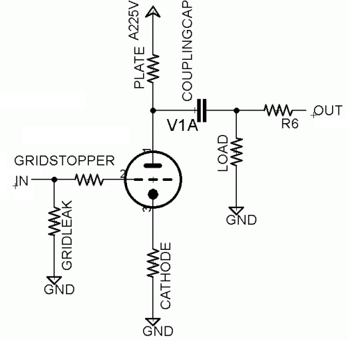

When you have the more common plate-loaded triode amplifier stage like this:
Circuit 1:
That is most properly called a "common cathode amplifier", because the cathode is grounded (common).
An "anode follower" can also be called an "inverting amplifier", which is simply the above common cathode amplifier with shunt feedback taken from the plate and applied back to the grid:
Circuit 2:
To make that 'anode follower' or 'inverting amplifier' work better driving both the load and its negative feedback loop, you can buffer its output with a cathode follower. That doesn't make it a different amplifier, really. It makes it a buffered inverting amplifier:
Circuit 3:
Circuit 1 is a common cathode amplifier.
Circuit 2 is a simple anode follower (aka inverting amplifier).
Circuit 3 is a buffered anode follower (aka buffered inverting amplifier).
Basically, the only real difference between Circuit 2 and Circuit 3 is that Circuit 2 is an anode follower in isolation, while Circuit 3 is an anode follower with a cathode follower added to make it work better.
It's a little hard to explain in words, but I think that gets the idea across.

I don't know why the names are what they are.
Circuit 1 , common cathode amplifier also inverts phase on output so term "inverting amplifier" applyes also. 🙂
True. But common usage is to call Circuit 1 a Common Cathode Amplifier.
Add shunt feedback to make Circuit 2 and you have a Common Cathode Amplifier with Shunt Feedback. But that's a lot of words.
I always thought Circuit 2 was named an Anode Follower.
Here's an old article that calls it an anode follower: https://www.aikenamps.com/images/Documents/anode.pdf

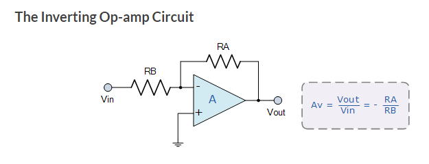

I think that's because you can apply enough NFB so that it has a gain of 1, making it a 'follower' but the output signal comes from the plate, so it's not a cathode follower.
Then I saw in Morgan Jones "Valve Amplifiers" that he called it an Inverting Amplifier or just "inverter".
I think some call Circuit 2 an inverting amplifier following common practice for opamps. On that page, notice that the Op-amp Inverter is the same thing as the triode anode follower.
I don't think Circuit 3 has a commonly accepted name. In the Anode Follower article above, the author calls it an "Amplifier with extremely low output impedance."
