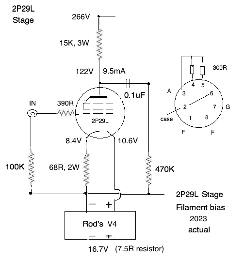

Looking for the simplest implementation of 2P29L I ended up with this circuit. I used a small 12+12v 12VA transformer for the filaments which gave me 16.7V. No heatsinks necessary on my 3mm aluminium top plate. I used the older V4 version of Rod Coleman regs but building fresh you would use the V9 which needs 3.5V headroom rather than 6V. This would allow for a higher bias voltage like 10V on the cathode and the rest would be altered accordingly. No rectifier tube, just 1200V Schottky diodes. Simple 230/230V transformer for the B+. About as easy to build as possible. You can also put a 1:4 step-up in front of it and drive something like a SE 2a3 stage. Very nice.
Thanks, Merlin. The other reason I built this 2P29L stage is to replace my beloved 10Y driver stage in my 2a3/6C4C 2 stage SE amp when the weather gets hot. My listening room is also my bedroom and heatsinks warm up the room. The 10Y has quite a hot heat sink since it's filament bias. When the heat gets above 25° I have difficulty sleeping, and I leave my system on 24/7 because I often play music quietly to send me to sleep. I also have a 2a3 output stage with AC heating to eliminate another heat sink. I usually use my 6C4C output stage with Rod's regs and, of course, that has another heatsink.

I put the 2P29L stage into my system in place of the 10Y stage and it's surprisingly good. I've said before that it is 90% of a 10Y and I still think that's about right. Not quite the magic but otherwise a similar sound. So my system is now DAC > 1:4 step-up > 2P29L > 6C4C. Both in filament bias. Very simple, very cheap, sounds wonderful.
I haven't used the 4P1L for several years. It has its good points - good treble and decent bass. I found it rather hollow sounding in the midrange. This can be improved but not completely cured by putting at least 25mA through it and even up to 35mA. Not something I want to do so I'll pass on that. The 2P29L has a balanced sound without any hollowness in the mids. The treble is quite good and overall it's quite satisfying. What it lacks is low level detail and transparency in the midrange. The 10Y does this better than any other DHT I've used. Loads of detail, wonderful vocals. In comparison the 2P29L has a relatively "thick" midrange. If vocals are vital to you then you will choose the 10Y even though it's a much more expensive and challenging build, especially in filament bias which gives you the cleanest sound. Actually, going from the 10Y to the 2P29L in my system makes me yearn to put the 10Y back. I just love voices with the 10Y and for voices I'd put the 2P29L at more like 80% of a 10Y.

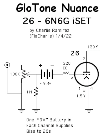

Maybe try battery grid bias with a 9v battery? I used this with the 26 in my Nuance iSET that I built last year. Super simple.The 26 is frustrating - it does have its own magic and is very good on vocals. It's a more challenging build in filament bias, and requires heatsinks which get hot.
I've never done any A-B comparisons with other methods but it sounds good to me. I did come across an analysis somewhere that indicated that it resulted in slightly lower measurable distortion vs a resistor. I'm also using it on my current project which uses the Hammond SUT arrangement with a different DHT.
Various combinations of batteries can be used for different tubes. Battery life is essentially their shelf life if no grid current is drawn. Probably 9 or 10 years for a Lithium or 6 or 7 for an Alkaline.
