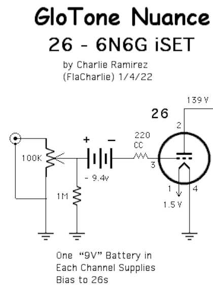

Maybe try battery grid bias with a 9v battery? I used this with the 26 in my Nuance iSET that I built last year. Super simple.
I've never done any A-B comparisons with other methods but it sounds good to me. I did come across an analysis somewhere that indicated that it resulted in slightly lower measurable distortion vs a resistor. I'm also using it on my current project which uses the Hammond SUT arrangement with a different DHT.
Various combinations of batteries can be used for different tubes. Battery life is essentially their shelf life if no grid current is drawn. Probably 9 or 10 years for a Lithium or 6 or 7 for an Alkaline.

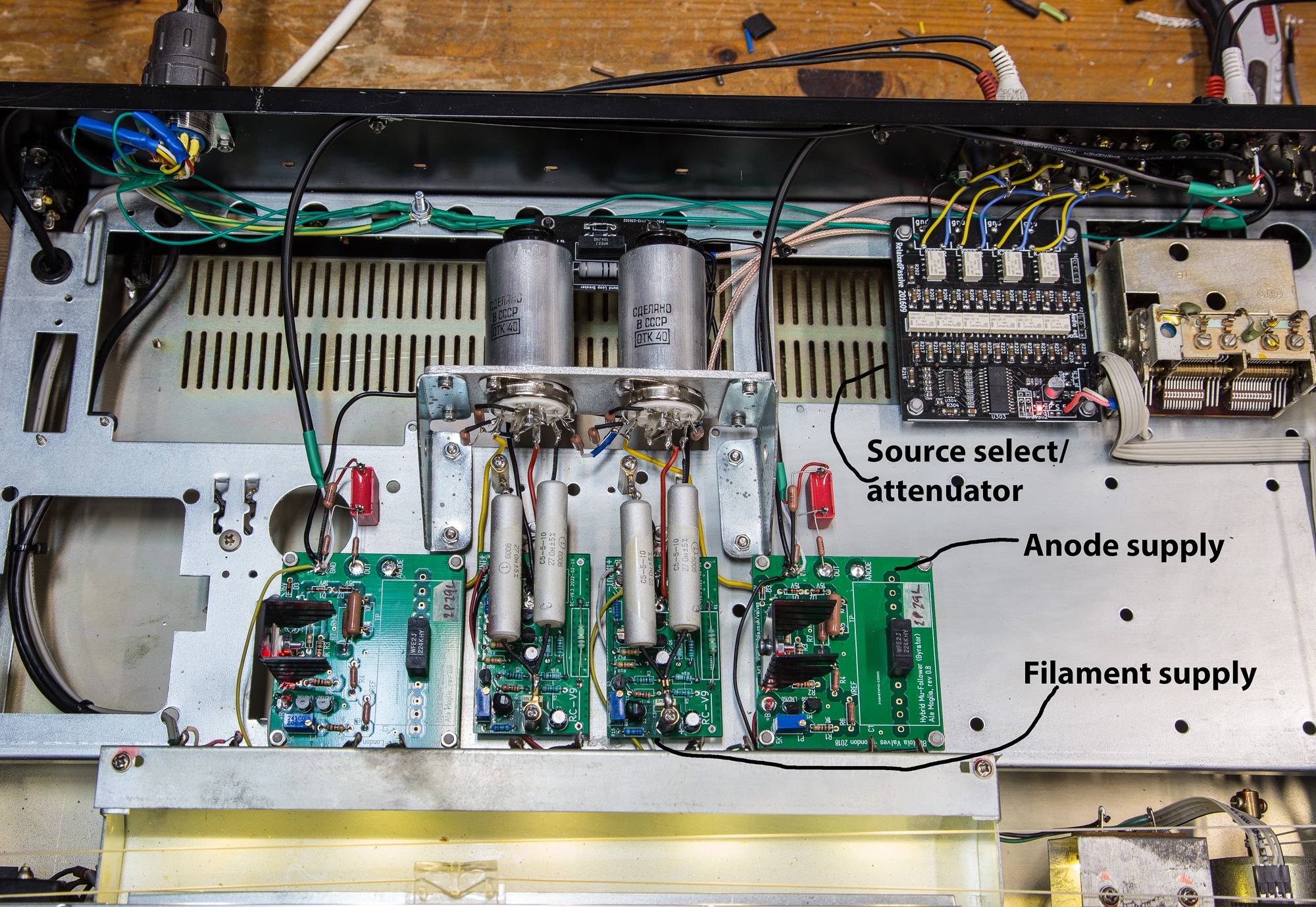

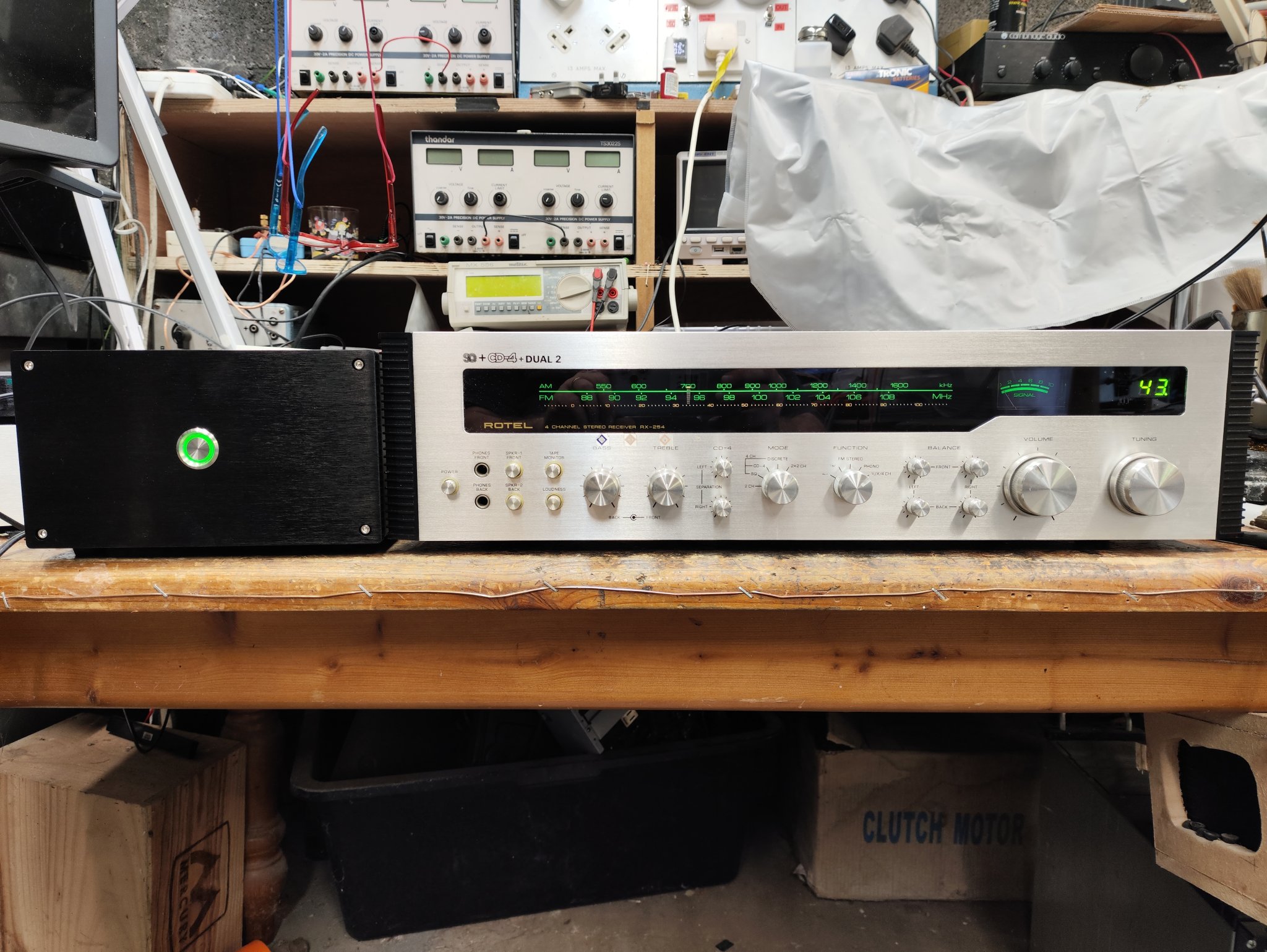

I recently completed a 2P29L build for a friend. Essentially the implementation is exactly as per the one on Ale Moglia's website. I implemented a two box solution, with transformers and raw supplies in one box and the other chassis just holding the main circuit. I used the Relaixed relay source select/attenuator for control as it also gives remote control ability and I am familiar with it.
At this point I have built two of these (and two 01a), one for me and one for a friend. My own one is the same circuit, but in a single chassis. I can conclusively say that the two box solution is definitely quieter. This is particularly so in the case of the 01a which is more microphonic than the 2P29L and I believe I will most likely go back and rebuild my own 01a in a two chassis solution. The problem is not grounding, but rather transformer vibration and whatever EM/magnetic fields are within the chassis.
Anyway, the main chassis here is a little unusual - my friend has a love for 70s receivers and asked could I use a chassis for one of these for the preamp. The end result turned out well, I gutted the contents for space, and I removed one of the dials to fit the 7-segment display for the Relaixed source select/attenuator. I couldn't get the green of both receiver display and 7-segment display to match perfectly, but they are close enough. The volume knob is mounted on a rotary encoder for attenuation/source select, all the other knobs are just kept from the original but are not connected.

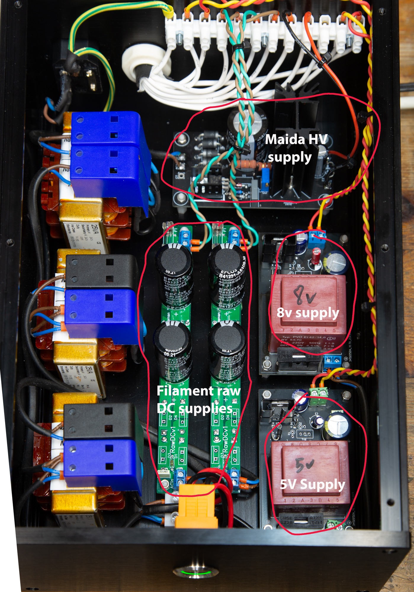

The PSU box is nothing special - transformers for audio are the 3x along one edge, then the rawDC supplies for the filaments in the middle, and HV maida regulator towards the back. The other two supplies are simple LM7805/7808 for the Relaixed system and the lamps in the receiver chassis.
