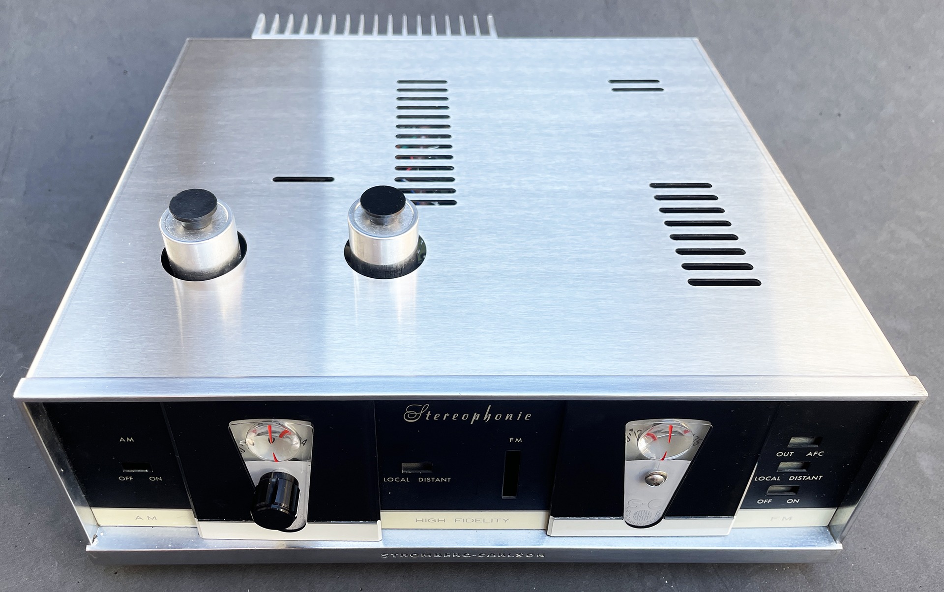

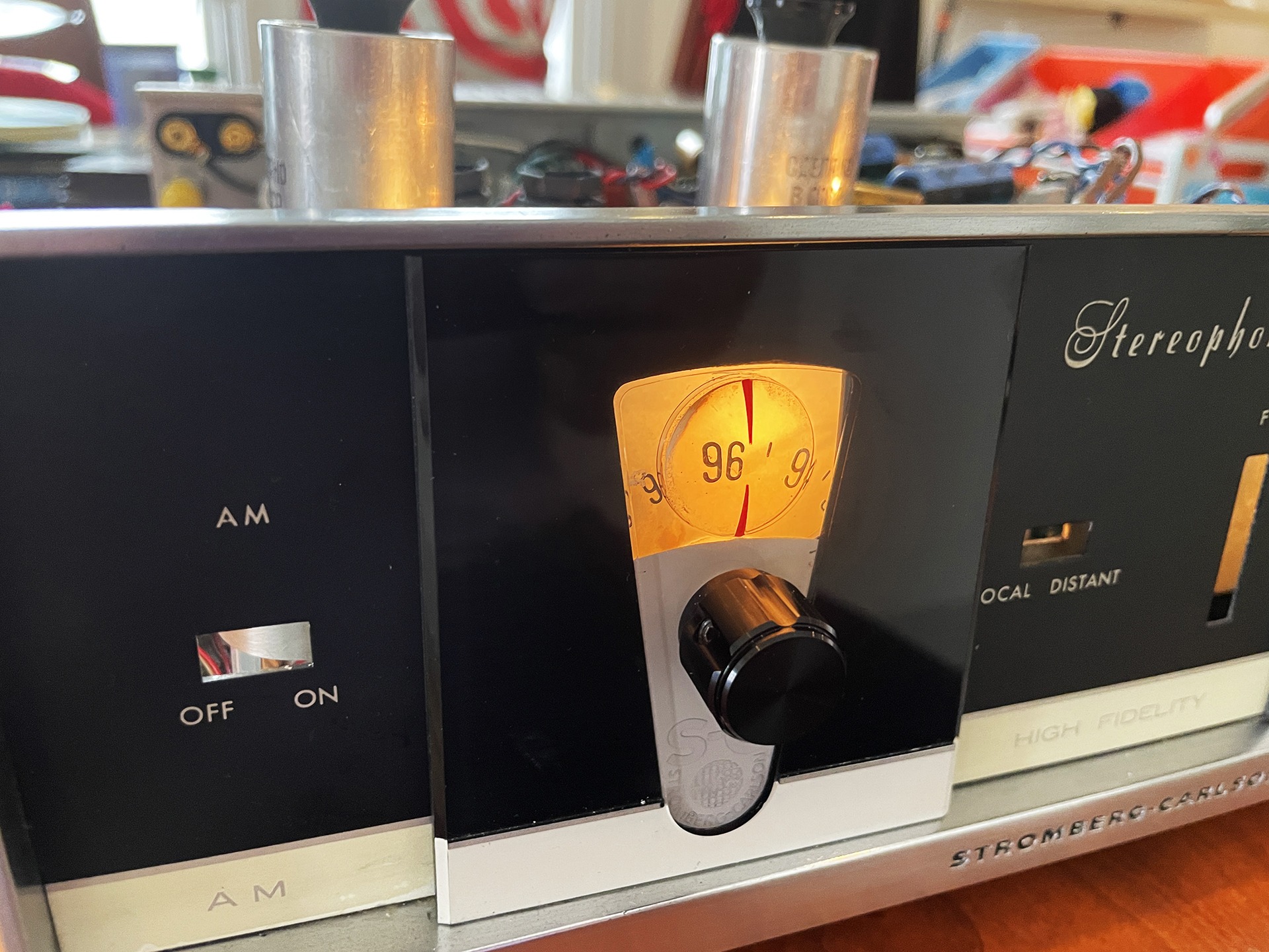

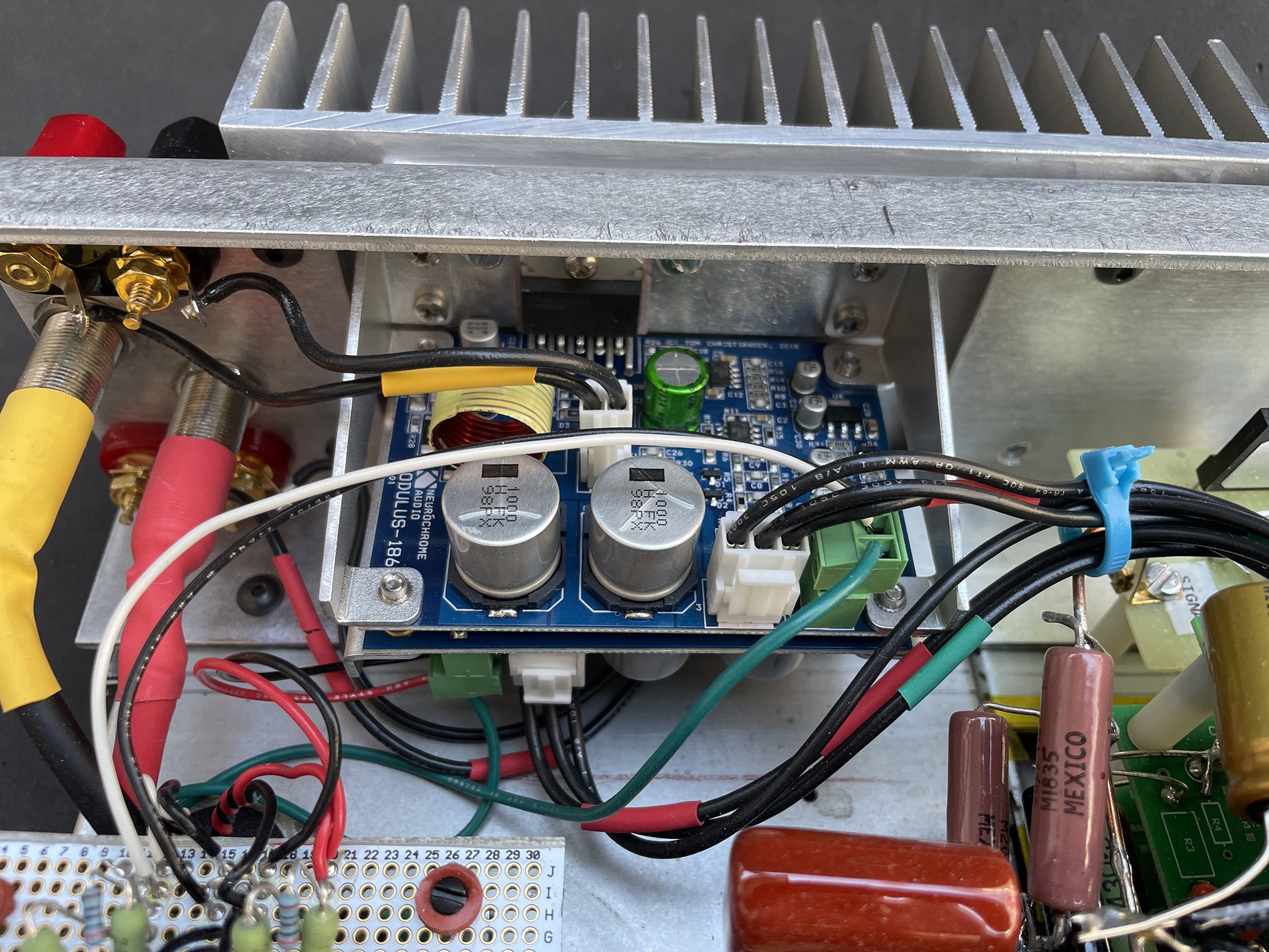

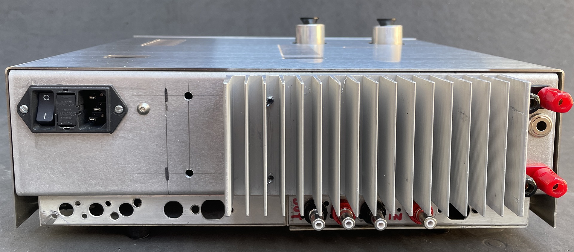

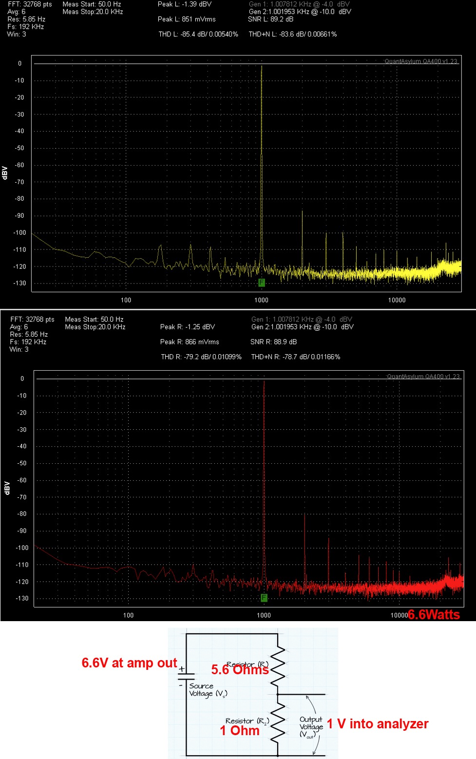

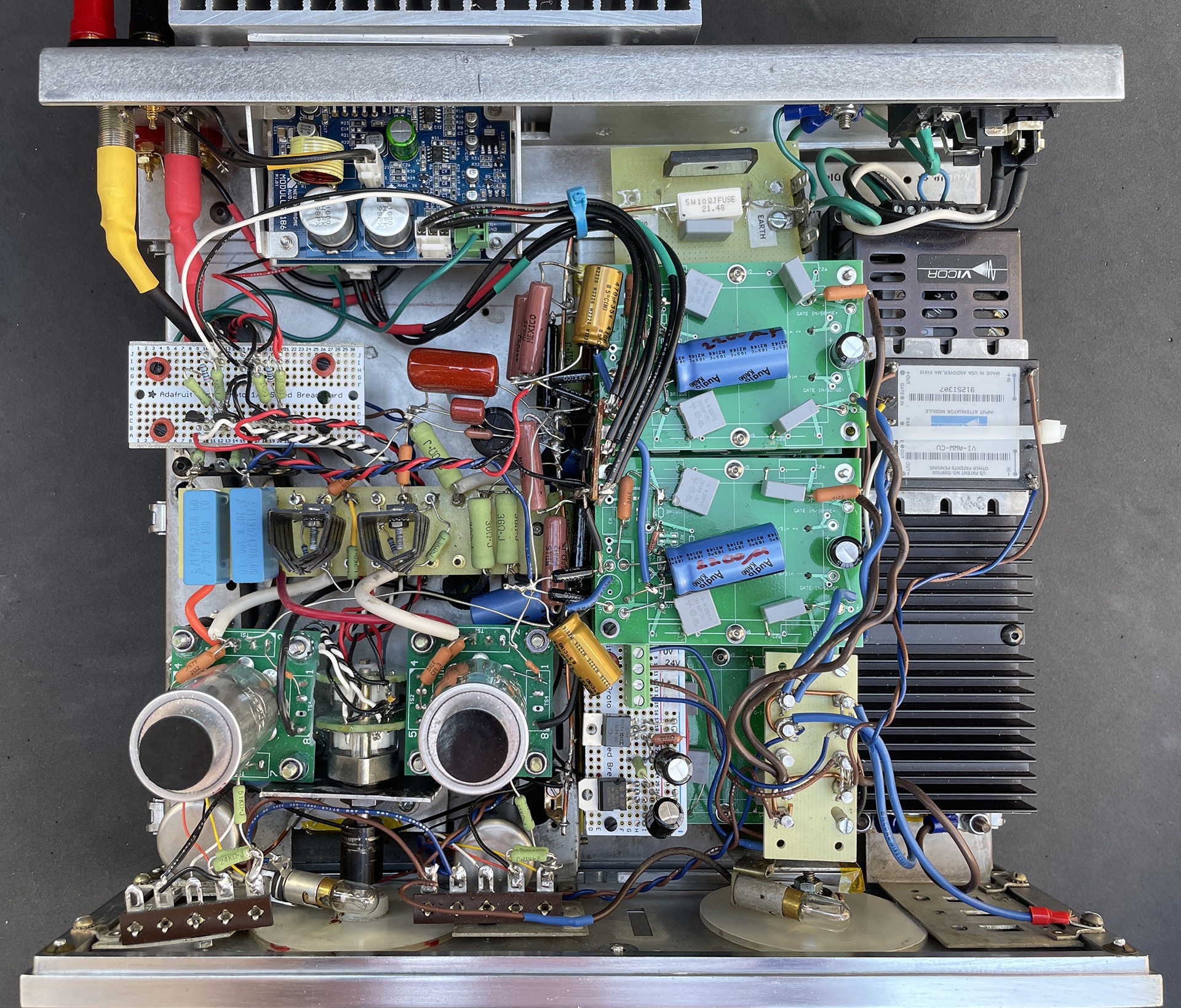

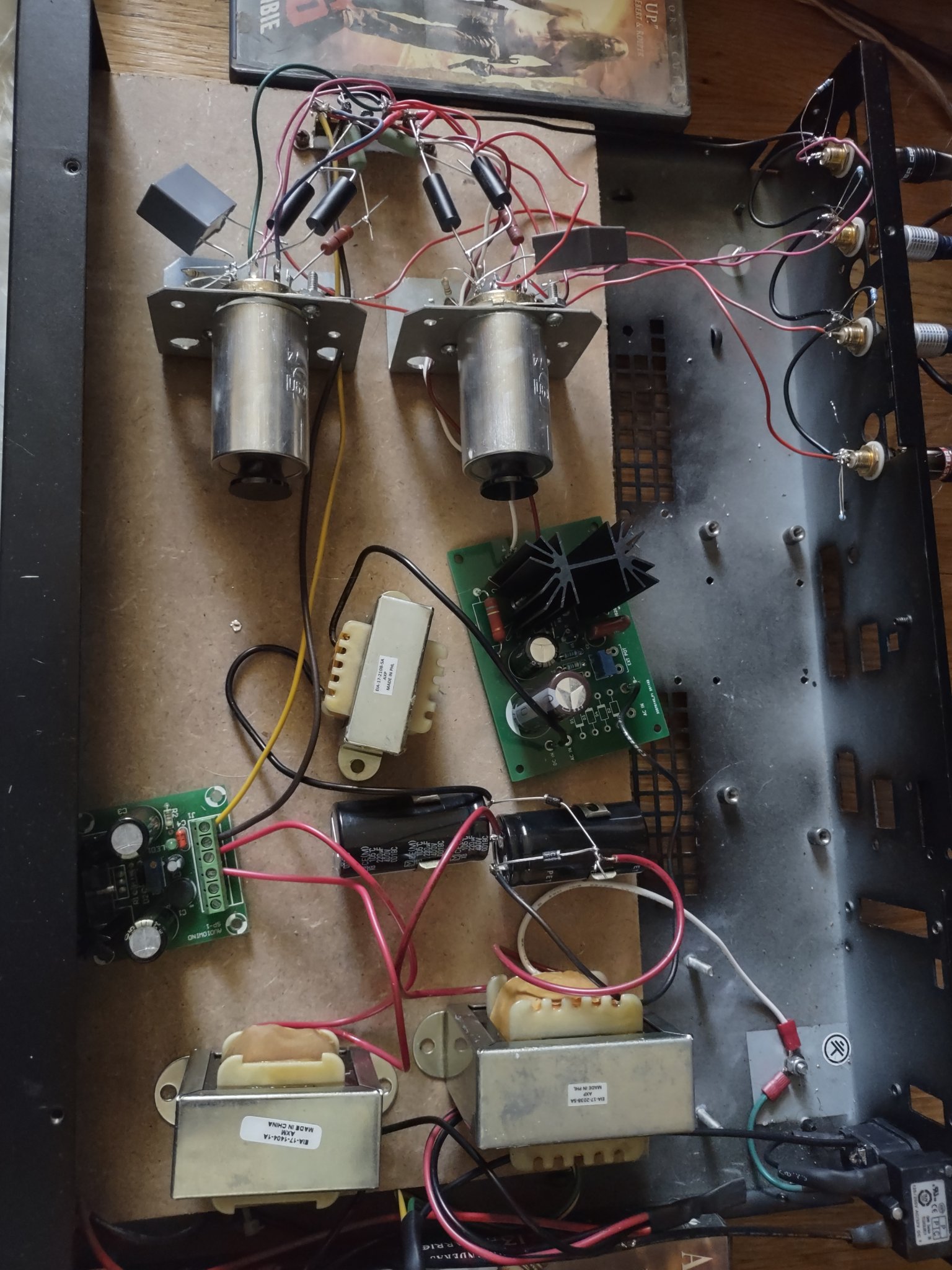

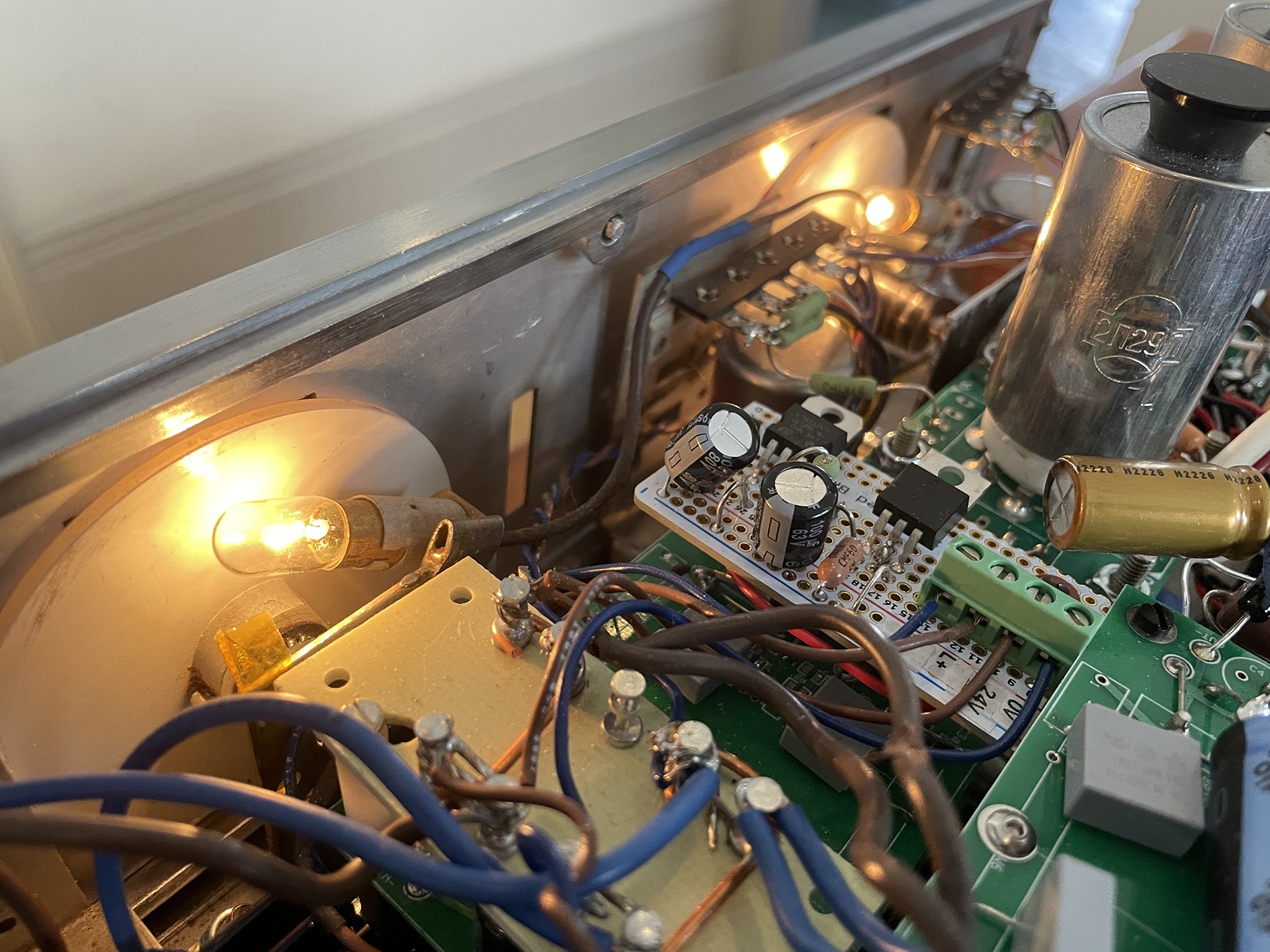

I finally finished this project. Started off as a 71a but too much microphony. Moved to 2p29L which really worked out great. Used SMPS and DCDC converters for B+ and filaments. Turned out it was indeed a major pain, but in the end gave good results. Ended up using some cinemag input transformers because I couldn't get rid of some noise. When using certain USB dacs, noise was horrendeous. I really couldn't fix it no matter what grounding scheme. Input transformers cleared up all noise, and I can't believe how quiet this amp is. I'm using 1/4" jacks for balanced in. Recycled a stromberg-carlson amp chassis and had a custom lid laser cut and bent for me.
2P29L goes into a 100K attenuator. I ended up throwing a B1 Rev 2 buffer on the output of that, into a Neurochrome Modulus.
Anyway, in the end it was a lot of work but really sounds so fantastic, I'm thrilled. I realize most of the heavy lifting was done by Tom's Neurochrome modules, but all in all it was a really fun project. Maybe the tubes and input transformers added some magic I'm not really sure🙂
well done on an unusual build! Love how you did the front panel - kudos!
As it happens I'm sitting hear listening to my own 2P29L into an LM3886, but not a neurochrome one. I started out my build with the 4P1L but the mircophony was a killer on the valves I had here. So I switched to 2P29L and I've been enjoying it very much. Mine is more of a formula than yours - Rods filament regs, Ale's gyrators on the anodes, r-core transformers etc.
Enjoy!
Enjoy!
You, know, I thought I had some photos of the build, but couldn't find them when I went to look.If I have it open again, I'll take some. Its fairly conventional build though, I think the only unusual thing is I used a maida reg in front of the gyrator, just because I had one built and it saved a bit of space compared to CLCRC type filter. I used those 10W Russian resistors for filament bias. After that, its a relay based 6 input selector, EIZZ pot and the circuit is as per Bartola's website.
Very happy with the sound. I think its equivalent to my 01a, but a different sound which is a nice complement to it.
I’m also quite happy with the sound. The only thing I can compare it with is a Salas 6V6 preamp into a hypex NCMP power amp I put together.
That was the inspiration for this one. It was a slightly clumsy 2 box solution. I wanted the same idea but all in one box and DHT.
While the Salas hypex combo is quite nice, this one is way crisper but still very natural. Bass is also more articulate here.
Edit- I forgot to mention that I added 5-6 dB NFB which is always controversial, but it lowered the noise, got the gain where I wanted and overall sounds terrific

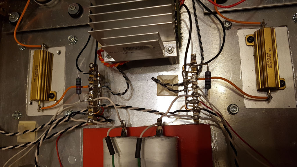

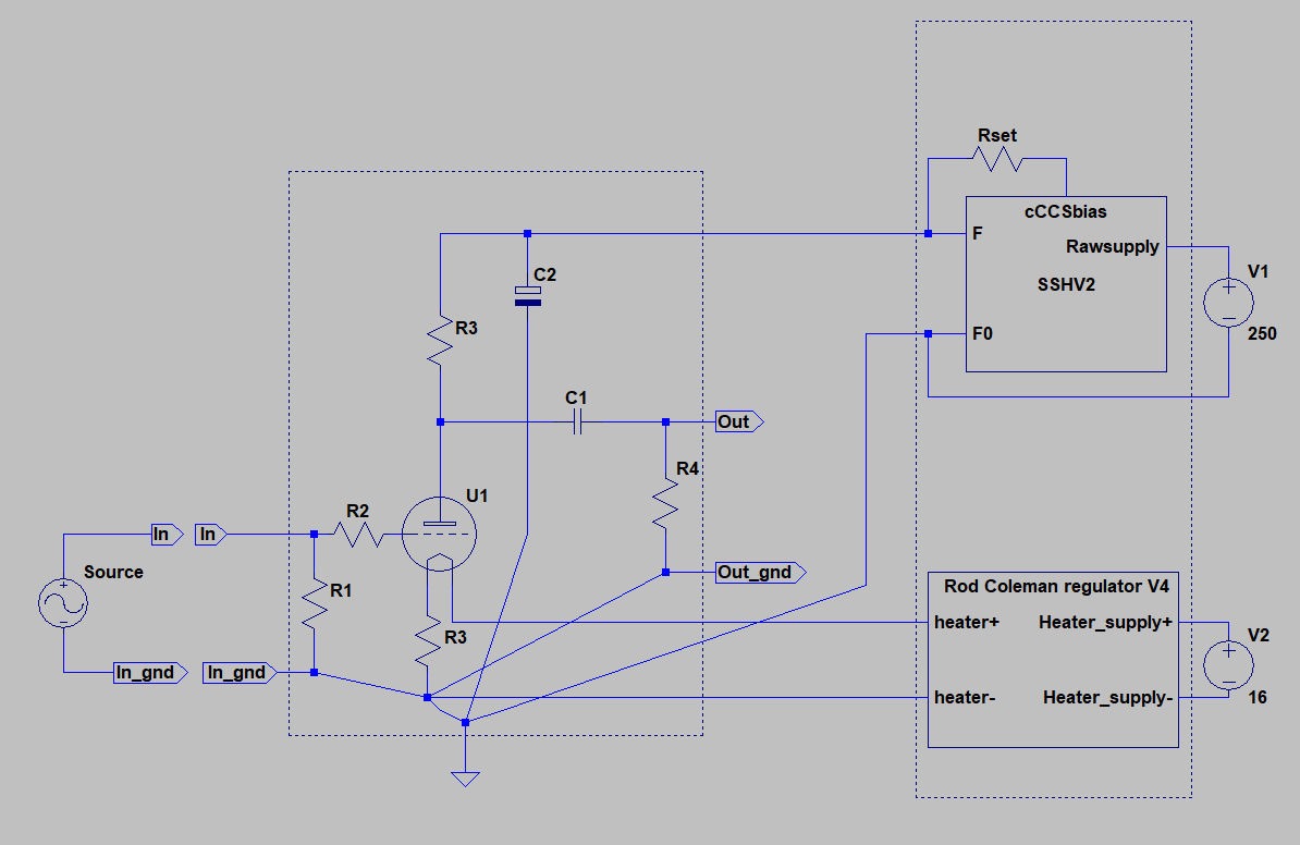

Using common "ground bus" of all inputs and outputs isn't the best solution.
Use individual "cold" wire for all inputs/outputs tightly twisted with own "hot" wire.
Sample (black/white):
Use grid stoppers (R2 in this schematic), B+ filter capacitors (C2) for each channels, and local ground points (R1-R3-R4 common point) for each stages.
I usually run twisted pairs for signal wires but resorted to a "ground bus" here, for simplicity.
