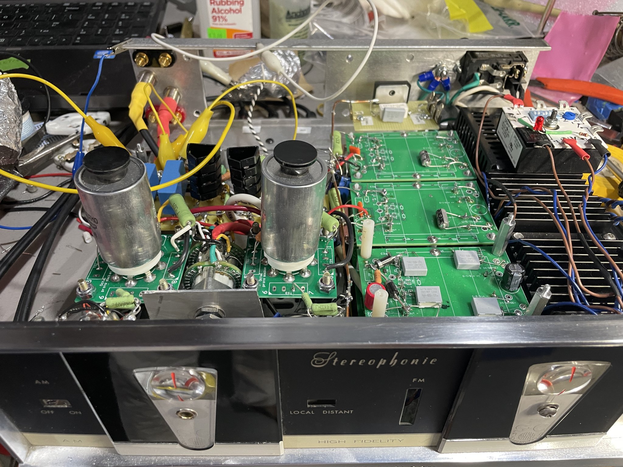

I successfully converted my 71a to 2p29l. Haven’t listened to it yet since I haven’t had a moment to myself with kids, work etc
But things are looking very good. This tube is very easy to sett up. Way way way less microphonic, which was my main complaint with the 71a. Settings are CCS loaded 22ma (I’m aware a tad high), 170 B+, bias - 5.5V, anode ~130V. Distortion also lower than the 71a.
Also, noting that for me I’m not getting 120ma at 2.2V on the filament as the data sheet shows. Rather 135ma, so had to knock it down with resistor and now have 125ma. This was the case for all 3 tubes I since tested. Not a big deal but threw my filament calculations off- fortunately had some low value decent resistors laying around.

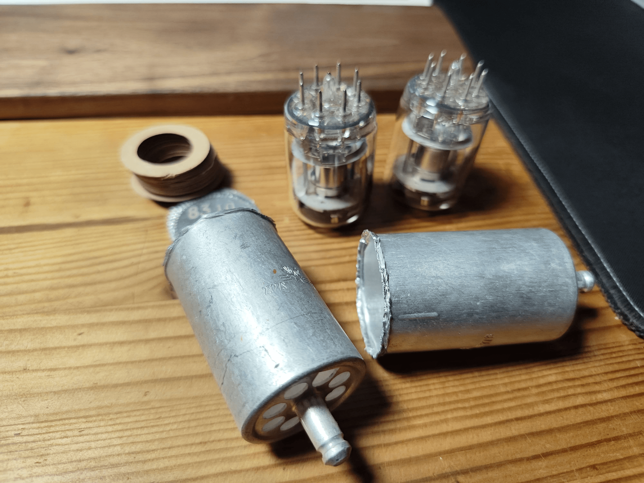

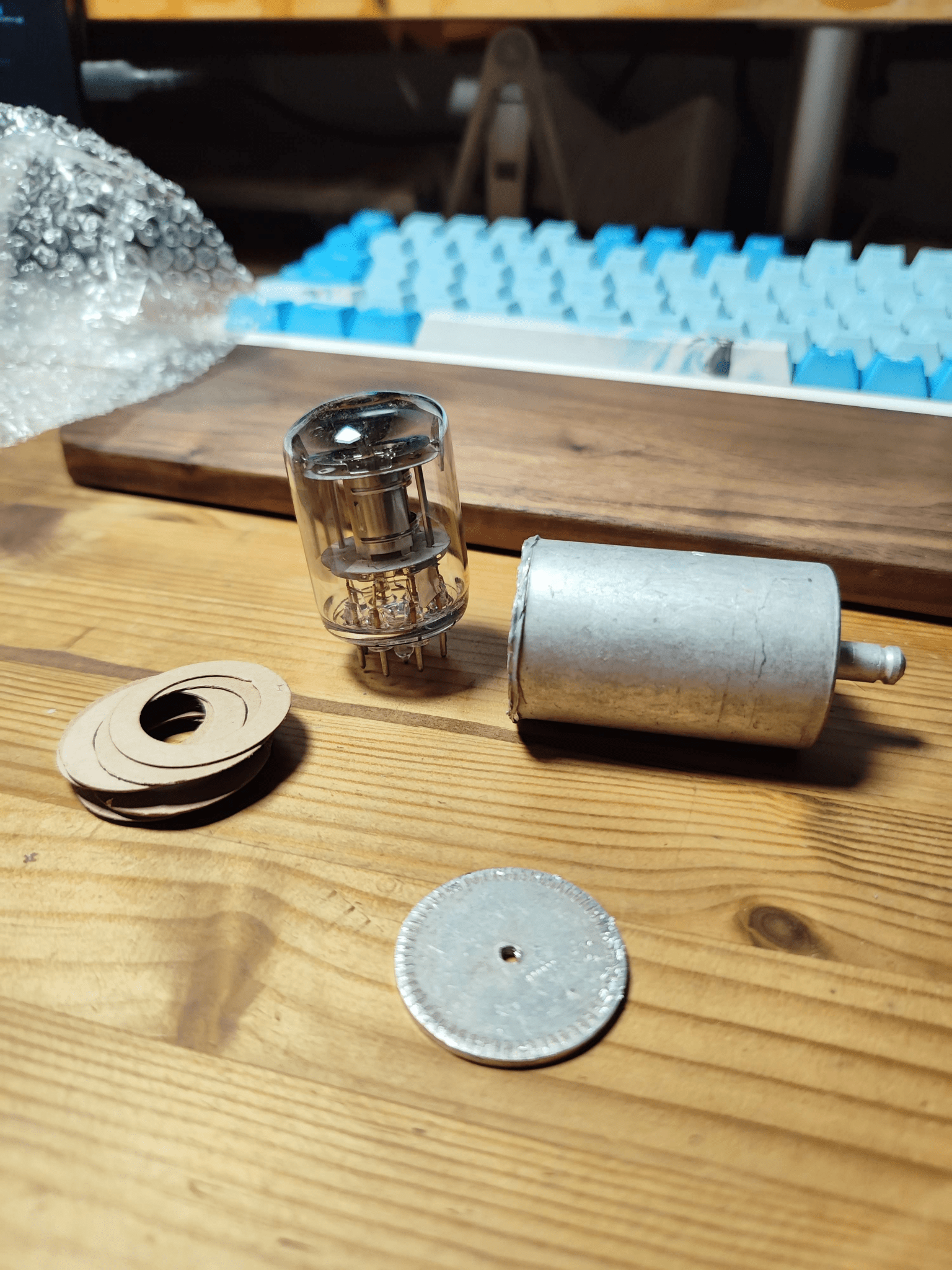

That’s why I’ve come around to these 2P29L tubes. Reputation for not being microphonic, plus they’re already shielded with their dorky but kind of cute hat. I kinda like how they look- others may disagree

Btw, the 2P29L still benefits from tying the metal shield to chassis. Noticeably the tube is much quieter this way. Right now I just have a wire taped to the metal body, but will come up with a better solution. But even without that drain wire this tube is orders of magnitude less noisy and less microphonic. I think it’s also way less ancient than the 26 for instance.

I finally got this all wired and am listening to it the last few days. Wow I really love it so far.
I did end up trying a bit of feedback, around 6db. I think it sounds wonderful. I don’t find the life is sucked out or anything like that.
Used 430k through a 1uF into a node with 51k input resistor.
I tried it without as well. I liked it too. I don’t know. Gain structure much better this way though for my system, and to me sounds real nice. Channel matching got better, noise and distortion all went down. YMMV try it out if your curious.
I’m using CCS and had around 15db gain. Now around 9 with the NFB.
I’m coming from a Salas 6V6 preamp, built as per his post 1 in that epic thread. This sounds a bit clearer, and maybe a bit more 3D. Take all these subjective descriptions with a grain of salt. Bottom line though this preamp sounds great. Go ahead and build if you’re on the fence. Microphonics not an issue at all.

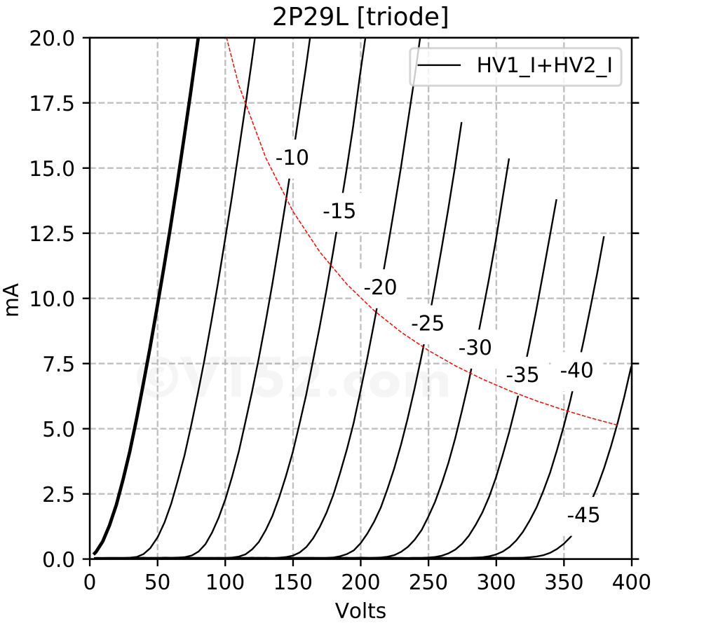

What are the effects of running the tube too hot?
I am testing at 175 B+, 18-19mA (10m45s CCS) , ~5V filament bias, about 130V on the anode. g2 and g3 tied to anode with 100R.
Sounds really great, but after about 30-40m running, I get a spike that pops up without fail at 18 kHz at around 90dBV. Not the end of the world, but running it into the power amp it is 20dB higher. I know our sensitivity at that frequency is down a lot, but still.
It always takes about that amount of time, and it's always the same frequency spike. I'll try backing down to 15ma or below. I know Ale running these at 20ma, but maybe it's a tad hot.
It must be a heat issue, if it only pops up after running for a while, right?

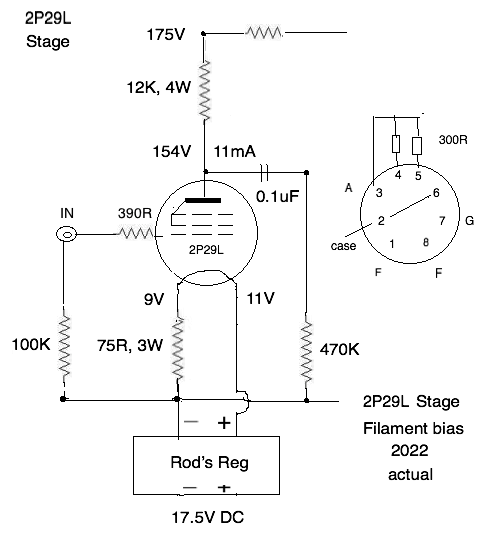

I use a simple resistor load with filament bias and I've not had a problem. I've used a maximum of 15mA. I take the black top off - it just unscrews. Don't know if that helps at all. Sounds good in this setup. Not quite as good as a 112A but easier to use and more common. I ground the cover and the pins that should be connected to ground. Attached circuit but with Rod Coleman older V4 regs. The V9 regs need a supply of 14.5V not 17.5V. The output feeds my 2a3 stage hence the 0.1uF/470K.

Very close to the maximum current of the cathode 20 mA
