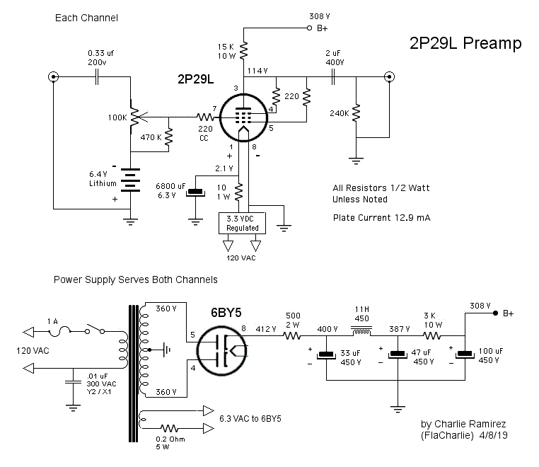

So I've been breadboarding some preamp circuits and wanted to try some "battery tubes" so, of course, the 2P29L caught my eye. Rather than posting to the 4P1L megathread I thought I'd start a new one.
I'm pretty much a copy and paste builder, not a designer, and my technical knowledge is limited, unlike many of the posters here.
I build low cost, "bang for the buck" stuff. So no expensive plate chokes, vibrator loads, output transformers or trick Rod Coleman filament supplies. Just keepin' it simple using a very basic circuit with parts I had on hand. It's a budget build not a state-of-the-art design.
I used a lower voltage PT at first, which worked OK but I remembered the rule of thumb that says a plate load resistor should be 3 or more times the plate resistance. So that meant using a 15k resistor. To accomplish this I needed more supply voltage so I changed the PT.
The current PS is built around a NOS Halldorson PT I picked up years ago at an estate sale. Because the voltages were getting a bit closer to the 450v rating of the caps than I like, I added a 500 ohm resistor between the rectifier and the first cap. It's definitely not optimal but it's good enough for a breadboard.
The 6BY5 is a dual damper diode which I chose mainly for its soft start characteristic and because I have a bunch. Plus I already had one set up on the breadboard. A different rectifier with more voltage drop might be a better choice and would, perhaps, allow me to ditch the 500 ohm resistor.
Four AAs supply -6.4v of bias to the grid.
Before switching to the 2P29L, I was experimenting with the 1LE3 and using a single AA on the filament. That tube only draws 50mA so the battery lasted a good long while - roughly 24 hours.

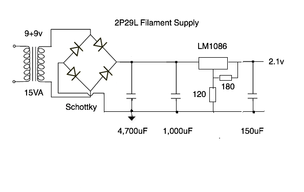

Since the filament current is 150% higher for the 2P29L I decided to try a cheap ($3.55) AC-DC regulated switch mode supply. The output is 3.3 vdc and I'm using a 10 ohm resistor to drop it to 2.1v.
From what I've read, I wouldn't be surprised if this filament supply didn't look too good on a scope. I don't have a scope, all I have is my ears.
I started with batteries, then went to battery in one channel and the AC-DC in the other, then both to the AC-DC. I couldn't hear any difference at all. Not saying there isn't any but it wasn't audible to me.
I added a 6800 uF 6.3v cap after the 10 ohm resistor to see if some filtering would be noticeable. I haven't listened to it with the cap much yet. I'll A-B it next week and see if I hear any difference but I figure it can't hurt whether it's audible or not.
I'm not good at describing what I hear but I find it very detailed yet it doesn't exhibit any harshness. And microphonics are not a problem.
I've used the tube in stock form and also with the aluminum shield removed. The nude version looks more familiar - like a small version of a 7868 - but there's essentially no glow at all.
Here's the current schematic. Comments and suggestions welcome, of course.

your amplifier reverses the phase, isn't it ?
Is your switching power supply still working well?
Regards
This was a preamp, not an amp. Yes, it does reverse absolute phase. As I understand it, every time the signal goes through a preamp tube section it reverses the phase.Hello, your amplifier reverses the phase, isn't it ? Is your switching power supply still working well?

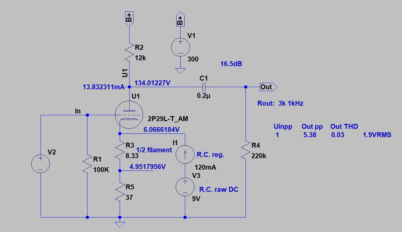

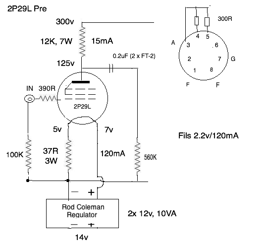

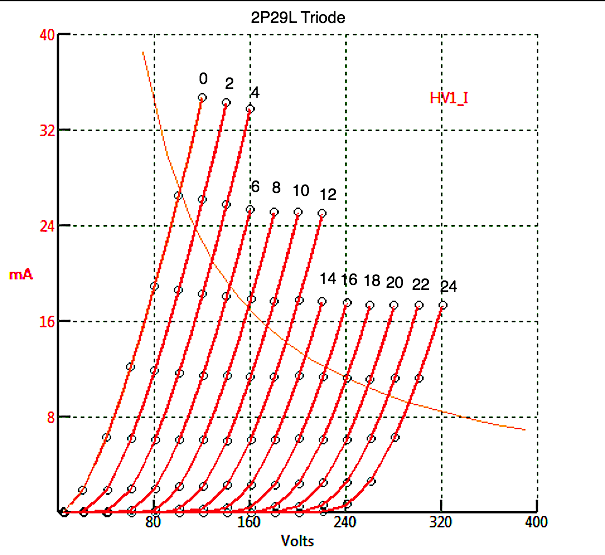

Building a 2p29l pre amp. I am struggling with the miller capacitance/attenuator input resistance with this tube used like this. Surely with miller capacitance of 220pf (ish) the band width of the schematic in post 1 is as low as 15K (ish) with 100k attenuator?
37R*0.12A= 4.44V
The "real" bias voltage -about- 4.44V+1V (Uf/2), about 5.44V.
If your goal is 15mA, the estimated anode voltage is about 132..135V.... but it's depends of tube condition.
https://i0.wp.com/www.bartola.co.uk/valves/wp-content/uploads/2016/06/2P29L-triode-model.png

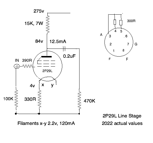

I don't think anybody noticed, but way back at the beginning of this thread this schematic was shared, showing a 2P29L based preamp.
That looks like the 2P29L is wired not in triode, but in screen-drive. Isn't it much harder to drive that tube's screen (g2) than its control grid (g1)?
I don't know how relevant it was to compare this circuit to circuits using a true triode or triode-wired pentode using g1 as the control grid.
