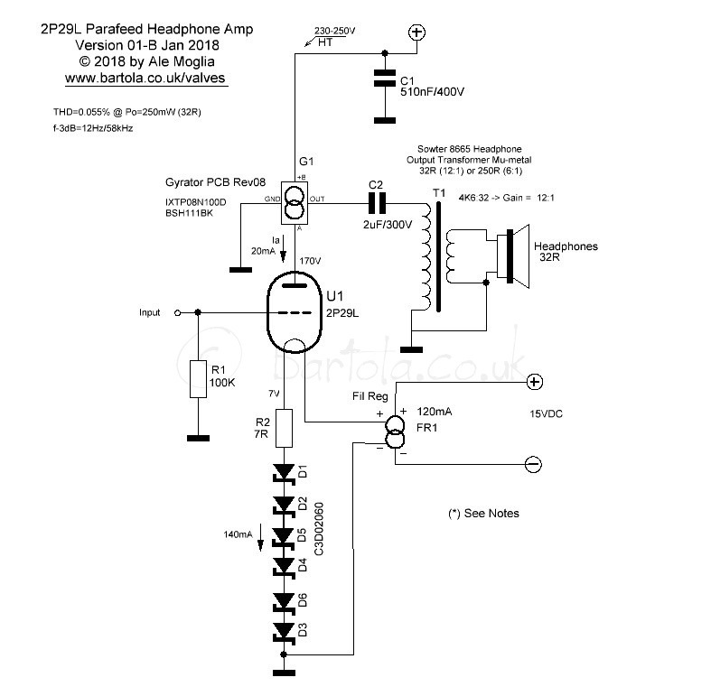

In case you are not aware of the interesting work done a few years back with the 2P29L over at bartola.co.uk.
https://www.bartola.co.uk/valves/?s=2p29l
Below, is one of their headphone/line amp diy designs for the 2P29L
Thanks Ken - Ale is a fan of the 2P29L. He's a friend of mine and we did a big preamp shootout some years ago which you can see on his site. The 2P29L did very well on that. I've stopped using SIC diodes in the cathode and I also prefer a resistor load, so that particular design isn't for me.
You’re welcome, Andy. I‘ve been checking in on Ale’s interesting DHT work from time to time. The 2P29L, in particular, appears to offer a unique combination of benefits. Sort of a sweet spot amongst low-power affordable DHT triodes. I have it earmarked in my mind as the valve I would utilize should I ever build a DHT linestage.

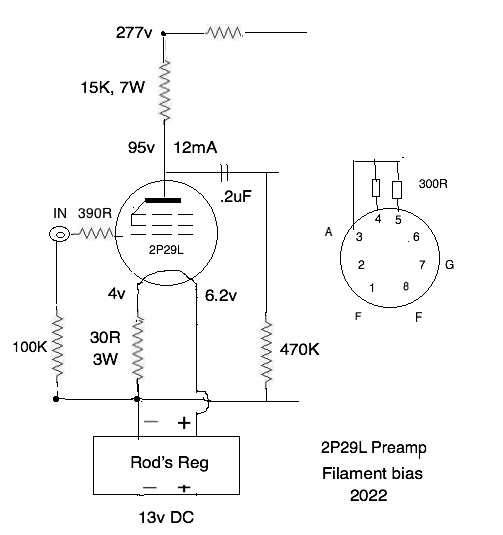

I do want to try filament bias sometime. This 2P29L preamp design was only breadboarded, though, I never built it. During that breadboarding process I tried about 10 or 12 different tube types and I found I preferred the 1626 but the 2P29L and the 6V7G were really nice too - those were the 3 that stood out.

Converted the 2P29L stage to filament bias with Rod's regs. It's really good - it reminds me strongly of the 10Y. The same kind of lively yet refined sound, very involving. Good on everything - bass, mids, treble. Great piano sound, but same for the drumkit, vocals and everything else. I'm loving it - going through all my demo tracks with a smile on my face.
Right now it's acting as the front end of my 2a3 amp. So 2P29L > 6SN7 > 2a3. FT-2 teflon coupling caps. It would certainly improve all those Chinese 300B Sun Audio circuits with 2 stages of 6SN7. It would lift them to the next level.

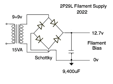

secondaries are connected in series
It's most probably 9V + 9V in Parallel.
9V rms gives around 12.5 - 13.2V DC, depending on the diode types, resistances, load current &c...
It's a 9+9v transformer. So it has 2x outputs of 9v giving 12.7v into Rod's regs. Seems to work OK.
I could tart it up but it sounds fine right now. It could be optimised, of course.

Andy, what’s your assessment of the sound impact of leaving the 30R cathode resistor unbypassed? I realize that it’s low value makes capaitive bypassing impractical without resort to eletrolytics.
The whole idea of filament bias, as introduced to most of us by Thomas Mayer, is to get rid of the cathode bypass cap. I don't think there's a problem with 30 ohms. No need to bypass it, surely? In any case I use DC Link caps as bypasses, but not with filament bias.Andy, what’s your assessment of the sound impact of leaving the 30R cathode resistor unbypassed? I realize that it’s low value makes capaitive bypassing impractical without resort to eletrolytics.

The 2P29L has a rated gm of 2.15mA/V; this amounts to an intrinsic cathode 'resistance' of 465Ω. Adding a 30Ω external resistor makes very little difference - but there is a little linearisation from the Rk feedback.sound impact of leaving the 30R cathode resistor unbypassed?
The low filament current makes for low dissipation in the cathode resistor too - making this DH tube an excellent candidate for filament bias, to the point that there can be few reasons not to bias it this way.
