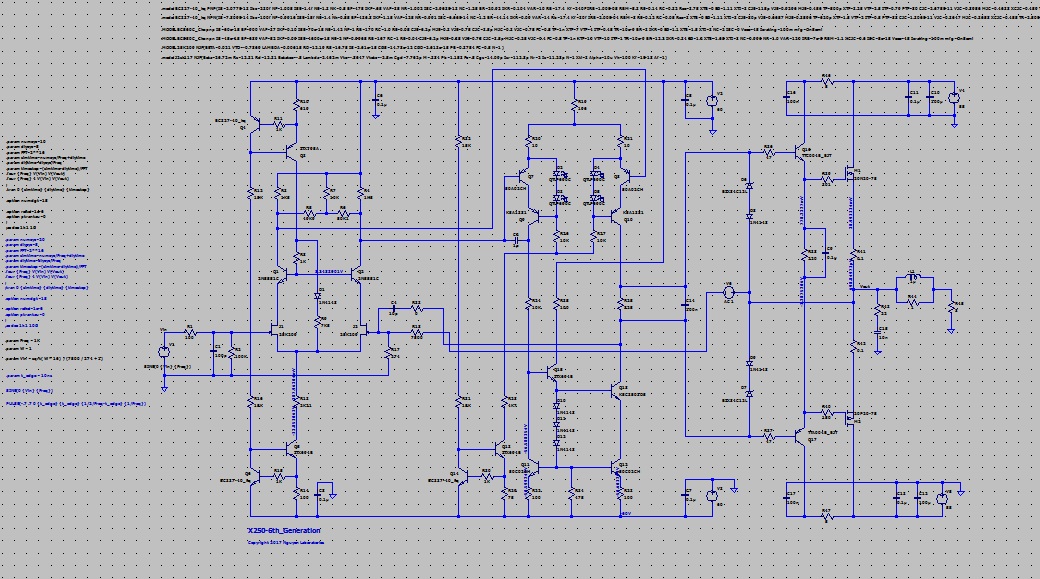

2nd amp from scratch: Low NFB- FET front end - BJT OPS
Here my schematic of 6th generation due all transistors are upgraded to modern components and easily buying.
// Mids are off due sound characteristics of 2SC2922 as it, if you try to replace by ON Semi ones, the mids will be better.
Regard,

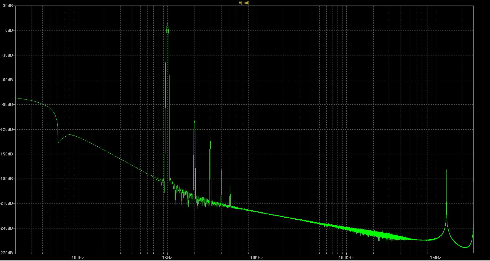

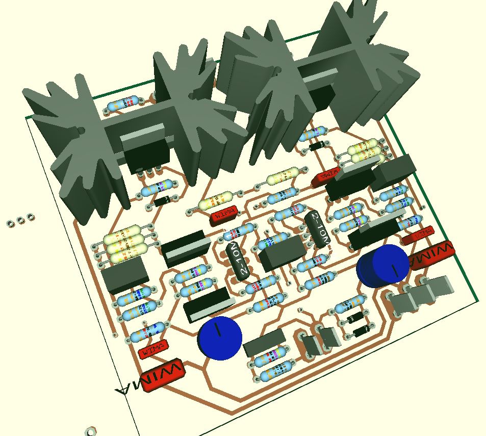

Proto amp is running with stable output stage bias, finally 😉
As VBE multiplier, I used the 2SC3964 bjt, specific designed for this purpose.
Here you can find current circuit, FFT profile 1W 8Ohm speaker load, PCB's designs and 10KHz square wave test into 8R. Compensation needs some further tweeking. Only compensation used at the moment are 2 7.5pF silver mica caps.

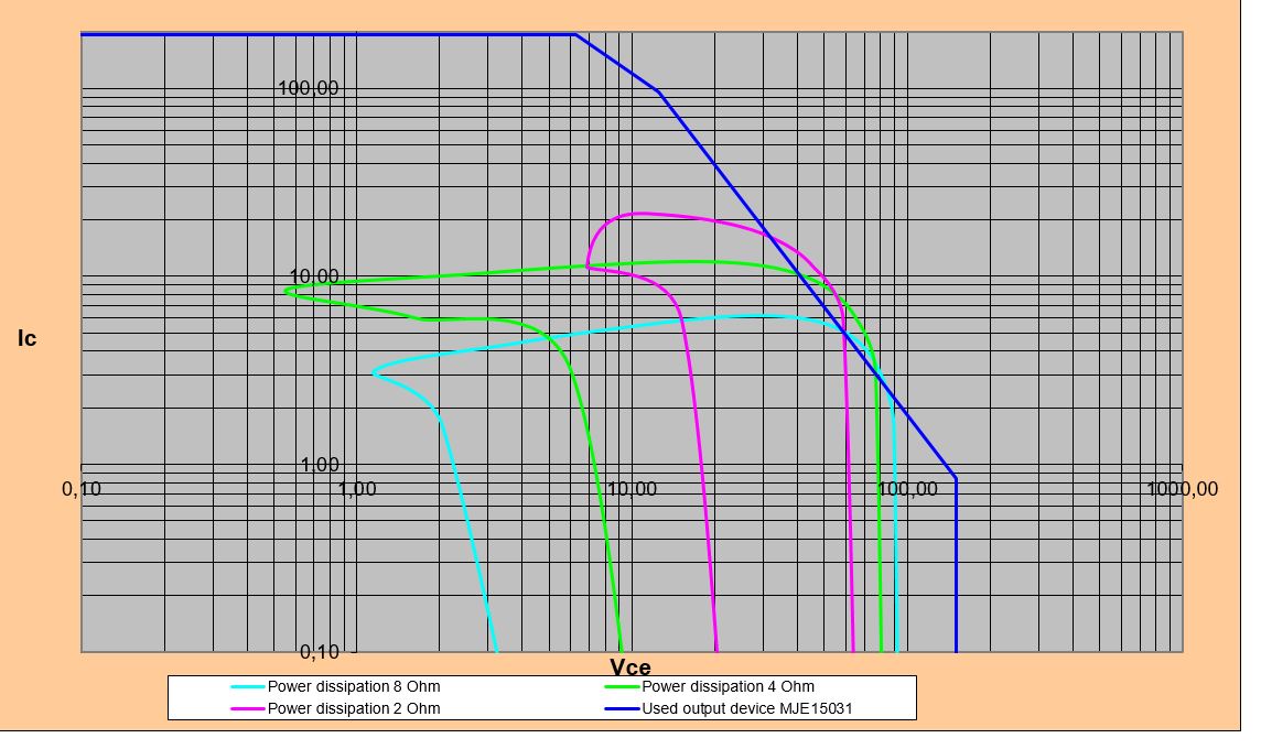

you could use 12 pair of MJE15031,32 with 1 ohm emitter resistors at little to no penalty other then a new layout.
Hi, yes, only if my rails were a lot lower. I'm using +-52Vdc for the output stage.
Enclosed is the SOA curve with 30! pieces of MJE15031 derated at 50°C. This output stage would "explode" with the first hard bass.

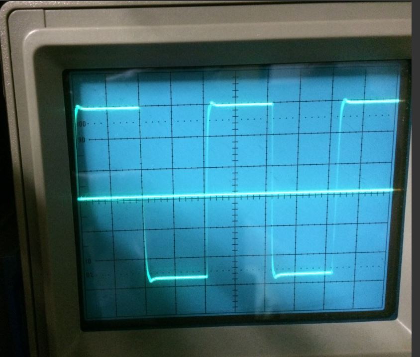

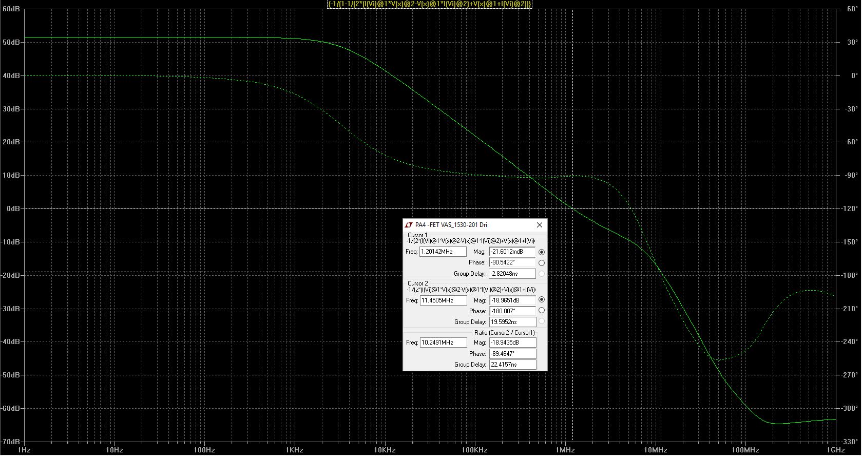

Square wave testing
Played a bit with the frequency compensation and settled today at:
- 5pF Lag compensation
- 7.5pF compensation from Vas Out to Diff pair
Enclosed the several pictures made at 10kHz with different film cap values.
Up to 8R//68n square wave is as good as not affected. From 330n onwards overshoot and relatively good damped ringing is visible.
What is your thought about the square wave respons? Do I need to tweek it further, any advise?
Regards

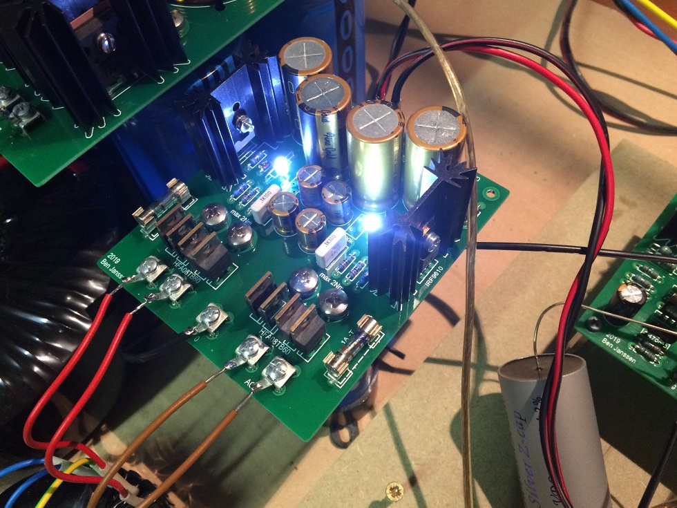

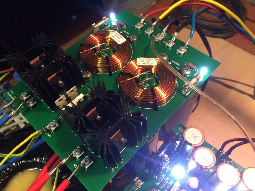

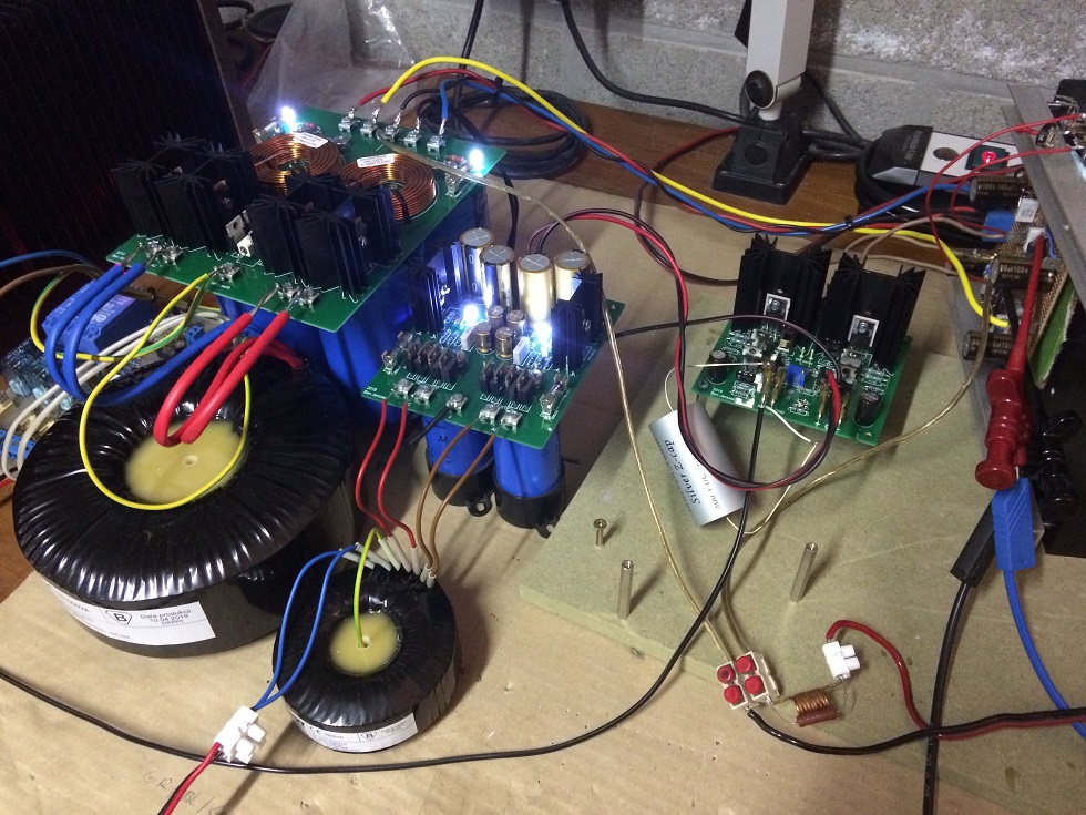

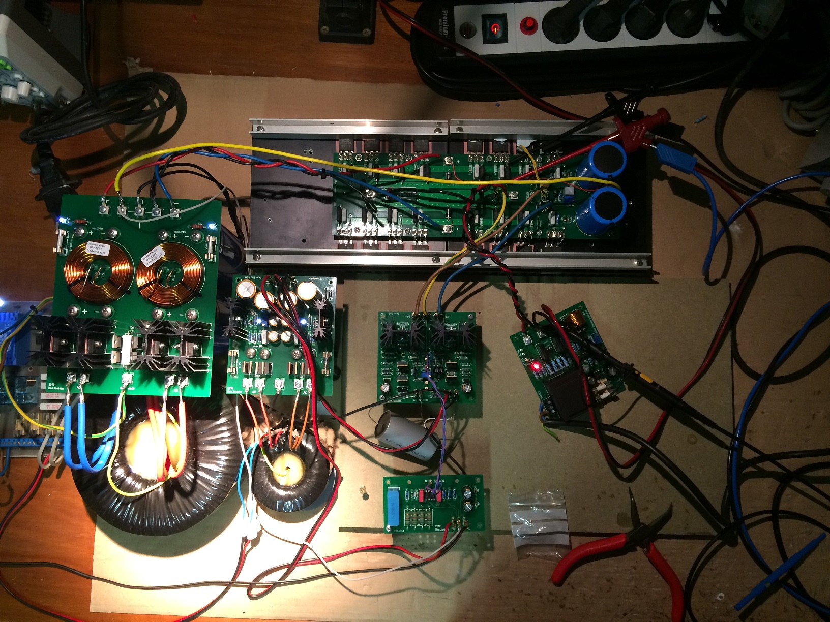

Output + driver PSU is ready
- 1kva toroid / Hexfred diodes dual bridge / 22000µf - 0.18mh 0.11R coil -
22000µf
Front end cap multiplier PSU is ready.
- 50VA toroid with FET cap multiplier
Front end is ready
- Jfet input stage cascoded with lateral TO220 Hitachi FET's and
IRF710/9610 VAS stage running at 30mA
- All resistors are takman metal film and NFB series resistor is charcroft Z-foil

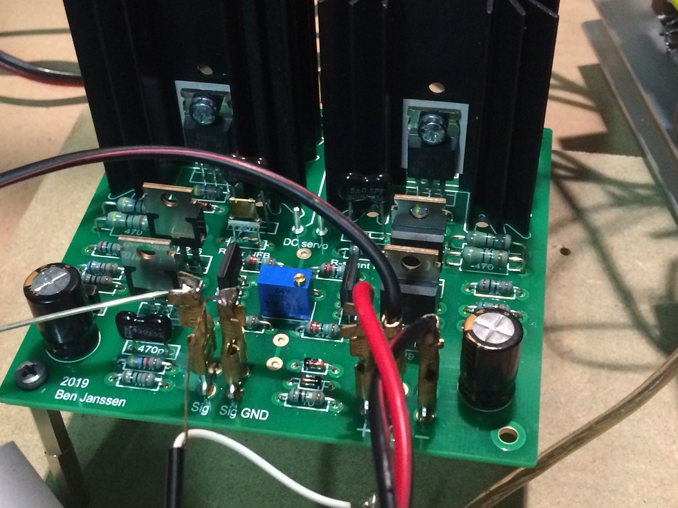

Output+ driver stage and DC-servo PCB design is currently work in progress.
I am very happy with the quality of the PCB's (made by JLCPCB).

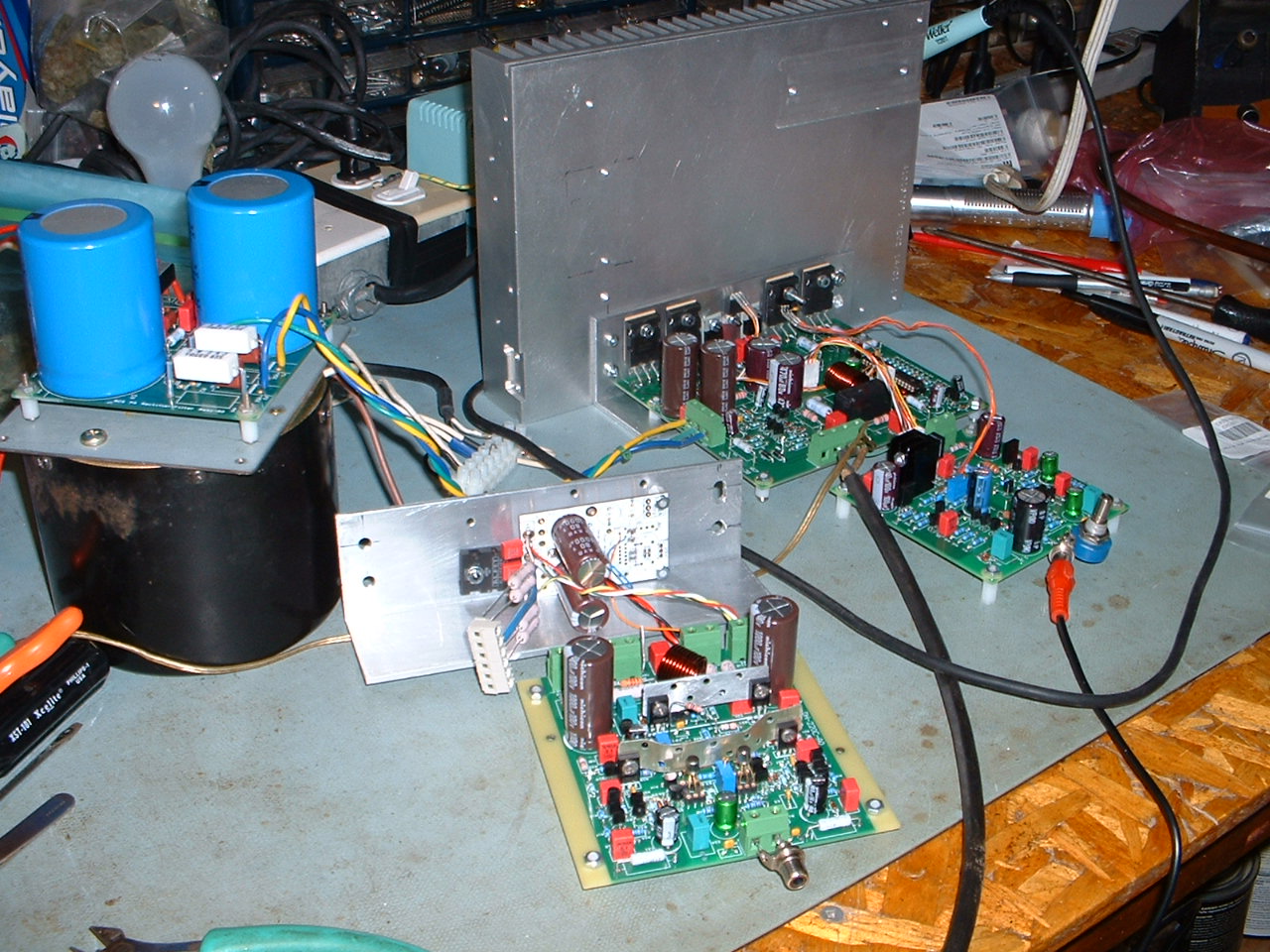

As a comparison, here is a pic of 2 new Bob Cordell amp designs, a traditional all bjt with 2 pair of MJL3281/1301 and a DH-220C driving a pair of dual die lateral fets.

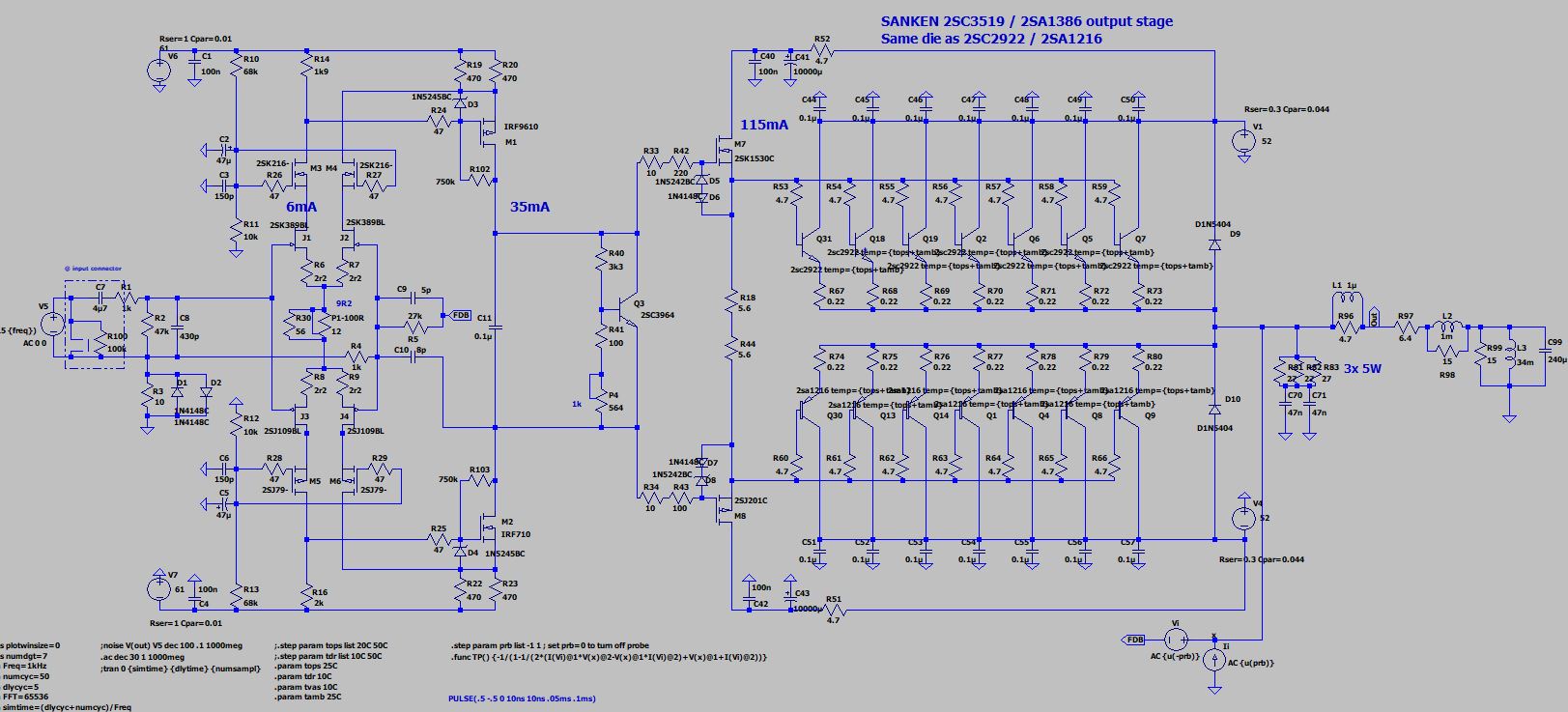

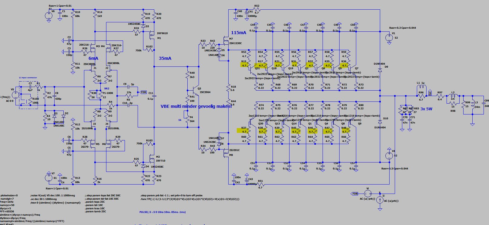

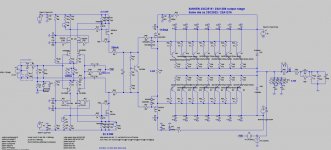

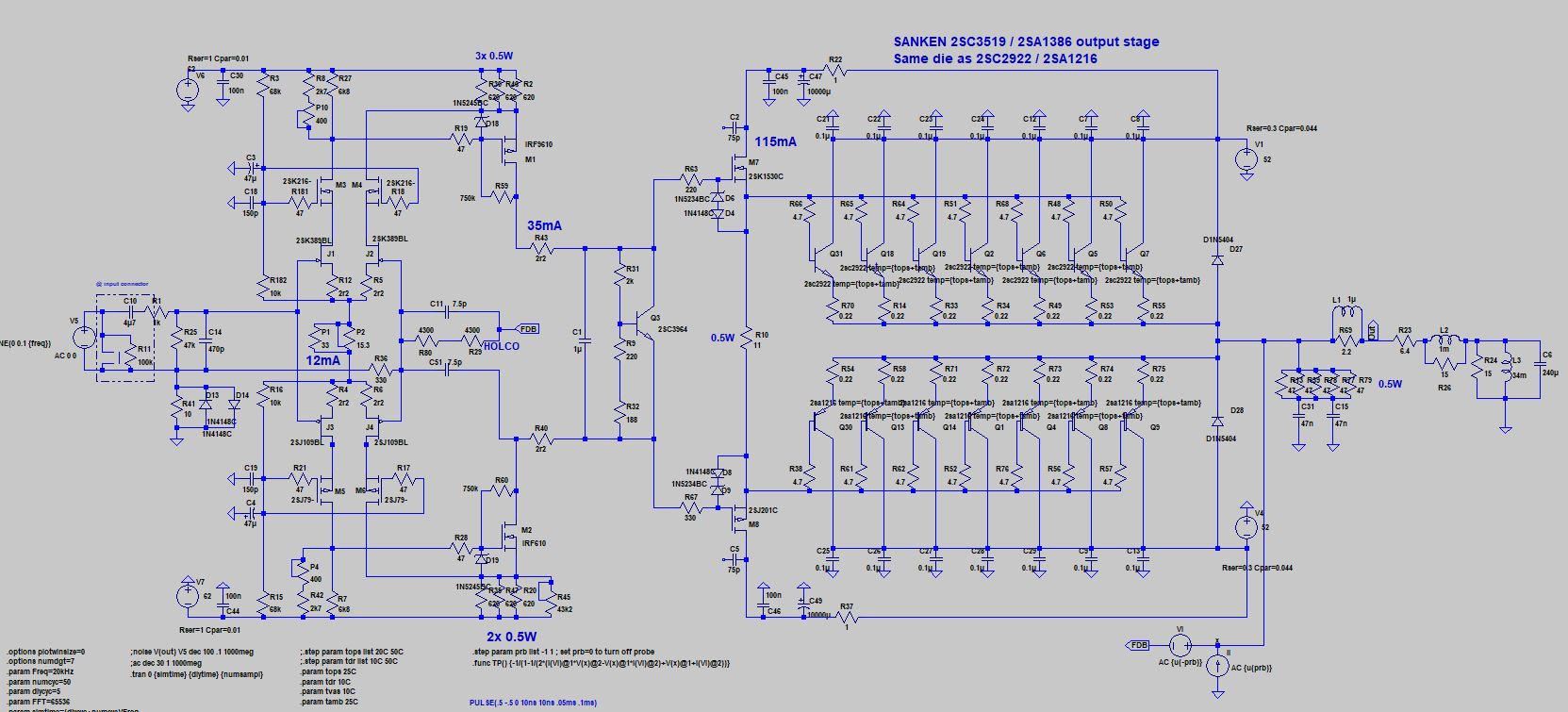

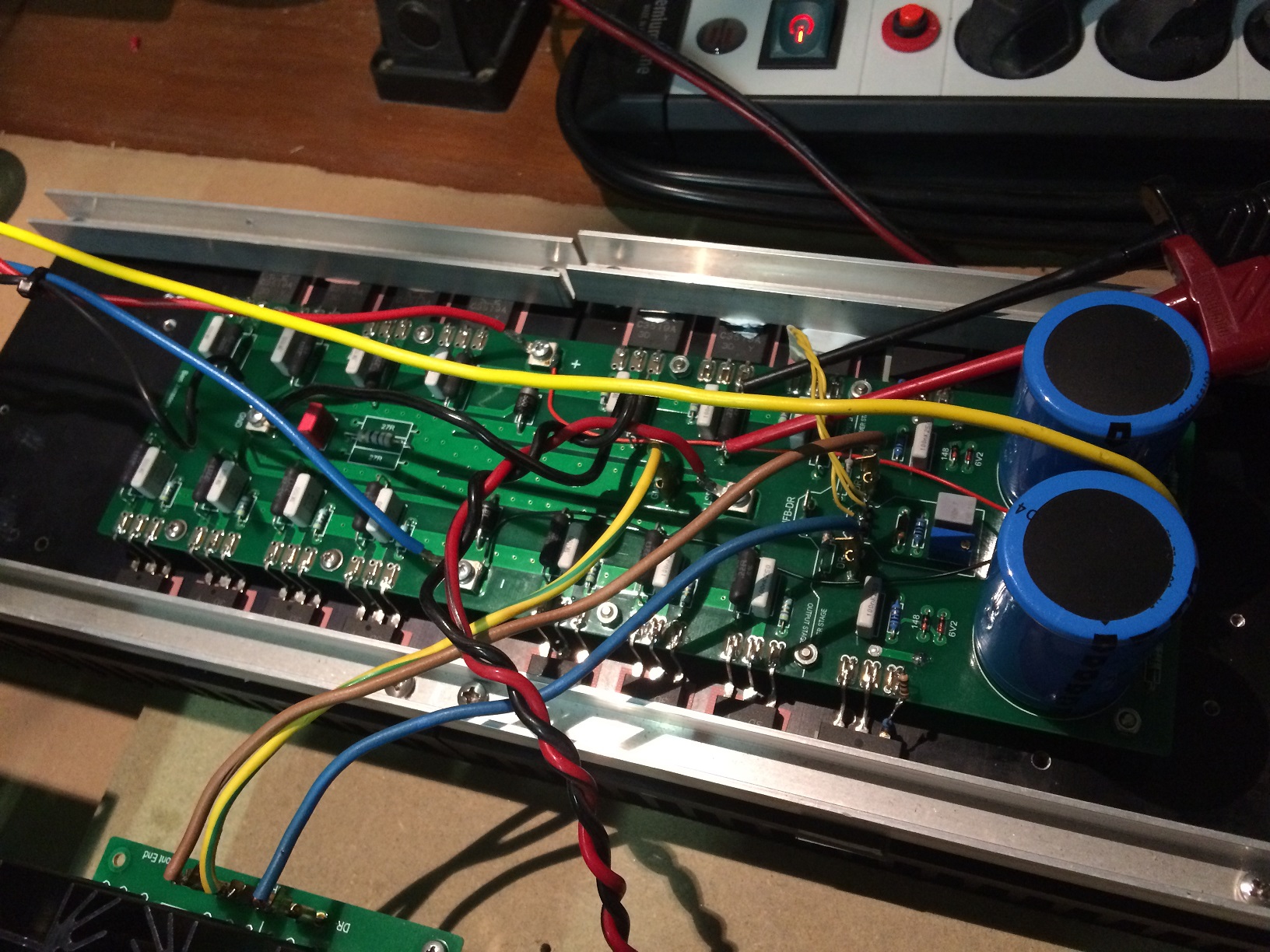

Fully build amp...but
I've first build the OPS with only 1 pair of BJT output devices (2SC2922+ 2SA1216). Frequency compensation is finetuned to get nice square waves and stable amp (tested with 10meters of speaker cable and R//C loads.
Than I decided to mount all output devices = 7 pair 2SC3519 + 2SA1386 (same die as the 2922/1216). BUT then: when I am increasing bias current to reach the amp starts to oscillate heavely. Increasing C10 helps to stabilize it again.
(Output stage PCB is still prototype ans mounted on some old heatsinks.)
I haven't changed anything else but the output devices. LTspice is not confirming other GM and PM when chaging the amount of output devices.
Is anyone els knowing this phenomenen?
All info is highly appreciated. I'm near to completation and like to finaly start enjoying the music.
You have a very beautiful chart, just now I saw it on the site. Consequently, the distortions also have such excellent parameters. R6 R7 R8 R9 these resistors can be removed. Distortion at small amplitudes will become even smaller, and at large amplitudes it is likely to remain unnoticeable.
As they say in Russia, an elegant aircraft flies beautifully.
What chart do you mean?
Having resistor there is sometimes very convenient for determine the current flowing there. 2r2 was the smallest value I could purchase from Takman metal film resistors.
Concerning the oscillations I'm having with running 7 pairs output devices: I'm measuring 4,8MHz oscillation.
Have no idea what the root cause is for this. Will first have a trial with doubling the base stopper resistors from 4r7 to 9r4, see what this brings.
I do not mean a diagram, but a beautiful scheme.
Check in LTspice distortion greatly fall without these resistors R6 R7 R8 R9. Resistors for monitoring the current in LTspice can be put 0.00001 Ohm. And in the real circuit they are not needed at all, few people put them even in industrial amplifiers.
https://www.diyaudio.com/forums/att...ow-nfb-fet-front-bjt-ops-circuit-31072019-jpg

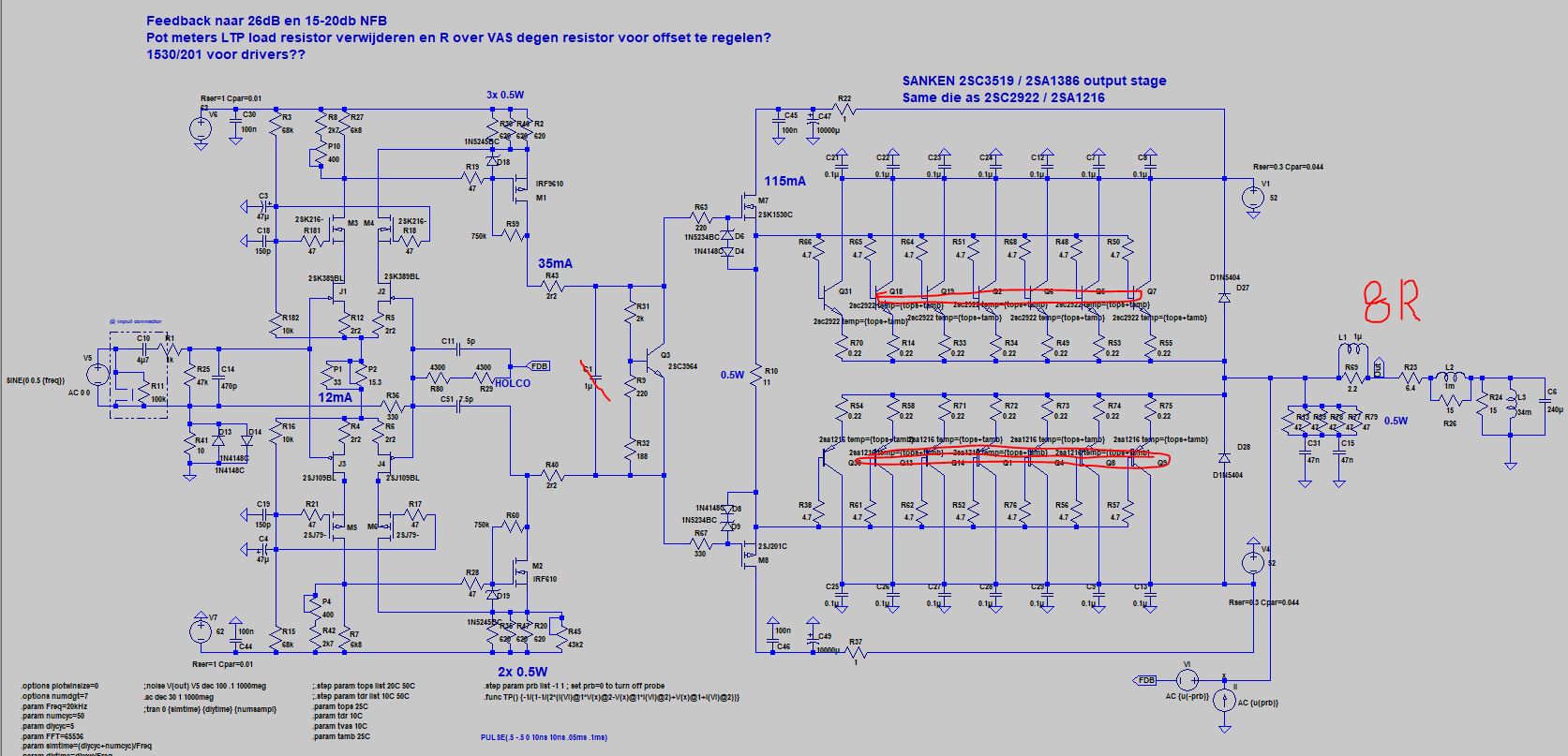

Test with higher base stoppers OPS
I added an extra 4R7 base stop resistor for each output device.
I gently increased the bias and from about 15mA throught the output devices, the amp started to oscillate again at about 5MHz.
When lowering the bias again I notice also oscillation only when the amplitude of the input signal is high when playing music, at lower amplituded/passages the oscillation stop again.
Any advise what to try next?
