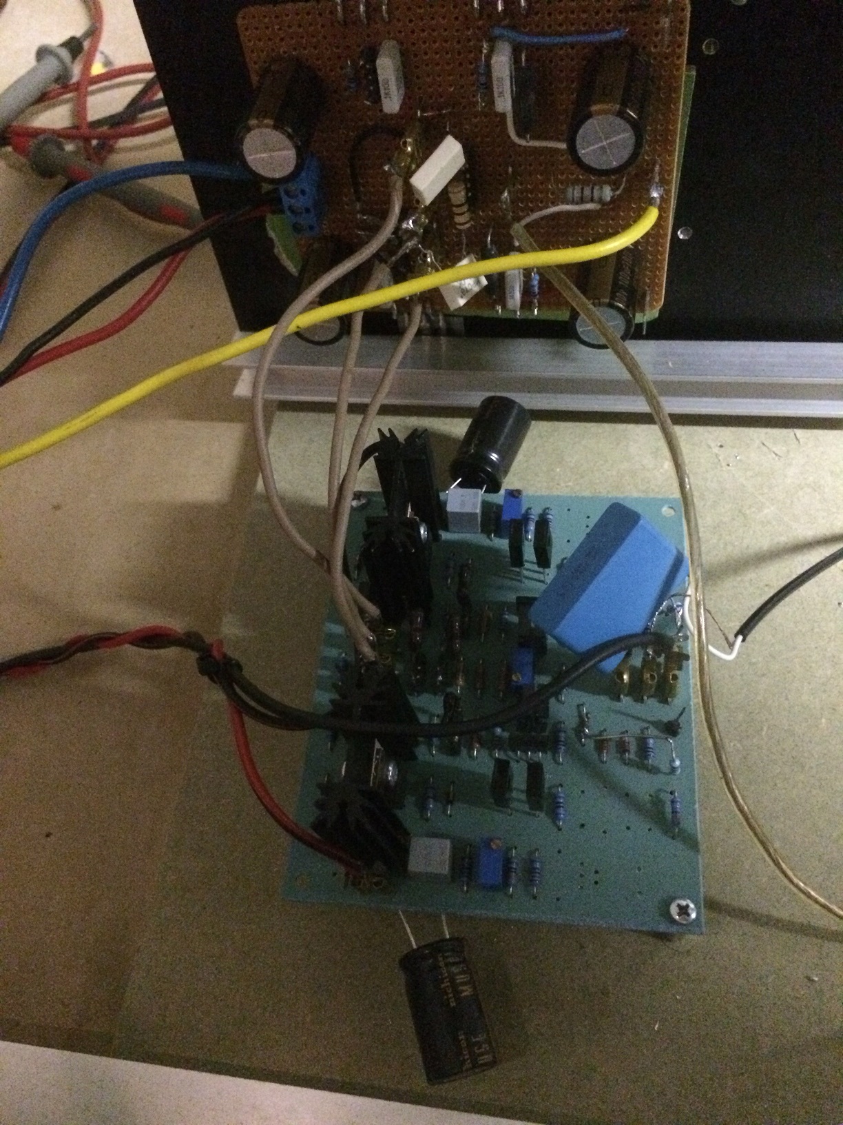

Thank you for continuing to share your ideas and progress. Using the wooden power supply test board for the first amplifier prototype is an efficient strategy. You can easily test improvement ideas before any chassis metal work is started. Have you considered putting the regulated driver power supply on the driver circuits PCB? Not the bridge rectifiers and transformers, just the regulator and capacitors. A single star ground must still be maintained: wires or short bus_bar
Two ideas for large Sanken packages:
1) Instead of trying to align all of the package screw holes, you can use a long square aluminum "pressure bar" that goes in back of all of the transistors and only screw this bar into the heatsink. A screw between each Sanken package. Easier assembly. Easier repair/rebuild. Some additional heat removal.
2) For a Vbe multiplier bias circuit, you can "wrap" the collector lead of a few Sanken transistors around a diode for modestly-quick thermal time constant monitoring. Thermal grease helps. Teflon/plastic tube on the diode leads helps to prevent electrical shorts. There are physically small diodes with good thermal conductivity.

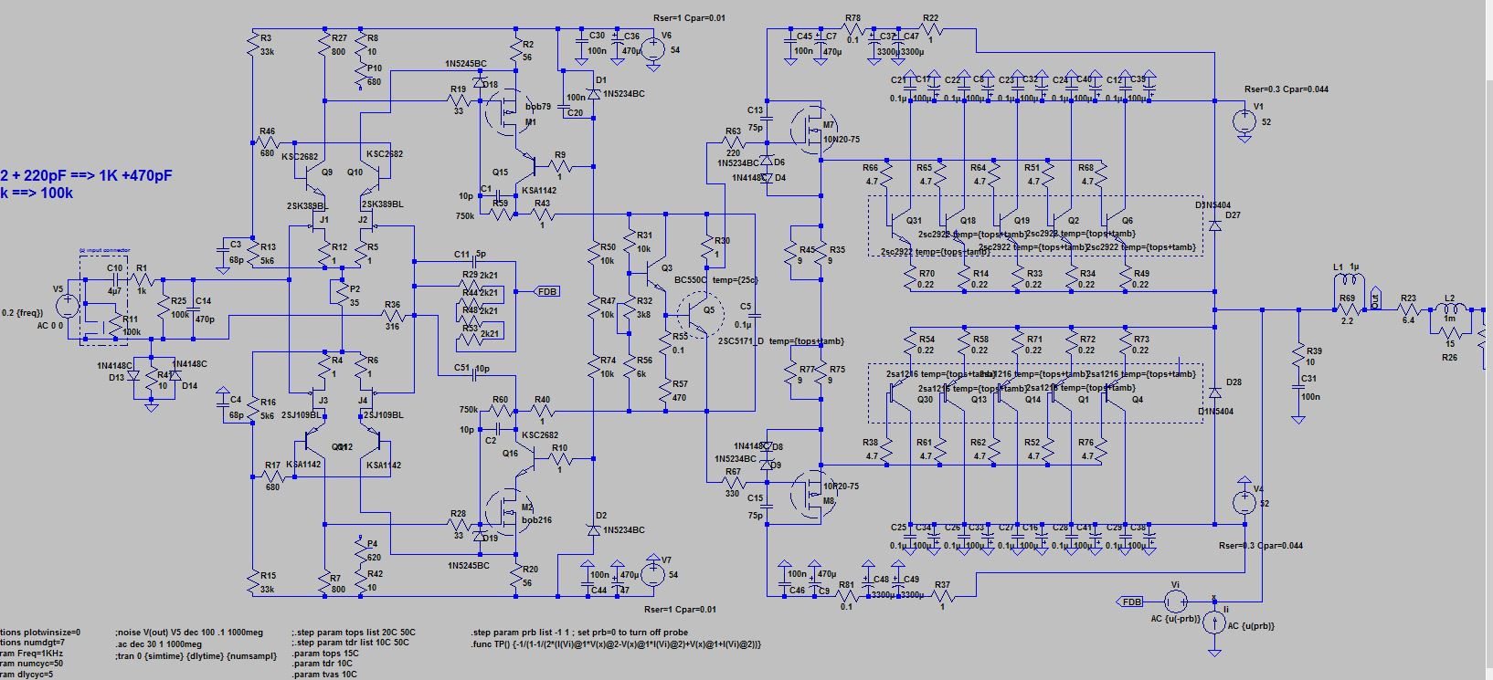

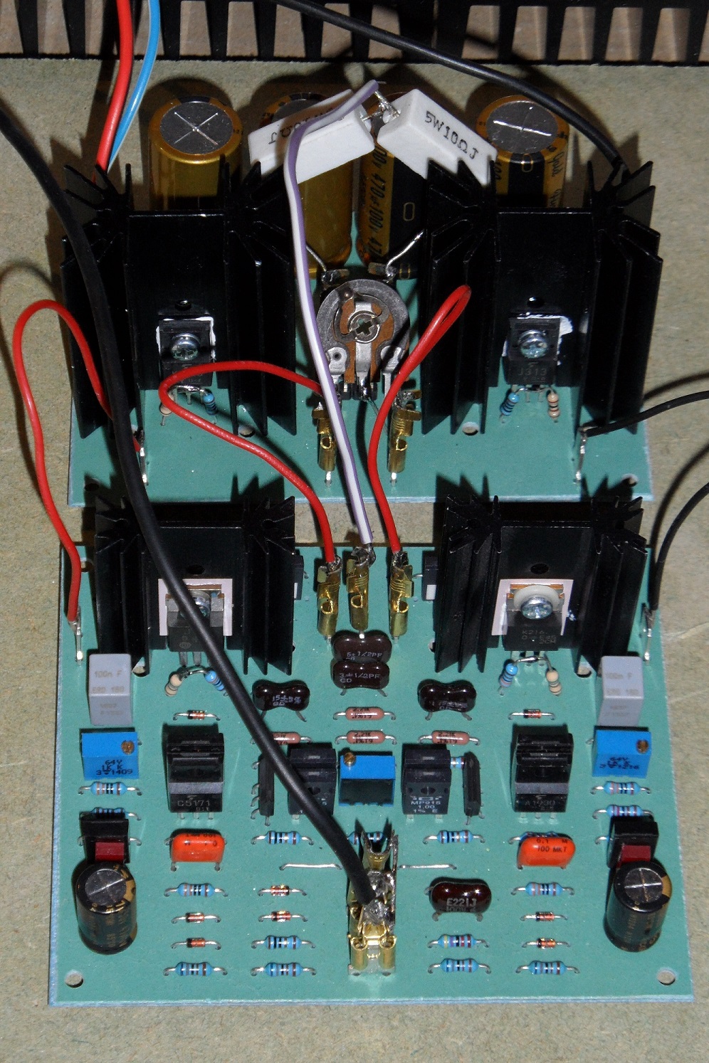

Front End build = oscillations
The front End and driver section is finally build. (became a father for the second time a month ago).
During measuring I noticed a 40Mhz oscillation with a Vpp of about 250mV (see scope picture). The simulated AC analysis however gave me a good feeling regarding stability; 76°PM and 20dB gain margin (see 2nd picture). Again a good example between a simmed and build circuit, certainly when mosfet models are used.
However, now I know I have stability issues I have to solve them. After looking at Classé and parasound circuits, the main differences are:
1. higher freq compensation value for capacitor from VAS output to diff input
(I'm using 5pf, see picture circuit AS BUILD)
2. much higher values for feedback resistors 100K vs 8k8 in mine. However,
spice gave me worser stability when using higher values here.
All input is highly appreciated.

Thanks alot for this tip! Did not think of that by myself. It seems to work: at the moment I have 68pF between each base and collector of the cascode bjt's and the oscillation level dropped already from 250mvpp to 20mvpp!
I used the RC combination at the bases as proposed by Bonsai in one of his excellent papers, appaerently it does not seem to work in my configuration while I tried several RC combinations whitout effect.
But how can it be that many oem's get away without this cap between base and collector at their cascodes???
It may also potentially come from the drivers. N-channel FETs have always got lower input capacitance (Ciss), than the P-channel ones. At 70mA quiescent current it may play its role, unbalancing the driver stage at HF.
The difference is around 40pF (170 and 210 for N and P respectively), so you may want to try adding 39-47pF in addition to C18 to compensate this difference.
The extra cap as proposed by Dimitri has some effect, but I haven't been able to remove the oscillation completely.
Because they are not needed. Your C1, C2 are too low, try 100 pF trimmer caps to find sweet spot, definitely some compensation work ahead.
I've tried to increase the miller cap and even remove it, the difference wasn't even visible on my scope.
This was definetely in the good direction. I've tried several values to compensate the difference between the P and N-channel device. However, the best result was to remove both capacitors.
Please find below some trials and their results. I'm still having 25Mhz oscillation with a 10mvpp oscillation.
All ideas are welcome!

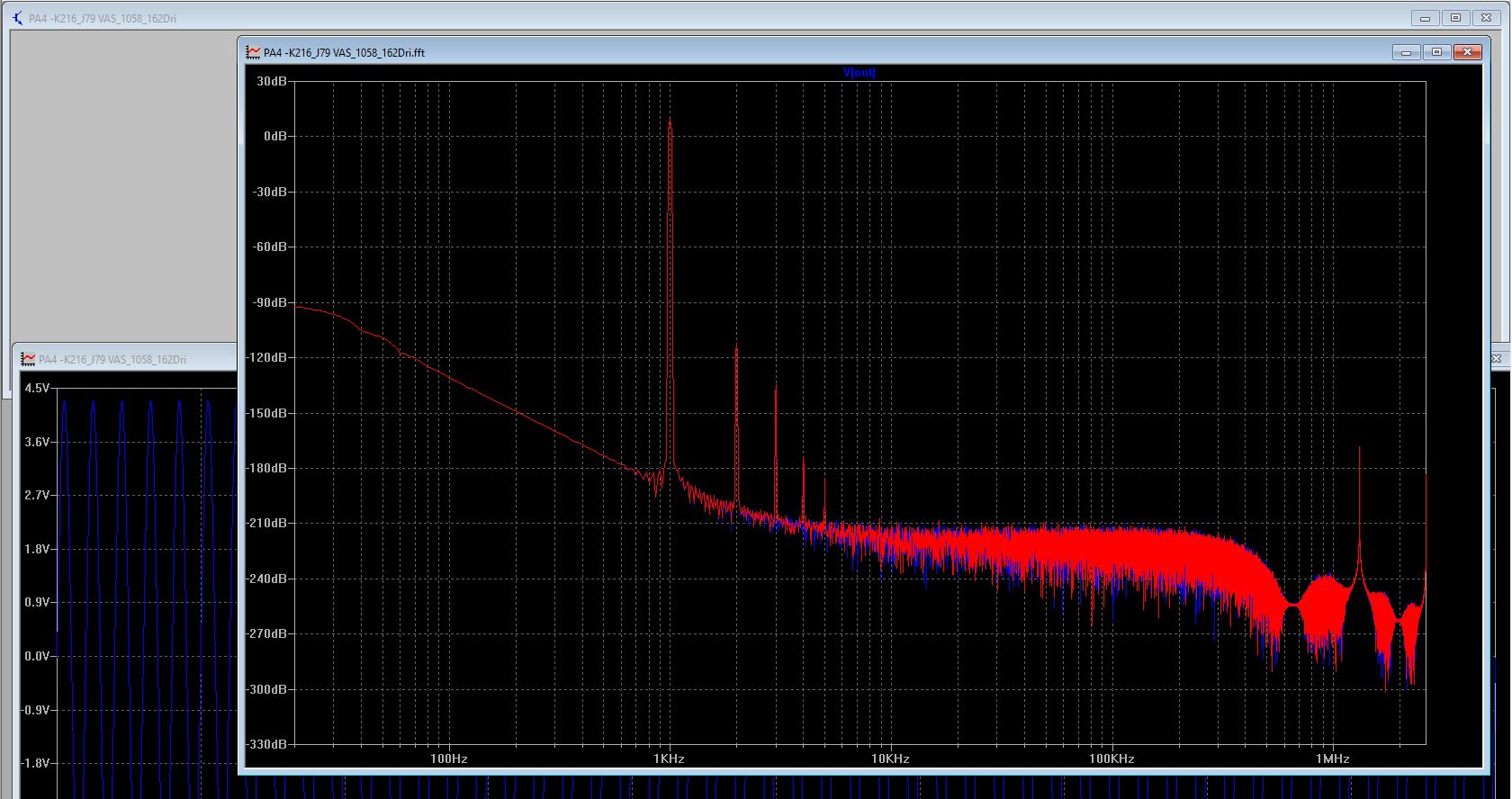

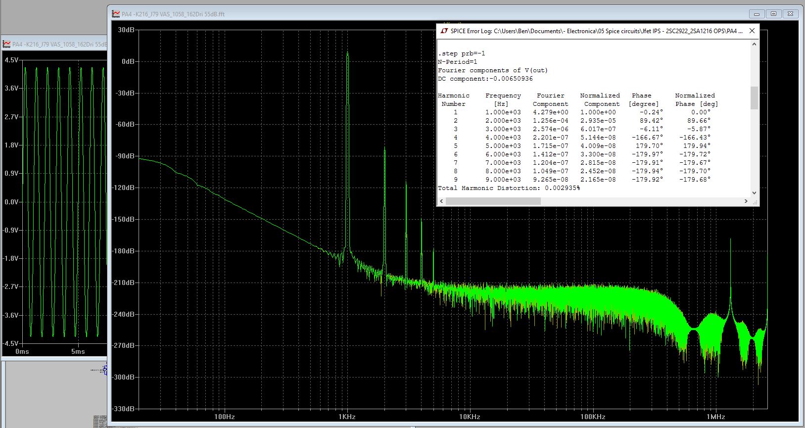

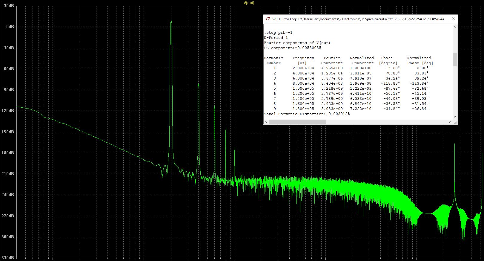

Years have passed, kids grown older (4.5 + 2.5years) and got some free time.
I've got a proto version running with 1 pair of output transistors. I only can compare it with my previous build (http://www.diyaudio.com/forums/soli...n-subwoofer-wideband-duty-13.html#post3382545) and a denon PMA700V.
This proto version "opened up" the music a lot more compared to my previous build which I found better sounding than the Denon. And keeping the same resolution and detail, I'll blame this on the Fet drivers (Profusion lateral Fets) and the Lateral mosfet Vas stage (2SK216/2SJ79).
Now I need to tweak the VBE multiplier and compensation caps.
All remarks/ proposals are welcome.

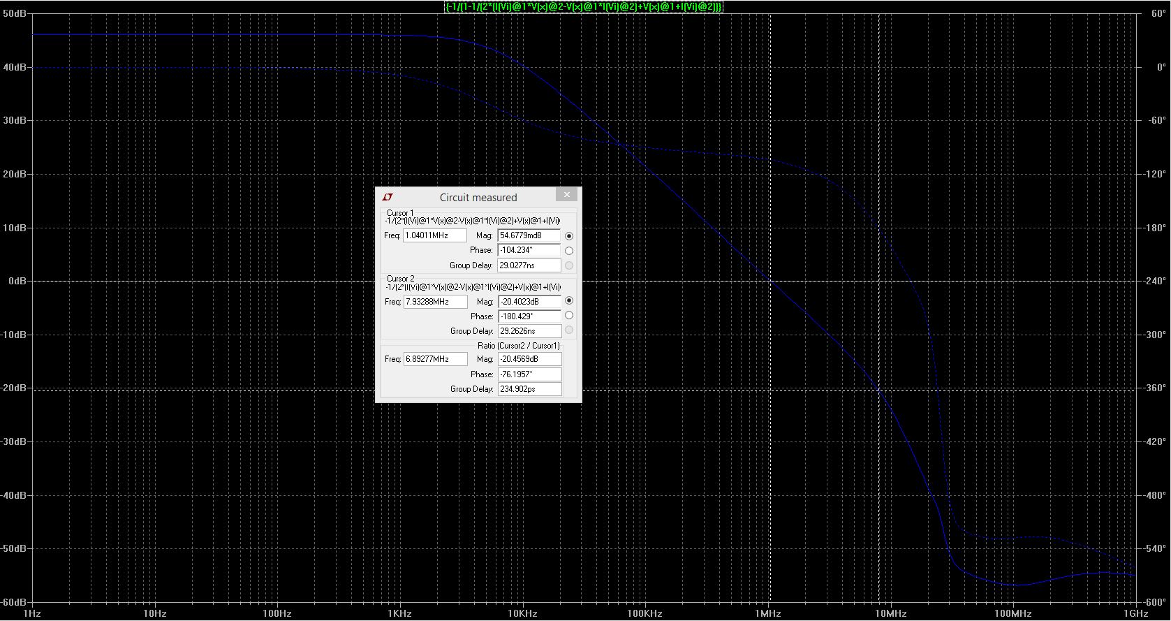

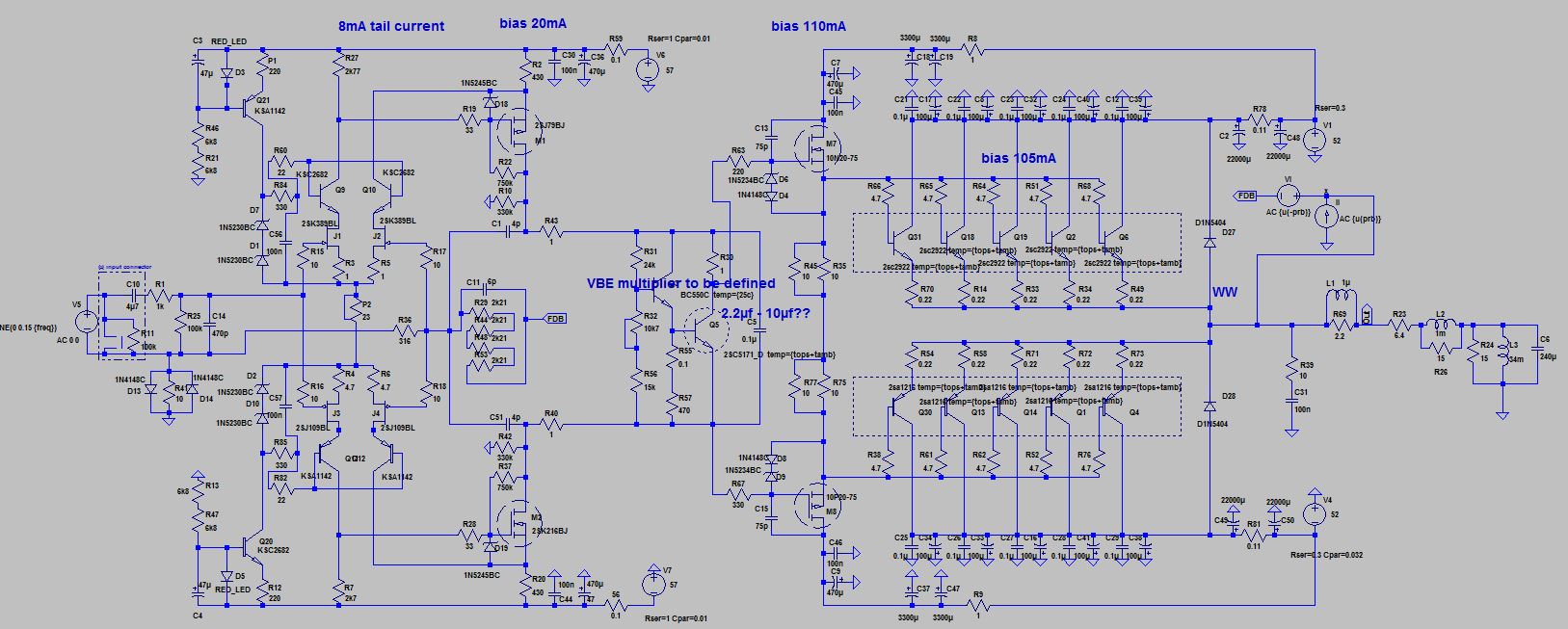

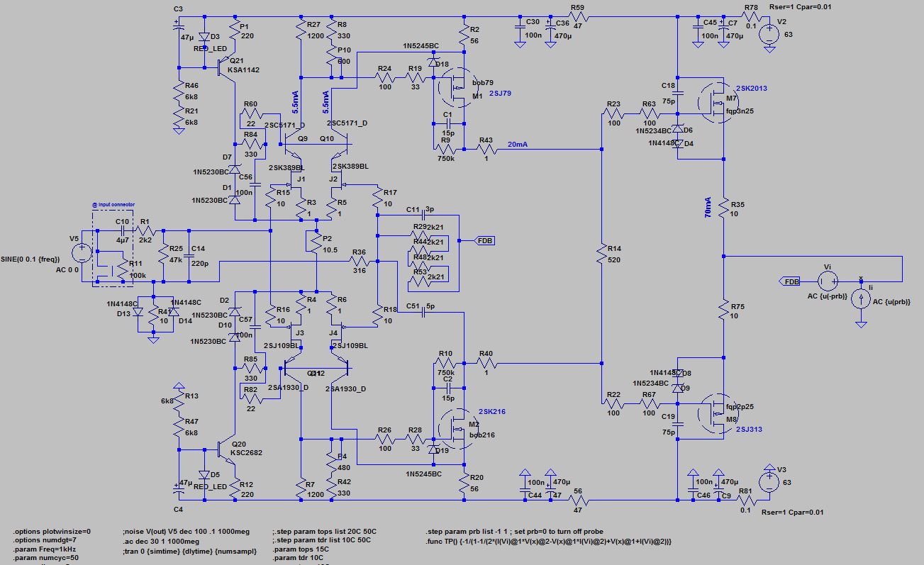

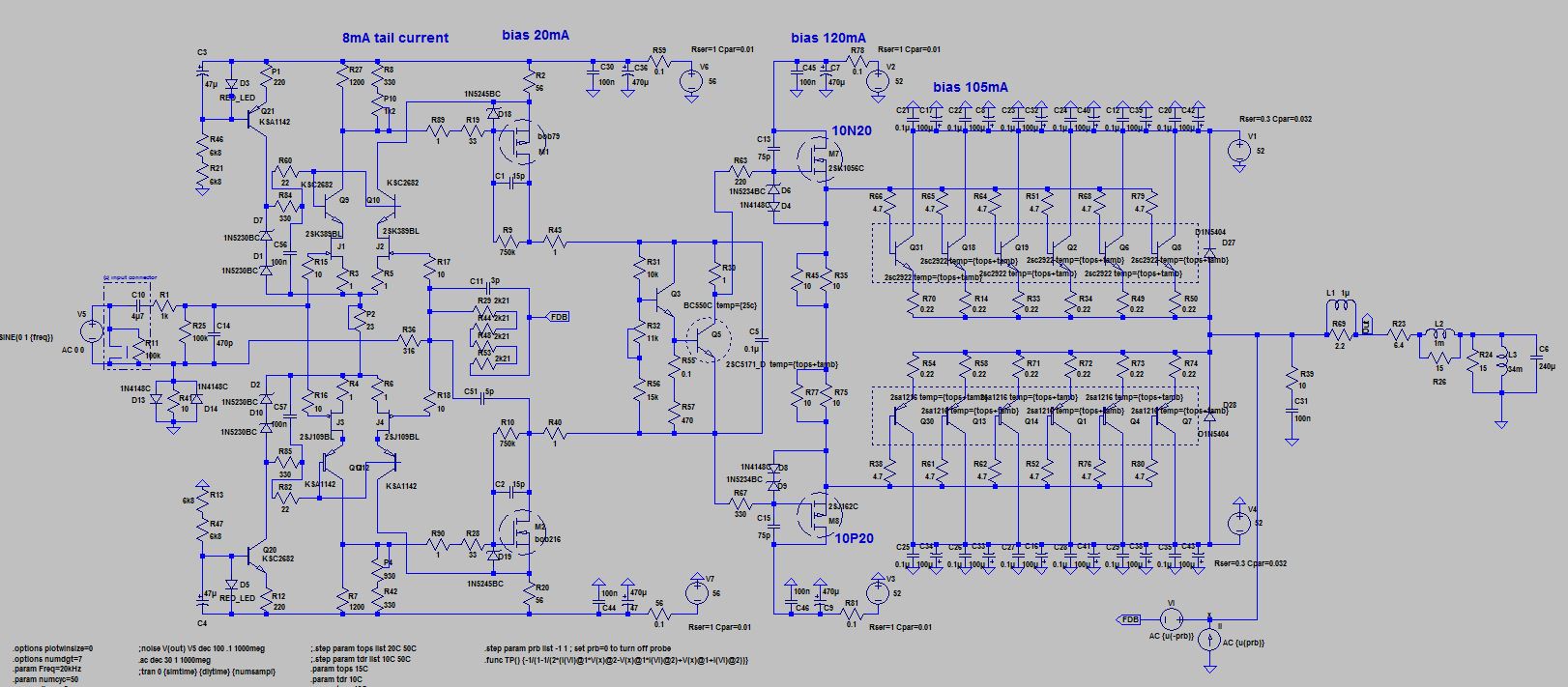

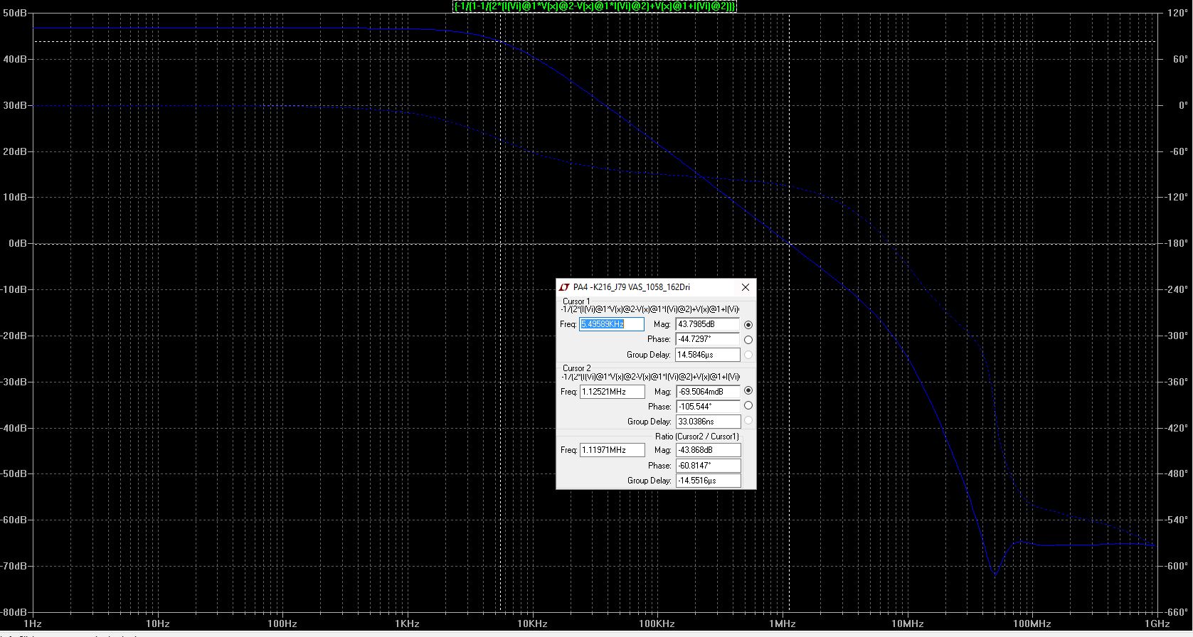

During some stability testing and tuning the Spice Mosfet models to have datasheet like transfer curves, I've noticed excessive gain.
Apparently in this design, the drain (load) resistors from the Jfet input stage are leading in setting the OLG instead of the VAS emitter degeneration resistors. To reduce the OLG, I need to lower VAS degeneration!?
Also the total amount of frequency compensation caps could be reduced a bit more, according spice. Measurements have to confirm this.
Following circuit I hope to test shortly.

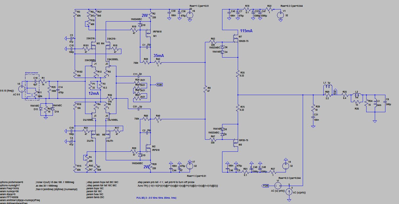

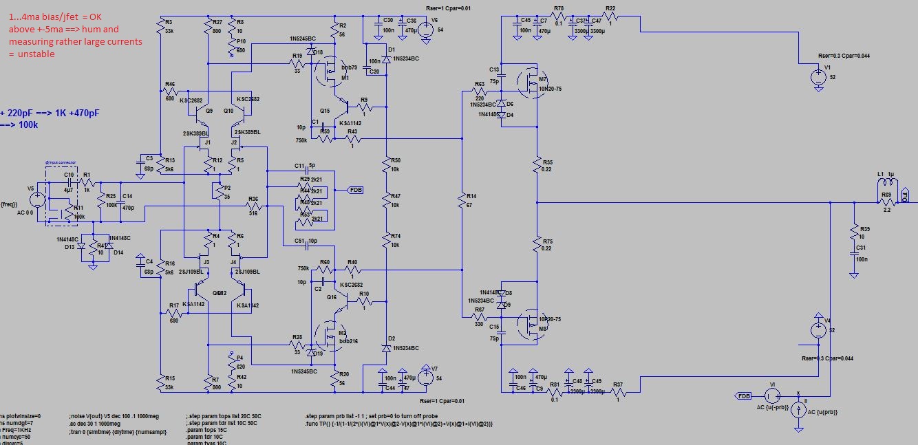

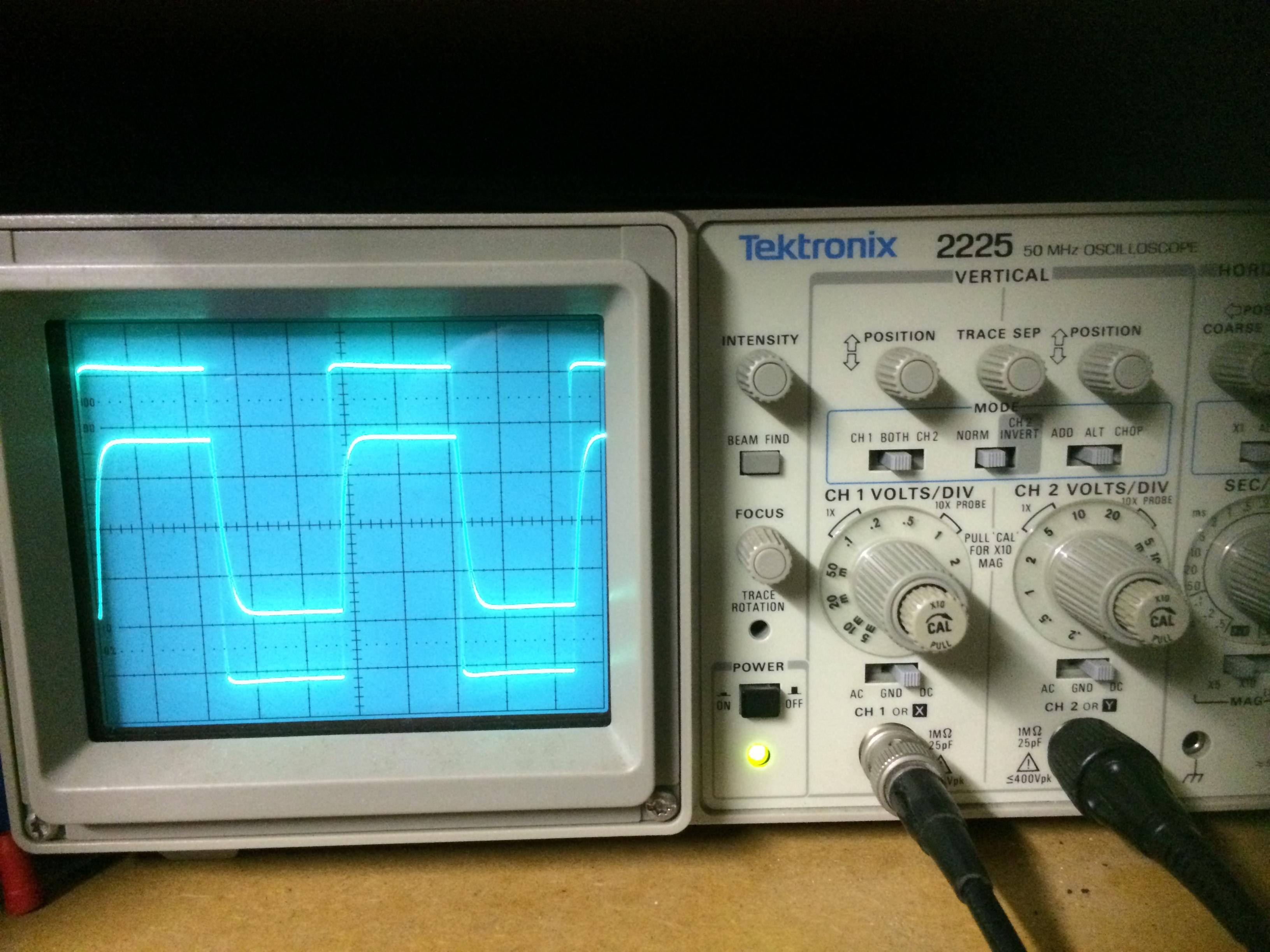

I noticed a rather high amount of hum through my test speaker. It appeared to be a +-100Hz signal with an amplitude of +-50mVpp.
What have I done:
1. checked PSU voltage with oscope ==> all looked fine
2. tested with all kinds of small bypass caps on zeners IPS and VAS cascodes. ==> NOK (hum still present)
3. removed hawksford cascode in VAS, only Lat fets as VAS ==> NOK
4. changed hawksford casode in IPS to cascode referenced to GND ==> NOK
5. changed CCS for cascode reference IPS to series connection of resistors ==> hum decreased to 10mVpp
6. increased base stopper cascode BJT's IPS to 680Ohm ==> hum decreased to +- 1mvpp. I can hear a very very tiny hiss when keeping my ear against the speaker.
7. implemented the cascode in the VAS again, but this time no hawkford. ==> still OK.
With the current status (see testing circuit below = without BJT OPS), 20kHz 30Vpp in 8Ohm//100n is as good as perfect. 100Khz square is also super (will take pictures next time!).
BUT, currently I'm having 3mA Bias current for the input Jfet and would like to increase to 7..8mA.
During increasing of IPS bias and keeping VAS bias to +-25mA and DC offset to a few mV's. Once the bias is at +-5mA, a big hum appears in my speaker and current increase everyware, is way to much.
Now, what is going on here?? I have to reduce the IPS loading resistors to maintain VAS currents, so OLG is lowering. Also Spice is not helping me to reveal this. Why it looks like the circuit is getting unstable??

With the help of some forum members I managed to get rid of the hum completely. Main reasons for the hum were IIRC:
1. VAS cascodes
2. voltage references for JFET IPS cascodes
3. increase of drain resistors FET VAS devices
More here: Cascode JFET IPS oscillation - getting crazy
Now that this was solved I tested different VAS devices.
1. 2SK216/2SJ79 lateral Fets: Very good detail and contrast
2. 2SK2013/2SJ13 Vert audio Fets: Less detail, more muddy sound
3. IRF9610/ IRF610 Vert Fets: same as 216/79 but more musical sounding, better soundstage.
I really had in mind the 216/79 would be best, so I tested different bias currents, lowered IPS bias and increased IPS drain to resistors to increase IPS gain, played with different VAS drain/degeneration resistors. NO result was better than the 9610/610. So I left the 9610/610 in as VAS Fets and used 216/79 as IPS cascodes.

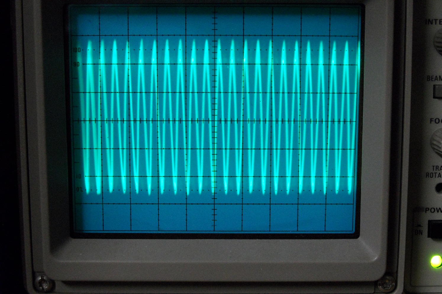

Below is current circuit, still without BJT output stage and some square wave testing 20Vpp at 20K,50K and 100Khz in 8Ohm.
