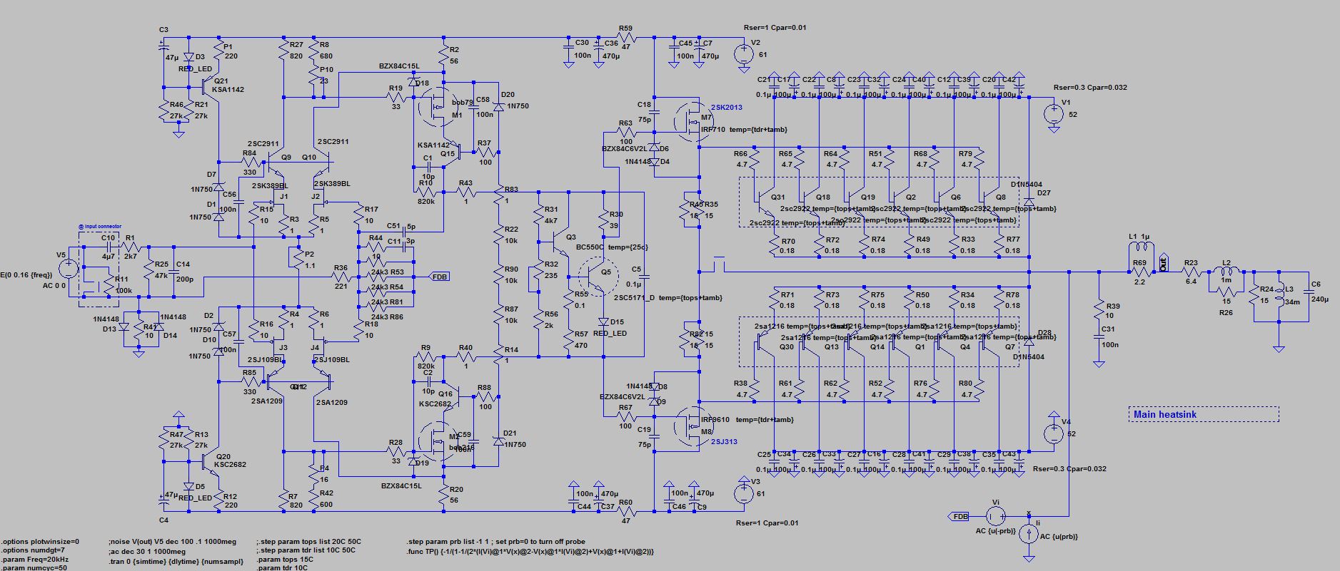

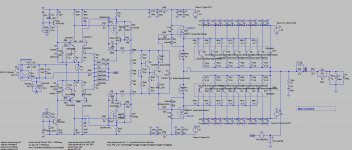

2nd amp from scratch: Low NFB- FET front end - BJT OPS
Update starting with PCB's
I've made a few changes after several months reading on the forum and other literature (Cordell, Douglas S, Hifisonix...)
Have look at the schematic please. In the pdf document is some more info and some simulation results.
Any advice/remarks/questions are welcome.

Looks very nice to me.
An alternative, not necessarily better, is to replace the driver FETs with pairs of bipolar transistors in a Sziklai / CFP arrangement like in the Roender amplifier (which I copied into my TGM3 amplifier). The possible benefit is that the two drivers (p-type and n-type) will be better matched than two FETs (n-mos vs p-mos) and yet still provide good isolation between the input stage and bipolar power output stage.
One of my goals was to have relatively high class A power. A cfp performs better with low bias current if I remember correctly.
In my previous amp I noticed much more details in the music when I switched from bjt to FET drivers. FET drivers are a must for me to start with.
Regarding your TGM3 amp, I must admit, it's a total unfamiliar topology for me.
Have you some experience in higher versus lower NFB resistor values, to define a fixed CLG? For example, my shunt NFB resistor is at the moment 221R which is relatively low compared with many other amp's. With 887R which I had first, my UGF was lower than 1Mhz.
I've never done a direct comparison by changing the values in an amplifier without also changing the topology. It's a question that crosses into the CFA vs VFA debate because lower values are usually found with a CFA topology. The lower impedance feedback network often provides greater UGF because there is always parasitic capacitance in the feedback network. But my TGM7 uses an LTP input stage, it is not a low impedance feedback network, but the amplifier has large UGF due to the high feedback factor and it sounds very good.

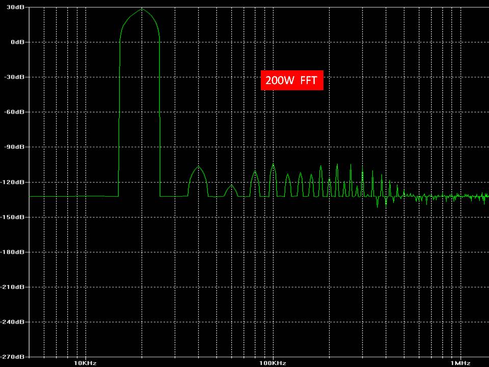

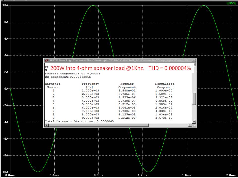

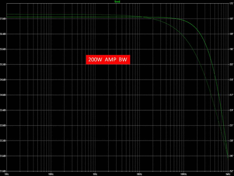

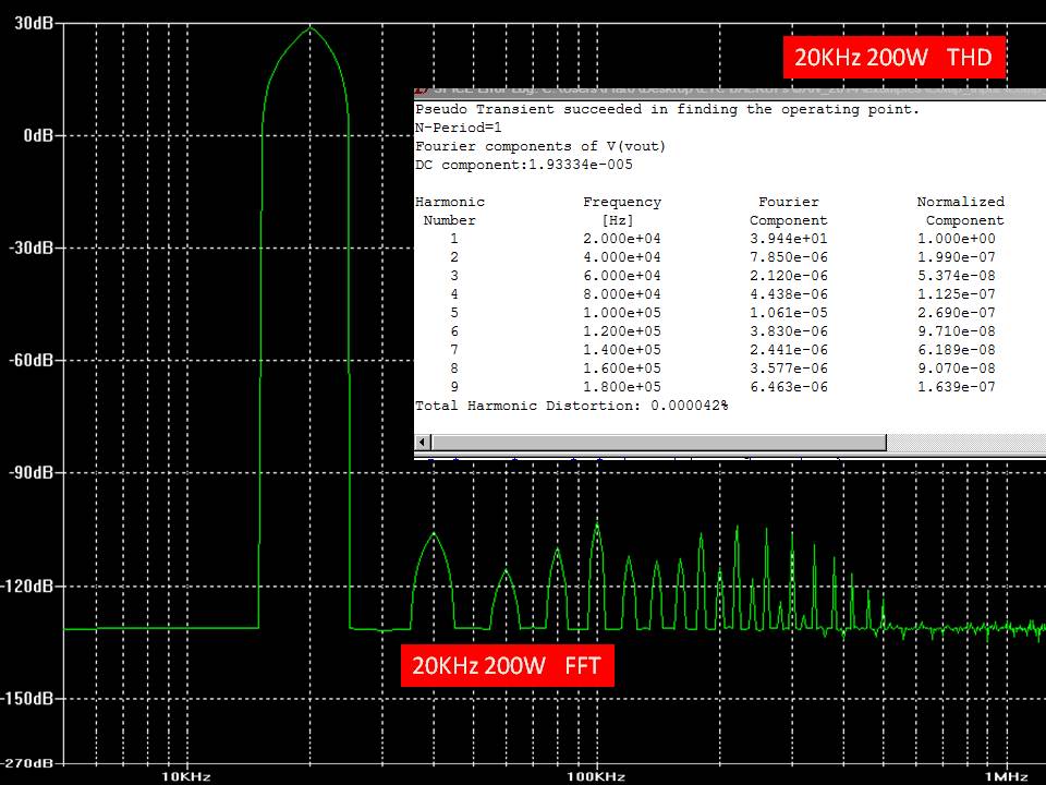

Hi David,
I attached 200W into 4-ohm speaker load LTSPICE simulation output for THD, BW, and FFT. The FFT illustrates that "good" harmonic ratios can be produced with a high-gain plus high-feedback amplifier. The simulation includes LTSPICE models for a regulated driver circuit power supply, and a C-R-C filtered output power supply. I'm collecting parts to get exact sizes for amp+protectionCKT PCB layout and winter construction to fully test the 300 component schematic(160 amp + 140 protection).
There are several low THD amps in the forum.

I attached 200W into 4-ohm speaker load LTSPICE simulation output for THD, BW, and FFT...
I quoted from your post where you mentioned only 20 kHz distortion but here you have switched to 1 kHz, which should be very much lower.
Still impressive results if true, but a plot with a header that says "200W Distortion" is not much evidence.
A "reasonable sim" needs a circuit, preferably as an .ASC and realistic models.
If you don't want to reveal your own then a link to any simulation that achieves this performance would be very educational.
...PCB layout and winter construction to fully test the 300 component schematic...
That would be impressive but hardly supports your claim that "most" amps can reach these numbers.
I have studied the Edmond Stuart/Ovidiu Poppa amp with interest.
But I am aware of no others that come close to your claim.
Which ones did you mean?

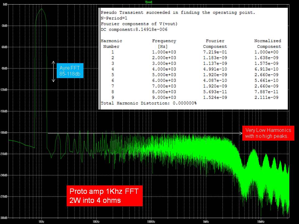

I did not want to hijack Bensen’s thread with a new amplifier design, just to show comparison FFTs.
Both the Bensen and Ayre amps use 1Khz 1-2 watt measurement points.
Attached Stereophile’s data for the cult supported Ayre MX-R amp which uses clever symmetrical cascoded FET input circuits driving a ThermalTrak bipolar output stage, and no global negative feedback. Even tube-lover Lynn Olson praises the MX-R.
Attached Bensen's FFT sim. "Modest THD, a nice harmonic spectrum using modest feedback, and Fet drivers for more detail to the music compared with bjt's."
Attached LTSPICE sims for a prototype bipolar amp which uses conventional negative feedback. Philosophy = " If you use global feedback use A LOT of it! It is better to significantly beat down ALL THD than to worry if the remaining TINY 3rd/odd harmonics are higher than the remaining TINY 2nd/even harmonics."

...Most modern bipolar amps can LTSPICE sim to 0.00005% THD at 200 watts, and maintain this low THD over diverse loads ...
...Attached Stereophile’s data for the cult supported Ayre MX-R amp which uses clever symmetrical cascoded FET input circuits driving a ThermalTrak bipolar output stage, and no global negative feedback. Even tube-lover Lynn Olson praises the MX-R....
The measured performance of this amp is worse than .03% at 200W into 4 ohms, apparently at only 1 kHz. What relevance does this have to your earlier claim of better than .00005% for "most... amps" ?
And to stay on topic.
What model level and values did you and Bensen use to produce the distortion numbers for his amp?
When Toni (ASTX) used the LTSpice model level 3 to simulate a MOS VAS in his amp the simulations were wildly optimistic compared to measured performance.
This is not unexpected, MOSFET models are problematic and almost certainly the cause of the error, because the rest of his simulation has been checked to match measured performance reasonably well.

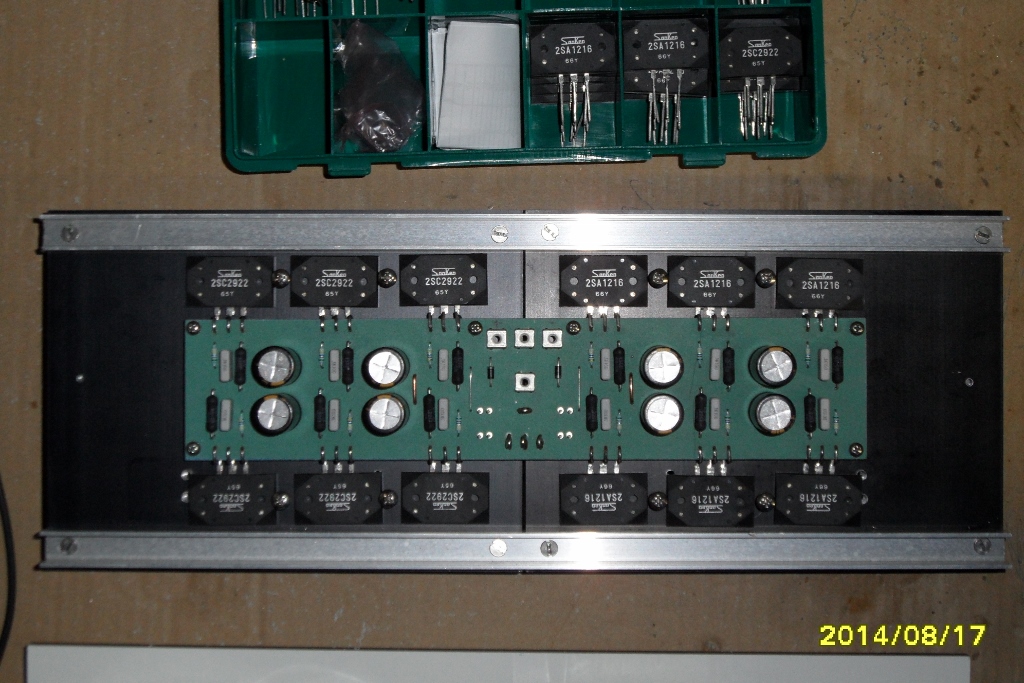

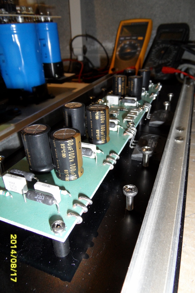

Update: OPS Proto pcb ready
I etched the OPS PCB using the foto transfer method on some old PCB material I have laying around.
The finale heatsinks will normaly be the 165mm x200mm from Modushop. I had some laying around from 150mm x200mm, which are ideal for the prototyping.
Base stoppers (4R46) and Dale emitter resistors (0R22) are all 0.5% types, this to not decrease the mathing specifications of the output transistors.
Decoupling fils cap are Rifa/Evox MMK types.
Electrolytics are Nichicon KZ MUSE
Power supply connection are very close to each other to prevent long wires and to twist them as far as possible. All heavy current connection are done with a print connector with a M3 threaded hole.
The driver emitter resitors will be on this PCB, values (+-15ohm) will be choosen during experimenting with drivers bias. During prototyping I soldered 2 times 4pins on the PCB to easily change these resistors.
