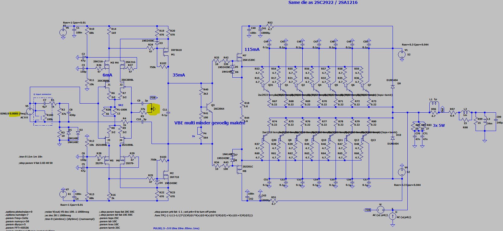

Is there a fluctuation in the simulation model too? You are in the wrong place looking for a problem.I added an extra 4R7 base stop resistor for each output device.
I gently increased the bias and from about 15mA throught the output devices, the amp started to oscillate again at about 5MHz.
When lowering the bias again I notice also oscillation only when the amplitude of the input signal is high when playing music, at lower amplituded/passages the oscillation stop again.
Any advise what to try next?
C9 also needs to be removed in the model, parameters can also become better. Your circuit is like a Parasound. I modeled it before.

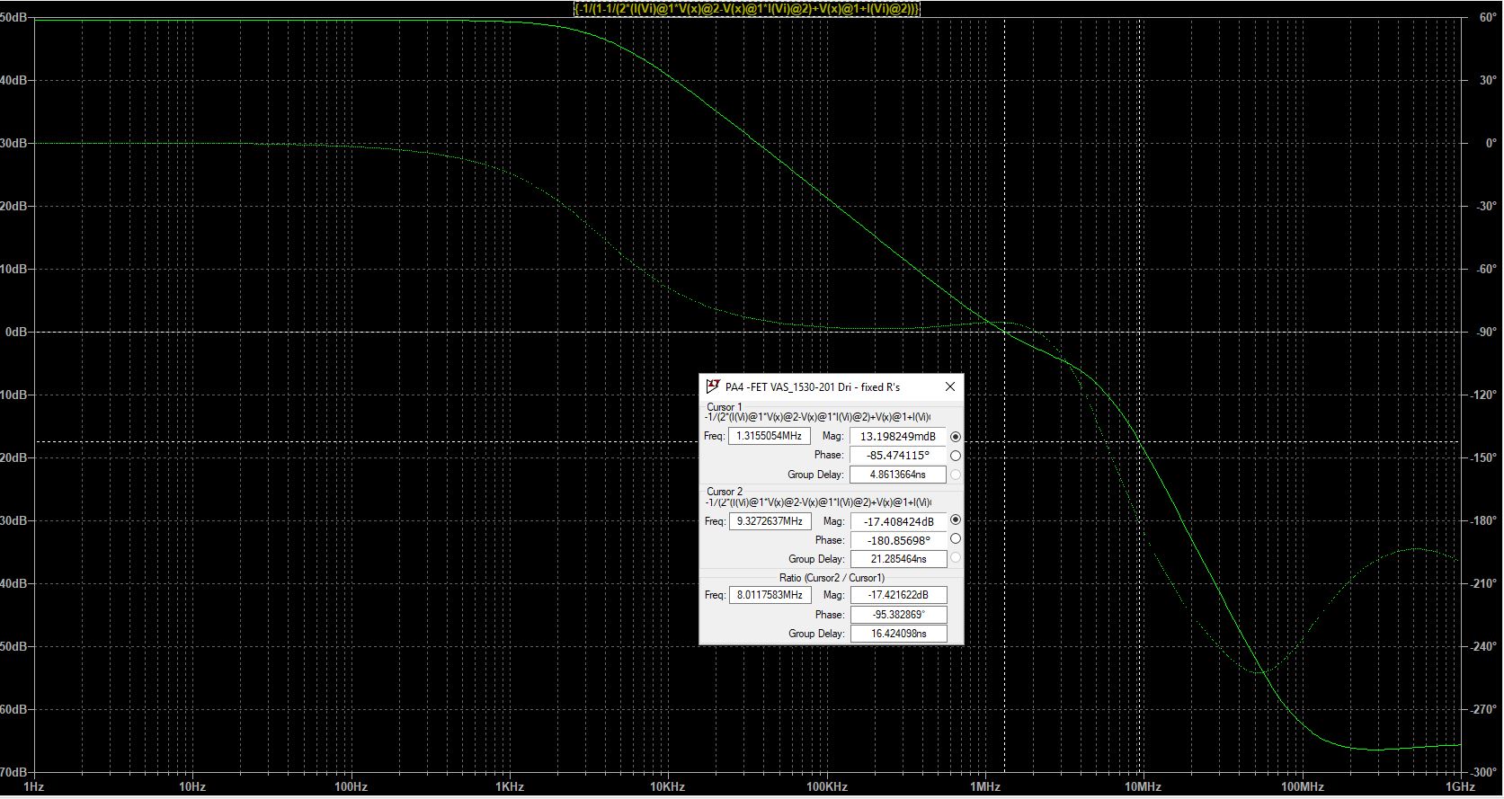

The AC analysis from the sim model doesn't change when altering the base stopper values.
In real life, my measurement tell me the same: same oscillation at same OPS bias current, both wiht 4R7 as 9R4 base stoppers. Yes, I need to look else for a solution.
In real life C9 = 5p and C10=8p. With these values I had a nice stable amp when only 1 pair of output devices.
Yes, indeed, it has suite some similarities JC1 OR HCA3500. It was not the intention. If you take a look at the beginning of this thread the design was much more complex. Due to all kind of issues the design has evolved to what is today. (Less is more)

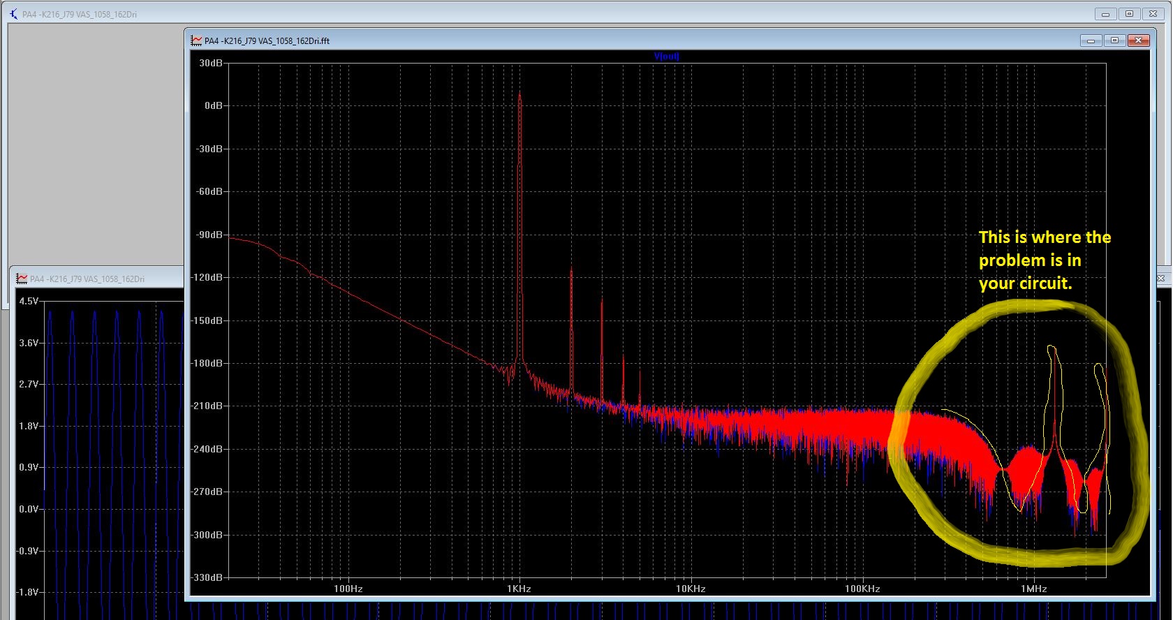

This is where the problem is in your circuit.
That's what you need to strive for

Below AC analysis of amp as-buid.
Tekst erased.
I watched your circuits, the input stage is not changed. Show a new picture with noise like the previous one.Hi Gunfu, the FFT you are showing is from one of the previous iterations of this amp.
Here is AC analysis of the amp 'as build'.

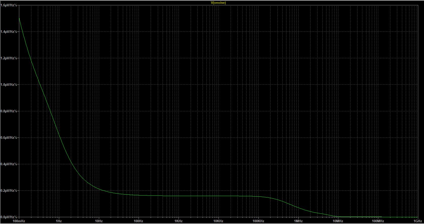

Here you have the noise analysis.

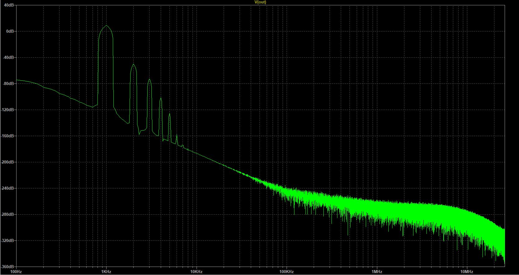

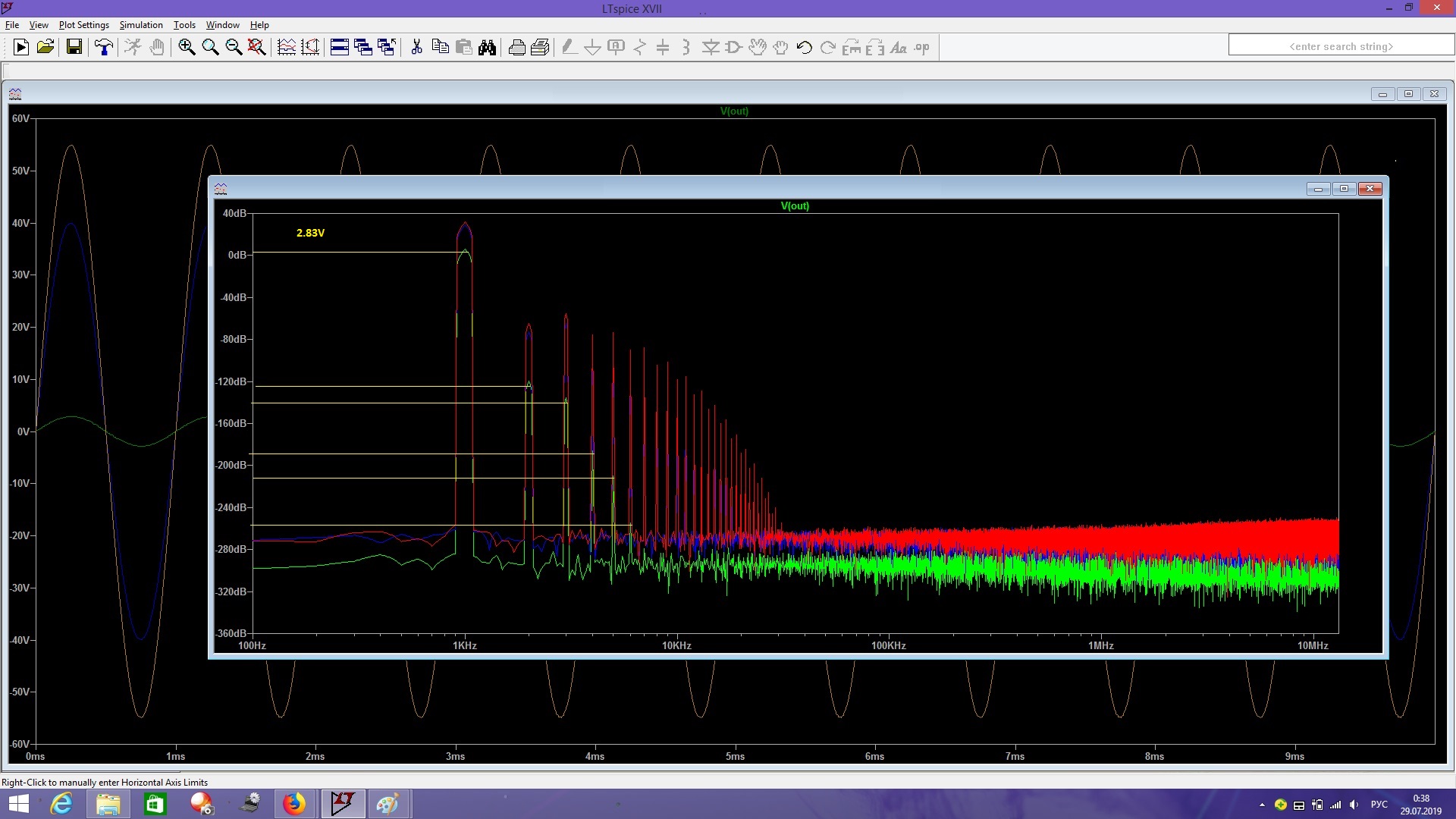

I'm trying to figure out how to increase the scale of the FFT to 20Mhz. I seem to get no more than 2,6mHz
Hi, did you try to rise the value of fbk res R5 from 27k to 50k, 75k, 100k, etc to check if the oscillations will stop when even less gnfb factor?

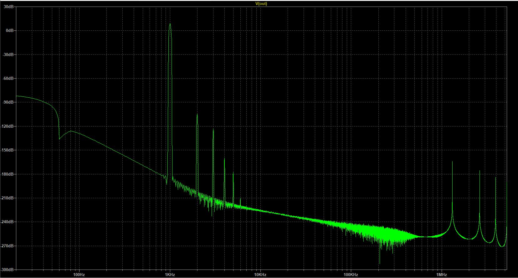

.tran 0 11m 1m 10n
.four 1K V(OUT)
.OPTIONS plotwinsize=0
.OPTIONS numdgt=7
.step param V list 2.83 40 55
It should ideally be like that. https://www.diyaudio.com/forums/attachments/solid-state/771148d1564353112-phase-harmonics-1-jpg

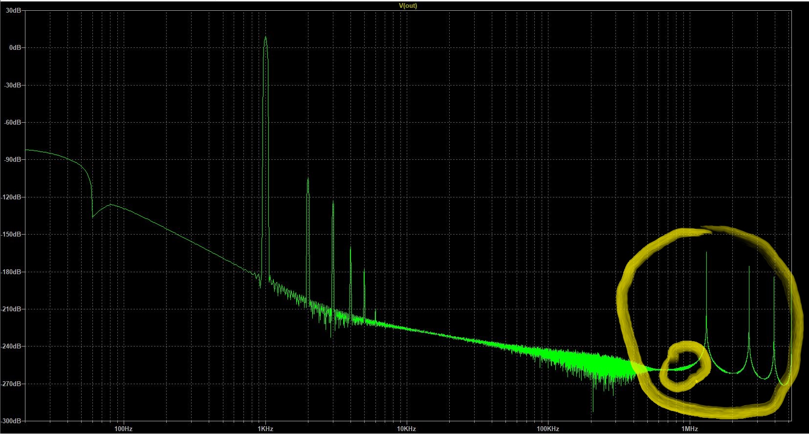

Managed to get data above 2MHz.
This doesn't look terrific. What to do to get rid of those "peaks" (-160dB)

There seems to be a problem in this picture.
For starters, I would turn off the negative feedback and see only the noise. According to the data that I brought. # 89

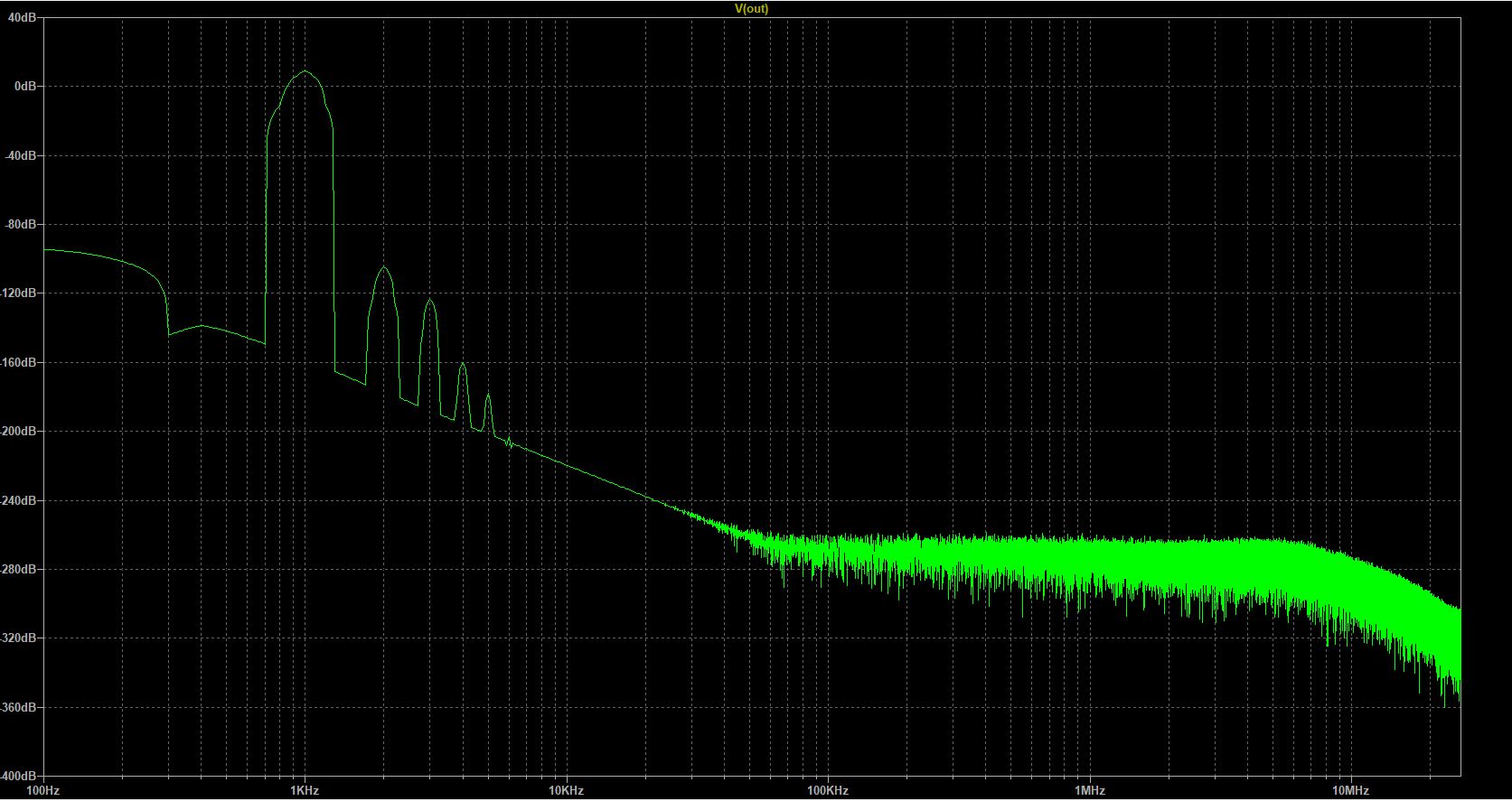

Hi GUNFU,
With your .tran function i'm getting following FFT result.
All peaks are gone.
Is this what you would like to see?
No, I do not like this picture. I don't like the phase shift going on. And secondly, tell me, have you now disabled feedback as I asked or not?Hi GUNFU,
All peaks are gone.

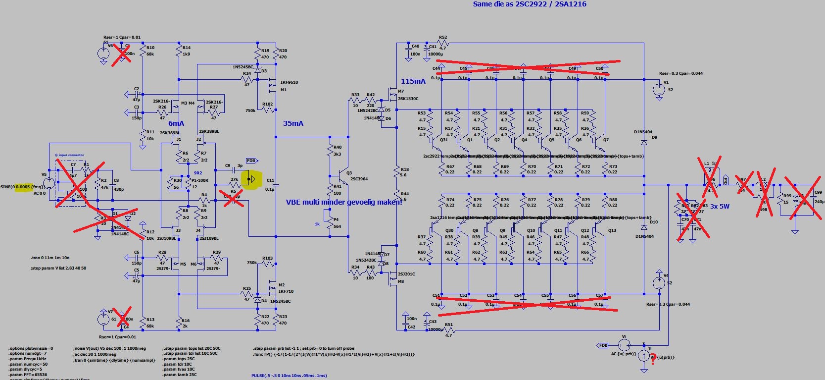

Why do you have input filters? They only interfere with the model and are completely unnecessary in the model.
The input filters distort the rest of the picture, it will be difficult for you to find the cause of the malfunction.
When you remove the feedback, the generator voltage also needs to be significantly reduced, to millivolts.
I bypassed the input filters and simmed without Feedback (ground to inverting input from input stage).
Please find FFT and modified circuit below.

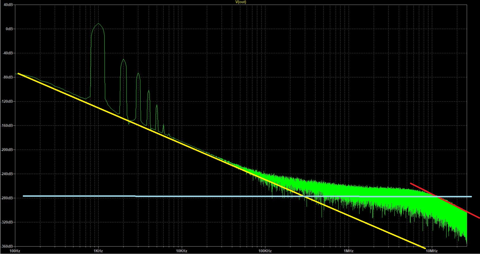

From the very beginning, the amplifier does not work correctly (yellow line).I bypassed the input filters and simmed without Feedback (ground to inverting input from input stage).
Your troubleshoot knowledge and LTspice experience is clearly better than mine. Thanks for your help.
The amplifier noise not covered by feedback should be horizontal, parallel to the blue line. Apparently, capacitor C10 also creates negative feedback. All elements that twist the phase at this stage should be removed even at the output. They are not needed for modeling, they are only misleading. I would even close the resistor R3. You can always return the circuit. Now it is very important to make it so simple that the noise line is horizontal. But even now it’s already clear that the attenuation frequency from 5 MHz is very low (red line). And there, in your amplifier, there were self-oscillations.
In the next step, you need to find out where such a low recession (red line) occurs, this is definitely not an output stage.
I crossed out in red everything that did not need to be placed in the model. Voltage sources are ideal here, so capacitors shunting them are not needed at all.
The output should be configured only for a load of 8 or 4 ohms, in this case, capacitors and inductors in our case are not required.
