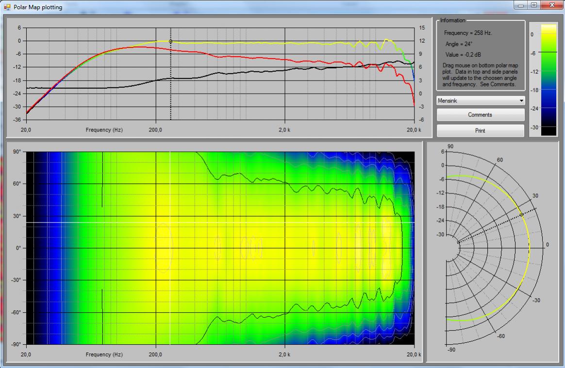

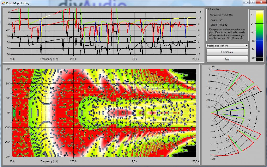

Do you have different code for each set of measurements? I do not get the calculation errors if I look at the Mensink data, but I still do get them when I open for example the piston cap (unless I change my "Regional settings" off course)...
Yes, actually those data sets were done on different programs. Try the Abbey, it was redone on the new program as well. The polar cap was generated in MathCAD. If that works let me know and maybe I can track it down.
Is it the speaker listed as "Mensink"?
Yes, that's the name of the guy who sent me the data. I don't know the history of who's speaker it is or who took the data.
Hi Earl,
It's been a couple months, but the guy who sent you the data is me 😉, see http://www.diyaudio.com/forums/multi-way/192737-2-way-waveguide-cardioid-like-6.html#post2673343
Your program is difficult to get to work at all, but once you do it serves as a great tool! Thanks for uploading the data. I'd like to see that data of the rear response, but I understand it will take you some time. Speaking of which, you've set a precedence 😀 .
You are correct, Abbey works ok also now.
