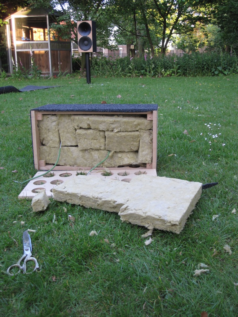

Why cardoids work better than dipoles and monopoles placed close to a front wall is kind of obvious, and that is the whole reason I want to use the concept. In my room the speaker will have to be fairly close to the wall.

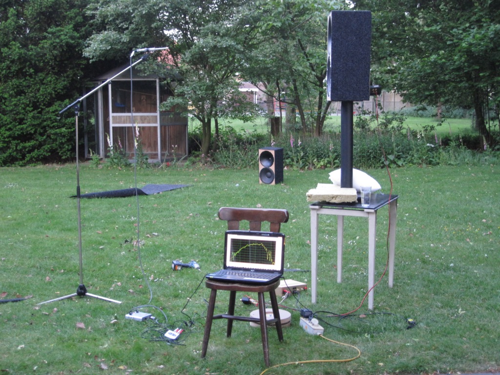

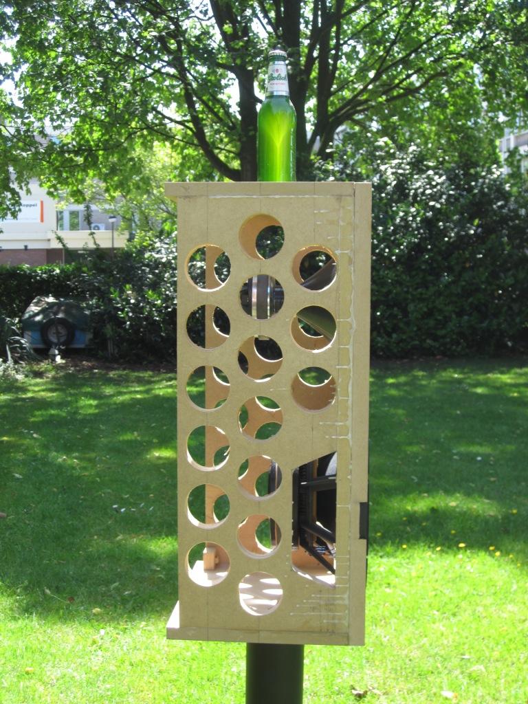

I was just curious about how you found out that keeping the back sealed and only have holes to the sides worked better when close to the front-wall. But I guess you kind of answered it. I can just measure the speaker outside facing upwards with a distance similar to what I have in the listening room and then see how different layouts affect the response.

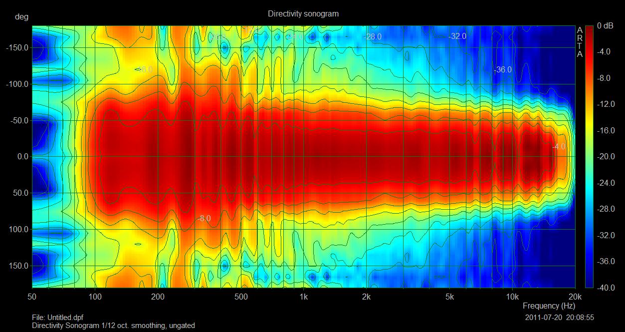

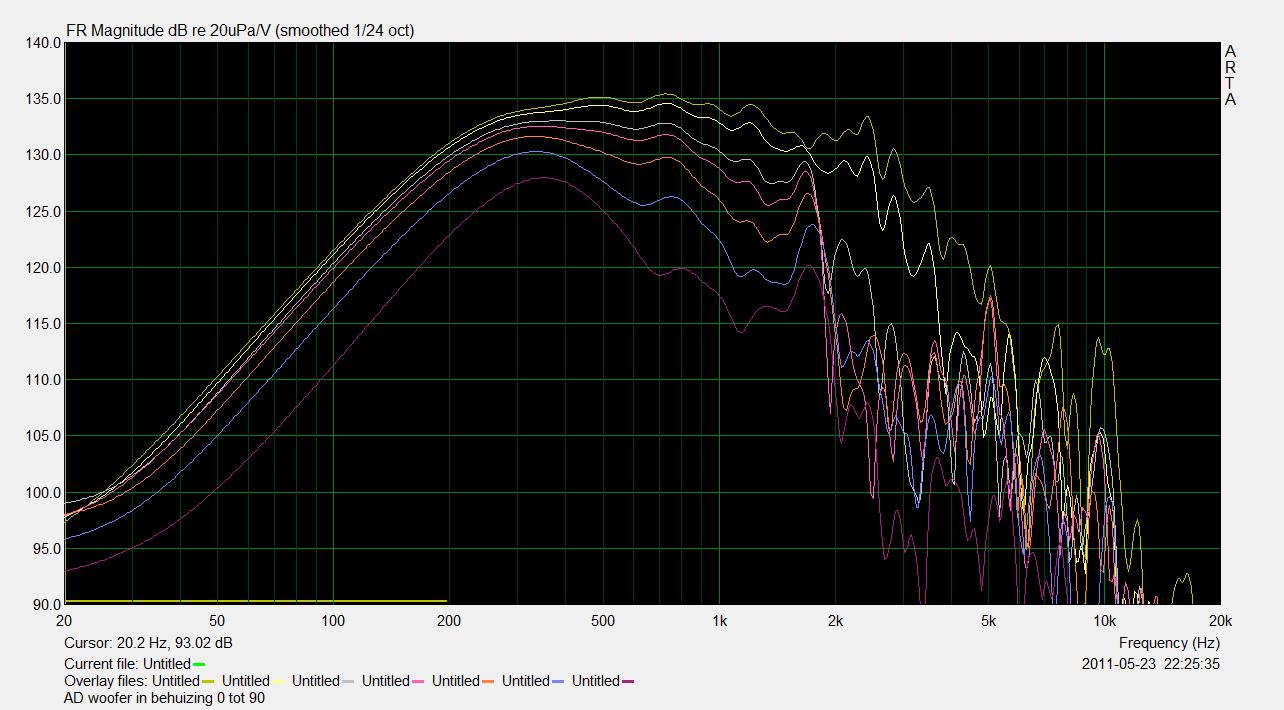

Well, at 90 degrees off-axis we get between -5 and -10 dB, depending on the exact configuration. You can get similar results with the appropriate waveguide, for a truly constant directivity speaker.
Okey, that sounds reasonable... I guess a shallow waveguide with a dometweeter would be quite close to that. And in many situations that would be a really good design.
But for my own personal taste and listening room I prefer greater directivity, especially from 800-8kHz to significantly lower first reflections in level, so I'll be using a more directive waveguide/horn.
And how does perforating the U-baffle solve the problems inherent to the U-baffle?I wish.
The problem with using a u-frame is that the results aren't predictable. I was shocked to find that the stuffing needs to match from side to side, and even the *consistency* of the stuffing changes the frequency response, the excursion, the distortion, the impedance curve, EVERYTHING.
IE, I learned why John K doesn't use U-Frames even though he wrote the software for them, and why Geddes uses reticulated foam instead of something else (re:consistency.)

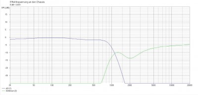

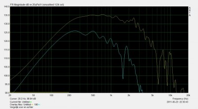

AD woofer in behuizing vol met demping%2C achterzijde.jpg21.3 KB · Views: 324
AD woofer in behuizing vol met demping Vergelijk voor en achter.jpg20 KB · Views: 350

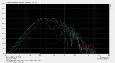

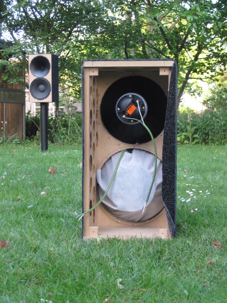

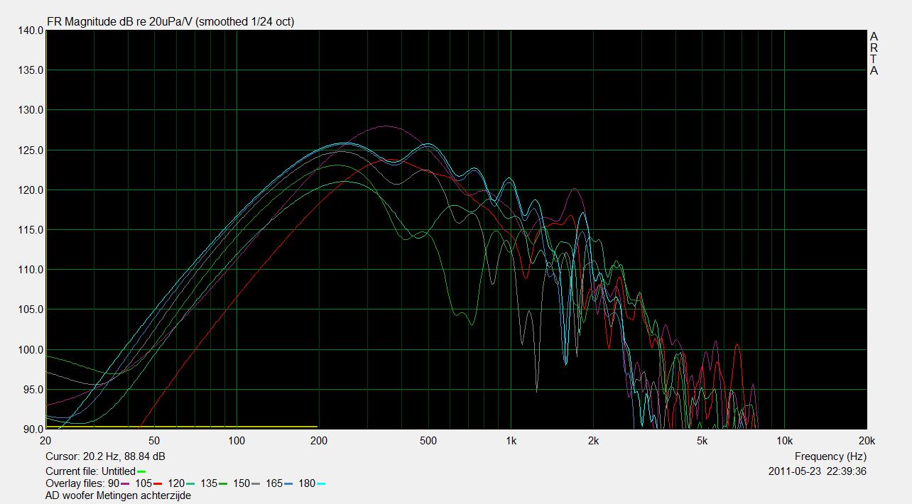

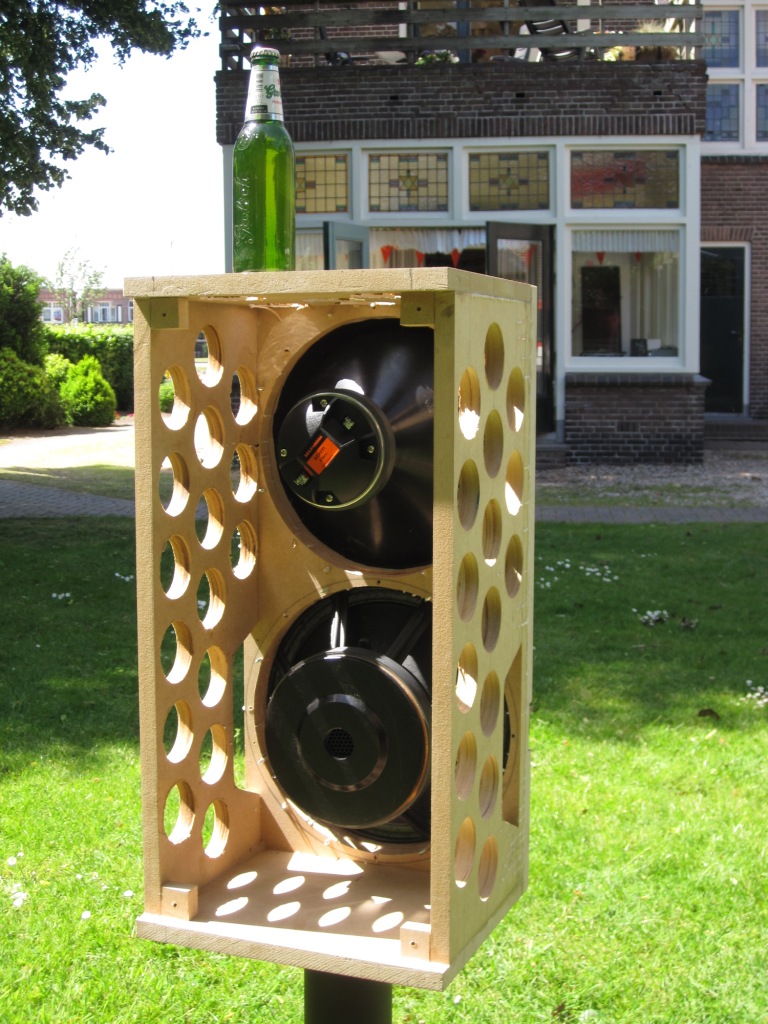

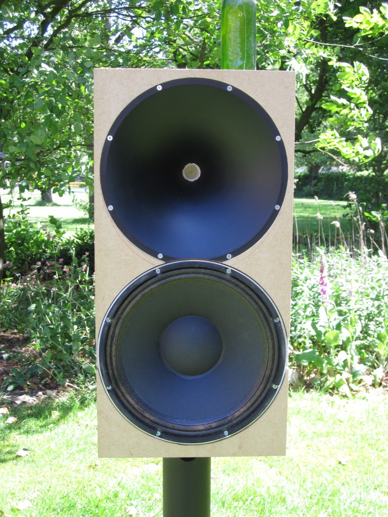

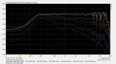

This was the first cardioid speaker I ever built. Since then I learned a lot about how to optimize them. The reduction in loudness relative to the front can be improved considerably in comparison to this speaker. Since then I started a business called Dutch & Dutch. Here you can find some technical information about the 8c, including measurements.

May I ask the profile of the waveguide? And is that a Seas tweeter you're using?

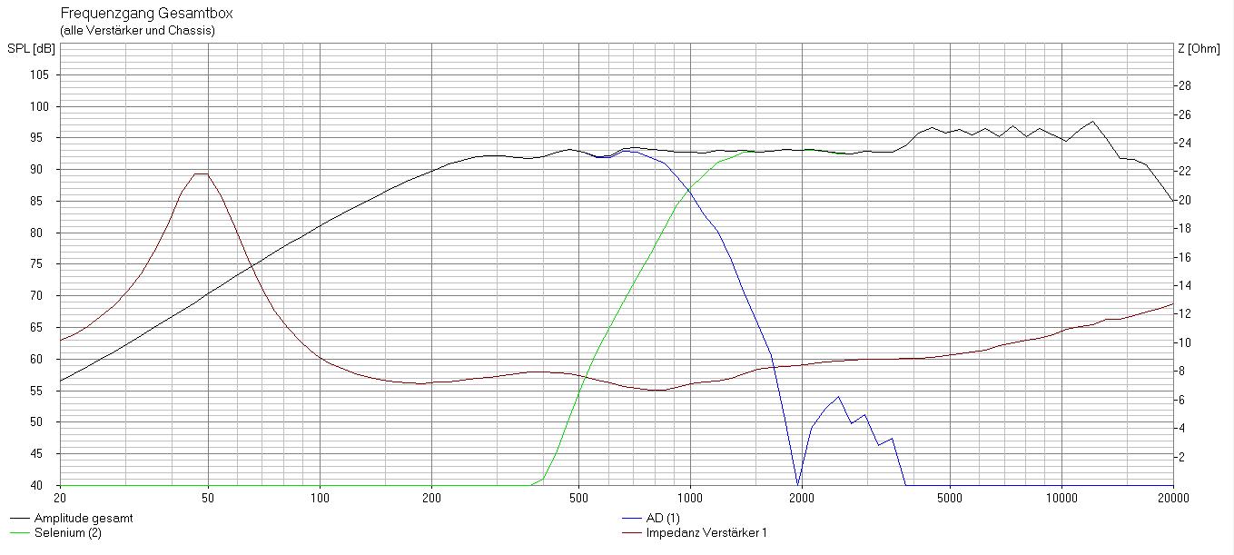

Would you care to share some tips on controlling the front wave relative to the back wave?
Ps your product in that link looks excellent
Your Studio 8C looks damn good. Must work wonders in typical living rooms.
How is the LF section arranged? Thanks.

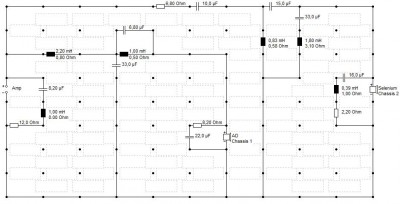

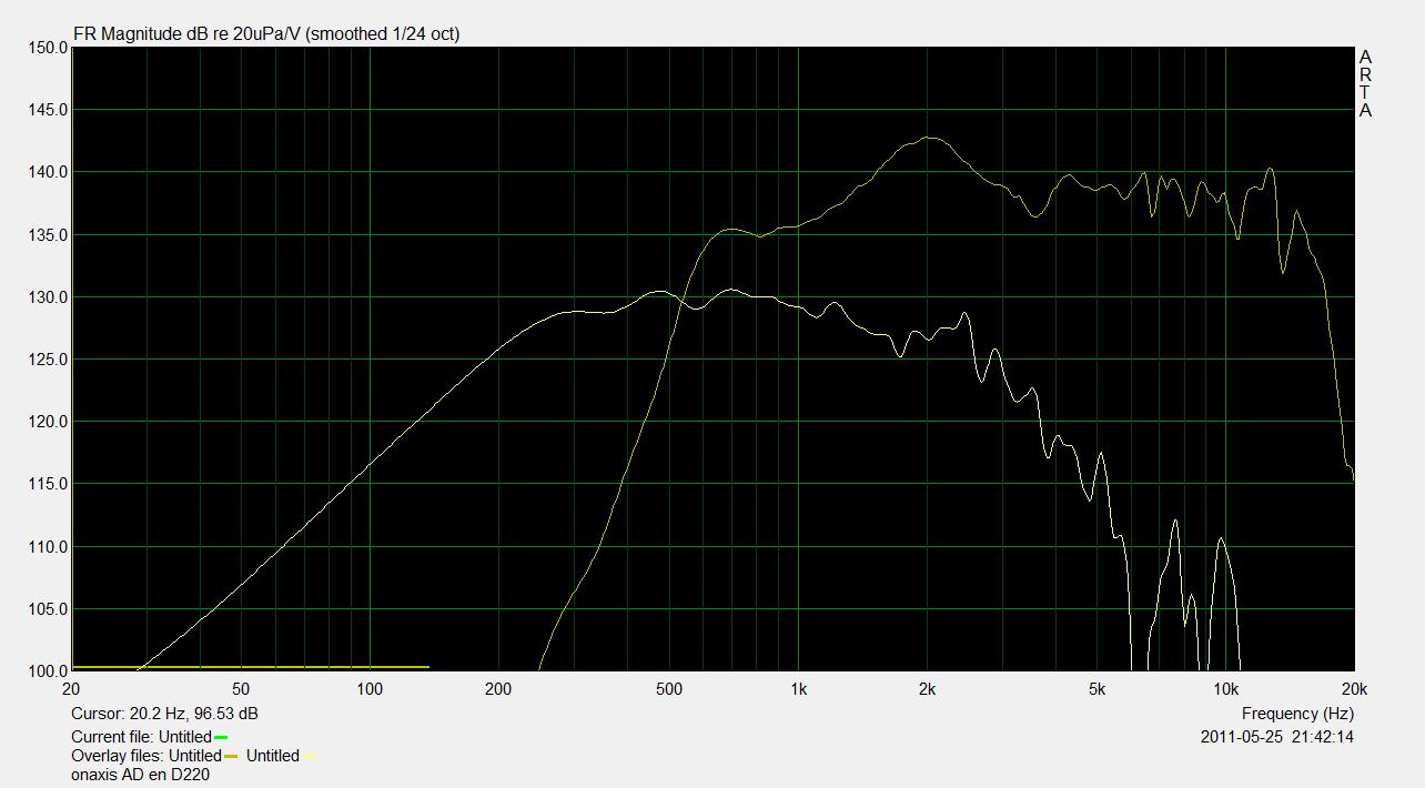

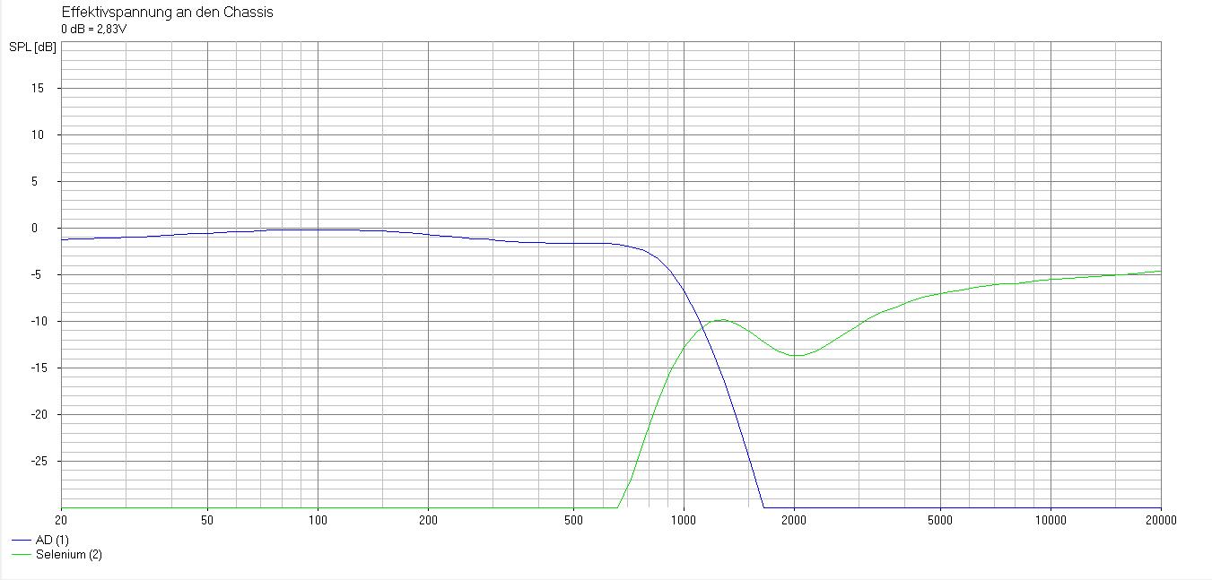

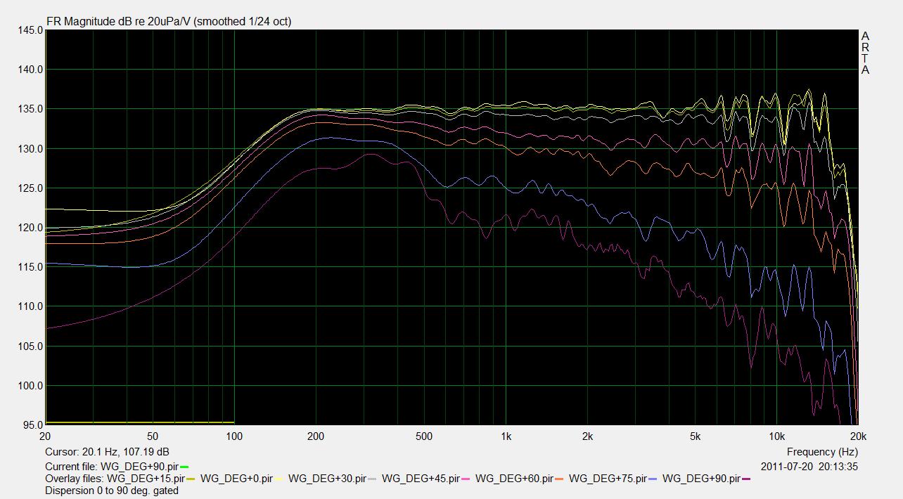

Take 2
