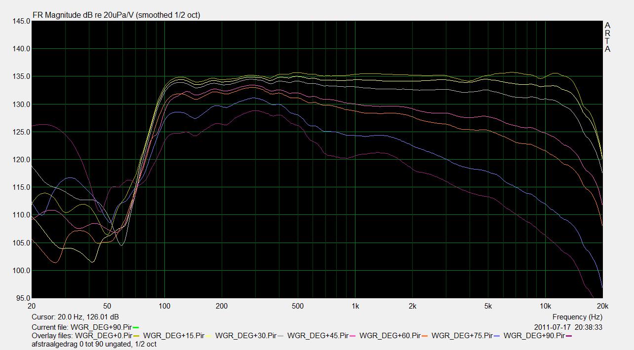

Tweeter looses the waveguide effect and is still not at ideal depth considering timing. The frame that holds the tweeter makes extra diffractions for the midrange. We can see lots of those in car speakerers.
RL 940 responses, funny that we can't see what happens between 0-45deg - I guess that doesn't look nice.

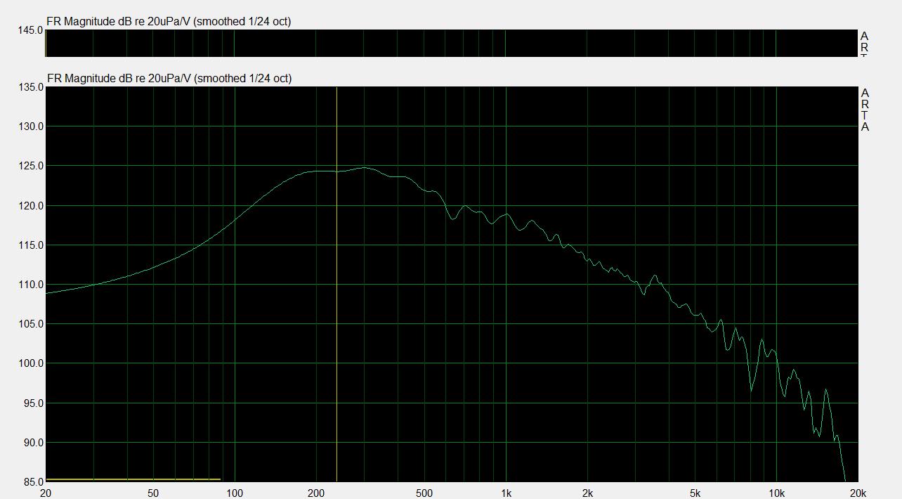

I bet NRC dip of bass at 60Hz is because of backside woofers making cancellation in the chamber which is claimed reliable only above 80Hz. We can see this kind of response in many other measurements.
Backside response shows no dip at 60Hz and deep cardiod nulling at 250-400Hz (roughly an octave) which is what I had expected, not wider than that! It would be nice to see full polar 0-180deg!
Distortion in the low band of midrange is because it is cardiod with poor efficiency and only poor 8"
Correct. The response in the bass is flat. In the Stereophile measurement there are narrow dips as well, but those are the result of parametric EQ's that we still on. The high distortion in the bass in the NRC measurements is a room artefact as well, confirmed by Douglas Schneider of Soundstage.
The cardioid works over a much wider range than that. It works well from under 100 hz up to about 450 hz. That's where driver directivity and diffraction/ baffle-step gradually take over.
The graph below is without subwoofers:
Note that in the Soundstage measurements the level on the back relative to the front is already around 9 dB down by 150 hz.
Also note that at exactly 180 degrees the results are a bit less good than just off that axis. That's because sounds that wrap around the left and right side of the baffle are exactly in phase at precisely 180 degrees and thus louder than just off that axis. It's clearly visible in the sonogram plot.
The 8c is a relatively compact full-range loudspeaker that offers low distortion at normal and somewhat elevated listening levels. At high levels distortion can become audible on some program material. This is the price we choose to pay for a cardioid radiation pattern in a speaker this size. However, 96 dB at one meter at a single frequency from a single speaker is very loud. In practice, in rooms with some reflections a pair of 8c’s can be played quite loudly and they do actually sound clean at quite high levels (this is mentioned in almost every review you'll find online). But if you’re into very loud music, they certainly have their limits.
