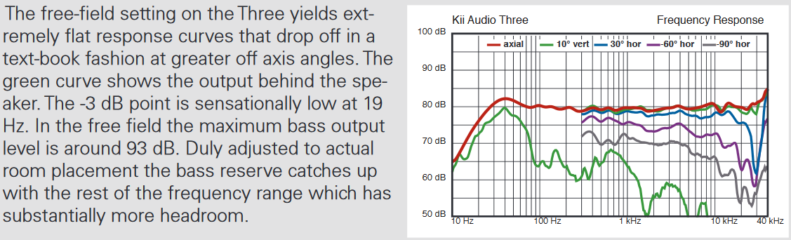

Tweeter looses the waveguide effect and is still not at ideal depth considering timing. The frame that holds the tweeter makes extra diffractions for the midrange. We can see lots of those in car speakerers.
