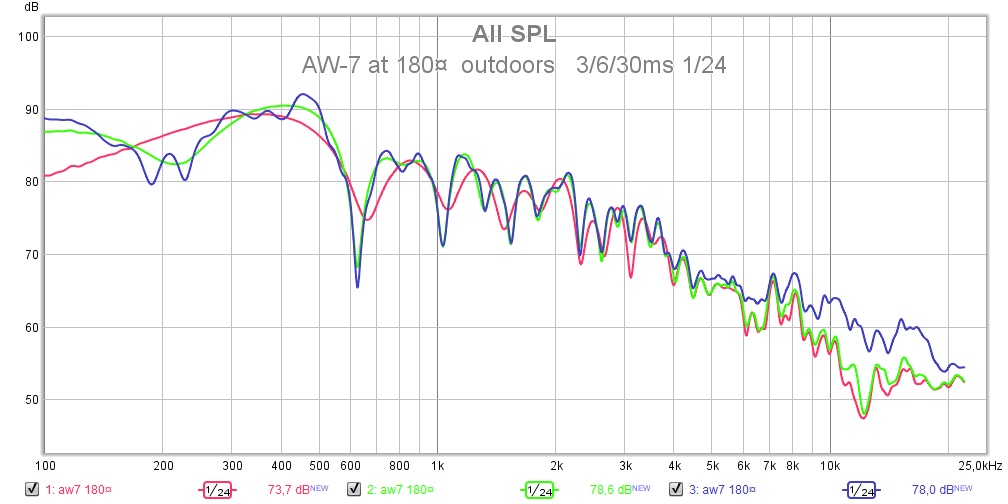

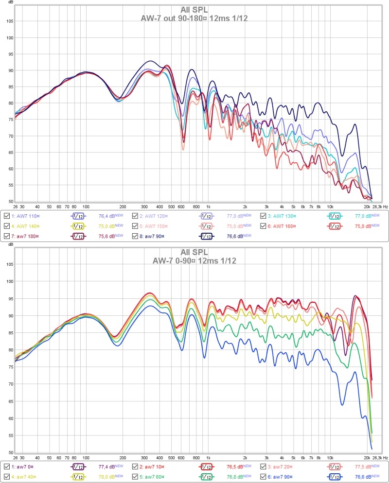

This is my outdoor measurement of a 2-way with SEAS 6½" coaxial, up to 180¤. There is "leakage" also with very short gating.

Oh, yeah I agree. That is a little higher level than what I would expect. I misunderstood what you were trying to say.
I was measuring about 1.5 m above ground and the gate is a 5 cycle frequency dependent window (FDW).
Maybe the 8C is more of a supercardiod? Doesn't explain high level around 10 kHz though. I have seen waveguide measurements with a higher level at 180 degrees than at 150 degrees due to constructive interference from right and left wave meeting behind the speaker. It would have been nice to see a full 0-180 plot.
