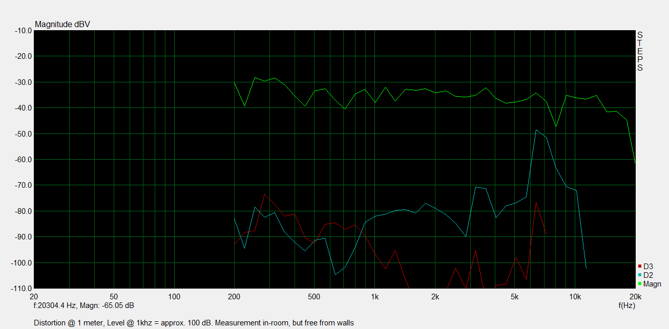

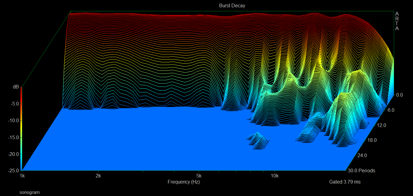

It's been a while since I posted here, but doesn't mean I've been resting on my laurels! To begin with, I've finally generated a burst decay and I've done distortion measurements.
As I already said, the burst decay does not look nice. However, it doesn't really bother me. I've recently edited some sound files with an EQ-curve that looks more or less like the frequency response of the Selenium with the waveguide. The effect is very hard to discern in an ABX test, and only on specific material.
The distortion measurements were done in my room, but with the speaker set up as far as possible from the walls. The mic was at 1 meter. The level at 1 khz was about 100 dB, +/- 3 dB (calibrated SPL meter). The peak at 6.5k is real. It is audible on a sine-wave too. It is probably caused by a resonance, because there is an irregularity in the frequency response and impedance as well. It is also hardly dependent on level. I doubt it is audible on most music, but I may experiment with another driver in the future. I've got some BMS drivers on the shelve.

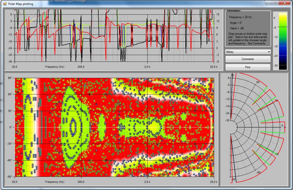

Did you have a closer look at the data Keyser has send you. I would really like to hear your opinion about them...
I tried to open your polar program on your website (to see if you had mayde uploaded keysers data), but the program is not working (see attached error log)
He has looked at it, but he hasn't mailed his polar plots to me yet. I've received no replies after my last few emails to him. He's mentioned several times in these forums lately that he's currently very busy. Maybe that's why.
By the way, I've never been able to look at the polar program either. Although I have windows and microsoft explorer, it just won't run.
Busy is half the story, the other half is that I screwed up. I started making some major changes to the software and its become unstable and won't run. That means that I have to go back through my backups and find a point where it was OK and start again. A lot of work, and I just have not found the time to do it. I intend to and even looked at the problem the last couple of days.
But I remain terribly backed up on just about everything that I do. It seems like I could keep on top of workloads like this years ago, but now I find that I have to slow down. My health is good, but I do spend a lot of time in doctors offices. I had a tooth catastrophy from a botched implant done in Thailand some years back that has cost me three teeth (and three new implants), some 5-7000 $ and almost bi-weekly dental visits. Oh well enough of my problems.
What error do you get trying to run the web software. It still works for me.

Do you run it from the pc on whoch you have some of the devellopment software used for the program? That could be the reason it works for you, but not for us (missing compononents or security policy). It used to run on my pc, but then something was changed.
On the older version I had to set my regional options in windows on "English -US", this probably due to the different use of points and comma's in Dutch and Englisch which resulted in calculation problems in your software.
But now this doesn't seem to help.
Hope you can fix it someday...
Hi Wim
Yes, I have only tried the program on a computer that is also a development platform and yes this sometimes makes the difference.
Clearly a foreign setup that uses commas and decimal point differently than the US will not run because the data files are a fixed US format and they will be read in as garbage if this standard is changed in the application.
So my question is now does everyone have a problem, or only a few, and mostly overseas people? As I think about it, it is usually EU people who have a problem. The comma as decimal point will mess everything up. Not sure if I can fix that.
If I read the error log, I would think the following file is missing: Polar_map.exe.config.deploy
Googling a bit around, this can be caused by the building the solution for 'debug', instead of building it for 'release'. This could also explain why it works on your pc, as you have the necesarry softare running for debugging...
Thanks Wim - that makes a lot of sense. I almost certainly did not do the "release" build. I forgot all about that.

I now get the calculation problem again as it used to be (see picture). By settings my regional options temporarly to US - Englsih, this is solved also.

I think the main issue is we (Belgium, The Netherlands..) use a comma for which you use a point, and the other way around.
