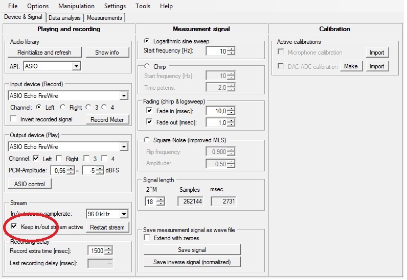

Another good way is to use the free software "holmimpulse". It allows you to keep the input/output stream of your sound card active (see pic of setting). This keeps the latency of the sound card fixed.
By enabling the setting "time zero locked (time alignment)" (see pic of setting), you can see the actual delay between the drivers by the time difference between the peaks of their impulse responses.
Tip: first measure the woofer, and then press the button "use last detected time zero", then remeasure the woofer. The peak of the woofer impulse will now be perfectly at "0 ms". You can now align the tweeter by trying to get the impulse peak also at zero.
Hi Wim,
Good hints. I have used the "time zero locked" feature but was not aware of the input/output stream issue.
I tend to find an offset that makes the tweeter phase flat in its midband and then lock that for woofer and mid measurements (assuming the tweeter is nearest). Note that the second pair of phase curves that the OP showed still looked like they had a lot more delay than minimum phase...?

The sound of the woofer arives earlier than that of the tweeter, while it is usually the other way around. So there is some excess phase visible for the tweeter. Moreover, the graph shows the individual phase curves for both drivers with the crossover. The highpass and lowpass on the tweeter and woofer respectively cause even more phase rotation and make things look messy.
