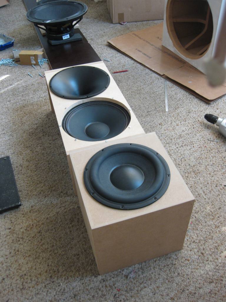

There was a good discussion about this on HTguide.com when Augerpro was building a two. I will try and find it. We also rear mounted our woofers to try and get the AC closer together.
I considered rear-mounting of the woofer and I actually started building the speaker with such a configuration, but I didn't like the way it looked (heck, I've even got a picture of it!), so I built a new baffle with the woofer on the front.
It was indeed a bit more difficult than usual to get the crossover right, but I think in the end it turned out pretty well.
I'll have a look at the thread at HTGuide!

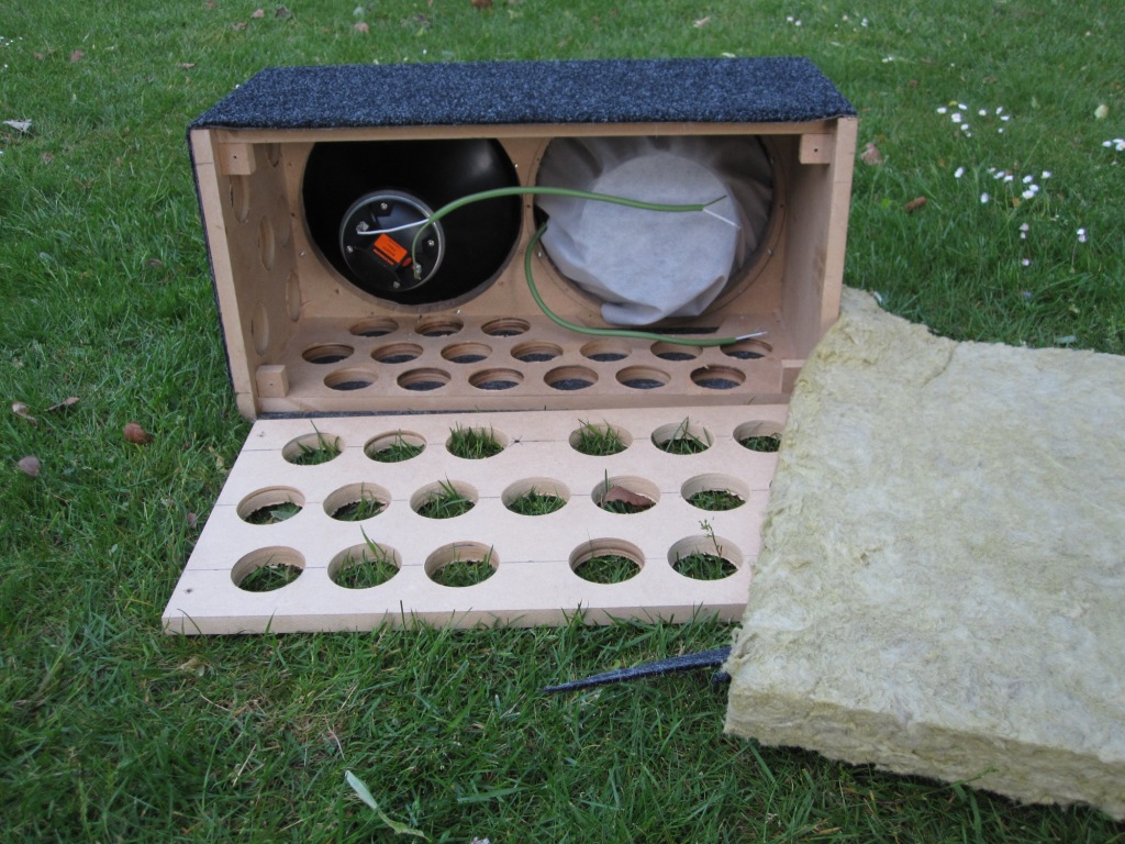

Hello Keyser,
Do you have some pictures about the stuffing? I know you said you only have some light stuffing on the sides, an more in the back, but a pictures says so much more...
Do you have picture of the back of the finished speaker? Is it also covered with carpet?
Many thanks you your reply and this excellent thread.

Hello Keyser,
Two pictures of the stuffing. You can see, they're stuffed to the brim. After what you see in the second picture one last layer of rockwool is added. There is no carpet on the back yet and the crossover is not built into the enclosure. What I meant about the sides, is that there is simply not much space to put a lot of damping material, so there's only one layer of rockwool at the sides of the woofer. I wonder if adding the carpet has a significant impact on the radiation pattern. There's only one way to find out!
