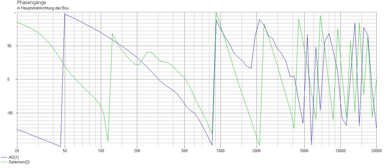

Helmuth,
I'm not using the calculated minimum phase because I want to take the delay difference into the measurement. This looks a bit messier, but it's easier to work with.
One good hint for this is to minimum phase the nearest element (usually the tweeter) and see what time shift that requires. Then apply that time shift (air path correction) to all drivers equally. You preserve relative phase shift and unwrap the phase curves at the same time.

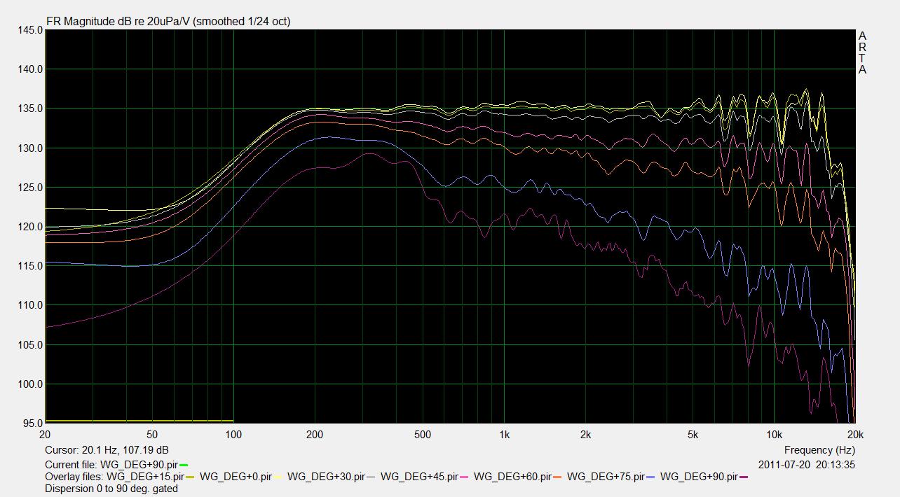

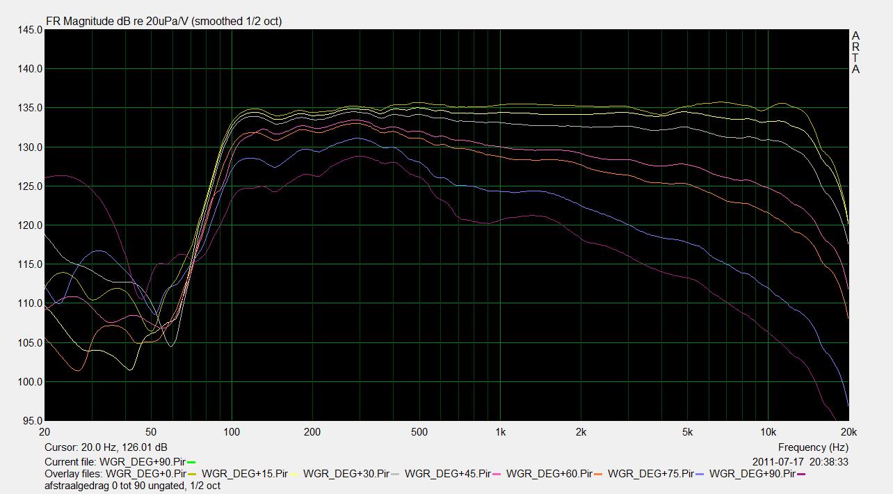

1 - The data is all there!
All measured outside:
1/6 oct. smoothing, ungated with reflections after a little over 10 ms).
1/24 oct. smoothing, gated.
Same data as above, 1/2 oct. smoothing, ungated.
1/24 oct. smoothing, gated, unweighted average of the rear response from 180 deg. to 90 deg. in 15 deg. increments.
2- Probably true. I didn't really expect my first try to be as successful as it turned out to be. But then again, I'm sure your waveguides required some tinkering with as well!
