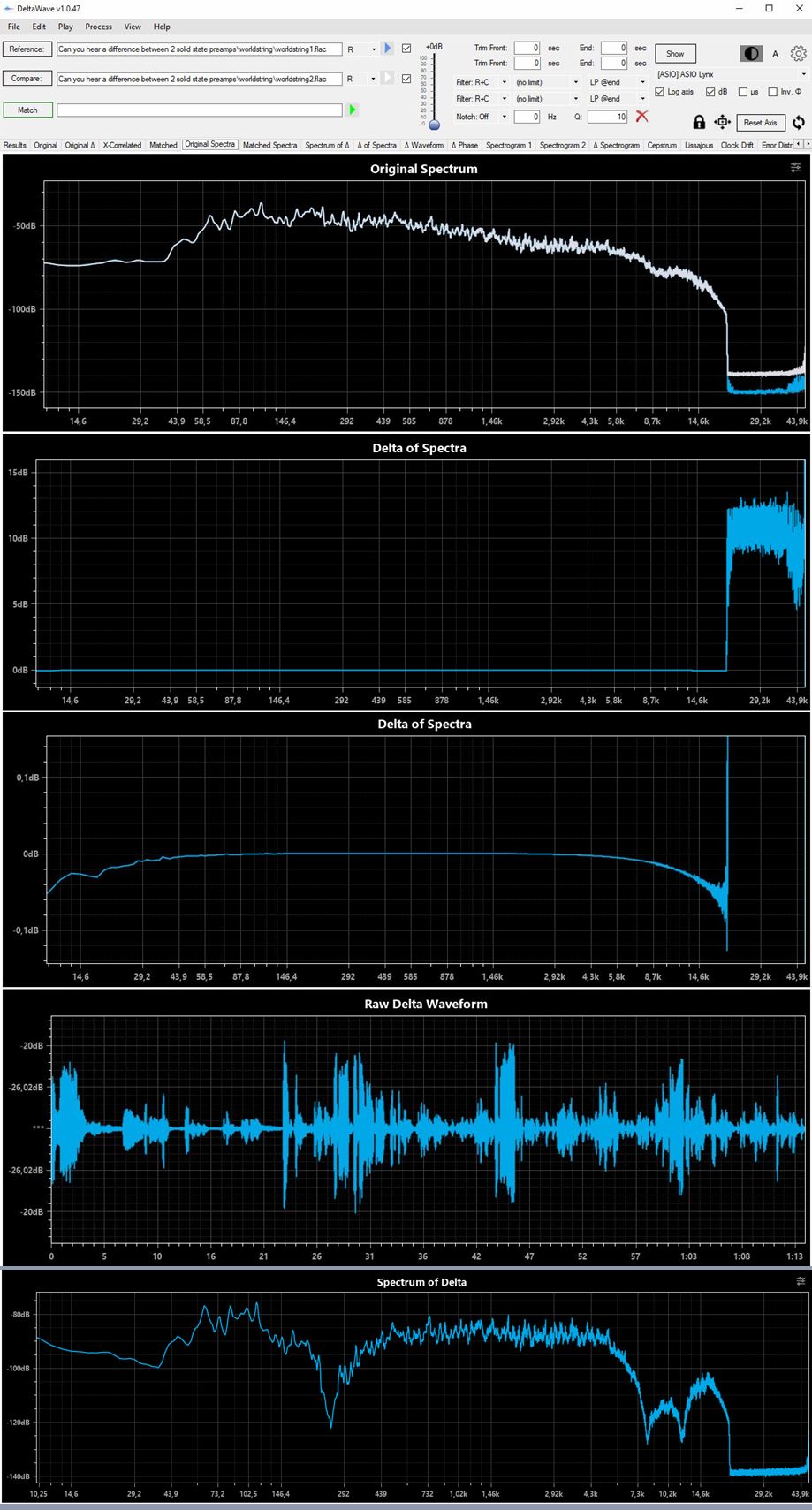

Those two files are synchronized to within one sample time, so I ran up some comparisons using the Python signal library. They are basically identical where it matters, I compared the raw signals, where the difference was clearly due to the slight time offset, and the cross-correlations matched the self-correlations, taken in 1000 sample chunks, and the spectra match (apart from ultrasonic noise floor) again taken in chunks (of 2048 samples). For instance:
This is the same for all the chunks, the ultrasonic noise floor beyond the brick-wall filter is different, but well down, at audible frequencies the spectra sit exactly on top of each other.

DeltaWave Audio Null Comparator gives:at audible frequencies the spectra sit exactly on top of each other.
