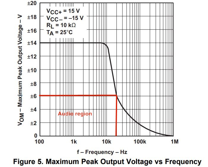

Slew rate is only .5 v/us. Kinda low for some audio applications.
Yep, sure is... but still we're only asking it for about 1 or 2 volts every 50us, so still well within it's unity gain bandwidth.
For a line signal? At least 10 times overkill already. Do the sums.
Jan
Did. If you want the kind of headroom most +4dbu mixers, tape machines etc have its not enough.
A cascade of unity gain stages is an obvious test-case, but not much use in audio. The longer cascades in mixing consoles give overall gain, and also internal gain in "unity gain" blocks like EQ.
On your existing breadboard, add 220r resistors sum-points to ground so all work at gain of 10.
As you point out, common-mode distortion is a thing and non-inverting is more common in audio. Means a major re-build. Use 20dB pad (1800r+220r), then gain-up again, twelve times.
The old TASCAM -10dBv standard started when '741-like opamps were all we could get (cheaply enough). There was a '5532 at the end to get the +4dBm master output.
