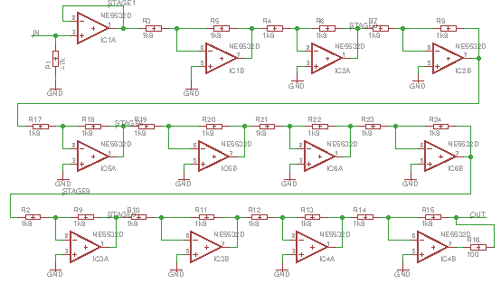

12 opamps chained - measurements
More measurements, this time on a single NE5532, both Signetics variant and TI, with inverting and also follower configurations, like this:
Although in reality its one dual opamp chip so only one set of supply pins!

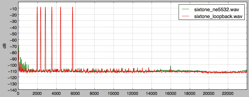

I plotted distortion against level for 4 combinations, the left hand plots are Signetics, right hand are TI.
The top plots are non-inverting (follower), and the bottom plots are inverting (all unity gain as shown above).
Clearly they show excellent performance although the TI does less well for the follower circuit (common mode issues perhaps?) - can we relate the TI performance here to the 12-opamp series performance - haven't tried yet...
Bit of an eye-opener that we almost get 1ppm level of distortion for the Signetics version, despite the Signetics datasheet saying nothing about the distortion performance at all...
And now the same tests with the 100nF decoupling capacitor omitted - this is why you should never roll opamps blindly, the performance goes to abyssmal very quickly if you don't understand things like decoupling, drive level, bias current etc:
Remarkably the TI chip does slightly better for the follower with no decoupling! The low impedance drive to the chip seems to stop the onset of oscillation for this mode and this chip, but all the others show HF oscillations are killing the performance, especially at higher levels - anyone who's played with designing amps knows oscillation onset at higher levels is a common problem, and its definitely the case for the NE5532 without its 100nF ceramic decoupling...

BTW I've just realized something very pertinent to this idea of testing opamps in series with inverting configuration - the even harmonic distortion will cancel out between successive stages, so the net amount of even harmonics after 11 inverters is probably about the same as one inverter.
Odd harmonics don't cancel like this and will accumulate 11-fold presumably, or rather 12-fold with the initial follower contributing too.
Think its time to start adding distortion-multiplier resistors to my test setup...
