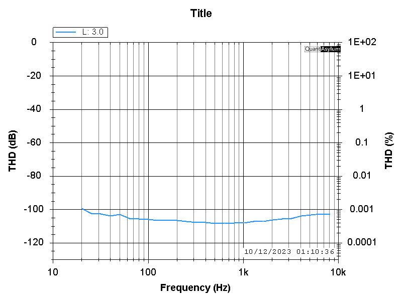

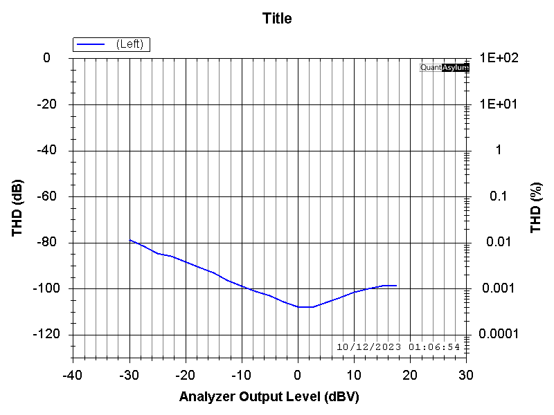

Well I now have a new piece of testgear to probe my 12 opamp chain, namely the QA403 audio analyzer, so I've revisited this circuit and plotted some THD v. frequency and THD v. level plots:
Since the chain consists of one follower driving a chain of 11 inverting unity-gain stages only the first opamp can contribute common-mode distortion, which I suspect is some of the rise past 3dBV here - below this level the noise floor is rising as normal.
Perhaps there are other mechanisms for rising distortion with level, after all with 18V supply rails you'd expect good performance upto about 20dBV. Perhaps there is injection of non-linear signals from the supply rails somewhere - the circuit only has 100nF decoupling caps.
At 3dBV I swept for frequency (I think with a 20kHz BW, but I'm not totally sure):
I guess the plot above 5k or so isn't really informative as a result - you'd expect it to rise noticably above 10k but that's not available.
