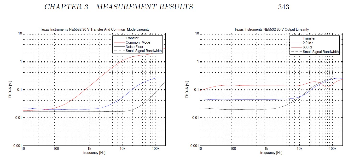

....shows the 5532 distortion worsening markedly at lower load impedances. Your driving just under 1k for most of your opamps and yet your results are spectacular.
I thought '5532 was fine to 600Ω?

It is still good at 600 ohm, just seemingly better at higher loading which you would expect of course.
This is what Samuel Groner found:

From what I can make out that's in agreement, with gain of -1 and lightly loaded the values seem to be 1ppm or so.
Going to heavier loads or very high signal levels or higher frequencies will quickly take its toll too I'm sure, but a few volts at 1kHz with inverting topology the 553X seems to be at the top of its game. I was using +/-9V battery supplies BTW.

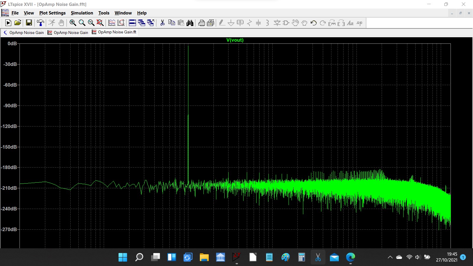

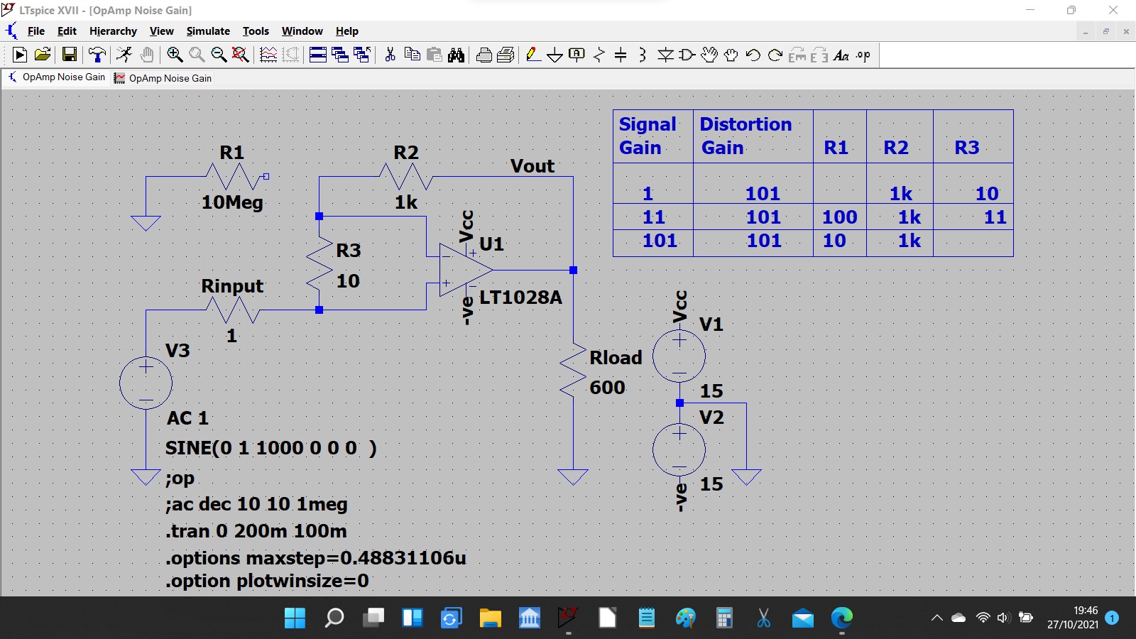

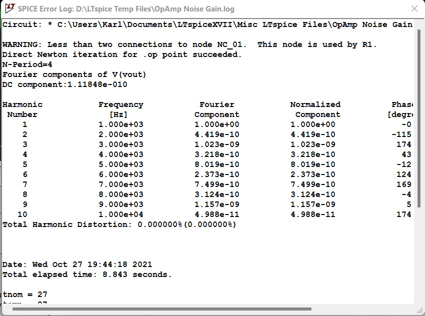

Somehow, I don't think it is, at least not the ones I've tried. This is a sim I put together a few years ago.
I am not aware of any audio grade op amp model that has distortions included, other than LM4562, LME49710 and their kin (same silicon). It's a device level model, compared to the common behavioral op amp models that almost never include the dynamic non linear behavior. The behavioral models are accurate for DC and AC simulation, but may provide very poor/misleading results for TRAN.
