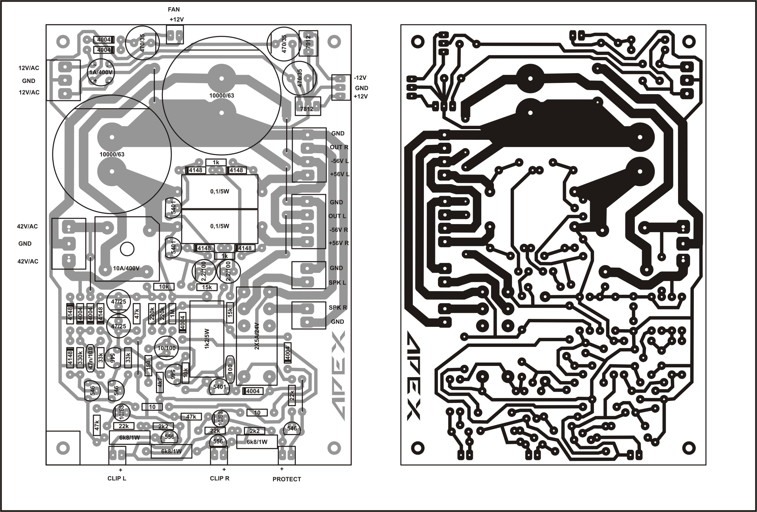

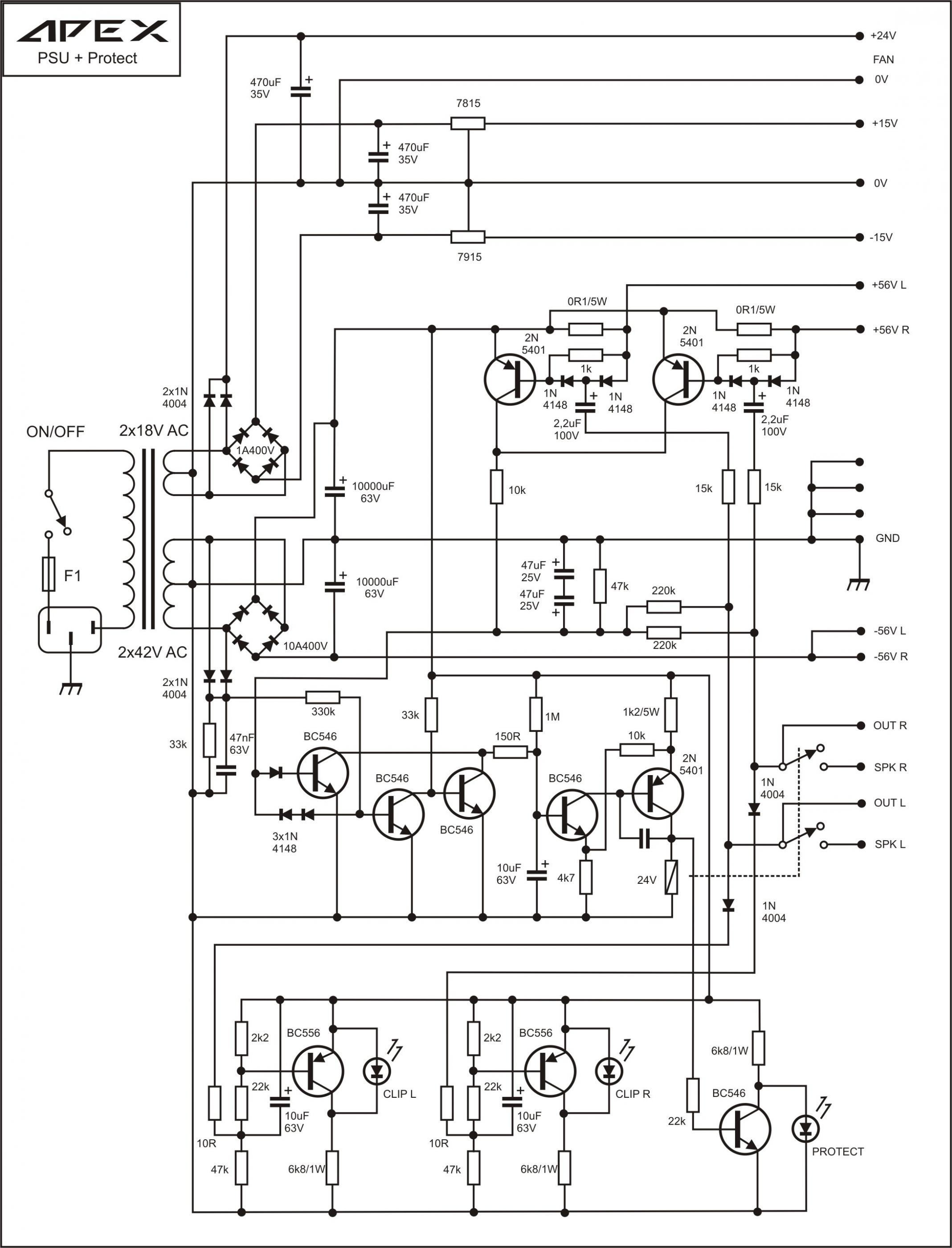

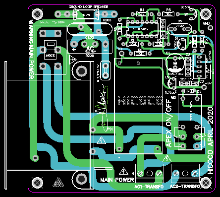

apex psu
hi, i want to make psu from mr mile but i dont have 2 transistors.
any replacement for bc546 and bc556?
5551 and 5401 can be used there?
BC546 CBE --> 5551 EBC
BC556 CBE --> 5401 EBC
