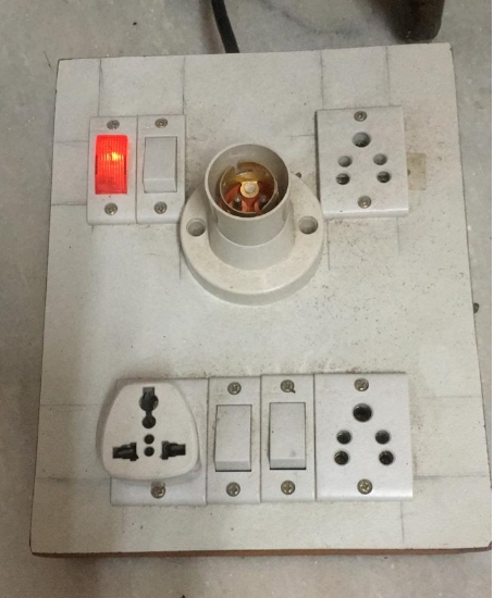

@gannaji or anyone: If using a Variac, would you put the bulb tester between the Variac and the unit being tested, or is a bulb tester not needed if using a Variac.
Be safe everyone
MM
My arrangement is like this. The top right hand plug is through the bulb. The bottom two plugs are direct.
All the three plugs are with individual switches.
If this is used before the variac, it will also get tested.

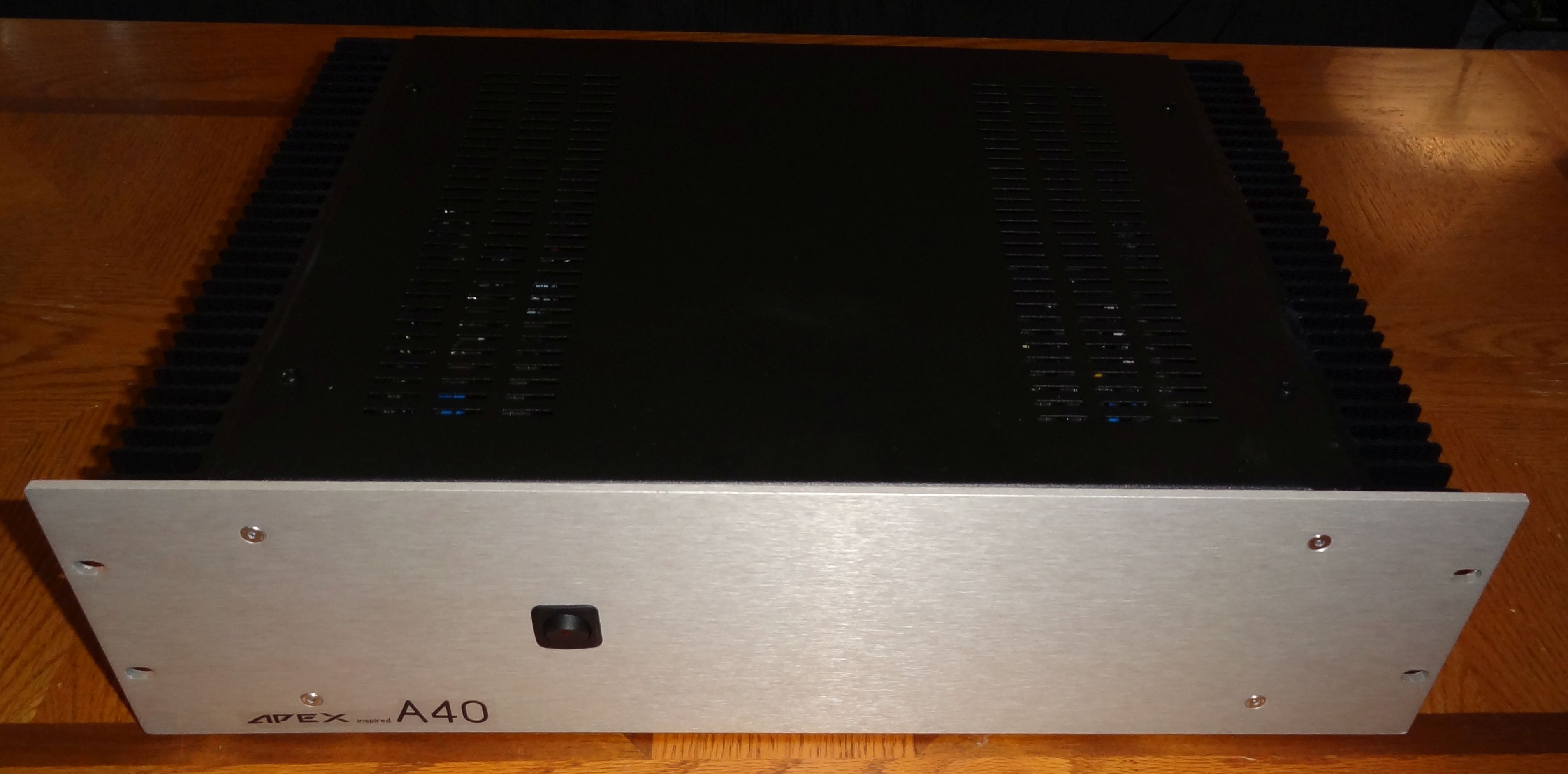

Stil14given mentioned the Apex A40 as a hard to beat amplifier

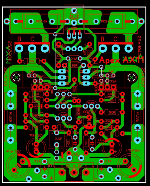

Would it be to much trouble to ask if someone could share the copper, schemtaic and layout for this amplifier?
Hope this helps

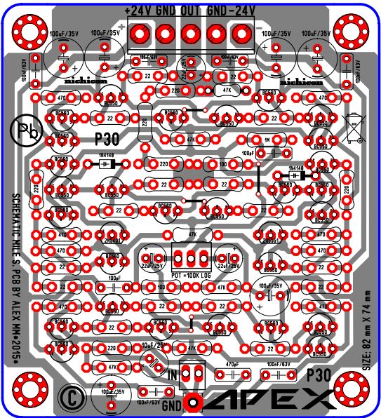

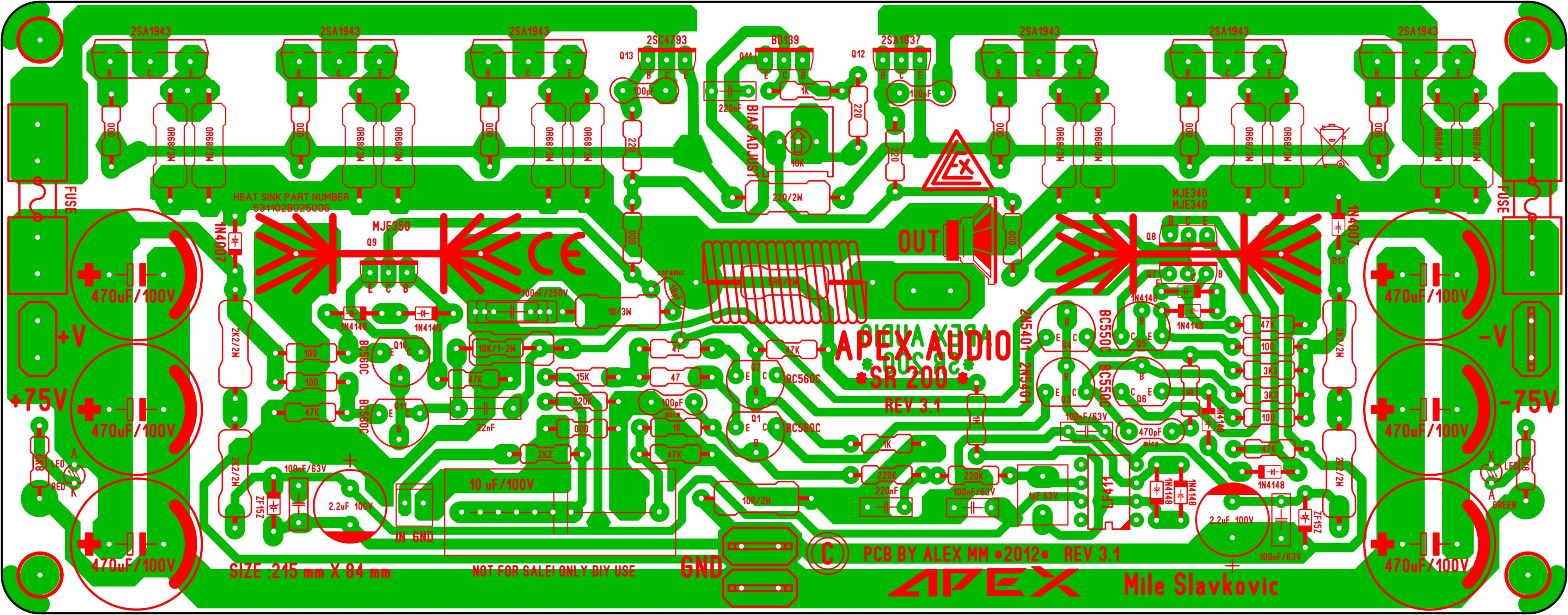

very nicely done!..congrats...yes, this one can be used when you already have simple bulk PSU with caps. Even I have such simple PSUs and I could add this regulated PSU as additional.
You could slightly move away the output transistors so they dont foul with V+ and V- faston connectors..
Prasi thanks for advice, but I am going to use output transistor down side board and I m little late for edit because PCB in progress. I have a heatsink 50x80mm there for it's easy fit on it.
