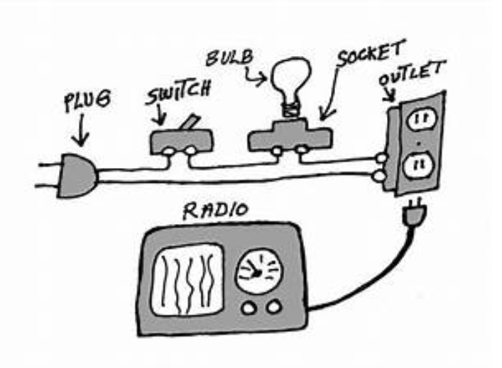

Have you used "dim bulb tester ?"
gannaji.
How to use dim bulb tester?
How to connect and what type of bulb can use?

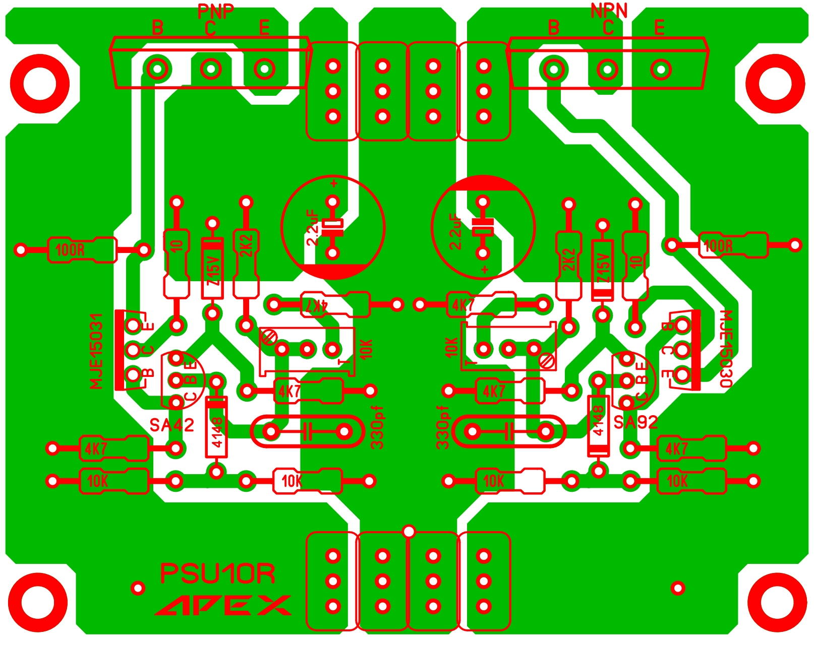

Same mounting hole distances maintained. Also given pads for output devices PSU10R, if anyone wants to run wires to heatsink.

@gannaji or anyone: If using a Variac, would you put the bulb tester between the Variac and the unit being tested, or is a bulb tester not needed if using a Variac.

That bulb tester is your single best safeguard to protecting components. I use both every time. Without the bulb tester stuff can burn up at low voltages if something is wrong.

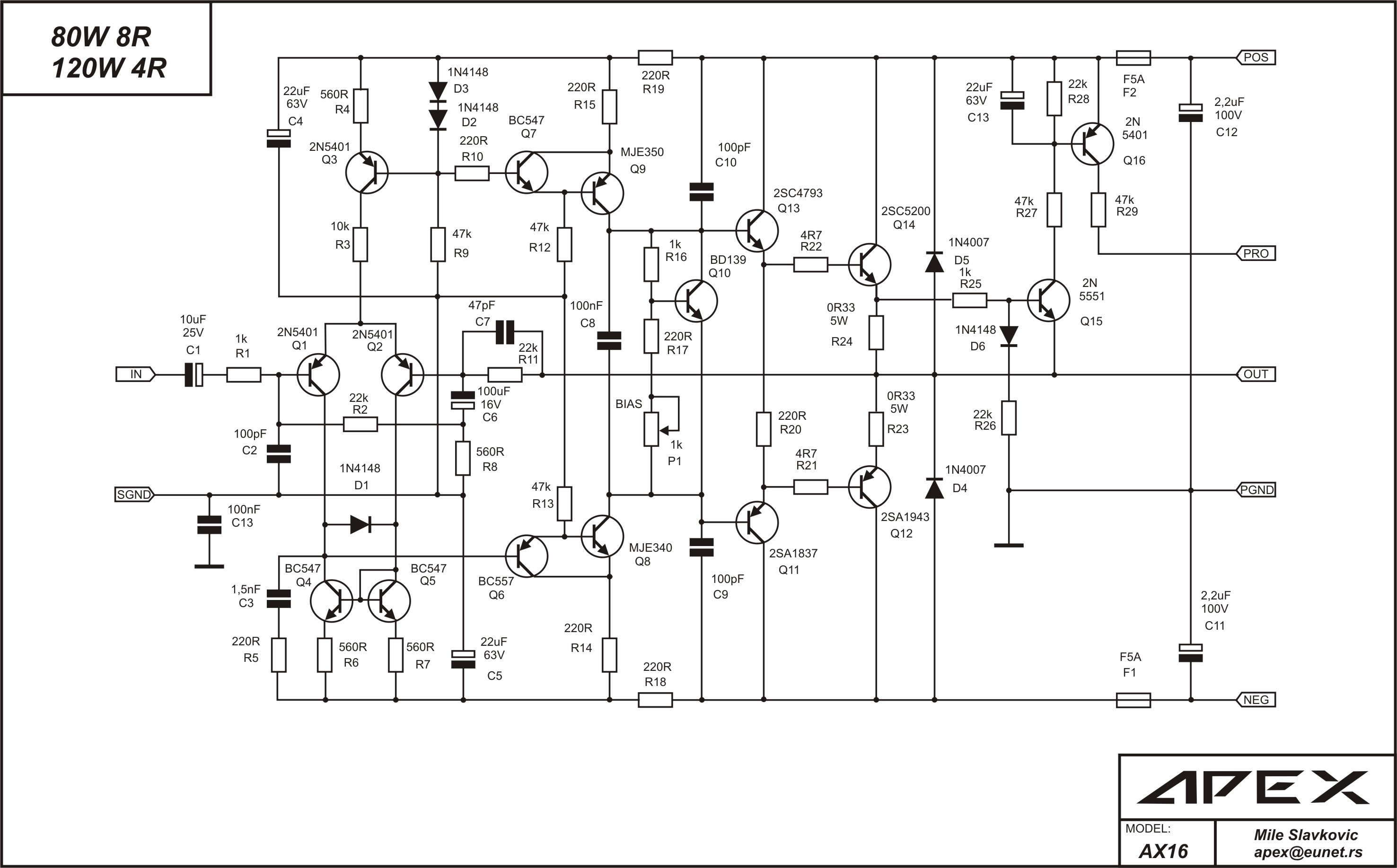

AX16 is AX14 with add overload/short circuit detection PRO adapter. Reguleted PSU15 is for any amp.

PSU 10R AND PSU 15 , done deal!..😀
tnx mr mile.i buil ax17 its very good quallity.,and now need a full protector...need to add overload detector for apex 555?
if yes..tell me to add and design a new version af apeex555.i do this.

Hello prasi and Mr. Mile, I've changed power transter with TO-264 package and track change by rotating MJ15030. Capacitor removed from Layout because I have allready simple PSU.
Regard
very nicely done!..congrats...yes, this one can be used when you already have simple bulk PSU with caps. Even I have such simple PSUs and I could add this regulated PSU as additional.
You could slightly move away the output transistors so they dont foul with V+ and V- faston connectors..
