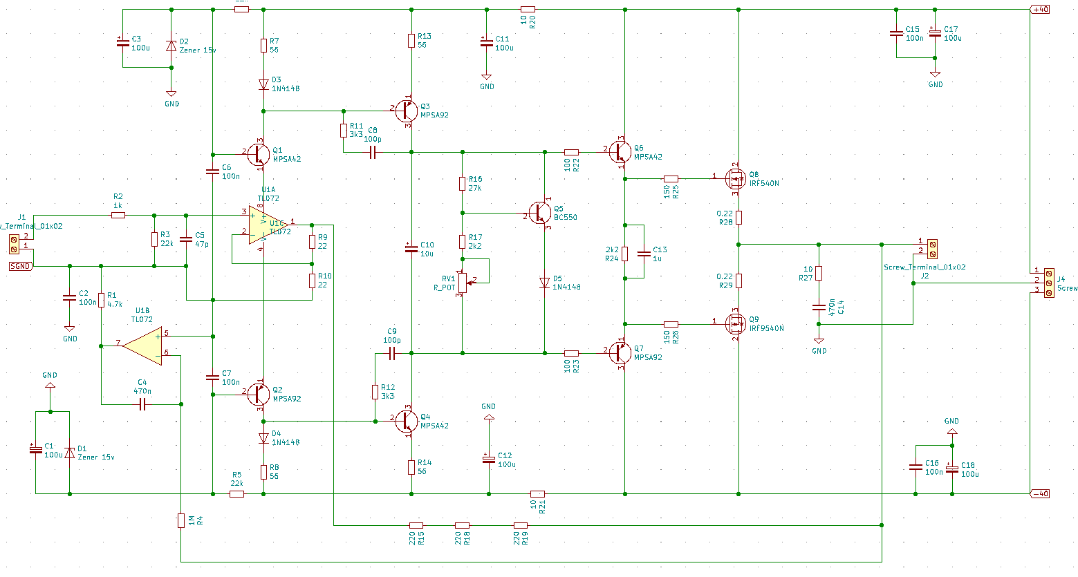

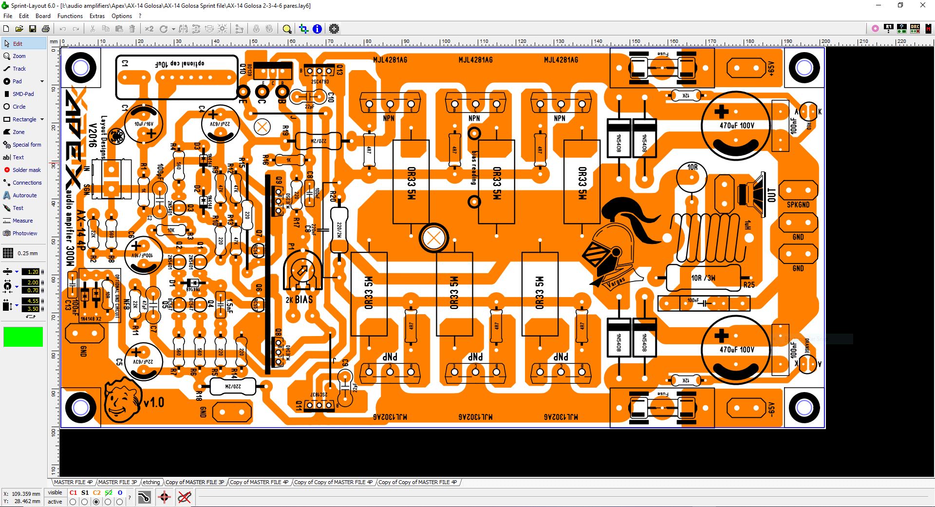

Now if someone could possibly share the latest working pcb layout for this amplifier, I would greatly appreciate it. This is gonna be my next build to power my Onkyo speakers.
Just the latest working pcb layout and the schematic.

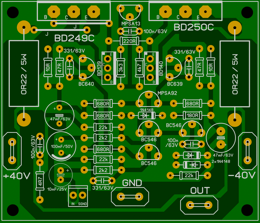

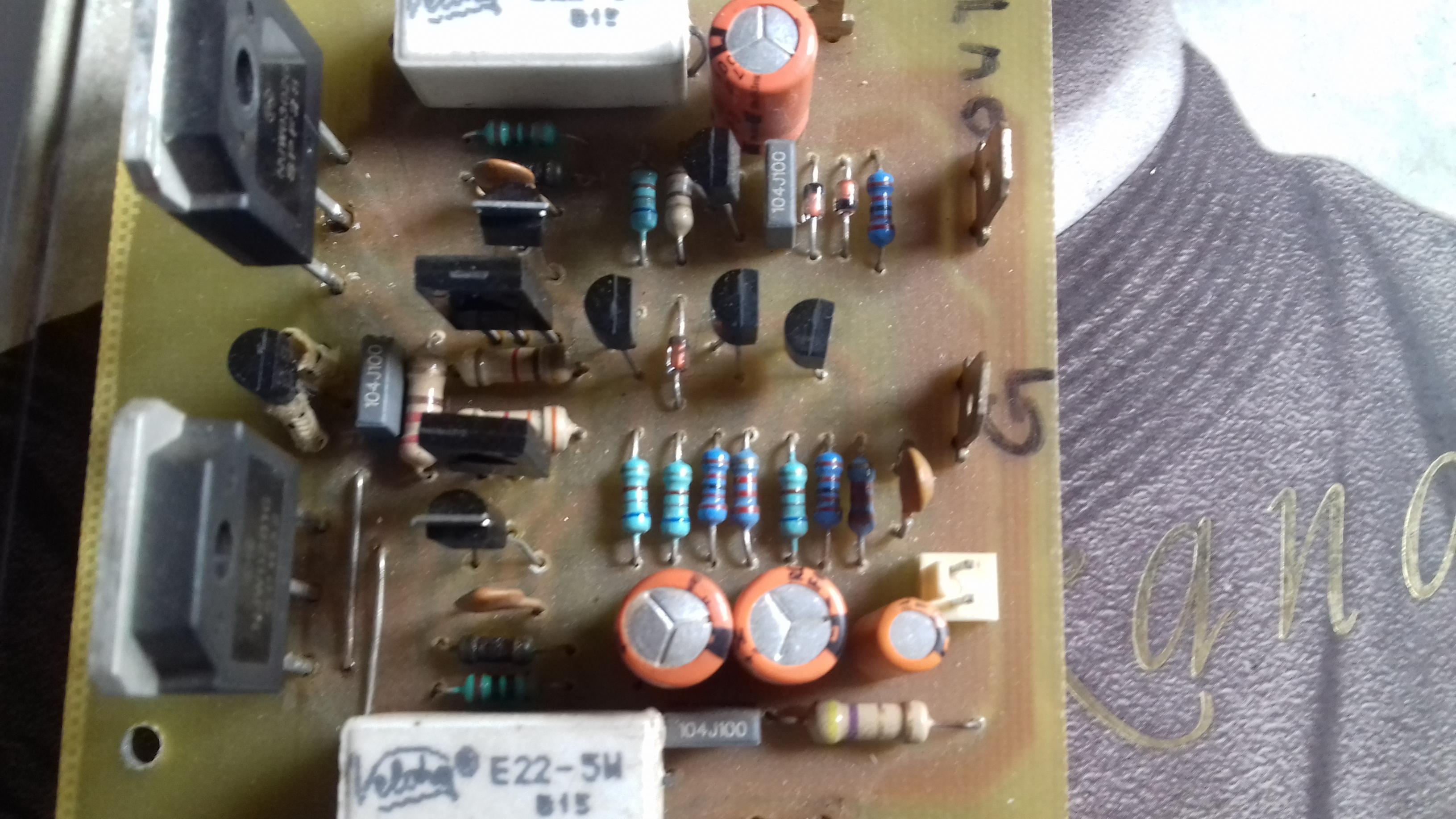

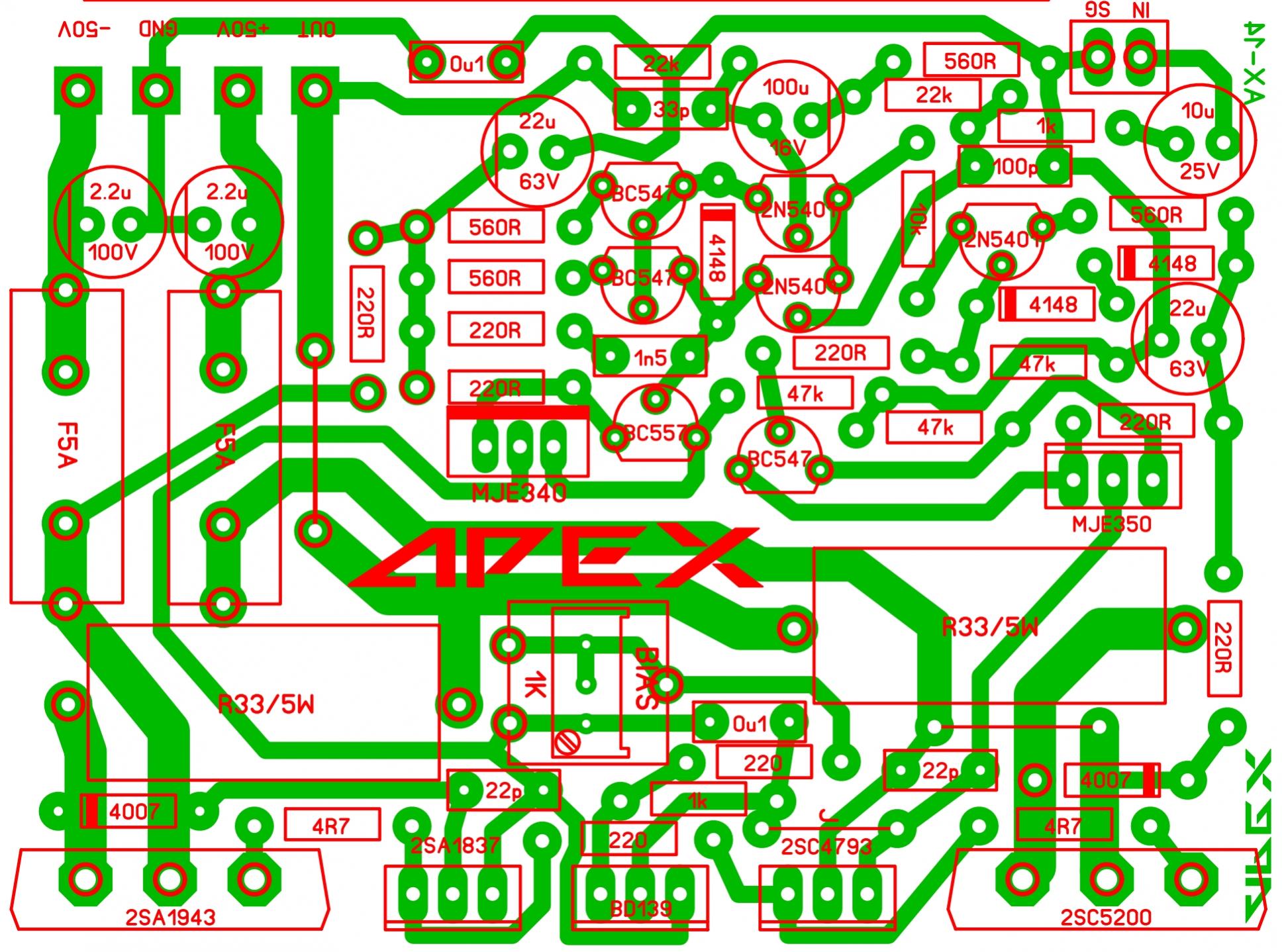

Everytime I go through this build thread, and I think I found the right pcb layout, someone suggests something else wrong or that needs to change 🙂
The layout I used was pretty similar to the original so if there is something better I don't know what it is.

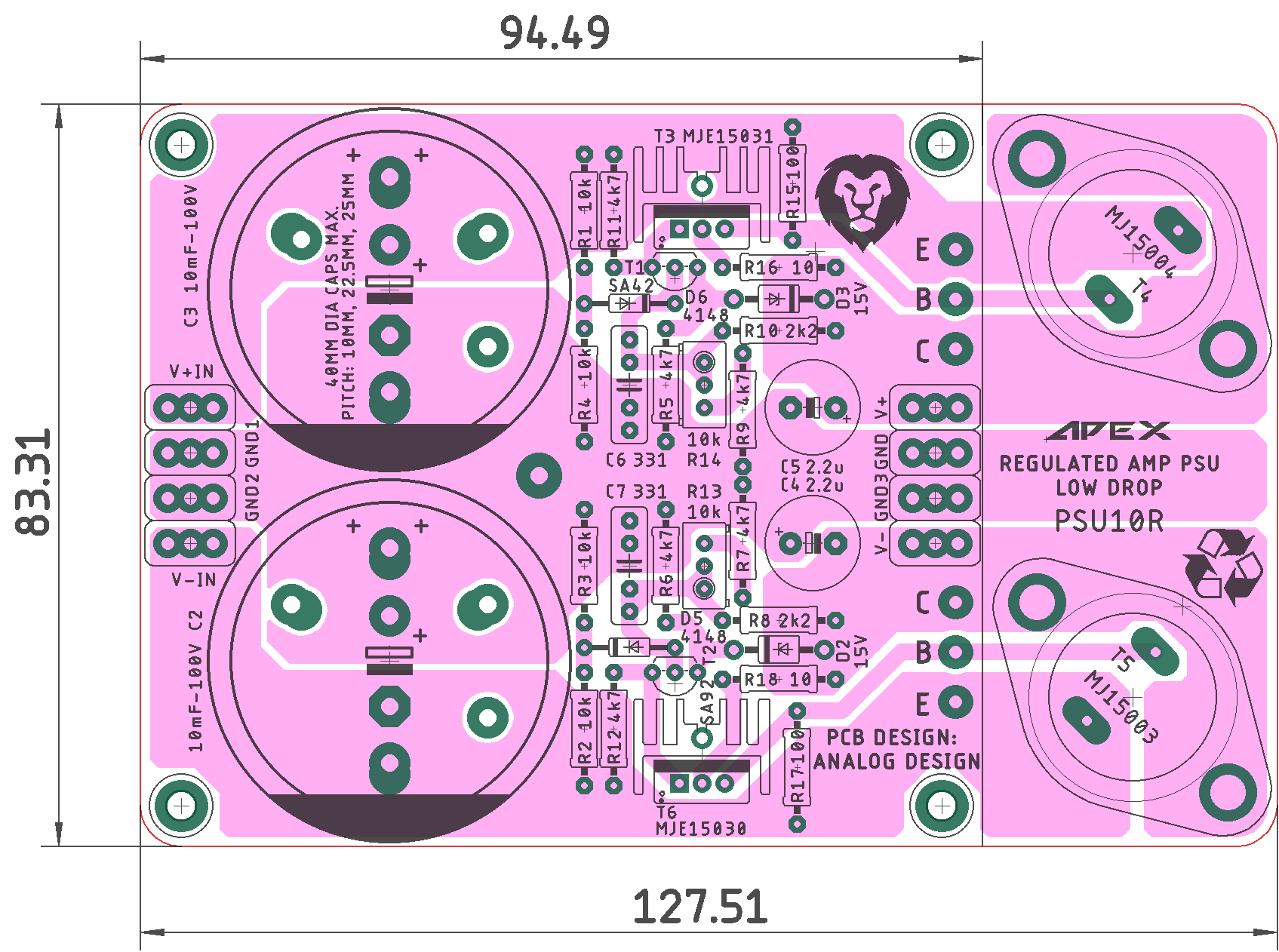

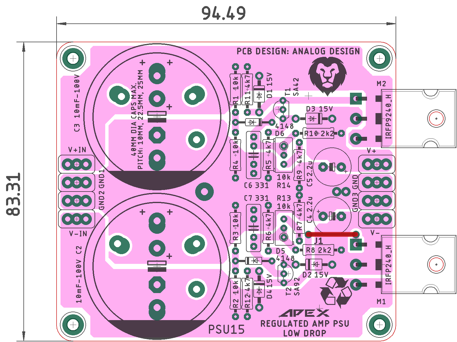

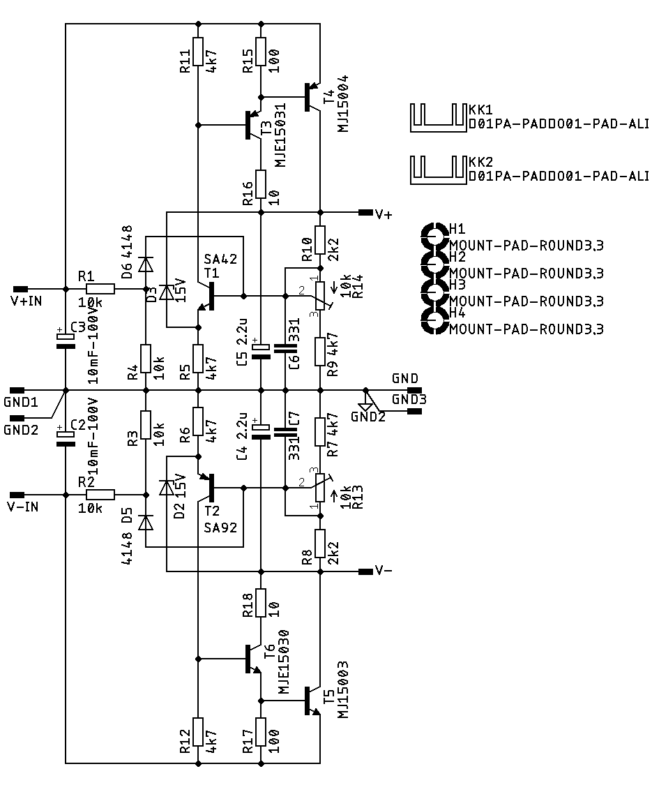

PSU 10R AND PSU 15 , done deal!..😀
Same mounting hole distances maintained. Also given pads for output devices PSU10R, if anyone wants to run wires to heatsink.
regards
prasi

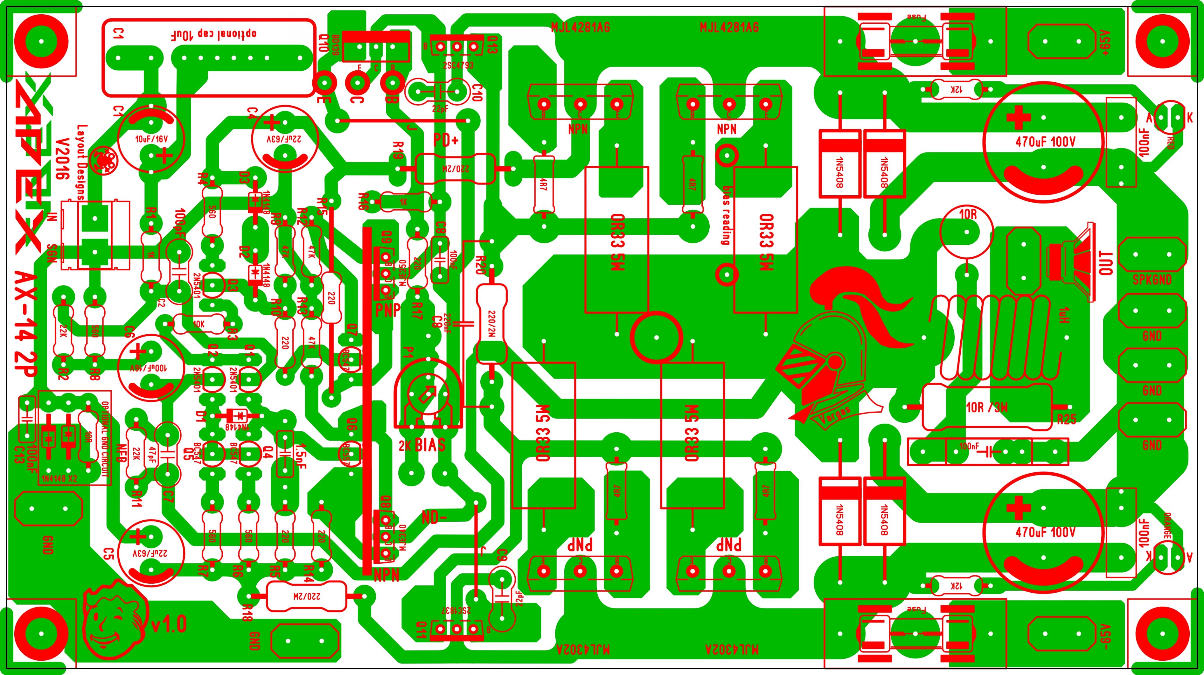

This is the one I had my eye on yes. Thank you sir. Now to try and cut away all the green color and then convert it to black and white.
If anybody has the plain pcb image for the above file shared by still4given, please will you share it.
Thank you
I have it. What is it that your need? Are you going to etch your own boards? If so, do you use toner transfer or Photo sense? I can give you the files for the foil and the silk for the top in PDF.
Hi there
I do the toner transfer method. Sheew, I would really appreciate it if you can offer the black and white pcb images, and silk in pdf and maybe the bom. Its a pain in the behind to try and get rid of all that green in some of the images 🙂
Here is both for those who may also need them.
