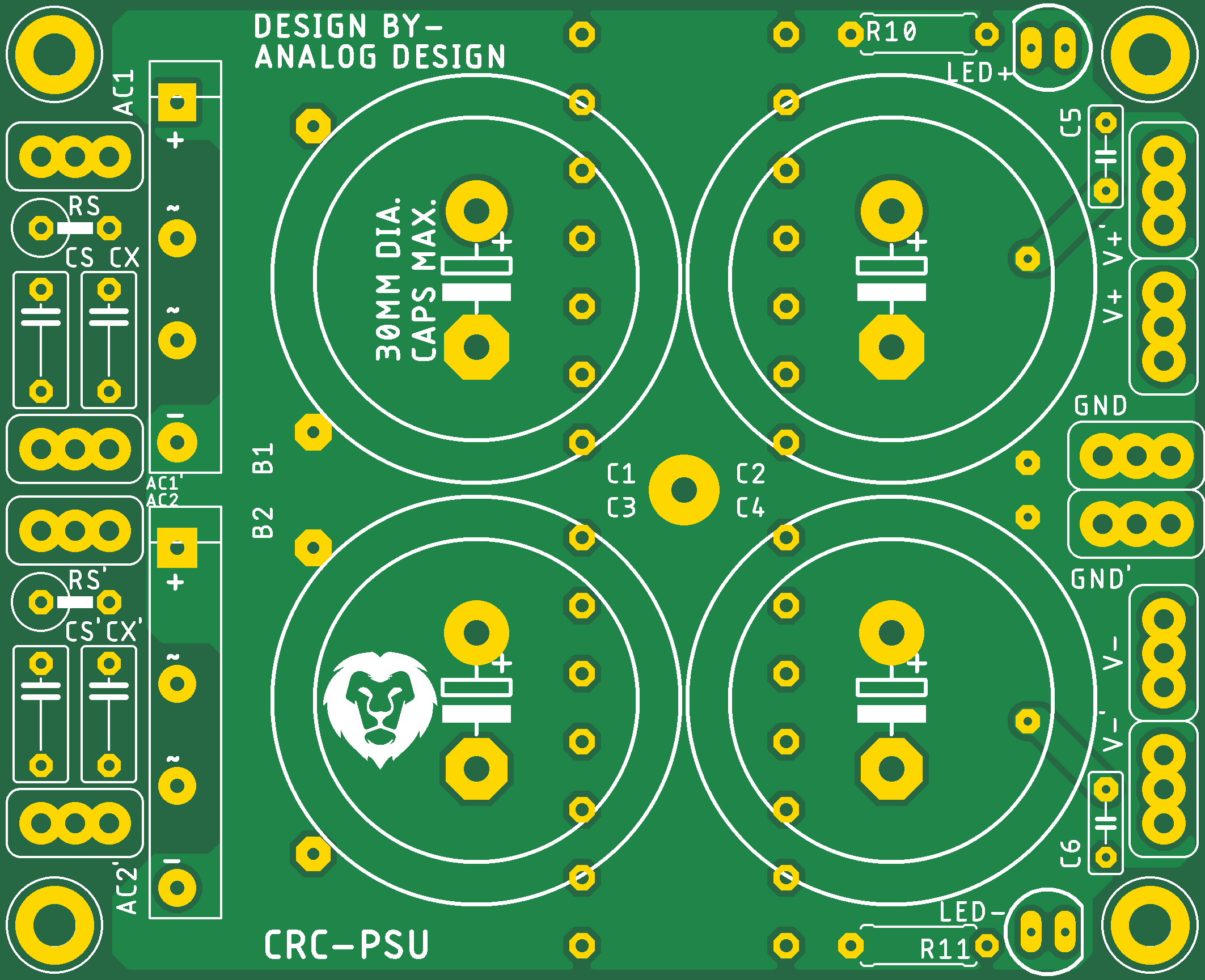

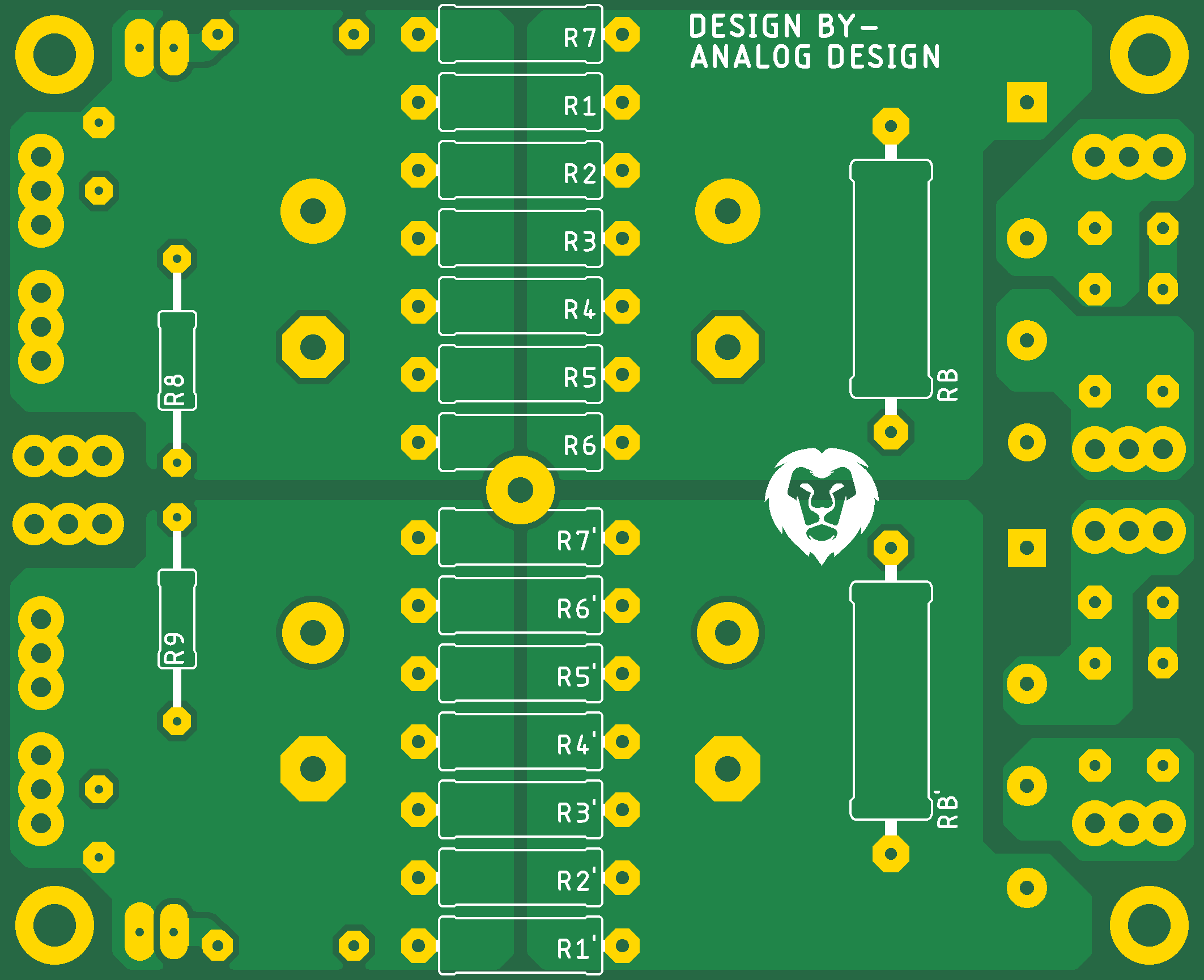

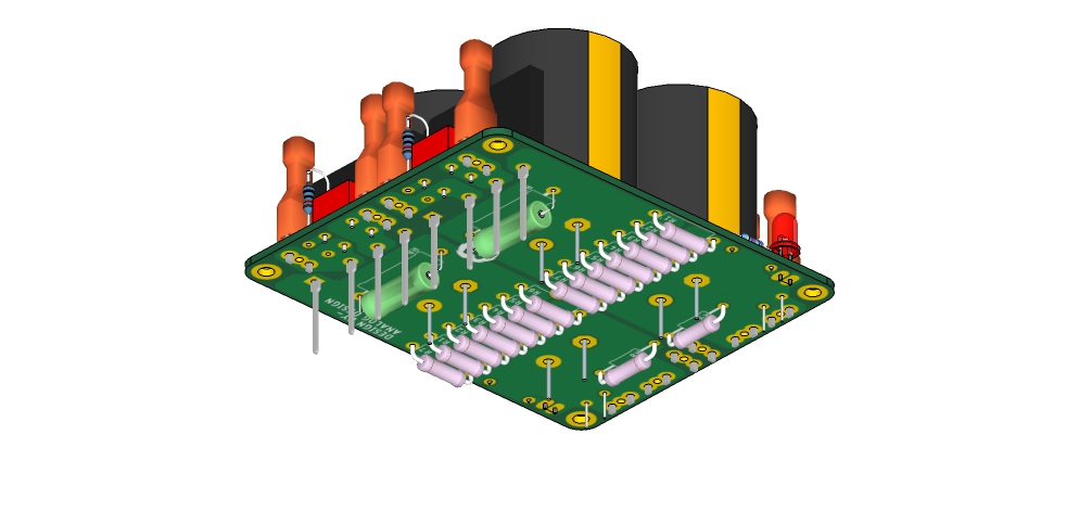

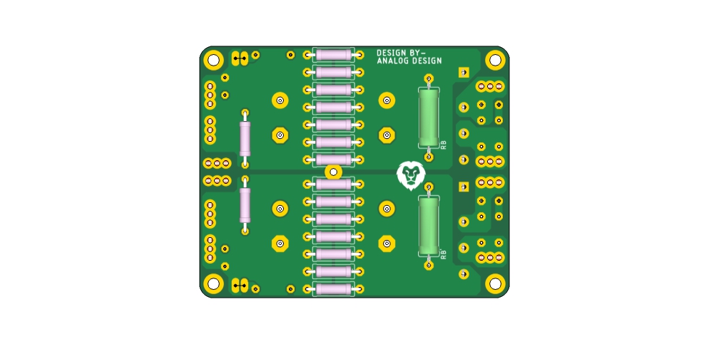

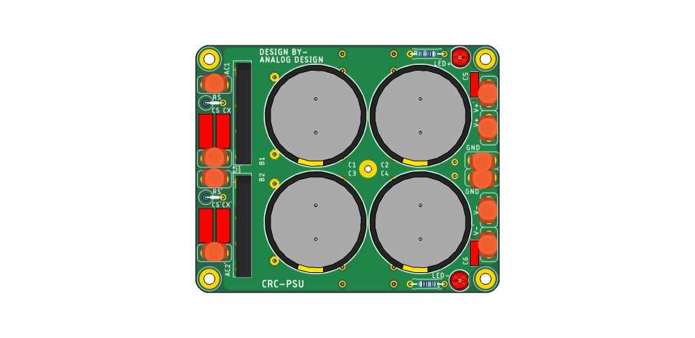

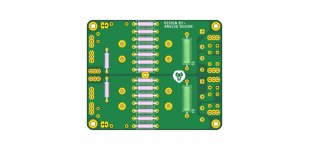

here are gerbers and sch... you could use a small aluminium plate as heatsink ( shown as hatched lines ) for the rectifiers (insulate rectifiers if using such single heatsink).
Thanks Prasi, yes I see that Chinese board houses are not accepting any orders if shipping to India. Nice idea of having the big wattage resistors underneath the board as well as the bleeder resistors, then we need to install slightly big spacers for the board.
If using onboard bridge rectifiers B1/B2 which needs to be isolated if using a single aluminium plate as heat sink. Then in that case I can skip the 4 diodes (marked CS,CS',CX, CX') and a pair of resistors (marked RS,RS') directly connect the transformer secondaries to the 3 hole marked 4 pins.
If I use offboard bridge rectifiers then I can connect the +/- from the bridge rectifiers directly to the +/- near the either side of the 2 bridge rectifiers. What is the purpose of RB and RB' which I can see underneath? I thought of using 1 of 0.22 or 0.33R 5W cement type resistors on each side (R7 and R1' so that I can install them on top of the board rather than underneath) with 4 capacitors of 10000uf 63v as my usage is going to be not more than 30v@5A AC transformer.
No, please study the schematic carefully...
1. using on-board rectifiers b1 /b2:
cs/cx , cx', cs' and rs , rs' are the quasimodo snubber components (optional).
2. off board rectifiers:
connect the off-board first bridge rectifier's +ve WIRE to the B1+ terminal towards the top AND rectifier's - wire to the B1's - terminal.
connect the off-board second bridge rectifier's + wire to the B2's + terminal and then rectifier's - wire to the B2's - terminal.
RB and RB' are the bleeder resistors...
R1 to R7 on positive and R1'-R7' on the negative side are in parallel...
So you would be better off using 1 ohm , 1W to 2W resistors.
I will make a 3D on how to mount components...
edit: 3-d pics attached

Thanks Prasi, I think I understood the schematic correctly but maybe did not put the markings correctly for the offboard rectifiers if I am using. I will better use onboard rectifiers looking at the small form factor of the board 🙂
Regarding the R1-7 and R1'-R7' you are suggesting to use either 1R of 1W/2W resistors as they are parallel rather than using one of 0.1R 5W resistor like this 10pcs BPR56 5W 0.1 0.15 0.22 0.25 0.33 0.5 ohm Non inductive Ceramic Cement Resistor 0.1R 0.15R 0.22R 0.25R 0.33R 0.5R|Resistors| | - AliExpress as 1R of 8 in parallel makes it to 0.12R. As I was thinking of using the cement resistor on top of the board and for better heat dissipation.
Thanks again
Also a bridge rectifier like this - 5PCS 25A 1000V diode bridge rectifier KBU2510|Rectifiers| | - AliExpress should be sufficient looking at the 3D image should easily fit and with the mounting hole we can put a small aluminium plate with some kind of insulation if both the rectifiers are mounted on the same plate. I am not sure if I have to use the aluminium plate as I will not be using more than 5A secondary trafo with this board for now in my class AB builds. What do you think?
thanks
Those legs seem to be equispaced, i had in mind some thing like this. https://www.mouser.in/datasheet/2/427/pb3506-1767492.pdf
for aliexpress, MCIGICM 5PCS 35A 1000V diode bridge rectifier gbj3510|bridge rectifier|diode bridge rectifier|diode bridge - AliExpress
For normal listening, you can get away without using heatsink...
Thanks Prasi, I found similar one as well like the PB3510 🙂
5PCS GBJ35M KBJ3510 PB3510 integrated circuit|integrated circuit|circuit integre| - AliExpress
I think sinking them with an aluminium strip seems to be tricky with the other componens and AC wiring being very close to the rectifiers. Maybe we can lift the rectifiers up a little bit and use the aluminium strips and the plastic isolation To-220 should fit with couple of silicon thermal strips in between with some grease.
Otherwise your boards look perfect and awesome for anyone to build and use, hats off :cheers:

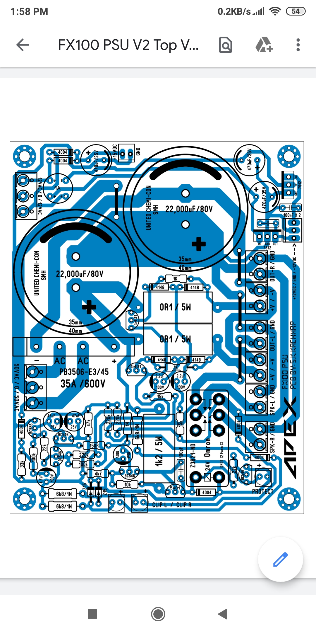

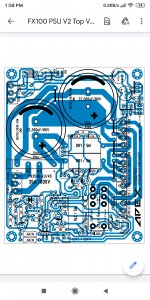

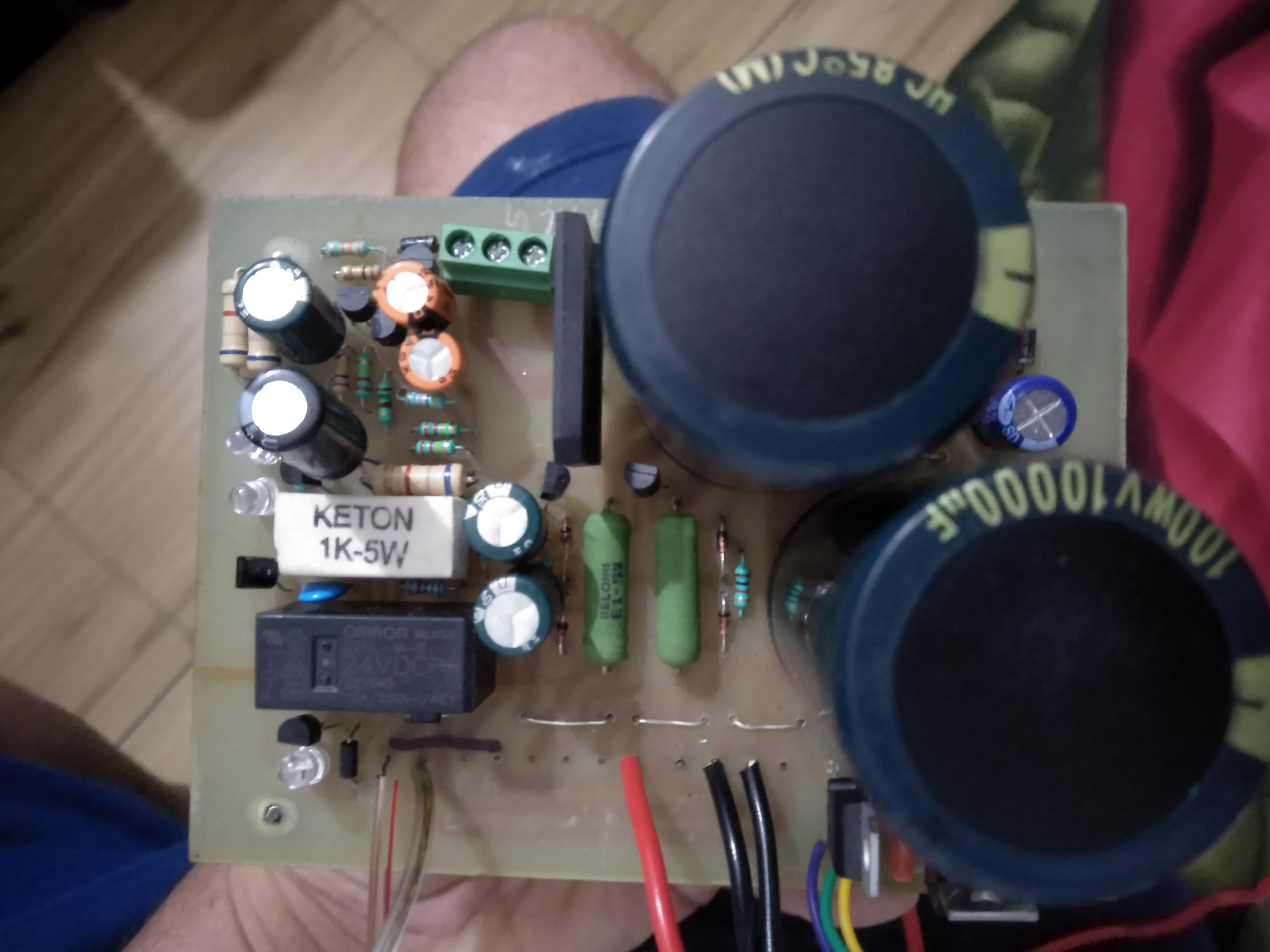

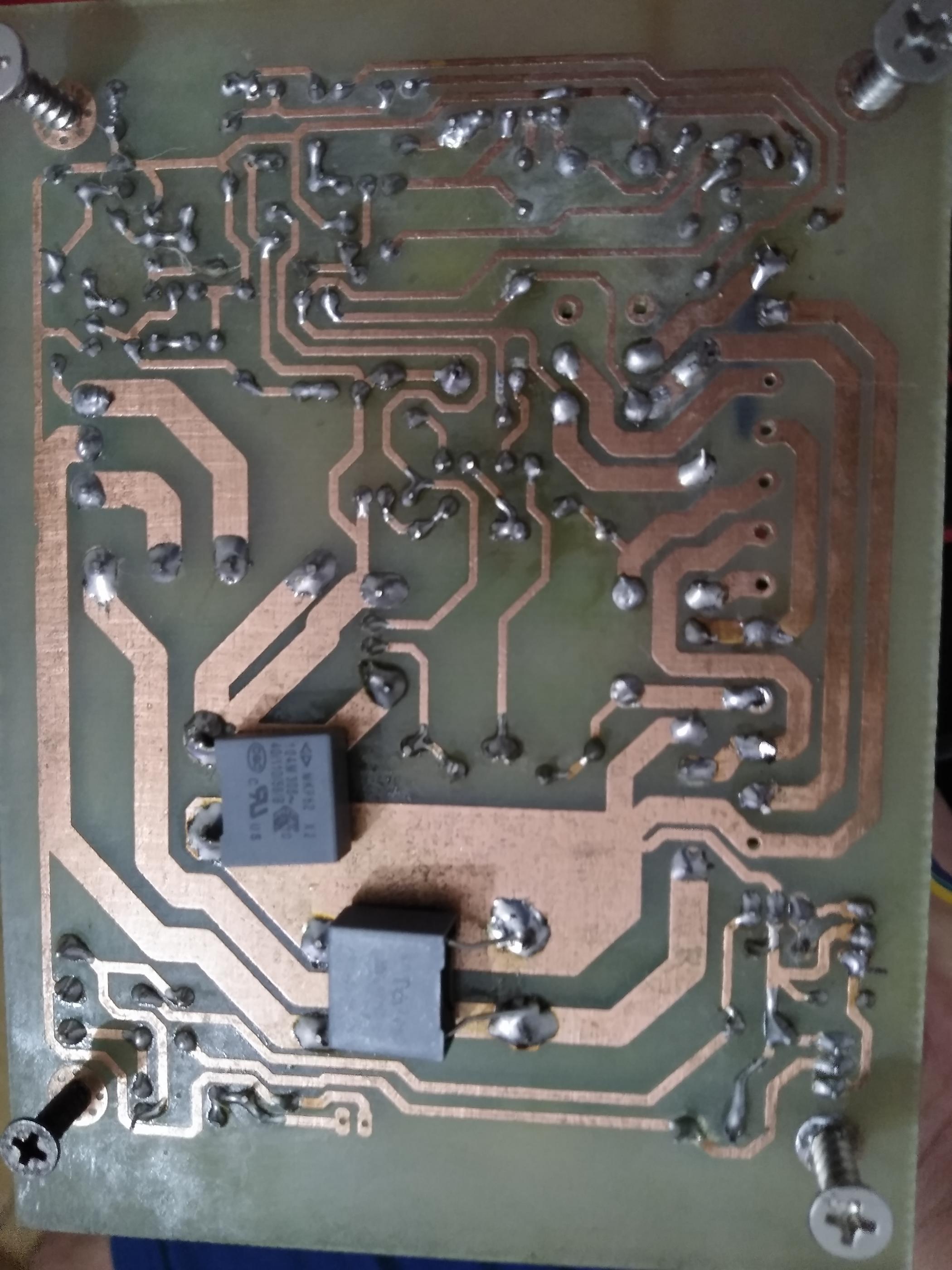

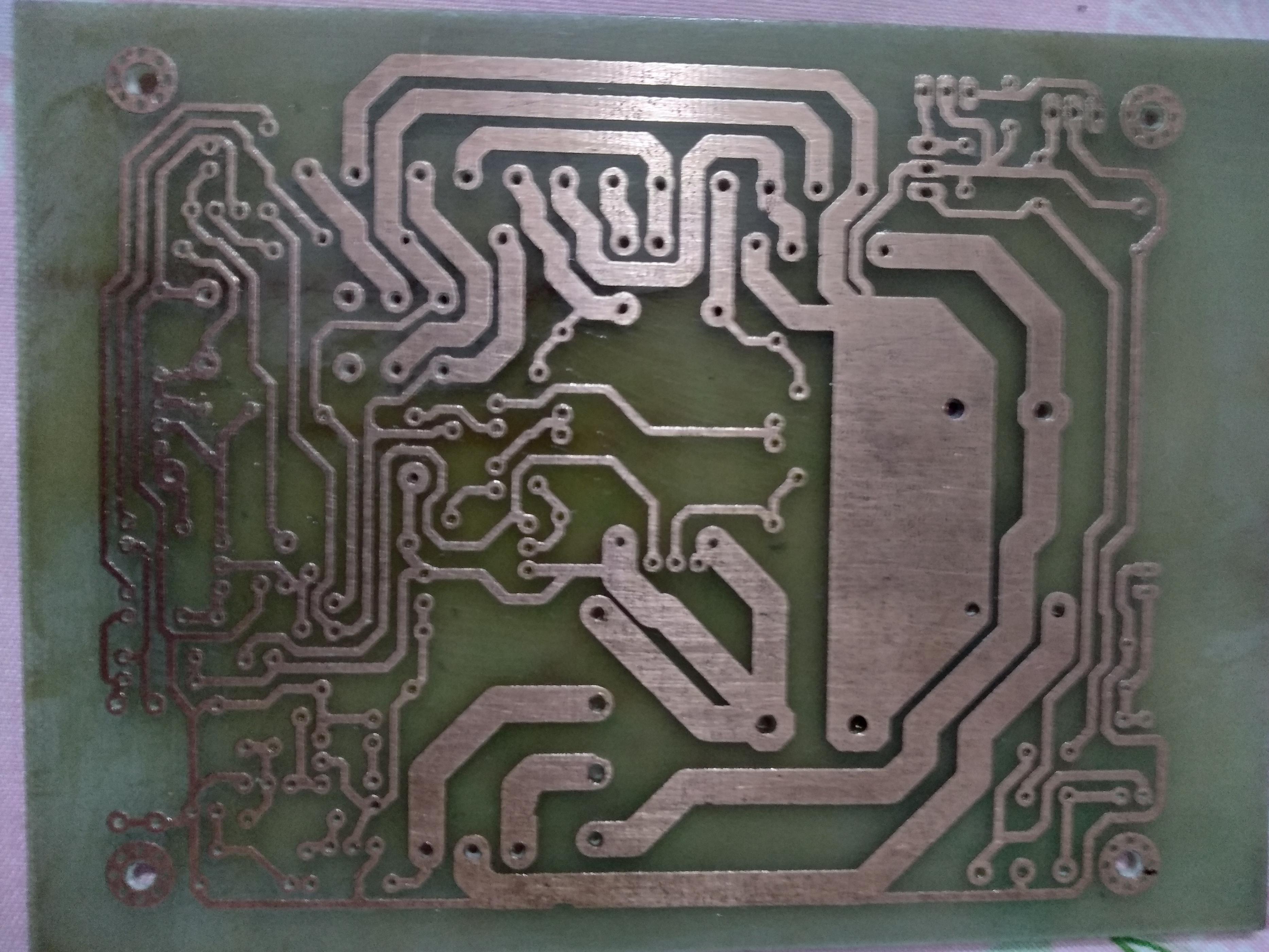

Apex fx 100 psu
Hello guys I made fx 100.every components I checked before set on pcb after soldier.but psu protection not working .like short circuit.and dc also .plz suggest me .how i sold first I give 35-0-35 also on 50 0 50 ac volt
