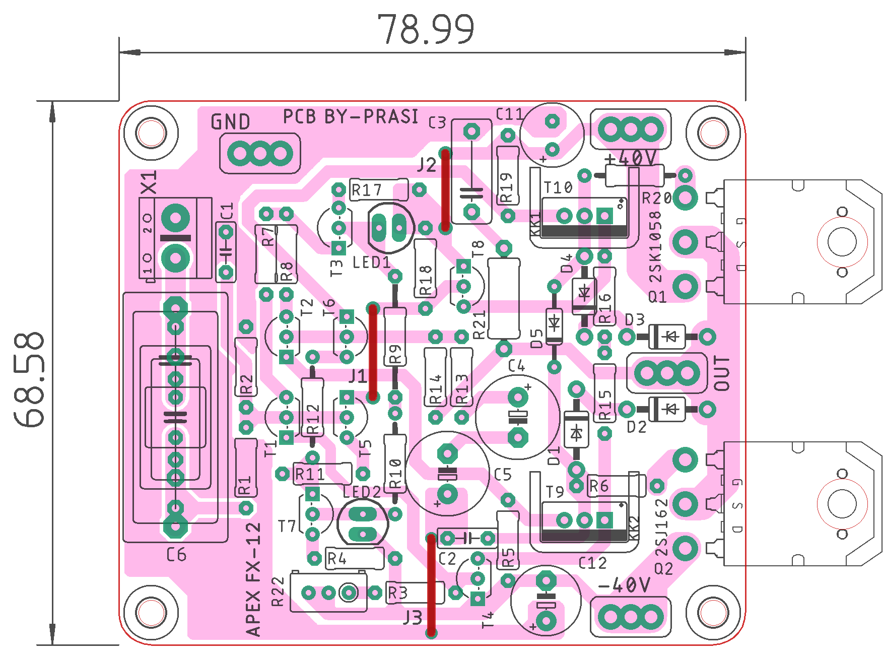

Hello brother, yes this PCB layout correct. Only one change, 2k2 resistance change with 1k or 820R or 680R.
I made that PCB on https://www.diyaudio.com/forums/sol...mate-fidelity-amplifier-1055.html#post5515173
Changed resistance value mark below
Regards
Thanks for helping, but this resistor influences the gain of the amplifier, I made the replacement but still didn't solve it, the bias continues at + -350mV in each 0r33 resistor and does not drop what can be done?

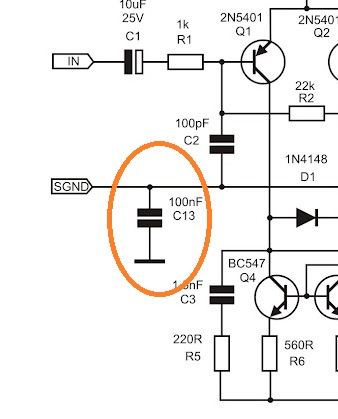

Sir,
I have connected SGND to PGND by removing C13 (100nF) and replacing with 4.7 Ohms /2W Resistor and measured Bias Voltage at across the Emitter Resistors (at two ends), adjusted POT and obtained 26mV and relay clicked on (taken 3 seconds).
I convey my thanks to all the Members who helped me.

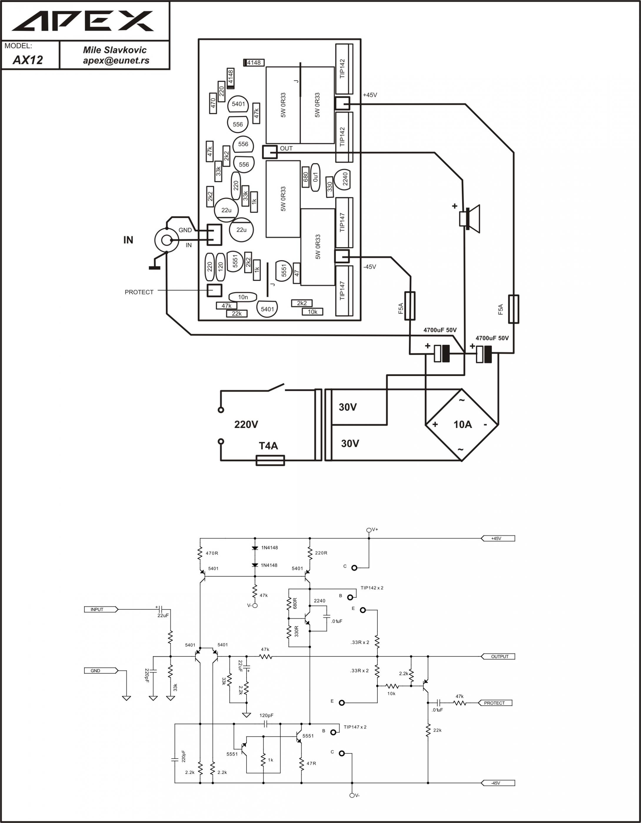

this is how it should be done properly,to avoid ground loop 100W Ultimate Fidelity Amplifier it is another APEX amplifier but the basics are the same.

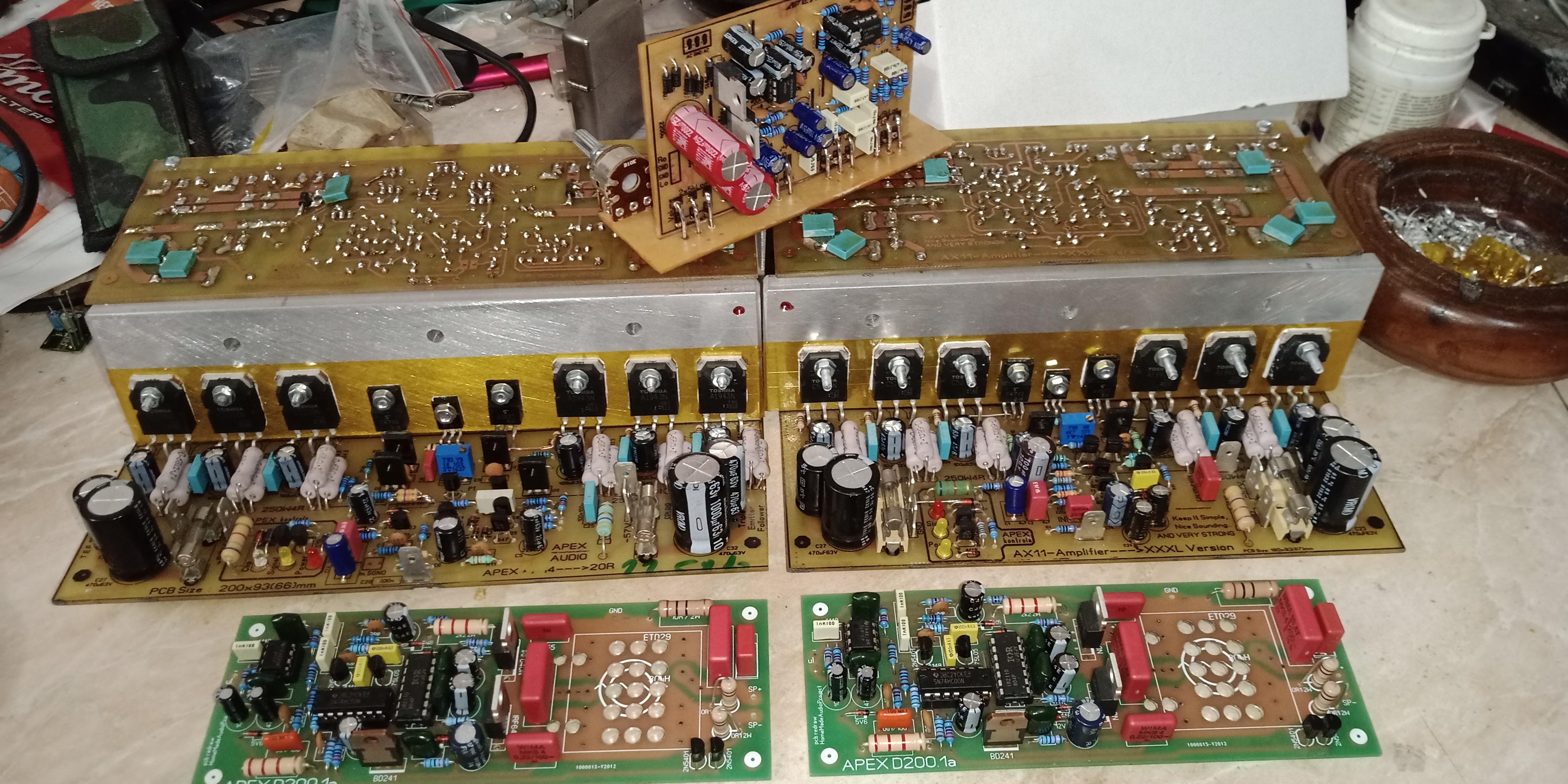

Good morning, I can't adjust my AX11 bias. In the tests the lamp remains on and biases with 350mV and each emitter. I've already changed all the transistors, i installed a 5k pot (in place of 4k7), checked for short circuits, but it didn't work, rotate the pot but do not change bias.
I made some measurements:
Differential pair: BC546
BxC=1,95V, 2,03V
CxE=1,31V, 1,37V
BxE=595mV, 594mV
BC546
BxC=2,70V
CxE=630mV
BxC=2,07V
BC639 and BC640
BxC= 2,03V, 1,95V
CxE= 1,37V, 1,31V
BxE= 594mV, 595mV
BD139 and BD140
BxC= 1,98V, 2,07V
CxE= 2,65V, 2,71V
BxE= 630mV, 639mV
BC517
BxC=2,72V
CxE=3,38V
BxE=661mV
2SC5200 and 2SA1943
BxC=2,65V, 2,68V
CxE=3,30V, 3,35V
BxE=672mV, 694mV
I forgot to measure mpsa92, if necessary I will do the measurement.
To help is welcome, thank you.
(I'm testing the amplifier on the right)
Does anyone have any guidance ??
