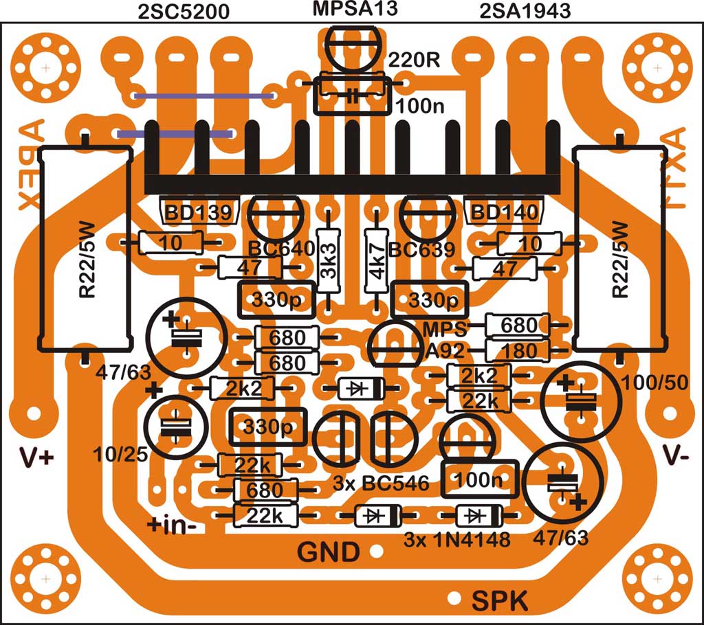

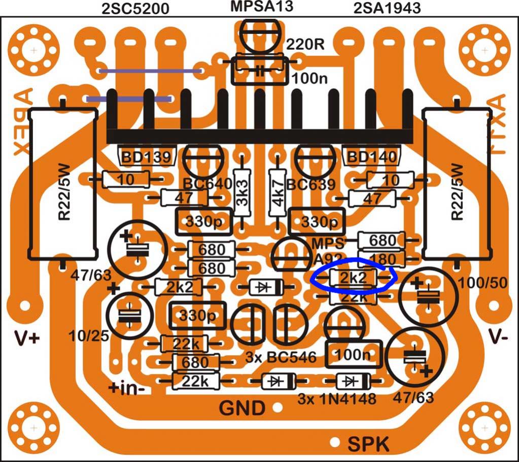

Good morning, I can't adjust my AX11 bias. In the tests the lamp remains on and biases with 350mV and each emitter. I've already changed all the transistors, i installed a 5k pot (in place of 4k7), checked for short circuits, but it didn't work, rotate the pot but do not change bias.
I made some measurements:

BC 517 is this transistor in right position, haven't you rotated it 180 degrees? it should be mounted with flat side to the heatsink.
I did it according to this layout, installed BC517 inverted. Is the pcb correct?

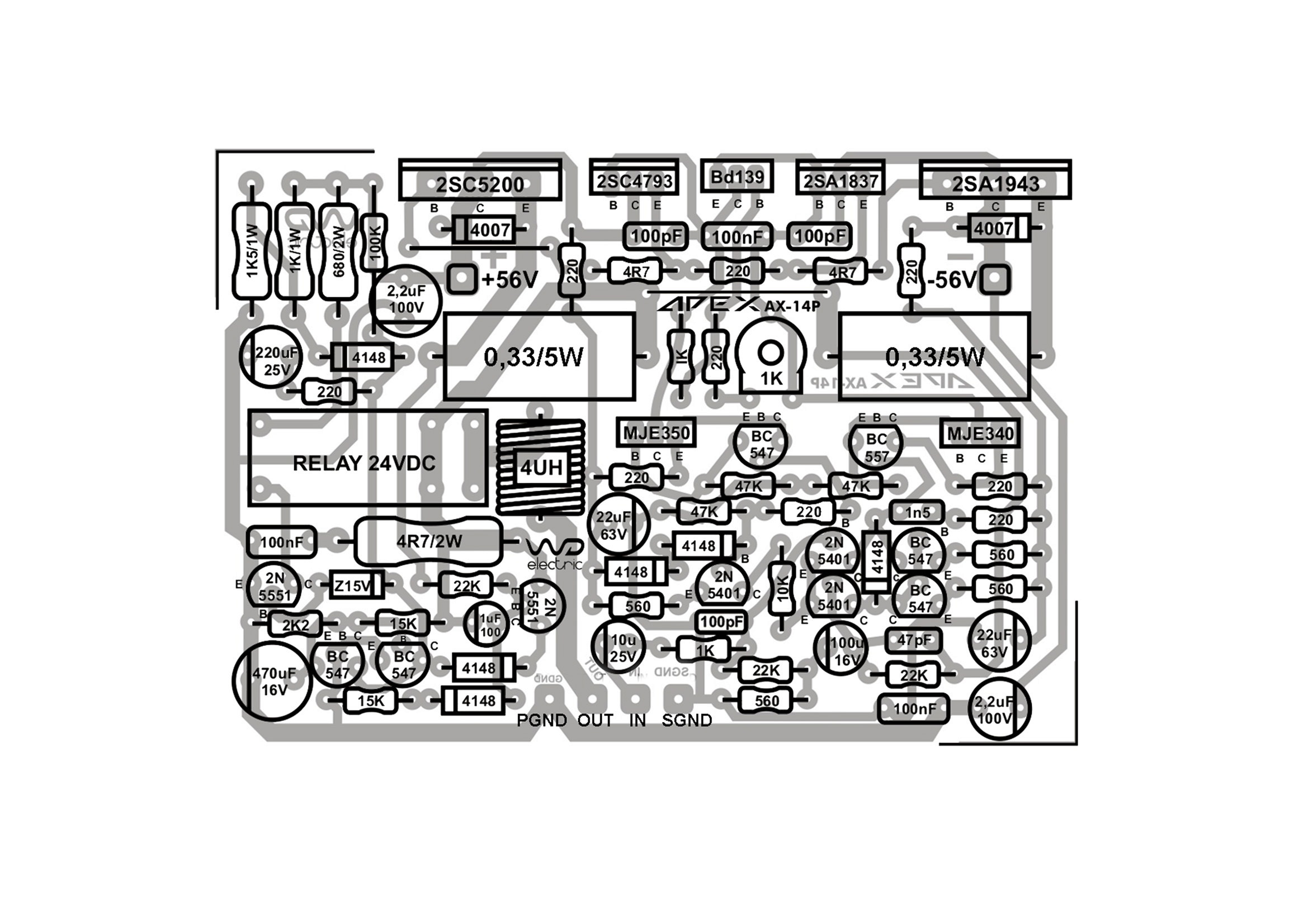

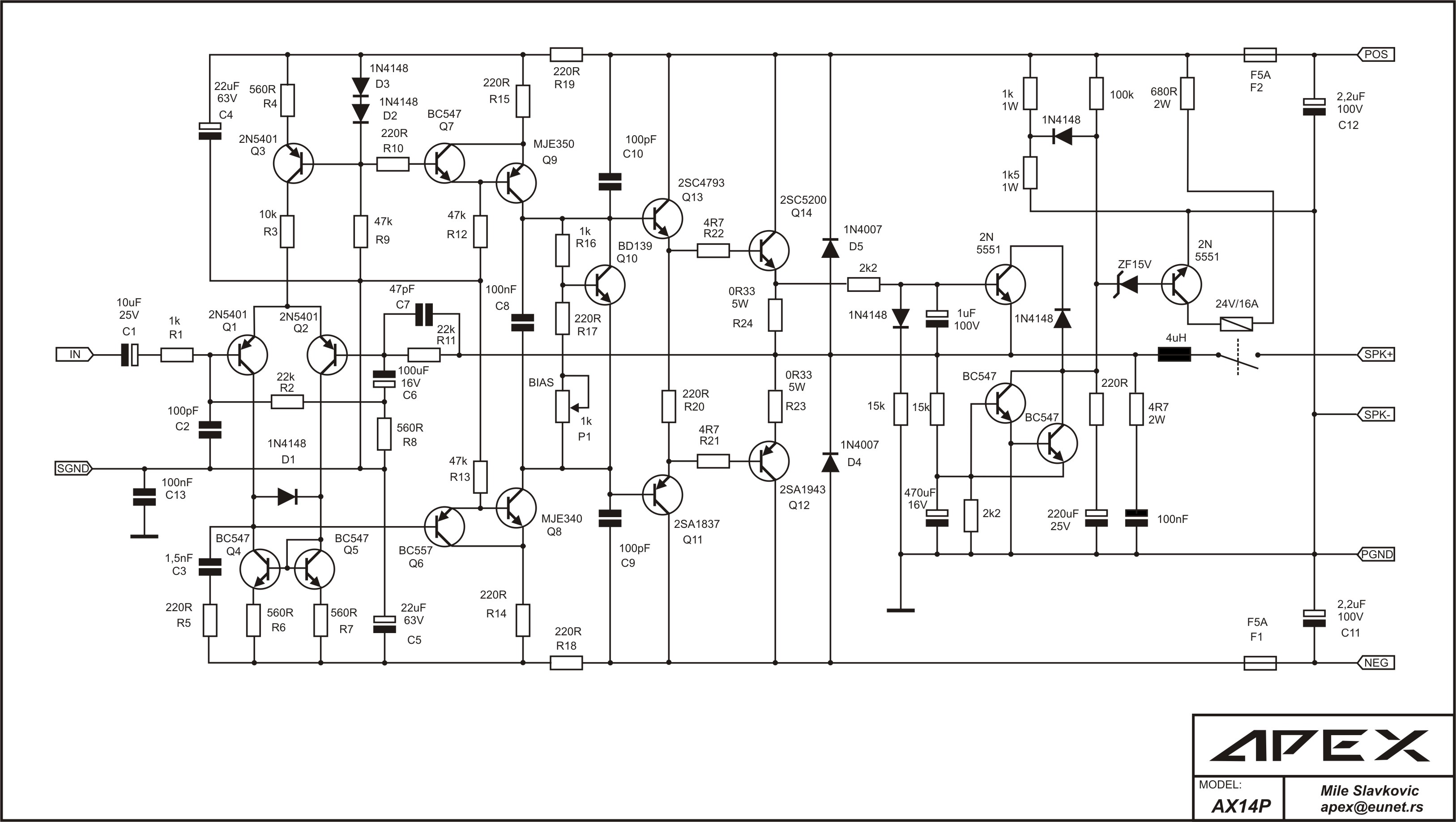

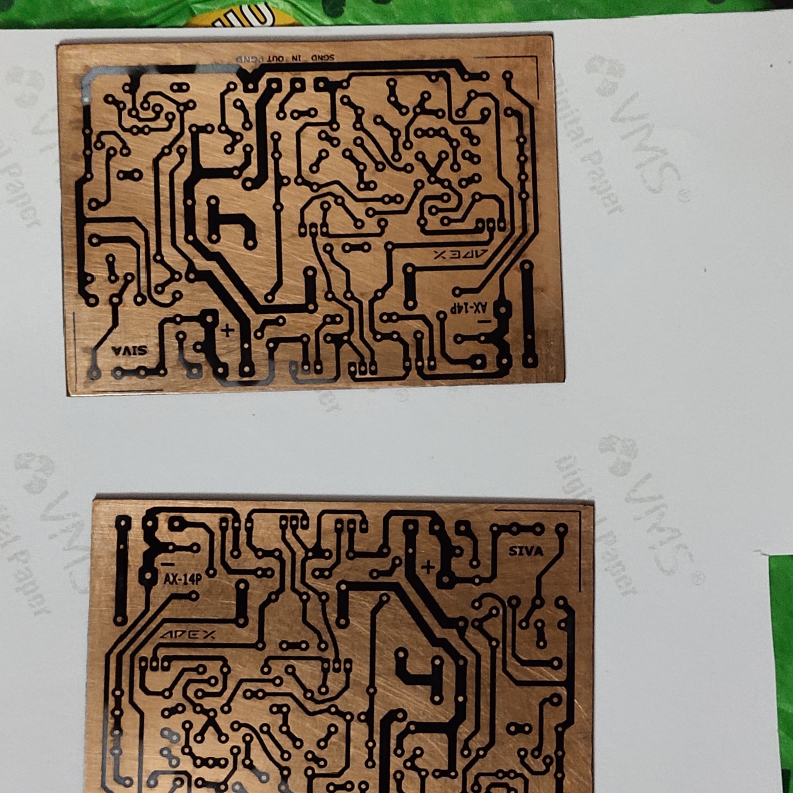

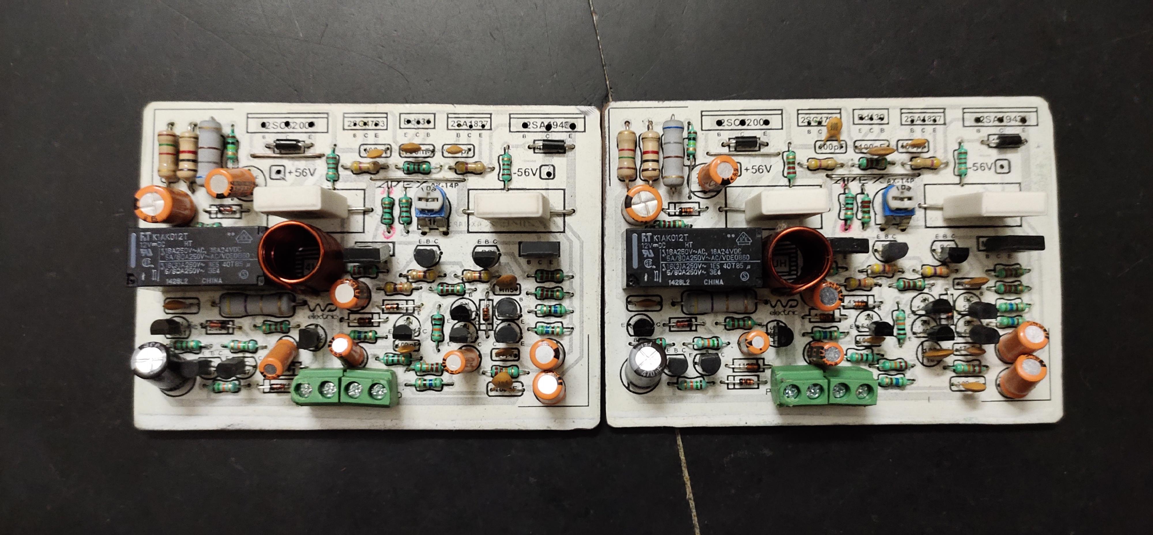

Sir,
I have built two individual channels of APEX AX14P according to the Circuit and PCB attached here with. After fixing the Head Sink, shorted Input to Power Ground, disconnected the Speakers, and applied +45/-45V . Measured the voltage at Emitter Resistors by adjusting the POT., the voltage is varying from 13V to 15V . The Output Transistors are also getting hot within few seconds. I have thoroughly verified all the components and its positions (pin to pin) though I bought new ones.
After that, I have changed the R16 (1k) Resistor at the Base of Q10 (BD139) with 470 Ohms. The Bias voltage is remained same (13v to 15v) and there is not heat at Output Transistors.
It is present situation of my Amplifier.
I am here with attaching the images of Circuit Schematics and also PCB made by me for your ready reference.
Sir, Please kindly help me in trouble shooting and I am very enthusiastic to complete the Amplifier.
Thanking you, Sir.

13V over 2x0,2Ohm is 13/0.4=32,5A of current. what are the values of your emiter resistors,and how do you measure it? have you connected input gnd to psu GND?
My amplifier is AX14P. The values of Emitter Resistors are 0.33 Ohms/5W. I connected Input Ground to Power Supply Ground. Connected DMM Negative Proble to Power Supply Ground; and Positive Probe at across the Emitter Resisters (R23 and R24)

so,you have measured output symmetry and not voltage across the emiter resistor.
voltage across emiter-resistor is measured actually across the emiter resistor - on its two ends.
SGND point from schematic MUST BE CONNECTED TO PSU-GND,than you will not have 13-15V and finally relay will click to connect output.

Yes Sir. I have measured the voltage at the junction of two Resistors not at two ends of single Resistor. Today I will measure according to your suggestion and intimate the result.

I am attaching a PDF with approximate voltages that you should expect with a +-45V rails. These voltages are all measured with reference to ground. Please compare your boards to this schematic. Again these are approximate. Yours may vary slightly but should be close.
