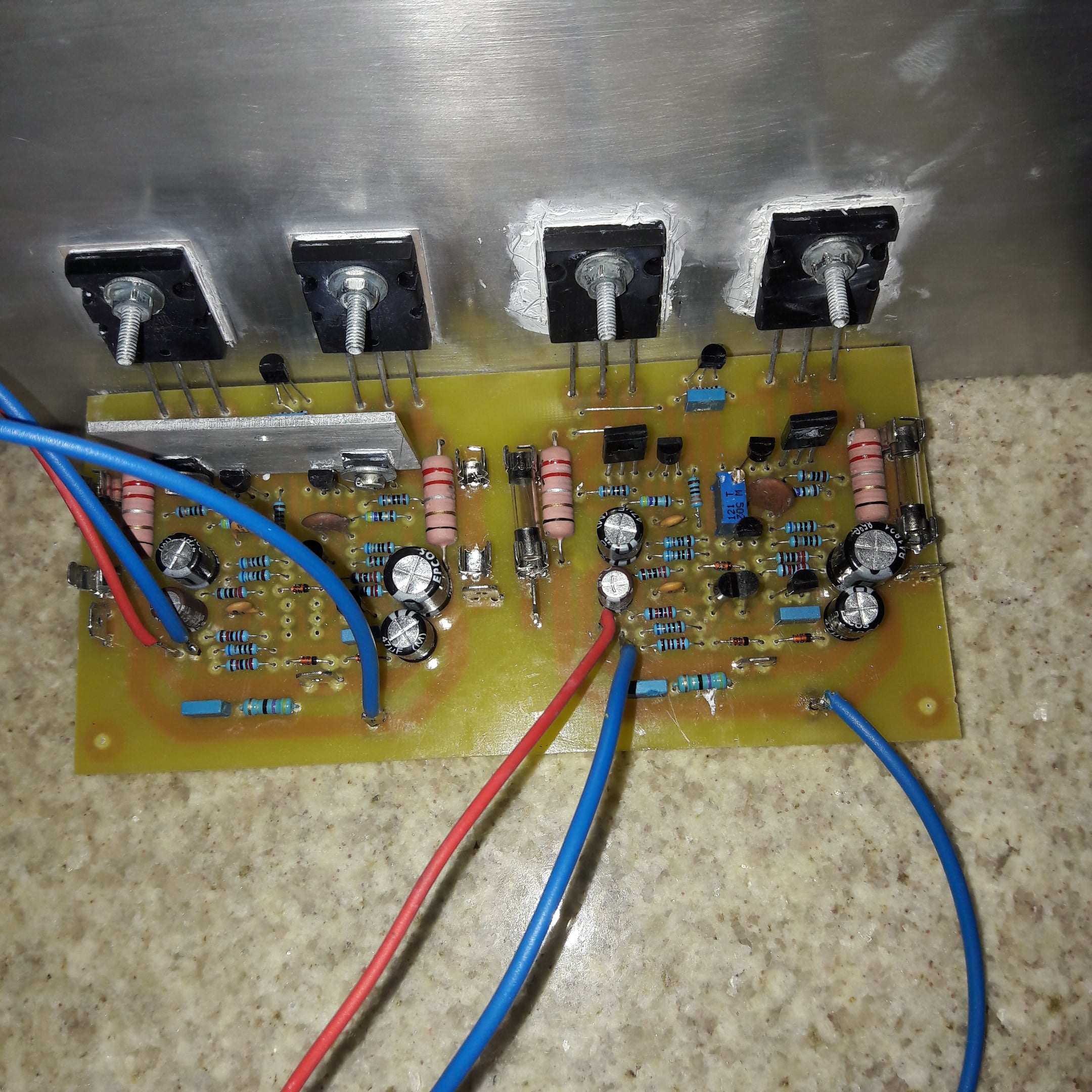

AX11 does not polarize
Good morning, I can't adjust my AX11 bias. In the tests the lamp remains on and biases with 350mV and each emitter. I've already changed all the transistors, i installed a 5k pot (in place of 4k7), checked for short circuits, but it didn't work, rotate the pot but do not change bias.
I made some measurements:
Differential pair: BC546
BxC=1,95V, 2,03V
CxE=1,31V, 1,37V
BxE=595mV, 594mV
BC546
BxC=2,70V
CxE=630mV
BxC=2,07V
BC639 and BC640
BxC= 2,03V, 1,95V
CxE= 1,37V, 1,31V
BxE= 594mV, 595mV
BD139 and BD140
BxC= 1,98V, 2,07V
CxE= 2,65V, 2,71V
BxE= 630mV, 639mV
BC517
BxC=2,72V
CxE=3,38V
BxE=661mV
2SC5200 and 2SA1943
BxC=2,65V, 2,68V
CxE=3,30V, 3,35V
BxE=672mV, 694mV
I forgot to measure mpsa92, if necessary I will do the measurement.
To help is welcome, thank you.
(I'm testing the amplifier on the right)
