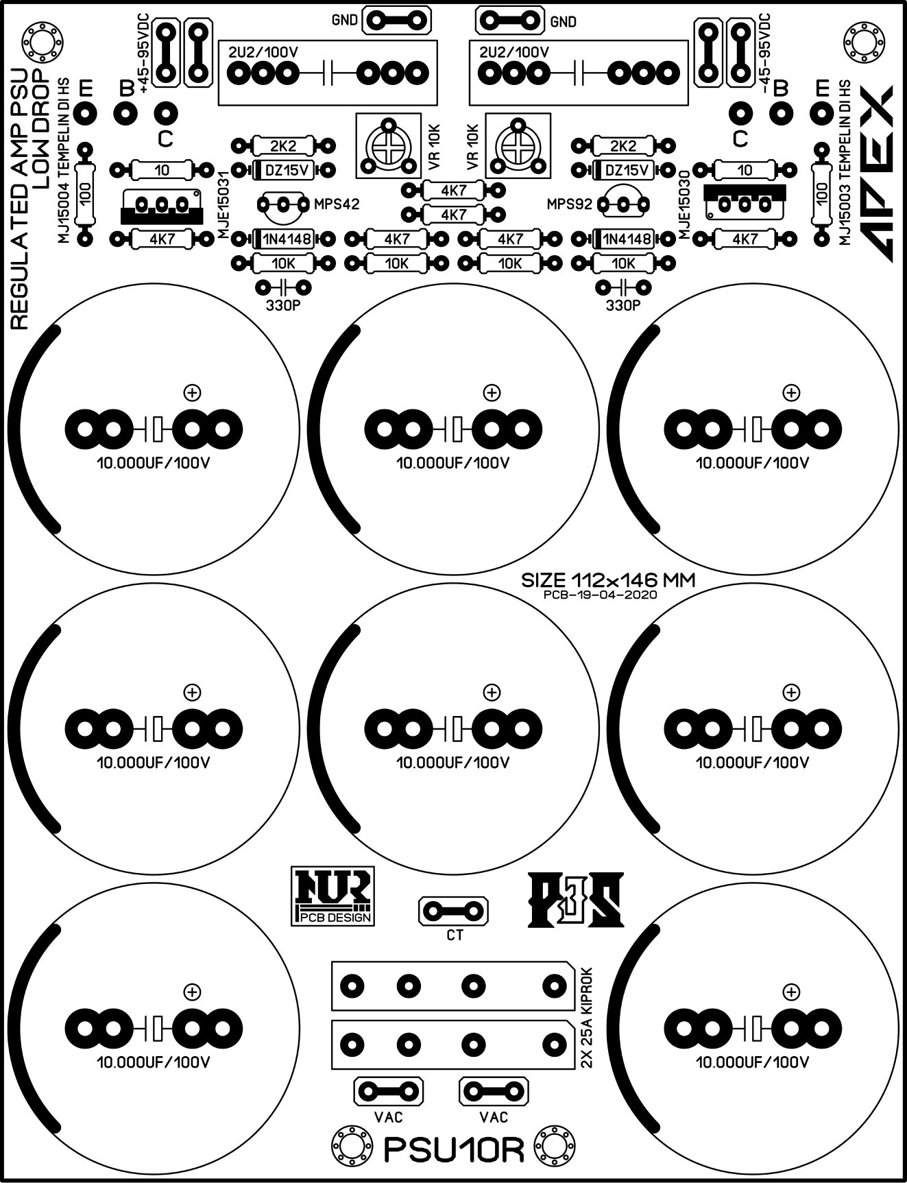

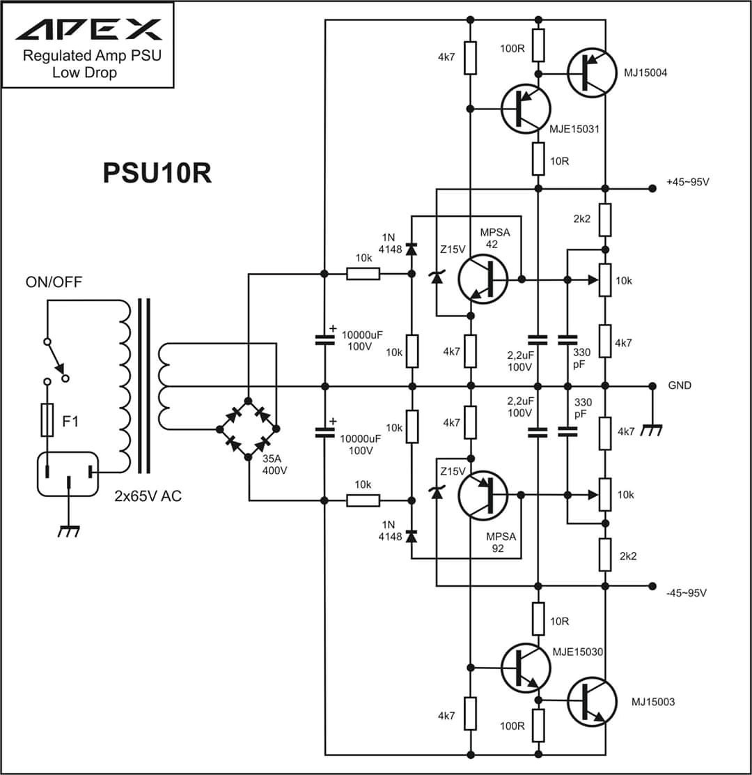

Regarding this circuit, what will the output voltage be if my input voltage is 45-0-45vac? Is this adjustable?

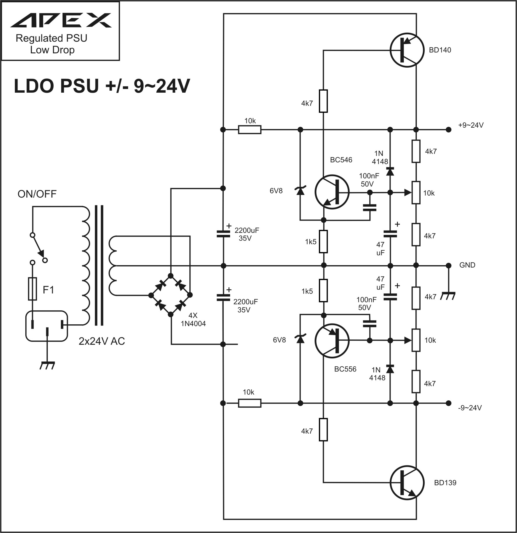

with 15VAC-0-15VAC , can we get +12VDC/0/-12VDC with above circuit?
Would BD139 require heatsink for say 30-50mA current?
regards
prasi
With 15VAC-0-15VAC , you can get +15VDC/0/-15VDC, this is Low Drop Output Regulator. Output voltage can be very close to the DC input voltage.
You can set output from +/-45V to +/-60V with 45-0-45vac input voltage.
Thank you sir, appreciate it. And output current? Is that dependant on input current? I would like to use it on your APEX AX14
Maximum current is 10A, you can use it for AX14 stereo
