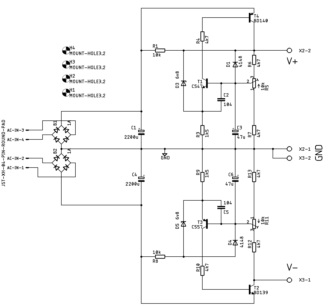

LDO Regulated PSU for Preamps

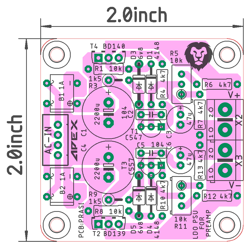

I am wondering if wouldn't be better/easier linear stabilisers L7915 and L7815. Why this is better?
PS: I have no understanding to that circuit, this is why I ask 🙄
10A out of a BD139,140?😕Maximum current is 10A, you can use it for AX14 stereo
never, but you can get it out of the MJ15004 and the MJ15003, BD139/BD140 was the biasing transistor replacement.
I believe you are confusing the PSU10R with the LDO. PSU10R is the one that is 10A.
Aaah, yes it seems I am confusing it with the LDO. My apologies

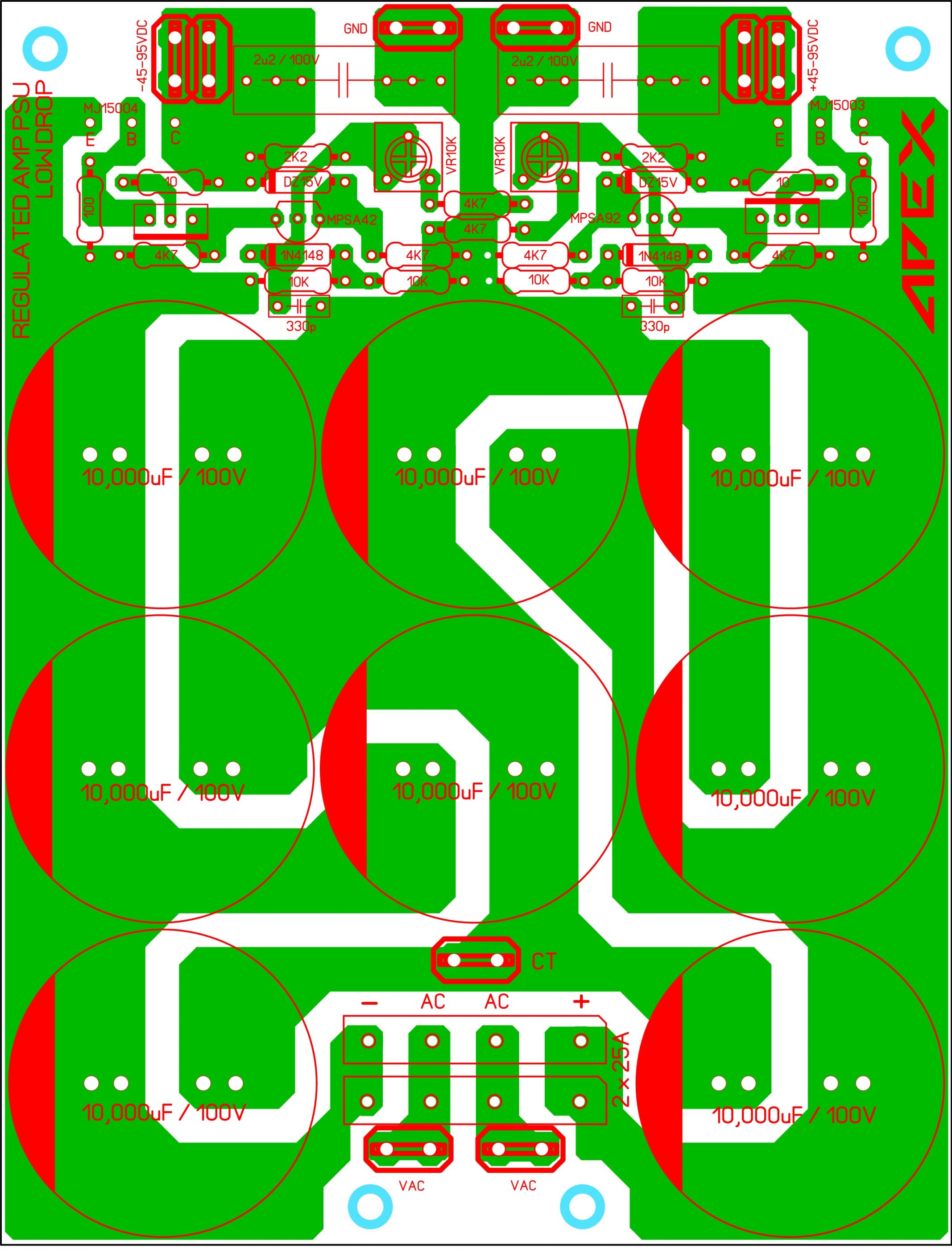

Something like this?
I believe the the outputs are reversed.PSU10R
Bridge and caps polarity are reverted on PCB.

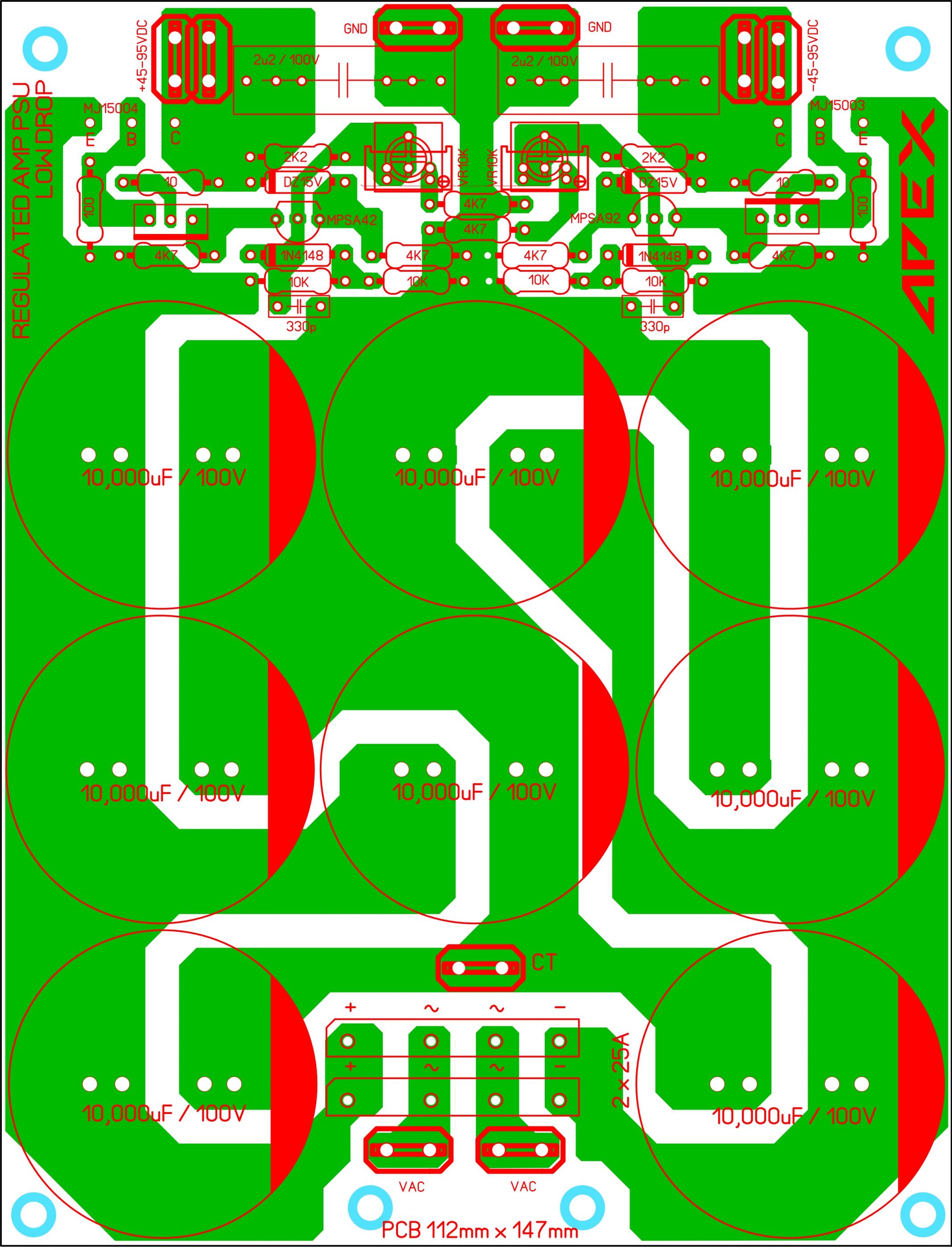

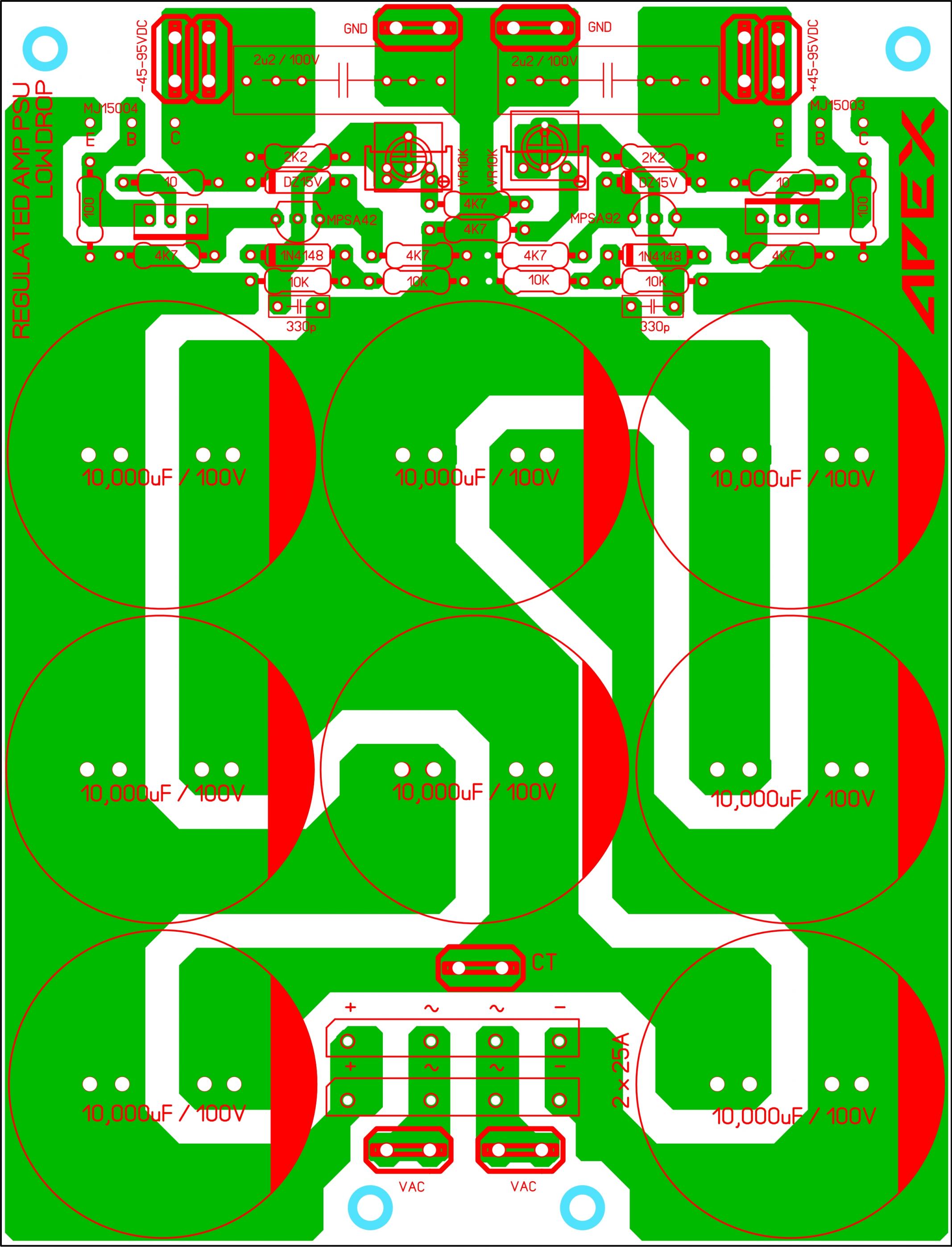

Wow I see now. How's this?
your DC voltage marking are swapped - need to change sides. nice job.
Good eyes!

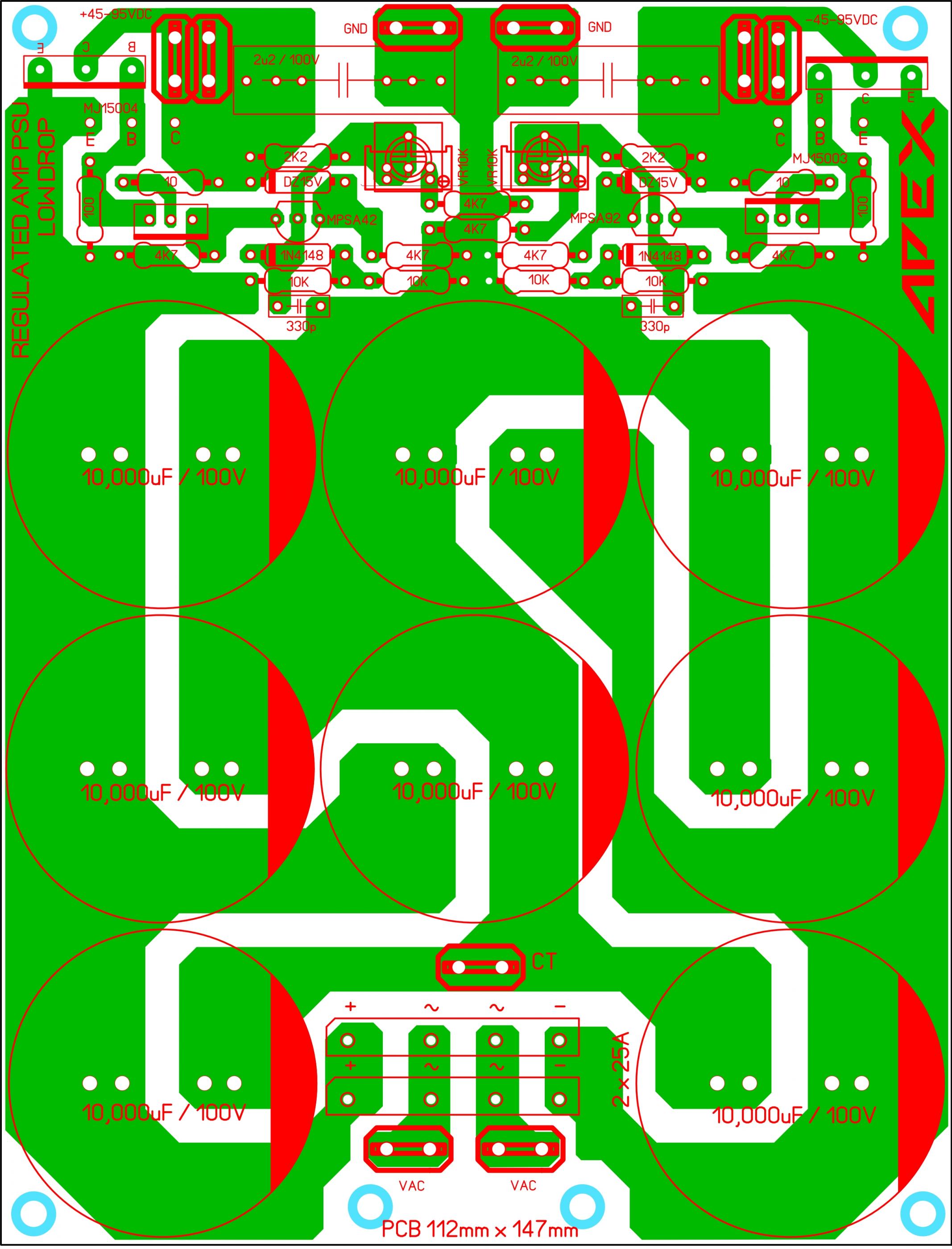

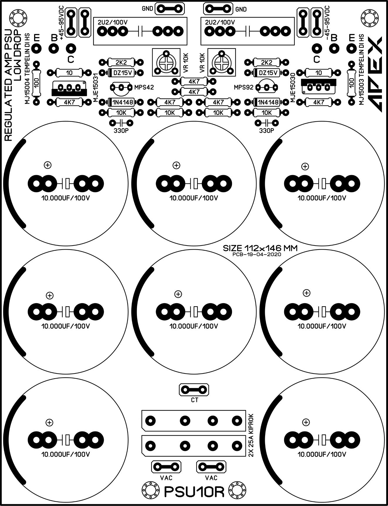

I would love to see a built PSU10R, especially what gets done with the MJ15003 and MJ15004. How the heatsinks are mounted
Good looking PCB. Do you use Sprint to make/edit pcbs? I just bought the program and started toying with it and after a week, I’m still terrible but starting to get the hang of it.
MJ15003 E and C are reverted...

These have to go on heatsinks, seeing that it can supply upto 10a. Was just wondering how you guys did your build with this PSU10R
