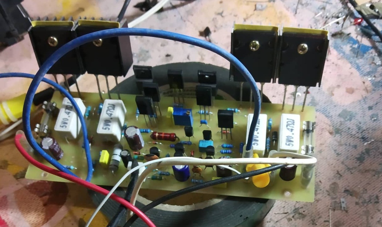

Wow, those little heatsinks were sufficient?
It's only for test in seconds, then using bigger heatsink.

I finished two boards and mounted on heatsinks, before powering on, I cross checked all the parts and found like for c11 and c12 i used 100uf 63v capacitors.
Do i need to use 2.2uf or can use 100uf too?

In AX14
