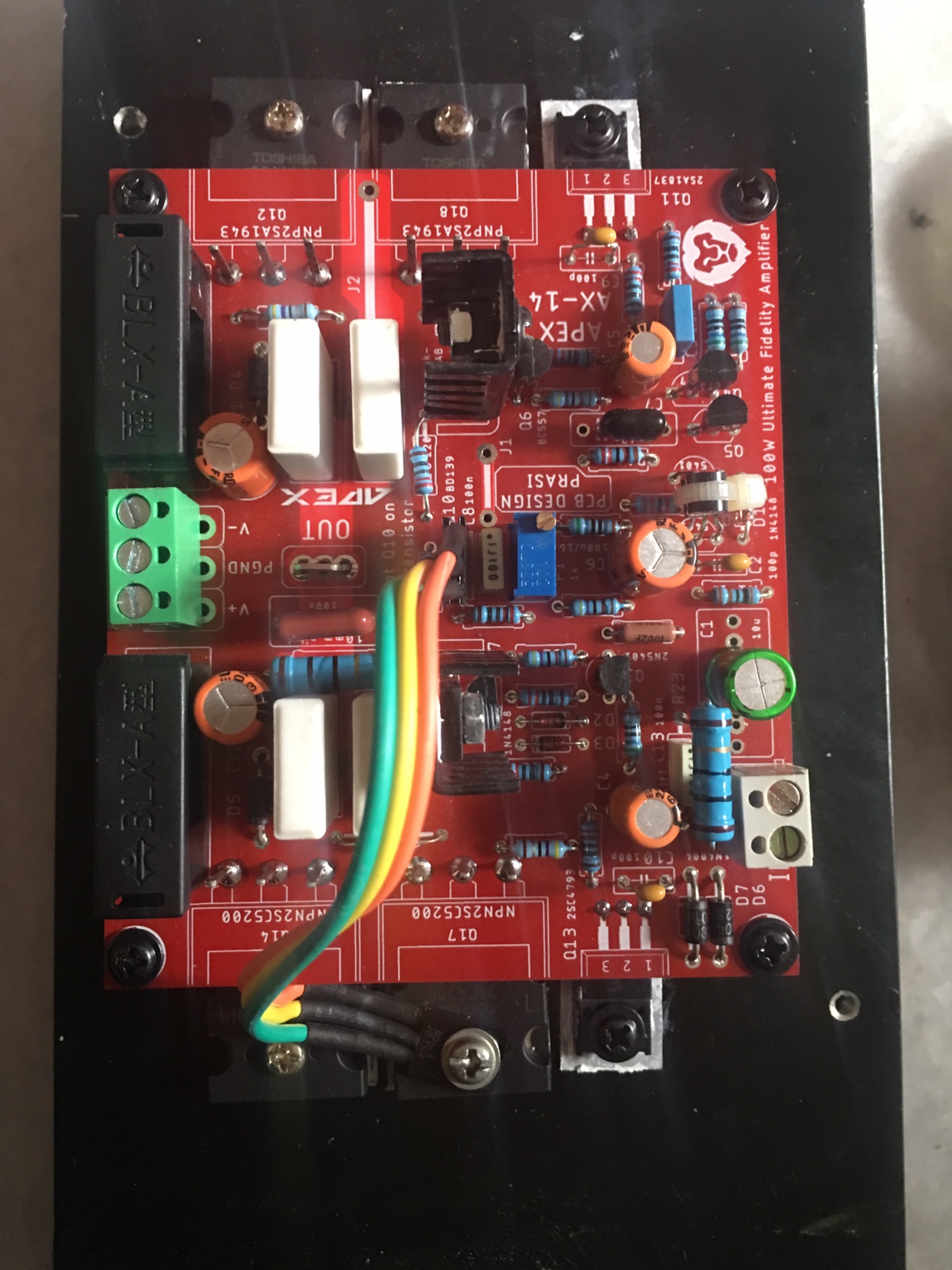

I powered the modules and unable to set the bias voltage 🙁
Both boards are showing same behaviour, the DC offset on one board is 15mv and on the other board is 7mv
Tried to adjust the trimmer but there is no voltage displayed
Regards
Raj
review your modules signal ground must be connected to main ground.
Regards
Raj
Try to change 1k resistor with 1k5 at bias circuit.
And also there is a nice asc file and also pdf file containing voltages, post d by Terry.
Measure your voltages and compare.

i have about the same issue but at one board when var is turned it adjust to about 2.3 mv, further that it jumps to +100mv and output transistors start heating.
Thanks all who helped in solving my issues, now AX14 amp is working good and the bias is set to 12mv
DC offset - It’s like less than 5mv
Regards
Raj
Regards
Raj

I followed the 11683 procedure, earlier i haven’t connected the signal ground to chassis ground.
After connecting it DC offset from 15mv on one channel is dropped to 5mv.

Yesterday i have connected AX-14 with my main speakers and found like left channel is having more gain than the right channel
Any suggestions to solve the issue?
One more observation is when i switch on the amp with out connecting the signal input there is thumb and hiss sound - is it normal?
I found the AX14 very well behaved, not a sign of switch on/off thump.
